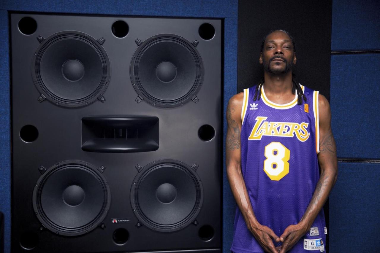

Though I don't like the look, I was considering a 26" wide driver baffle to help match the radiation pattern of the 26" horn. Sounds good in theory.
Apparently, Snoop does ;)
