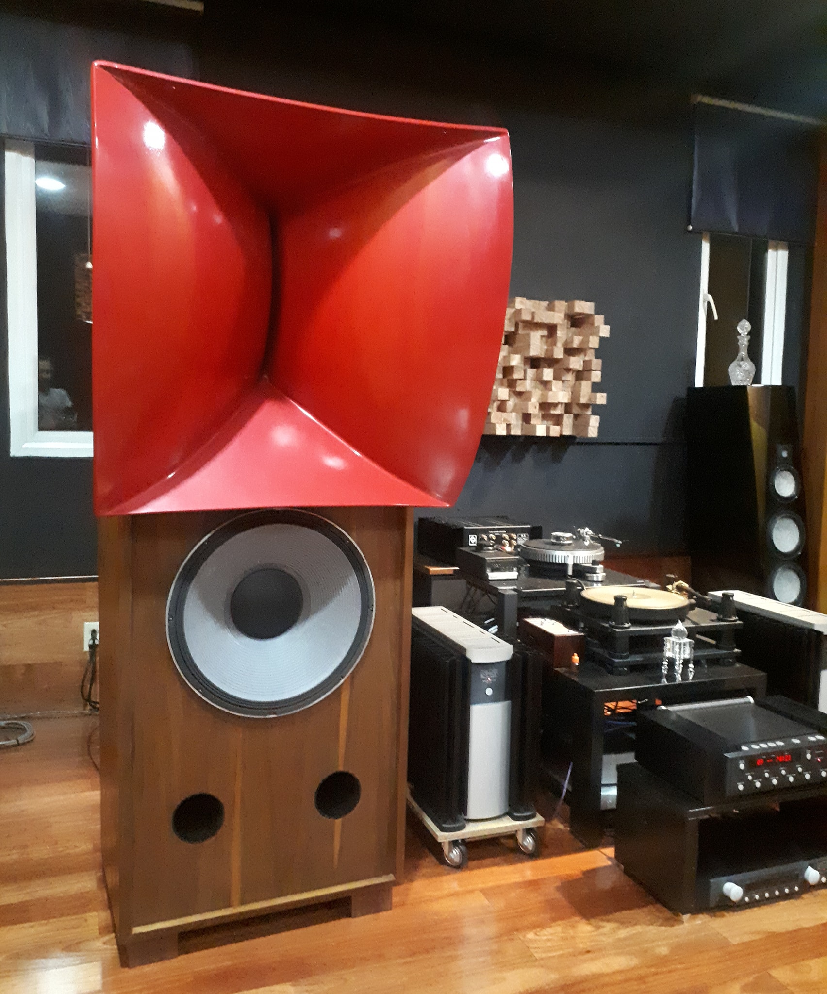

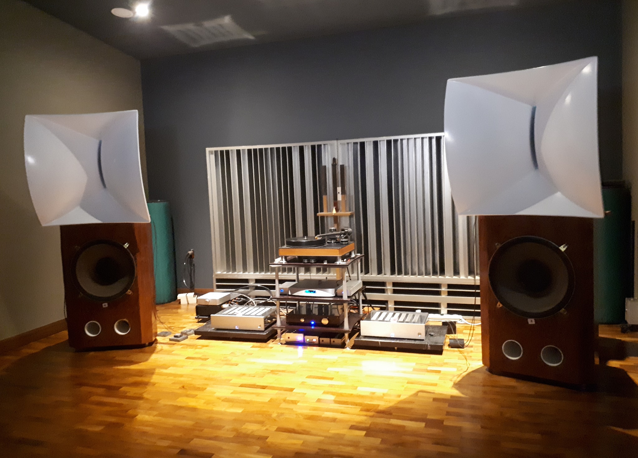

Seating is approximately ~ 18 feet to the front wall, so roughly ~16 feet to the speakers, almost 5 meters. To produce 105 dB at the seating from each channel takes a decent amount of power.

Ventilated cab for high Qt driver, so usually will have some form of damping or just a 'sock' cover for ~OB.

Ask the builder ! He is also a member of this forum !!! Have you seen the end-product as well ? There is felt over the slots in order to get resistive loading.

It's a (variable) resistance enclosure.
More info here.

I am sure even these could work wonderfully. Yes, those are 2241H 18s (thanks to GM for the reference to the FB page, earlier).
