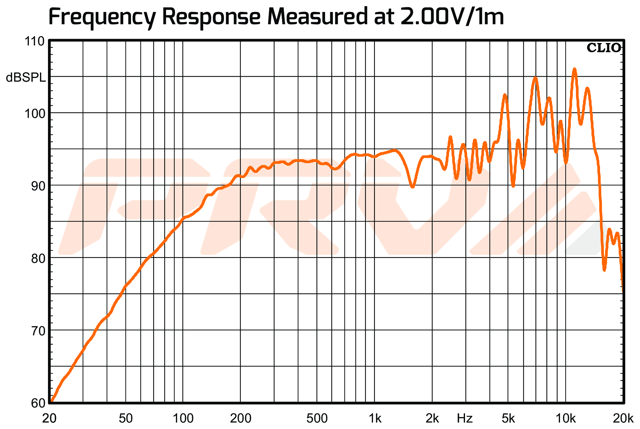

Some measurement at 104db of the PRV loaded in tractix by xrk971 says otherwise 5 years ago :Docali notes strong break up modes above 8 kHz in the Axi2050's response.
While the resonances are clearly there, I wouldn't qualify them as "strong".

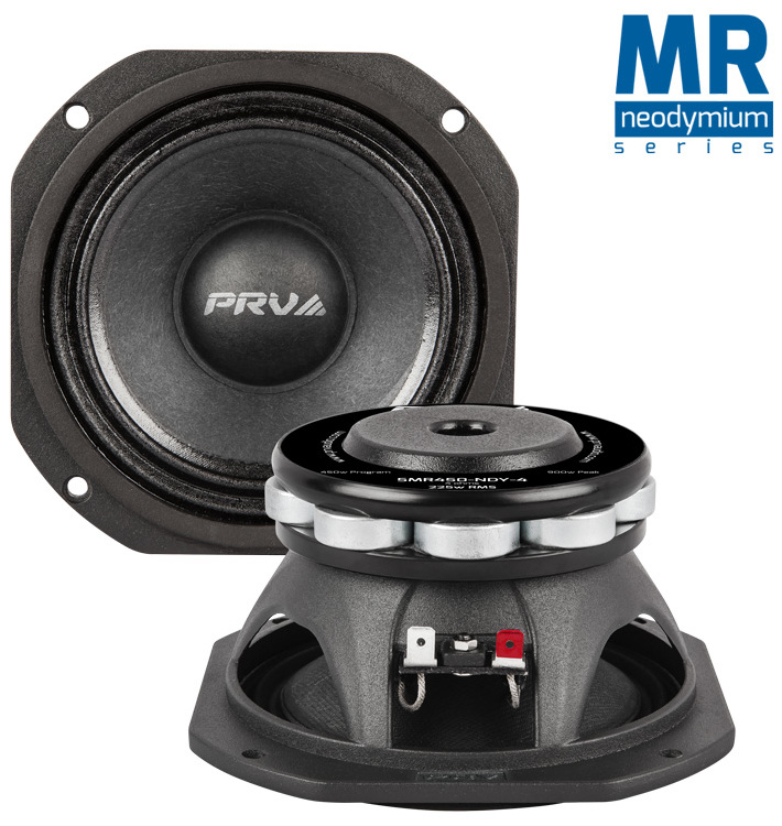

PRV 5MR450-NDY for FAST/WAW applications
Don't get me wrong, I think the PRV is a great driver and the breakup resonances of a stiff paper cone are usually considerably less annoying than the "spikes" of a hard suspended metal diaphragm.
Here's the 5MR450NDY mounted in XRK971's OB setup (slot loaded OB) with 5 dB major tic increments (instead of 10 dB).
XRK971 initially used EQ to flatten the cone breakup peaks and later applied notch filters, which improved the driver's IR.
