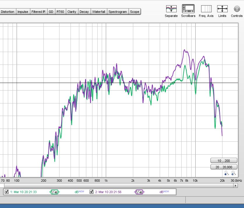

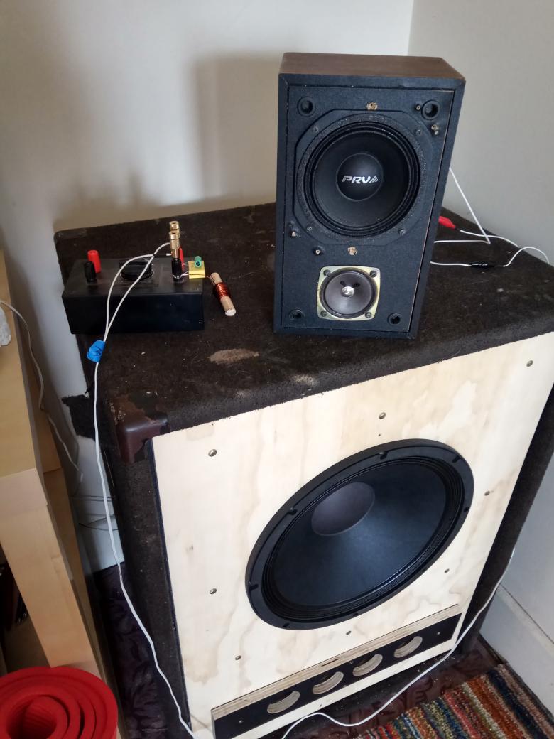

The 5MR450 has a breakup at 7.7khz that is slightly annoying and noticeable. Mounted in small sealed boxes, a simple passive filter can fix this to a large extent, and in this setup it doesn't need any other EQ
Mounted in large horns changes things, and I haven't had the time to work out a passive solution, so i am using DSP for now
