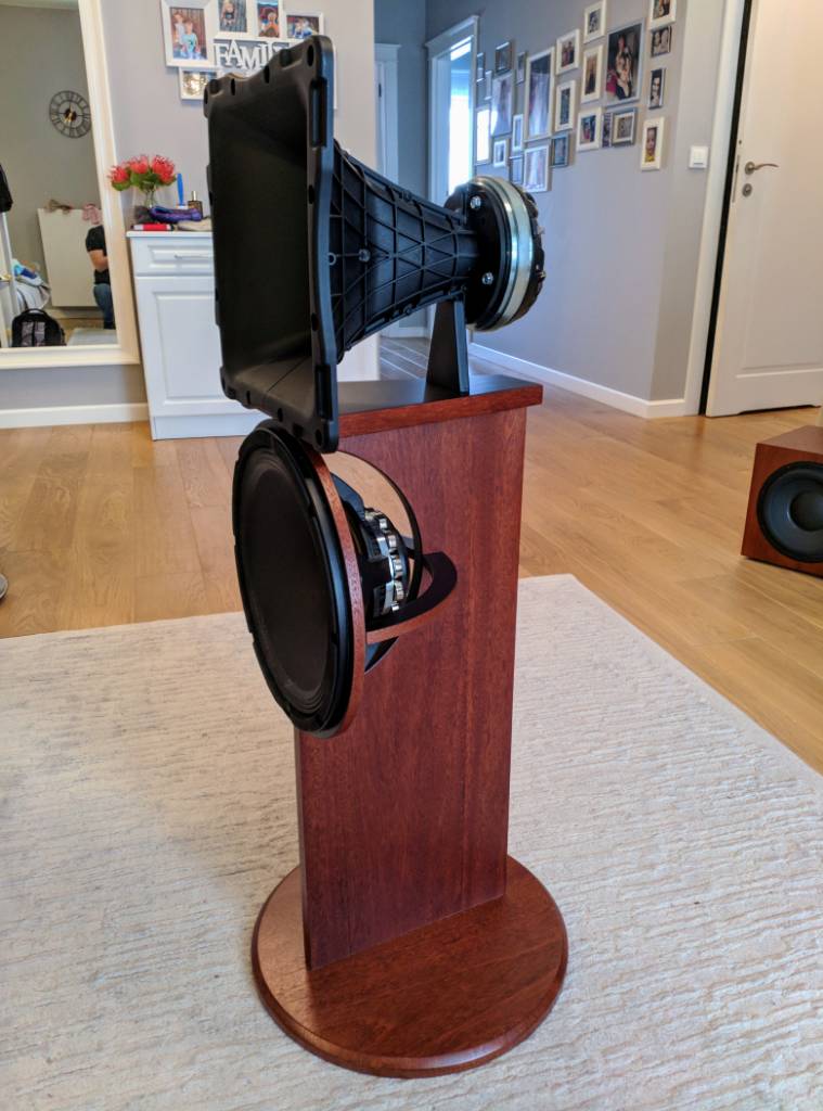

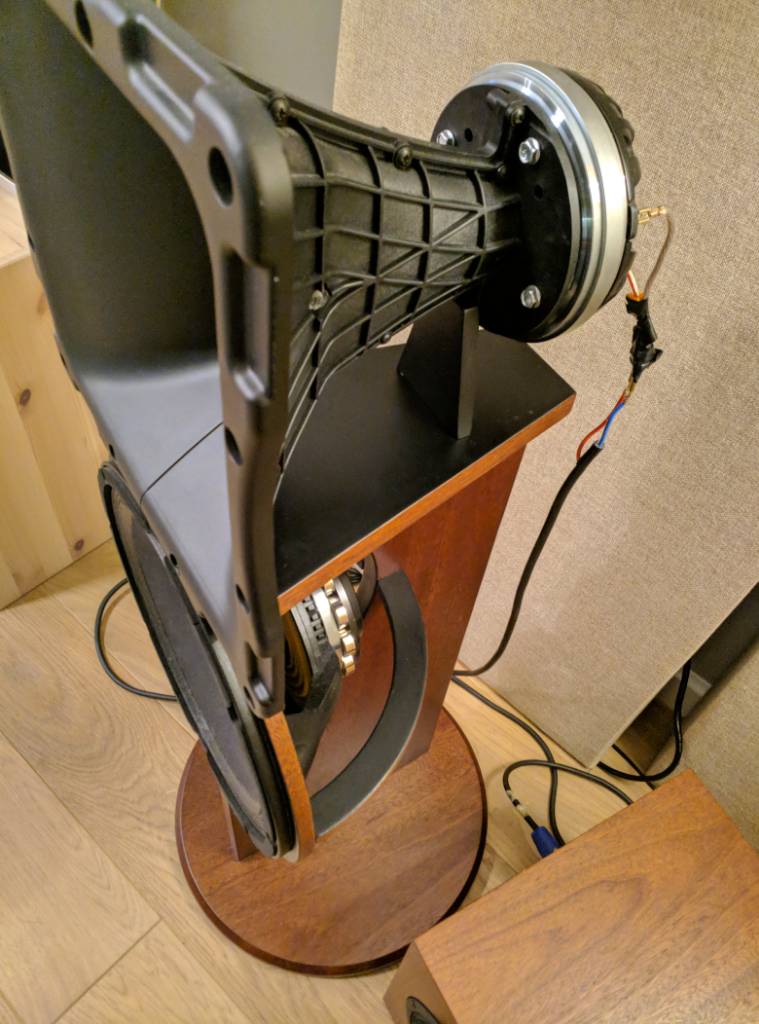

RCF ND940 1.4 with HF950 + Beyma 12MW/Nd OB, augmented with subs.
Crossover @ 600 Hz.

The builder commented:
"Subs are Peerless 830452 in closed 30l cabs. They play clearly quieter than the Beyma 12s. I equalize to 30 Hz and you need to give 10dB correction.
I noticed that the bass is better when the subs play in mono mode. And even better when one has a reversed phase."

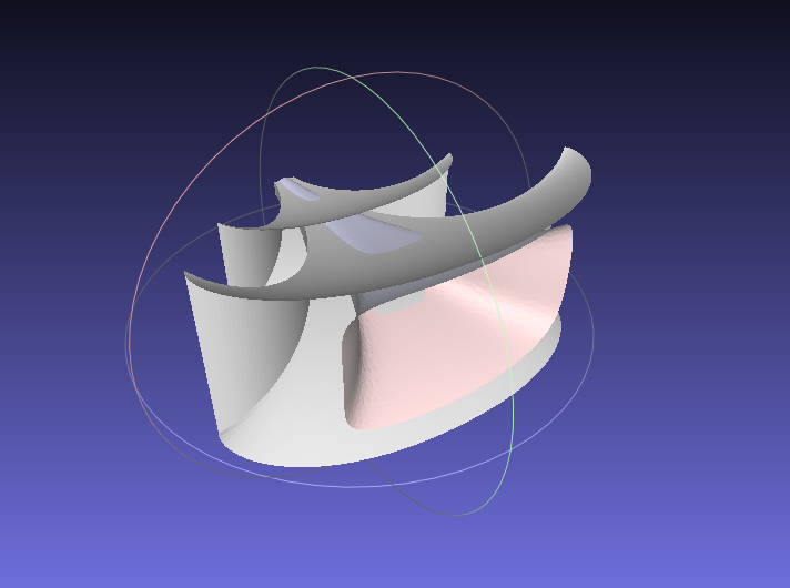

Radial horns overlaid with the drba_swh160_sf138_se6p (pinkish), from left to right [drba_radial_grt_1, drba_radial_001, drba_swh160_sf138_se6p]
One of the radials is smaller. It might be worth simulating, and maybe a trial print first build, but it does not look like it would suite your long term goals.

Thanks, Don, for this nice overlay!
These radial horns become very wide with respect to their horizontal dimensions. So, not really what camplo intended with his size restrictions.
Furthermore, this radial horn has a rectangular throat. I remember that it took some time to have a good base model for the round driver in the simulations. Is it straight forward to adopt this to the rectangular case? I agree that it would be of high interest to see how these perform. Although, the radial is what I call a "behave to nothing" horn while the SWH is a "behave to something" horn. The radial has no overall construction wave front. Only the horizontal profile behaves to something. The vertical was chosen to get a certain mouth exit angle.
The SWH is a behave to something horn and we know that it has very good and even loading characteristics. We see this from the nearly straight trend line in the sims.
If camplo would like to build a smaller model horn he should use the same horn as the target design but only scaled down. I think 400Hz would be a good model.
