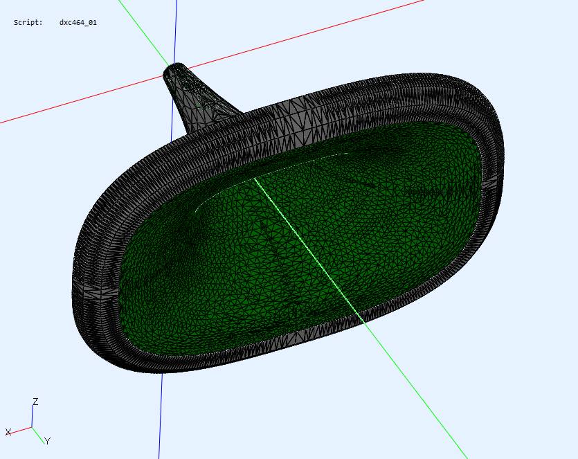

These are the last few horns overlaid to show the relative sizes.
In order left to right : [ dcx464_01, drba_jmlc_150_hvdiff, drba_Shark_RA_45_PE_PRJ, drba_swh_147_T07_Jericho ]
I thought the "drba_jmlc_150_hvdiff" (elliptic) was the preferred but could use some more refinement on the vertical roundover.
@camplo - Is "drba_jmlc_150_hvdiff" one to proceed with? If not maybe @docali can generate a smaller version of it for say 300Hz as a trial printed horn.
I think I'd be well off to end up with the drba_jmlc_150_hvdiff unless Docali has some input on this. I mean I gave the rough draft, you and him are doing the finishing work, and then I have to handle the fabrication.
You threw me for a loop with the last simulation because I didn't expect you to go from the smallest horn to the biggest but at that point, it was obvious that the medium horn wasn't going to make the horizontal polar wider. I remember the hvdiff profile being a combination of many designs before it came to a few tweaks, that in total, makes for a desirable profile. I'm not trying to ad to your work load. I invite you to do more simulations to satisfy your own curiosity. The last bi-radial that Docali made would be an interesting sim, in my opinion. So in short, if you were to work towards the finishing touches on the 150 HVDiff, I'd be happy, anything else is a bonus.

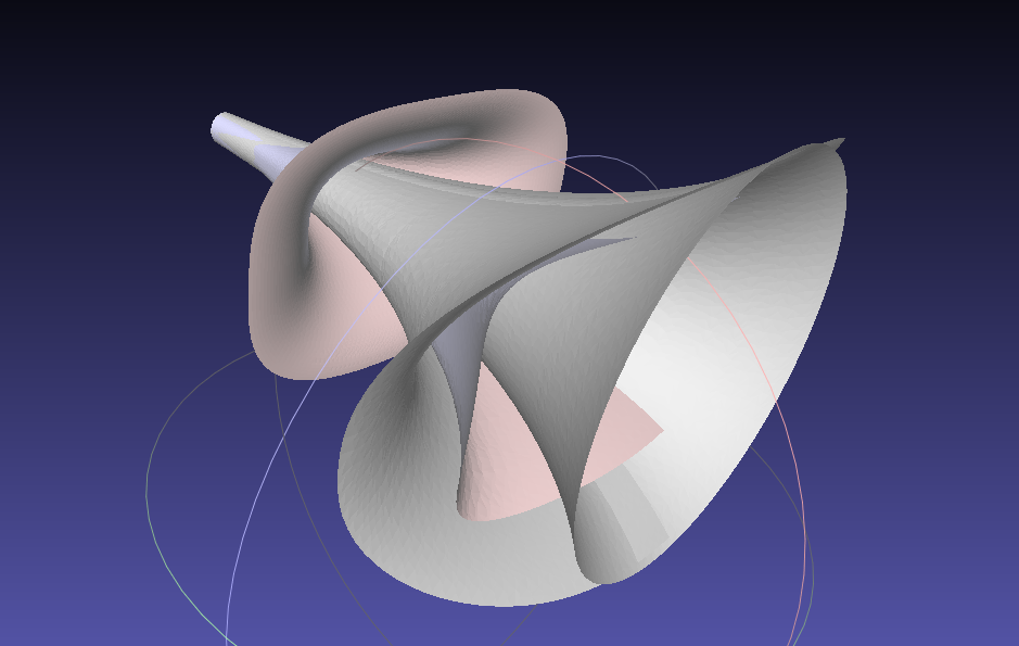

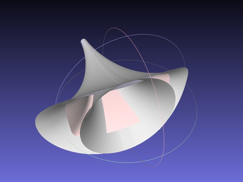

I would suggest that camplo should focus on the round Jericho or this one:
https://www.diyaudio.com/forums/mul...m-spl-low-distortion-2-a-495.html#post6010045
I am not sure what was meant with biradial but my drafts shown had a rectangular mouth/shape.
I like the round Jericho too, but the horizontal polar is wider on the HvDiff and the loading is the same. HvDiff loading is also wider than the drba_SWH160_SF138_SE6P....
Is it possible to cover the whole spectrum, high spl, low distortion with a 2-way? _ was the radial I personally had in mind. Here's another Is it possible to cover the whole spectrum, high spl, low distortion with a 2-way? that was made.
I don't know anything about them, I didn't inspect them but we have already seen the length connection to loading amongst the tried flare rates. If I printed a small horn before attempting the 150hz Hvdiff I'd rather it be a 320hz HVDiff that I could cross at 600hz or so.
