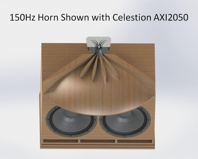

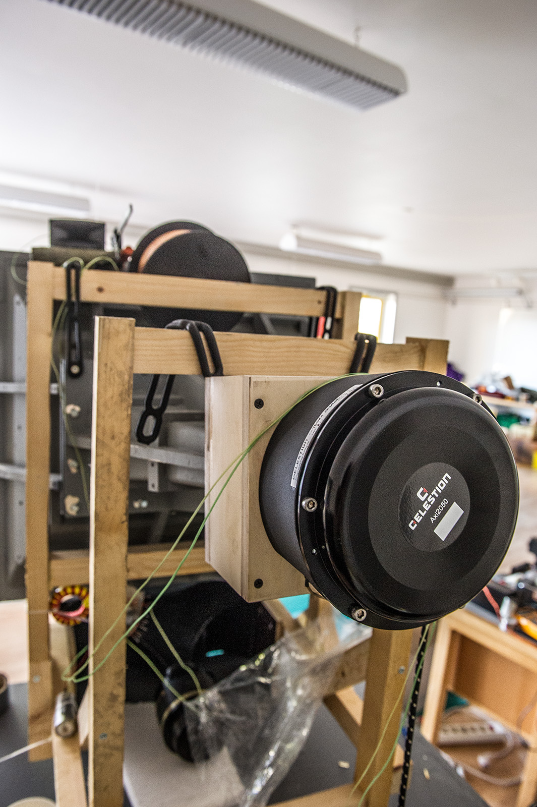

Some of us wondered about the "box" in front of the Axi2050 that was mounted to Bjørn Kolbrek's mid horn at the European Triode Festival 2017.
737289d1550517474-celestion-axiperiodic-driver-kolbrek-axi2050_etf_4-jpg
Here's a comment by a member of the Norwegian ETF 2017 crew:
"The Celestion drivers are very good, much better than the (Altec) 288. Bjørn Kolbrek works at Celestion, so he arranged the loan of the drivers, they went straight back to Celestion after the festival.
A new throat section was made for the mid horns to mount the Celestion drivers."

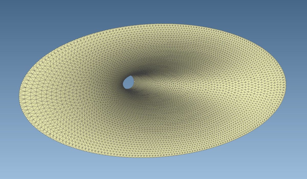

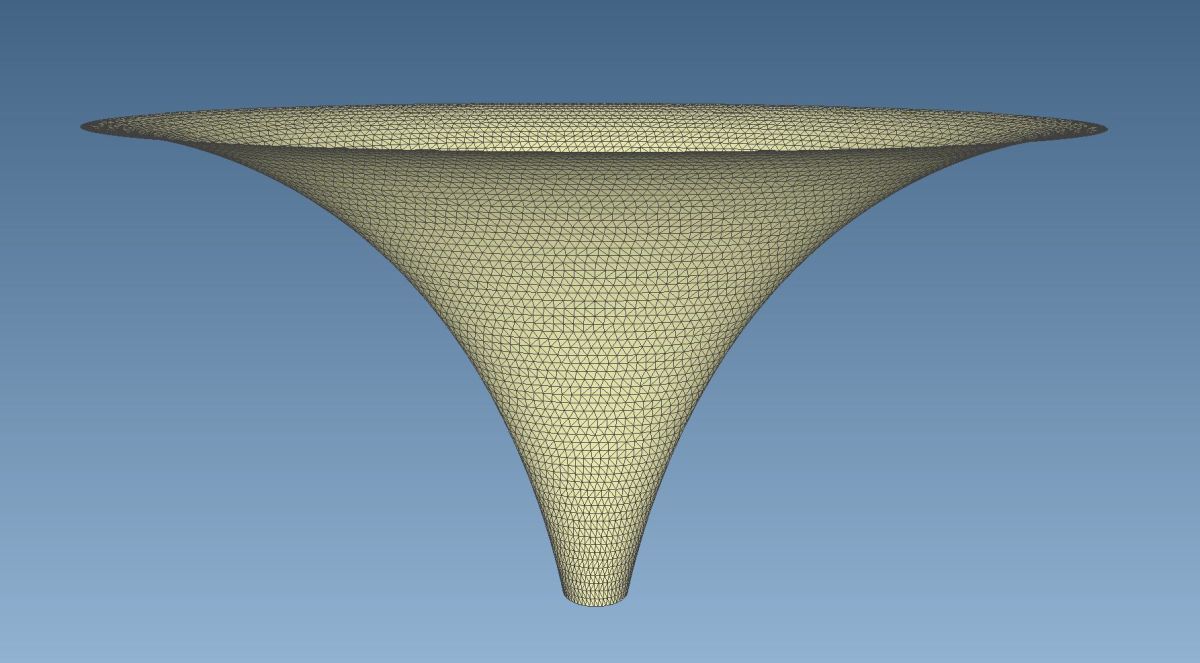

Obviously, the circular horn has more energy because its beam width is focused on axis, while elliptical one have a spread energy around the space because they cover a bigger angle on the Plane A. Due to its structure, the elliptical horns cover a larger area and for this reason, we have an SPL loss.
What? This is a major issue I addressed in my calculator not to happen! This is a similar profile but has strictly the same constainst as the round one by using ellipsoidal construction wave fronts:
View attachment ciare_01.zip

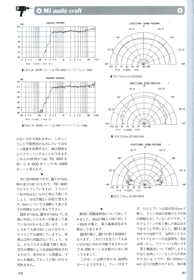

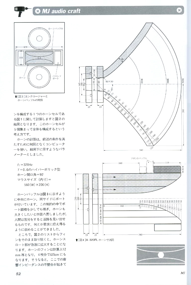

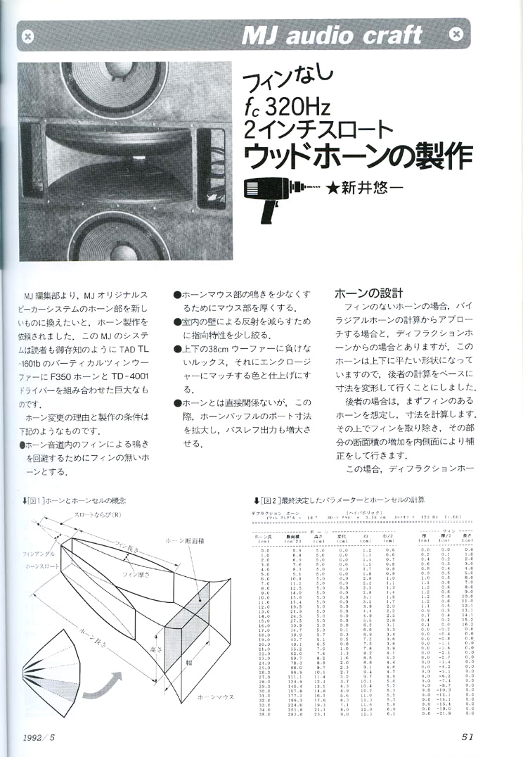

Yuichi Arai's A320FL article from the May 1992 issue of the Japanese magazine "MJ".
Directivity is supposed to be decent up to 10kHz.

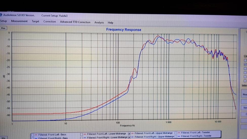

I've tried the AXi2050 in A320 up to 9kHz.
Works well, but it needs eq in the top octaves.
Here is how the raw response looks in Audiolense PC based DSP with FIR, measure window;
Right now I use it from 650 hz to 5 khz with TAD 2001 in JMLC-2500 over.
Maybe I will try it later with Fostex T-500 mkll from 9-10 kHz.

These curves let suspect strong break-up modes from 8-9k on which cause generaly a high degree of distortion. Could someone do a precise distortion analysis of this hyped driver up to 20k? I do not think that this driver should be used up to 20k.
Maybe you can use the AXi2050 all up in PA systems in bigger horns, but in my case with a small room and hifi setup with the Yuichi A320 I think the limit is around 9 khz, maybe lower.
Works great in current setup, 650 Hz to 5 kHz, and sounds good.

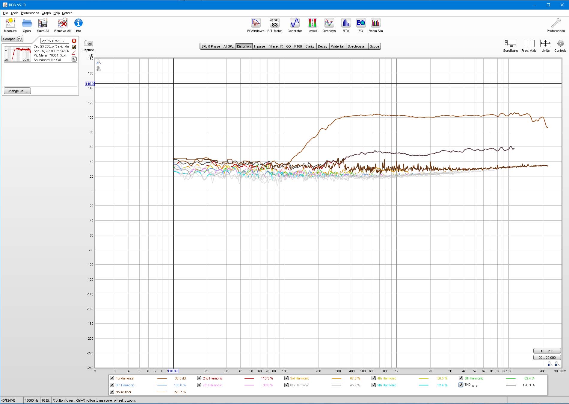

These are from Kevins 250hz Jmlc's, I'd have to look up how he did the measurements, I think at 1 meter, not sure. Could be at listening position which is 3 meters.
