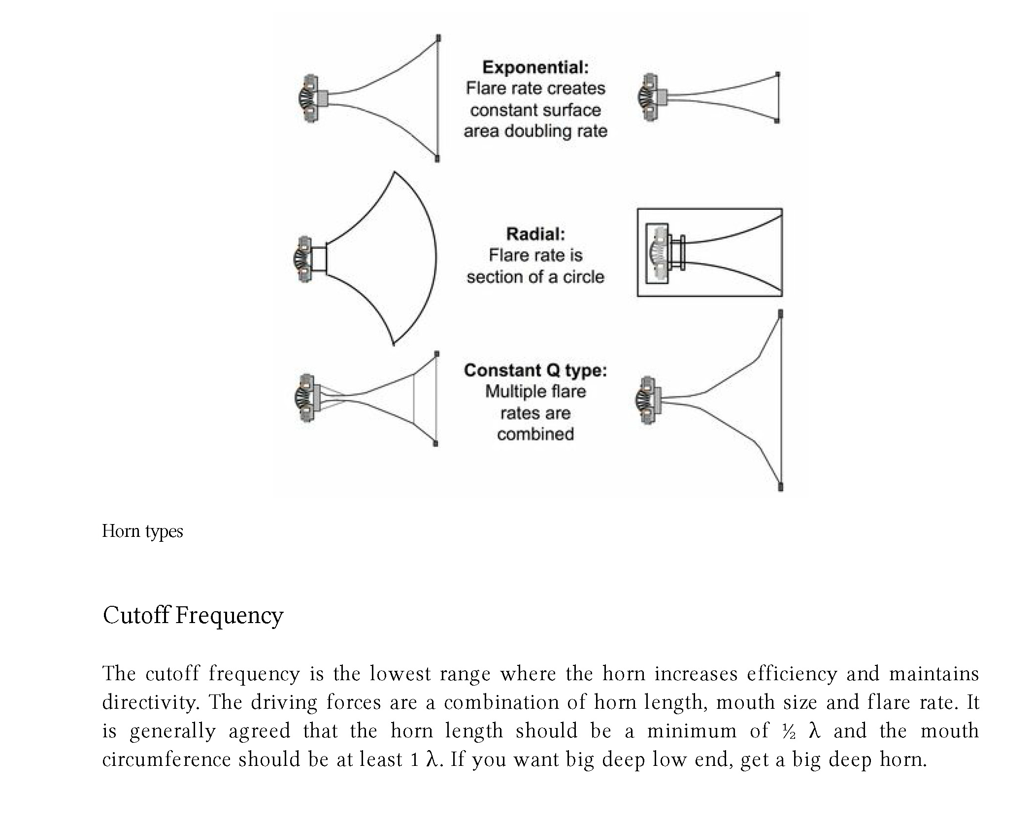

"The geometry that describes the shape-shifting between the throat and mouth is termed the horn flare or flare rate. This can range from a simple linear expansion (the cone) to equations using half the Greek alphabet. The simplest one that we still might find in the field is the exponential taper (or exponential-ish variations thereof)."
And:

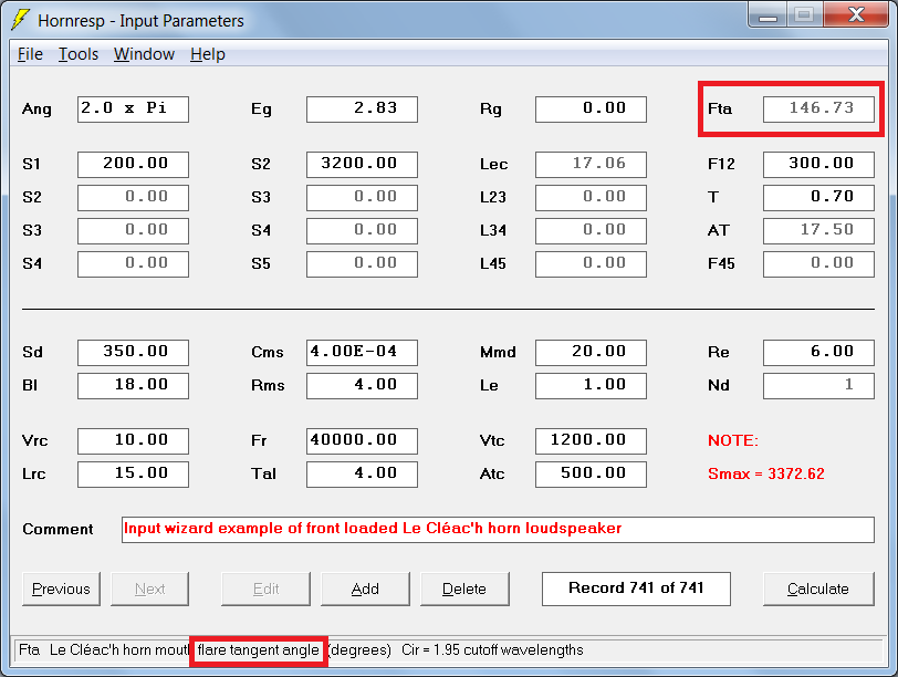

Another reason for considering flare to be related to the physical profile of the horn:
"A horn is also a directivity controlling device, which radiates over an angle defined by the flare angle of the mouth."
Ref: Beranek & Mellow - "Acoustics - Sound Fields and Transducers"
This is why Hornresp continues to use the term "flare tangent angle".

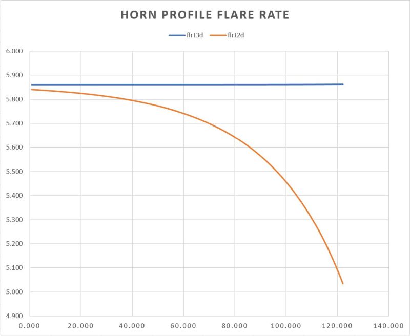

This is the flare rate of an spherical wave horn with T=1 for the 3D construction wave front flrt3d and the 2D step wise mouth surface area (numerically evaluated from the profile). flrt3D is of course constant as the derivative of the exponential function is again the exponential function.
Exact formula is: 1/S * dS/dx

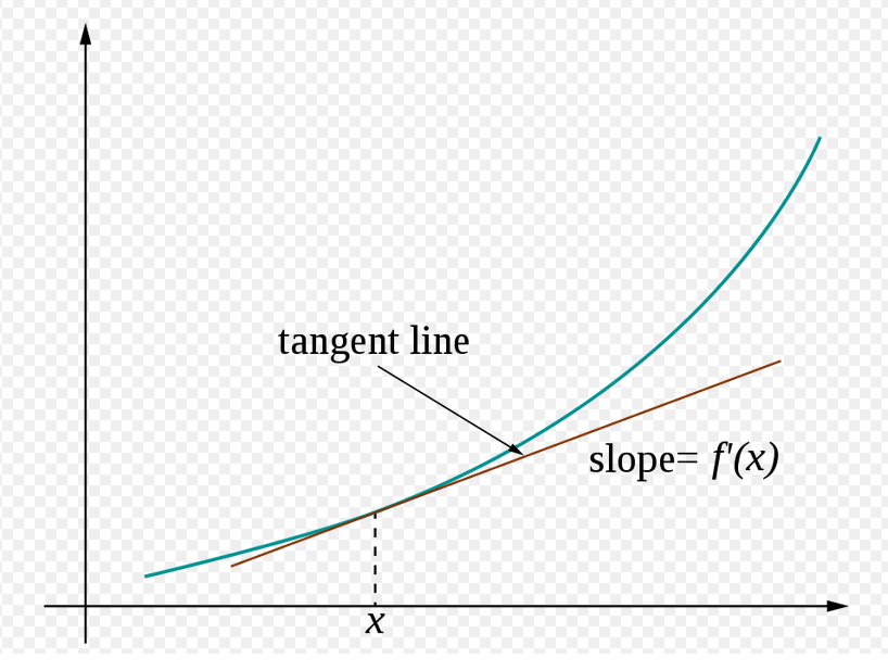

Without giving it any thought, I had automatically assumed that the flare rate at a given point on a flaring profile would simply be the first derivative, or instantaneous rate of change of the curve at that point. In other words, the slope or gradient of the tangent line to the curve at that point, as illustrated in the attachment. It seems that I was wrong in assuming this!
My sincere apologies to everyone for my earlier, now "fake news" posts on the matter. I will try to make sure that it doesn't happen again 🙂.
