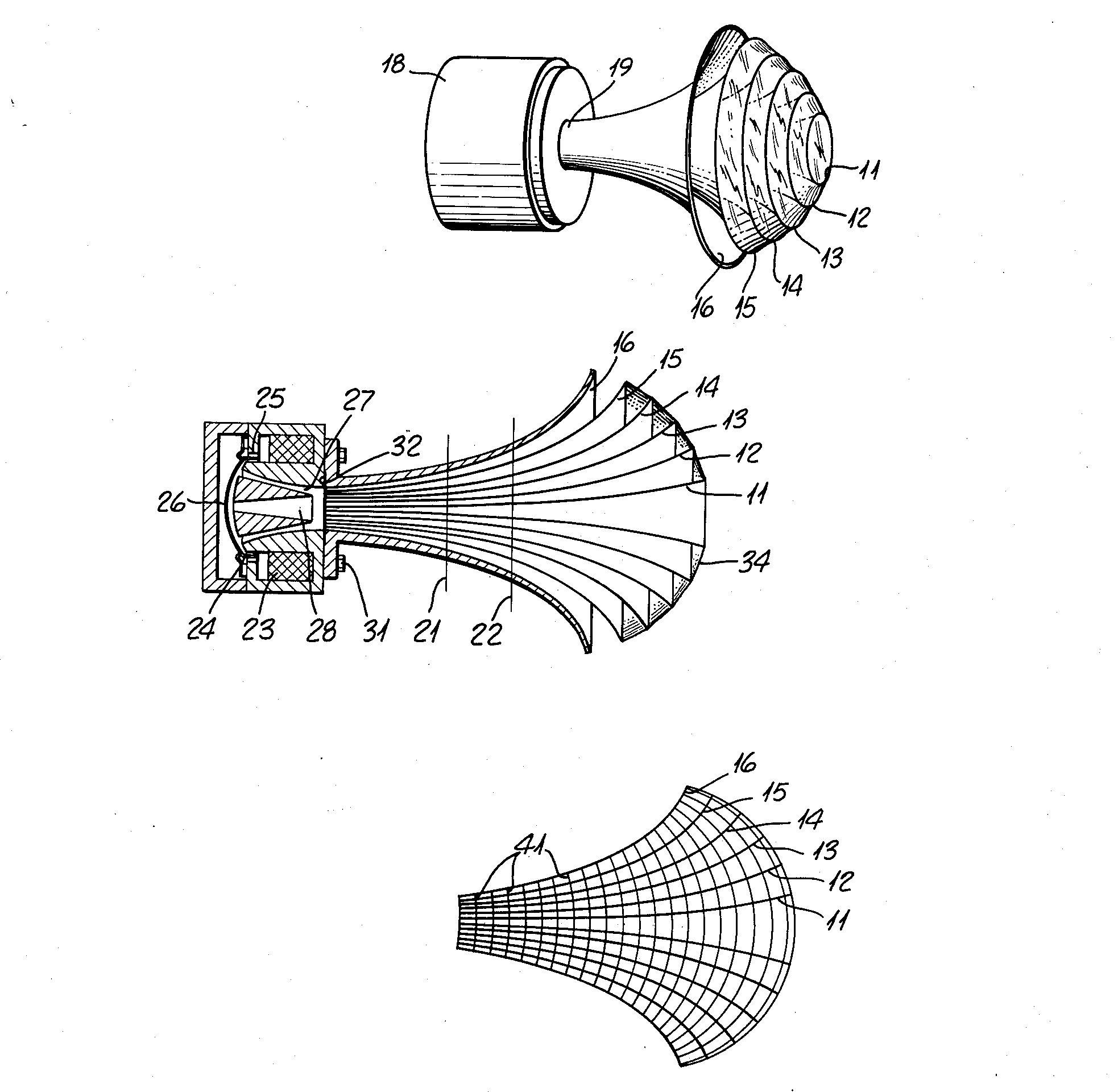

Less well known than the OSWG, but no less interesting is Dr. Geddes' Phase Plug Patent, which brought me to the idea to extend the phaseplug into a "Phaseguide".
As is the case with most loudspeaker concepts, something similar (though not the same) was patented by Amparex in 1958.

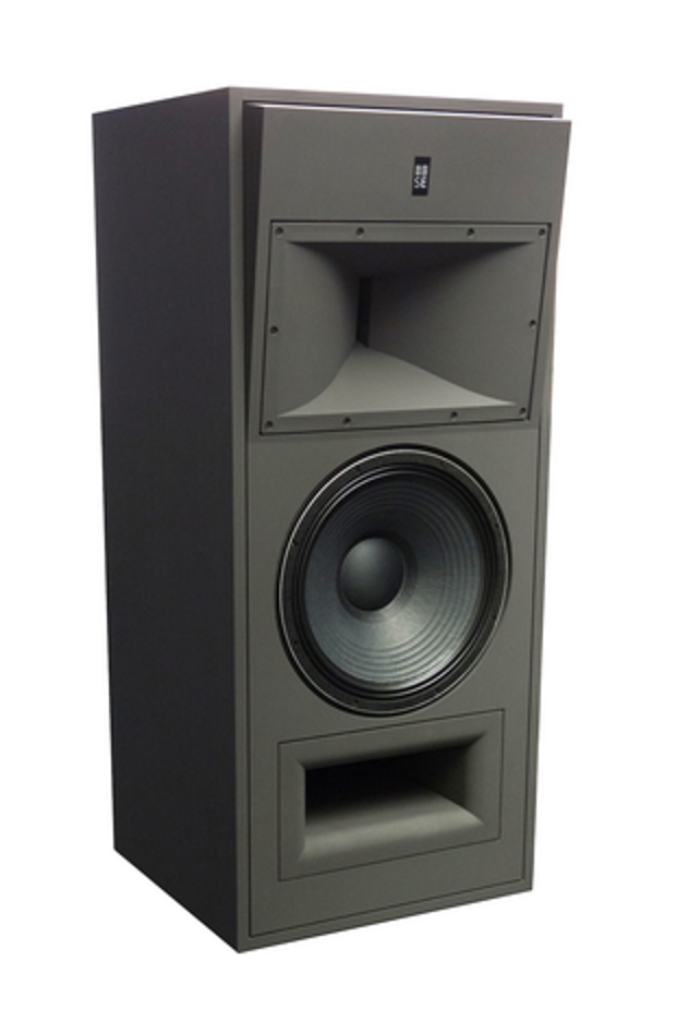

My question has to do with the 3 octave horn rule. Is it a problem to do a compression driver/horn from 800Hz to 15KHz with a single compression driver/horn that the manufacturer produces a response plot claiming it can? Besides the math what is the audible cararcteristics? Less crossover issues vs excessive driver/horn BW?
800-15k? Sure.
The Calpamos by Tony Gee is an example, another "slightly more expensive", but similar 2-way is the Strauss MF-2...
Pardon me, it's now MF-2.1.
The specs seem too good to be true, but the designer has a very good reputation in the high-end mixing/mastering industry at stake.
I have yet to encounter a negative comment on the predessor, which looks identical (apart from the woofer) and has been around since 2000.
SE-MF-2.1
Drivers:
- 2” compression driver, metal alloy diaphragma, neodymium magnet circuit
- 15” LIT woofer, coated paper cone, neodymium magnet circuit
Sensitivity: 93 dB / 1 W / 1m
Impedance: 8 Ohm
Power: 200 W RMS
Frequency range: 23 Hz – 26 KHz (-* 6 dB)
Crossover frequency: 400 Hz
Distortion THD: < 0.3 % (93 dB / 1m / 100 Hz – 26 KHz)
Dispersion: 90° horizontal, 40° vertical
Weight: 110 kg / 220 lbs
Dimensions: height 1200 mm, width 530 mm, depth 490 mm

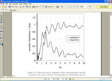

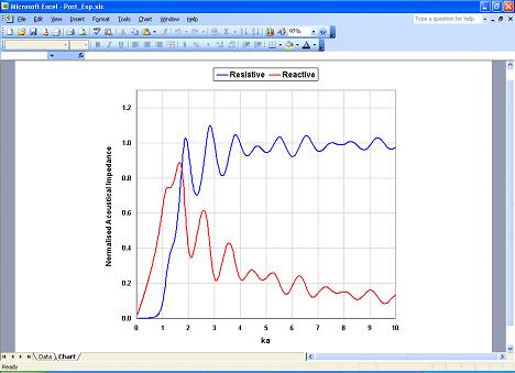

The high "loading" aspects that people point to are false artifacts that occur in the Webster solution that don't actually occur in reality.
Attachment 1 - Measured normalised throat acoustical impedance for the axisymmetric exponential horn specified below.
Attachment 2 - Predicted normalised throat acoustical impedance for the same horn.

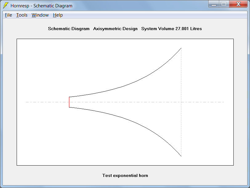

Attachment 3 - Horn profile.
Test horn:
Throat cross-sectional area = 20.27 cm^2
Mouth cross-sectional area = 2307.22 cm^2
Axial length = 55.90 cm
Radiating into half-space (2.0 x Pi steradians solid angle)
(The simulation results were exported to Excel and converted to show values of ka rather than frequency along the x-axis, to make it easier to directly compare the predicted and measured data).
David, your sim seems to confirm the common conception regarding the good loading properties of exponential horns (irrespective of Webster's theory).
More importantly, the actual measured results also confirm it 🙂.
