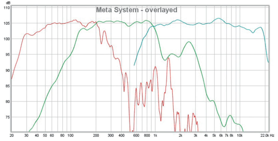

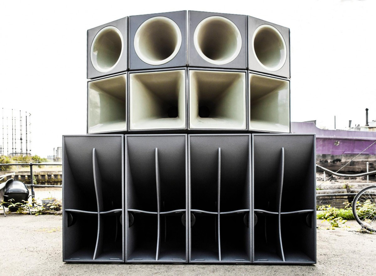

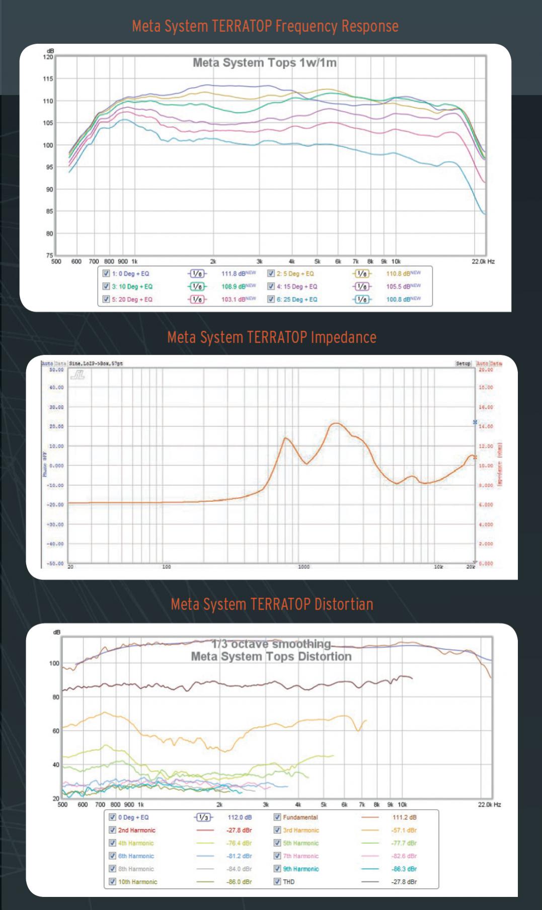

These guys also build an impressive-looking 3-way mobile horn system, including a rather large 40° OSWG.
- 630Hz Oblate Spheroid with LeCléac’h roundover
- Crossover: 957Hz, LR24dB HP
- (HxWxD): 550mm x 610mm x 576mm.
Despite the narrow coverage angle and generous size, it seems this waveguide would put a quite lot of stress on the driver <700Hz.
Interestingly, a Fc of 630Hz is specified.
