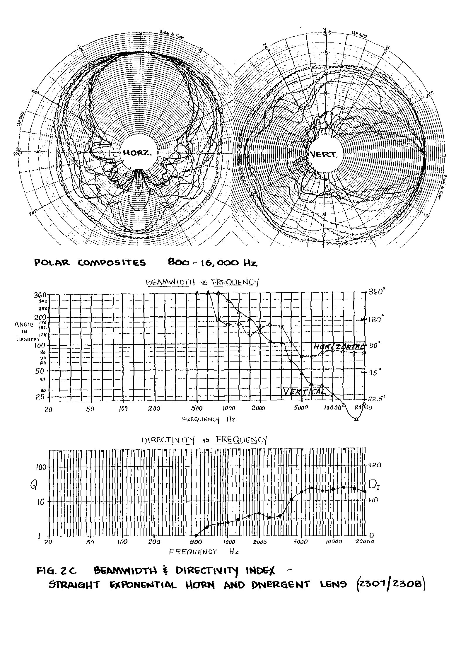

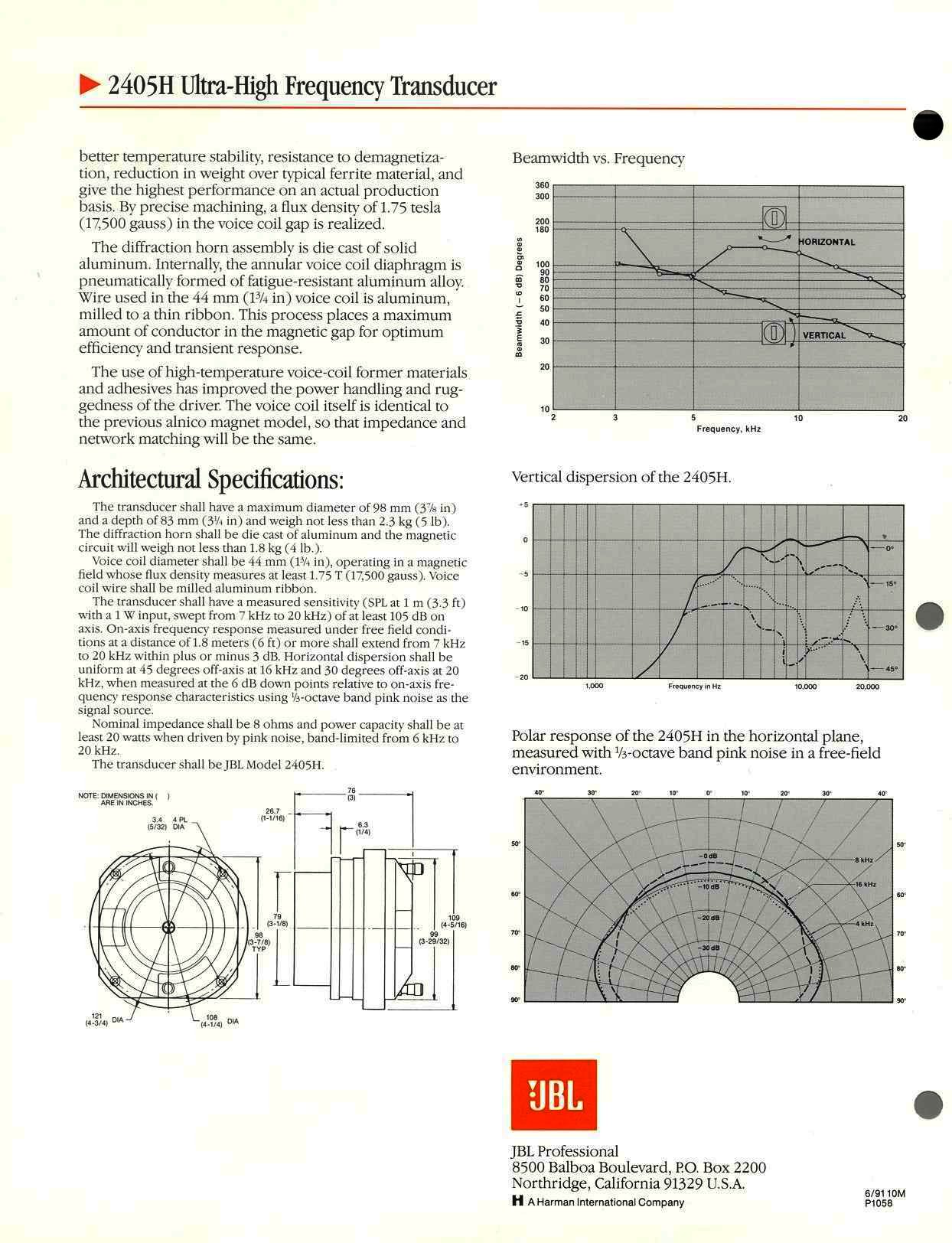

Hello Camplo
Here are the polar plots for the 2307/2308 horn/lense combo and the 2405. You can decide for yourself. There is a 10 K crossover point between them in the 4344/45 speaker. They are mounted side by side so there is lobbing off axis when the two are combined. Looking at the vertical plots you can see how narrow and irregular both get off axis. The 2307/2308 plots are from a DB Kelle AES paper for the 4430 monitor.
Rob🙂

Certainly not a consensus from me. Having heard many shallow waveguides in PA or domestic use (including Gedlee) I disagree. They are fine at moderate levels, but start to get into trouble even at loud domestic levels. You'll hear the compression driver straining and working hard. It isn't pleasant or natural sounding.
At the same SPL and above in a deeper, wider horn - there isn't the same problem. There are other problems, of course.
This is my experience and that of others as well.
