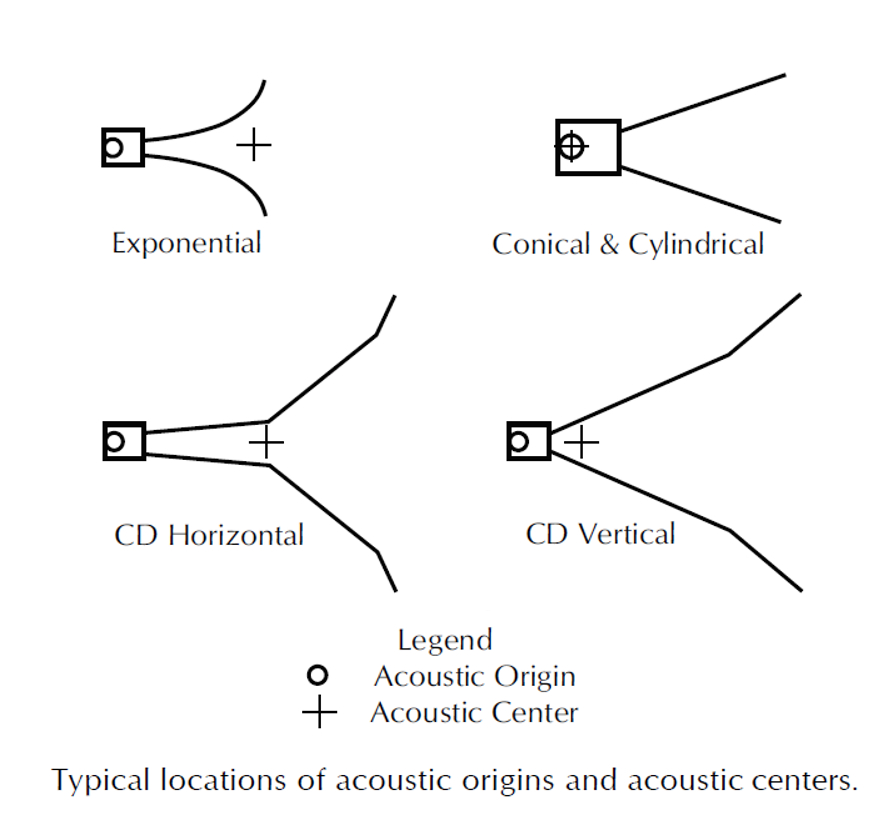

If one measures the impulse response of a loudspeaker at some remote point in space, it is found that a finite time elapses between the application of the loudspeaker excitation and the reception of the response. This time interval is called the transit time. The product of the transit time with the value of the speed of sound that prevails under the conditions of measurement defines a distance.
When this distance is projected from the observing microphone towards the loudspeaker along the loudspeaker axis, the terminus of this projection defines a point in space from which the signal appears to originate. This point is called the acoustic origin. On the other hand, the acoustic center is the point in space from which the spherical wavefronts appear to diverge as observed in the far field. The attached figure illustrates the location of these points for a variety of horns.
It should be observed that only the cylindrical and conical horns have co-incident locations for both the acoustic origin and acoustic center.
OS also has this characteristic.

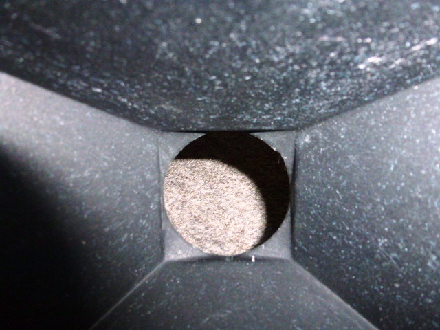

Here's my question to Dr. Geddes regarding a "smooth slot", as featured in the 18Sound XR horns shown previously:
As the wave fronts in the interior of the elliptical throat section of these 18Sound horns have curvature and there's no sharp discontinuity - in contrast to the classical diffraction horns, would it still lead to reflection and subsequent astigmatism?
I don't keep up on current products - too many.
As the discontinuity diminishes so will the reflection and the diffraction - so its better, but best is no discontinuity at all.

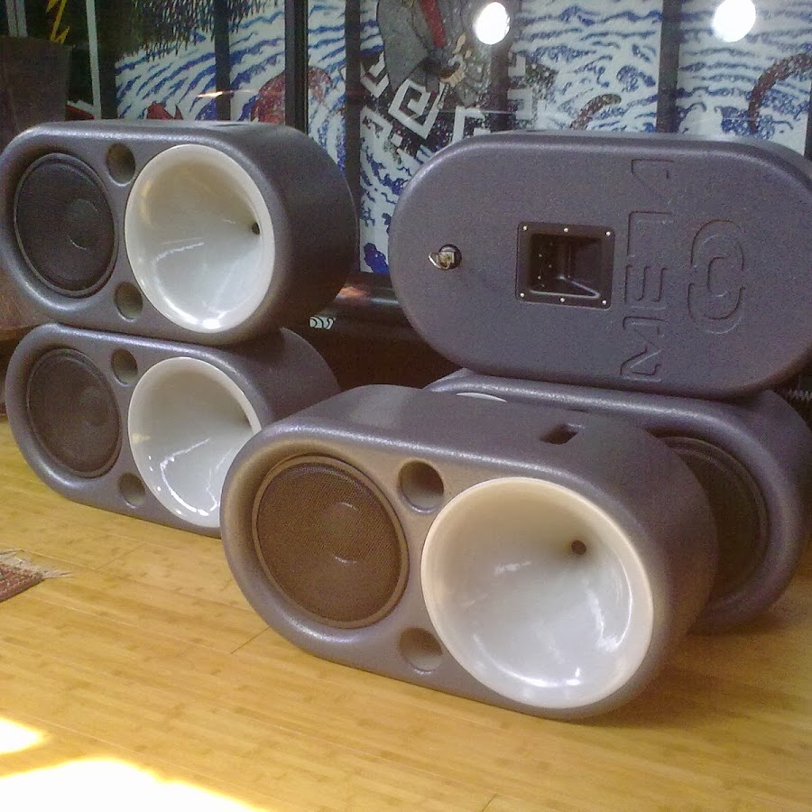

There's actually a small PA company using OS waveguides for their 2-way cabs. These are 60°, I believe.
Yes I know K402 is not OS, it's conical then tactrix it's why I used "quasi"...properties are "almost" the same as OS
The "mid-section" (after the throat and before the mouth) is similar indeed. Not strictly conical, but close.

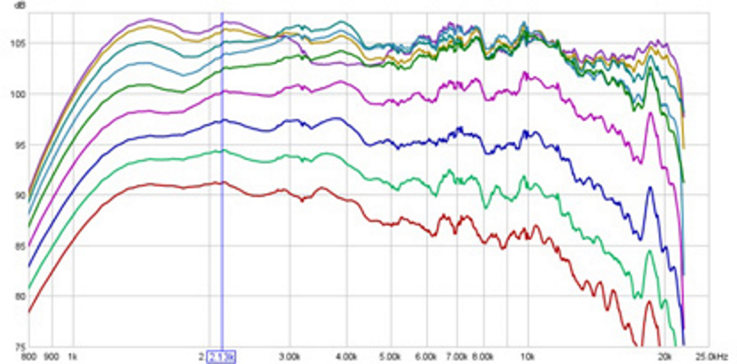

Some additional data of those fullrange 2-ways, shown in #5036:
- 70 degree -6db controlled dispersion modified oblate spheroid waveguide (The "mod" appears to be a LeCleac'h roundover).
- 12 (low mechanical Q) + 1"
- Crossover, presumably between 1500 and 2000Hz.
Quite remarkably, they even published an unsmoothed plot of the waveguide.
"The plots on the right are measurements of just the waveguide, after minimal Eq, we can see we have amazing control off axis in the top range (beyond 20k), each line apart from the first, represents 7.5 degree off axis incriments. So the purple line hovering around 100dB is 37.5 degrees off axis, and just before here we can see at around 35 degree off axis (the -6dB point) it starts to loose control albeit fairly evenly... which is perfect as we wanted a 70 degree guide."
