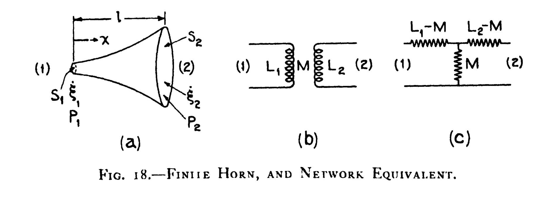

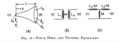

Largely forgotten and overlooked independent research of exponential horns at Bell Labs, 1924.
The method of applying the theory of electrical networks to the horn, as used is due to P. B. Flanders and D. A. Quarles of the Bell Telephone Laboratories. The advantages of the method will be evident, if a comparison is made between the present text (1924!), and the treatment of the horn by A. G. Webster.
Horns have been extensively studied by P. B. Flanders, from whose most important memorandum the following quotation is taken, for the purpose of summarizing this article. The statement bears on the application of a horn to the short tube leading from the loud-speaking receiver diaphragm.
"Neglecting reflection effects, the addition of a horn does not effect an increase in the ultimate impedance at the end of a receiver opening. It does, however, cause that impedance to reach its ultimate value at a lower frequency; and the lower that frequency, the better, of course is the horn. The impedance "looking out" of a seven-tenths inch hole in an infinite wall reaches 80 per cent of its ultimate value at 9300 c.p.s.; a certain conical horn causes this 80 per cent value to be reached at 4200 c.p.s.; while the corresponding exponential horn causes this value to be reached at the relatively low frequency of 250 c.p.s. In a way these figures show why the exponential horn is so much superior to the conical type."
...The theoretical discrepancy is doubtless greater than that which would be observed in any practical case, because the wave front emerging from the large end of the horn can hardly be strictly plane; it is much more likely to be convex. And it may be noted that the smaller value for Y' as compared with Y at low frequencies happens to be more nearly in agreement with the smaller end correction for an unflanged tube (as compared with a flanged tube) which was noted by Rayleigh...
...There are many interesting problems in connection with horns, such as, for example, the directive effects in the radiation after it emerges from the mouth; the effects of dissipation; the effects of phase change, etc. It appears that some of the effects obtained with horns require considerable experimental study in order to elucidate them; unfortunately no discussion of these can be given, for lack of suitable data (which might have been available at Bell Labs, but was never published).

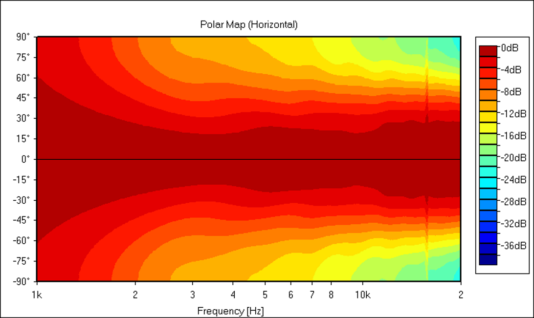

Directivity is somewhat negated by size, the wider the horn mouth, the larger range of frequencies it will direct. So there is no battle between the "loading" horn and the "directive" horn. People suggest that Salmon horns have no "Directivity Control" but thats a lie, it just doesn't "control" the directivity in a way that they find favorable, hence your confusion. A constant diretivity horn thats 15" a-round has the directive control over the same bandwidth as a Tractrix of the same diameter, generally speaking. What they do with the bandwidth within that range, is not the same.
Directivity Kolbrek style:

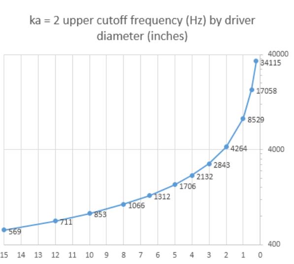

Oh, one last comment...with whatever size horn you use, you might want to use the ka=2 guide, for matching cone directivities ...
I'm gonna use it if I decide to build another different size syn horn
