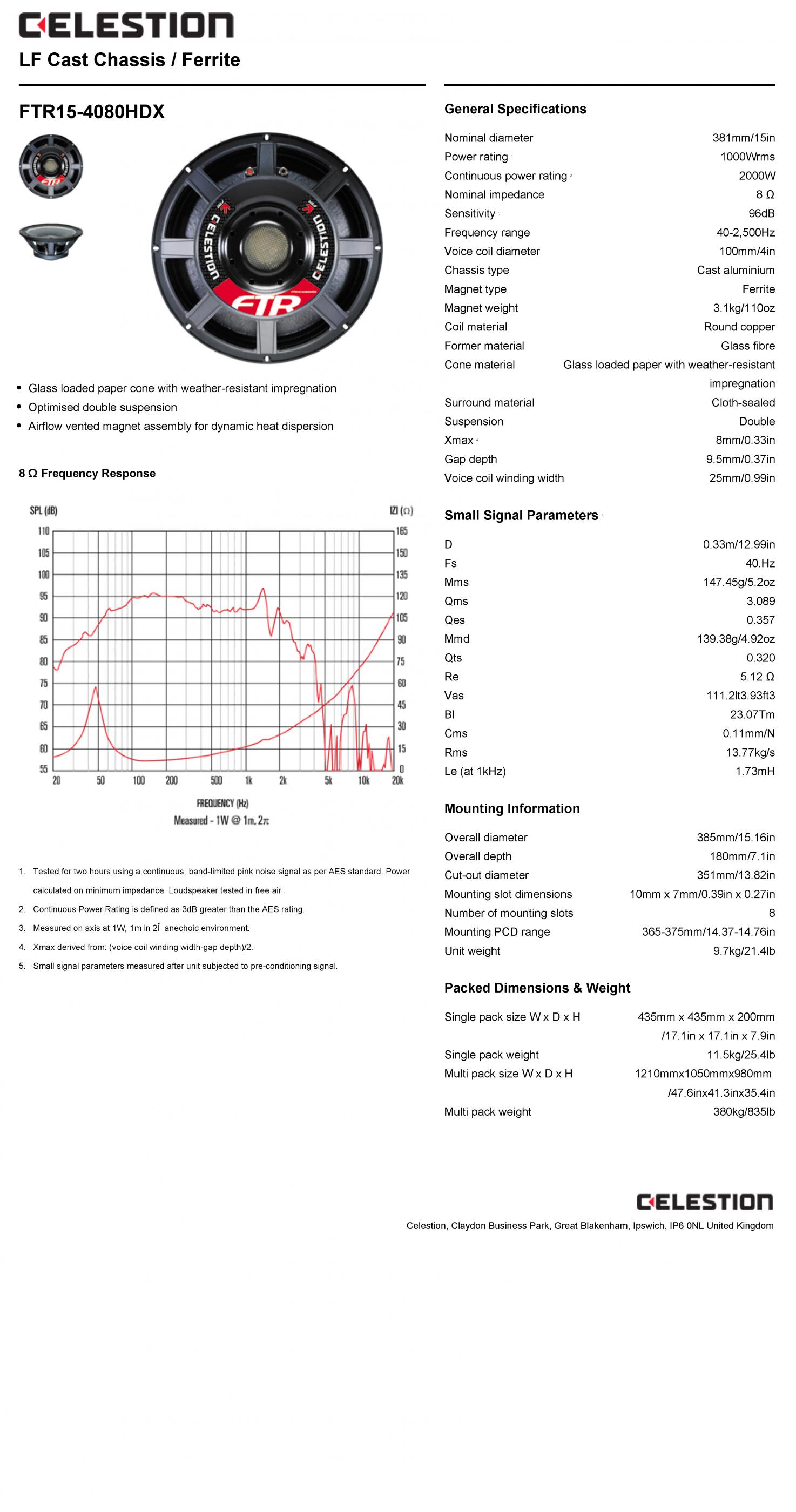

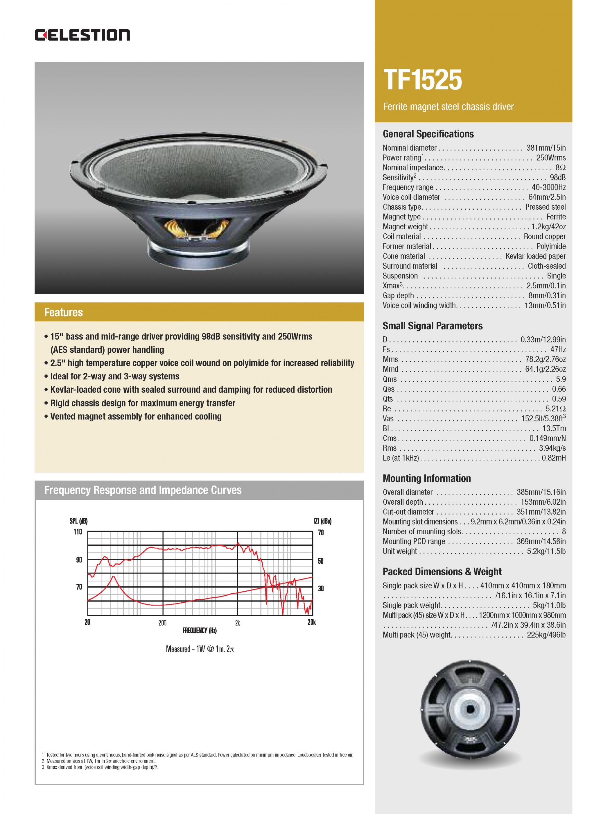

Let's just put our conceptions to a virtual test.
We both like Celestion drivers.
So let's build 2 virtual all-Celestion 2-way cabinets.
Horn: H1-9040P
Comp. driver: CDX1-1747
We'll pick 2 different 15" drivers:
- TF1525, a basic and cheap midwoofer with a stamped steel chassis.
- FTR15-4080HDX, the top of the line 15" woofer.
We use both drivers in 2 separate, optimized 2-way cabs with the horn integrated in the baffle. The XO is 1200Hz, the lower usable limit for the CDX1-1747 at which distortion figures will remain within the 'comfort zone'.
After finishing the cabs we'll have a panel evaluate both. I bet very few, if any, members would prefer the midrange of the FTR15-4080HDX loaded cab.
A glance at the specsheets shows why.
