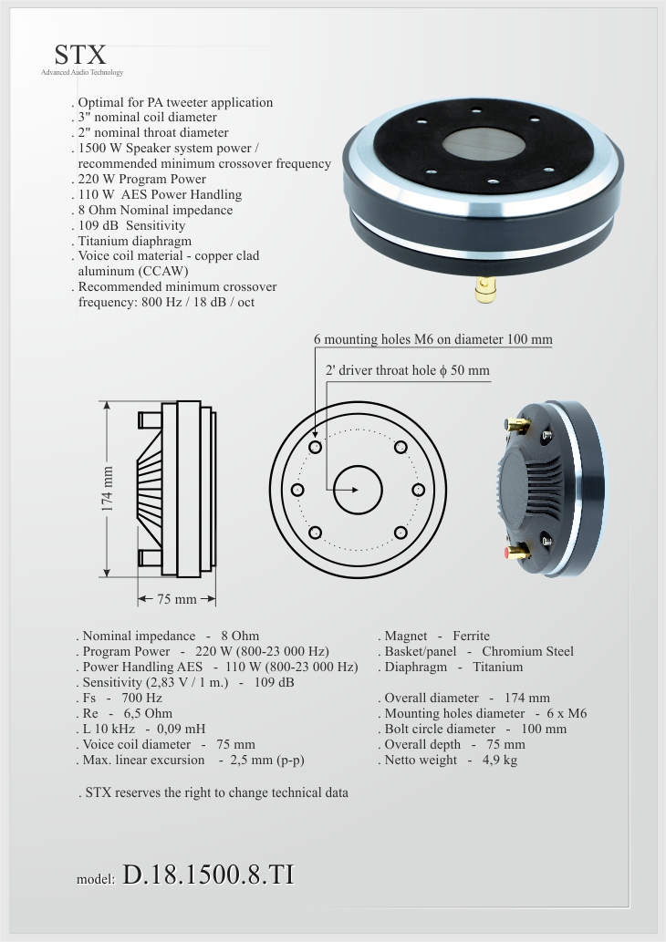

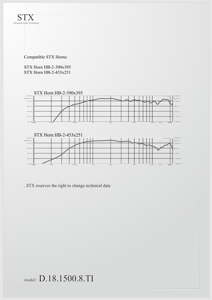

Sensitivity of a compression driver is very misleading. That's because of how they test it (various methods.)
In my NS-15, the only compression driver in B&Cs lineup that could come up to the sensitivity of the woofer (15NBX100) at 10 kHz was a de250. This is always true on a constant directivity device because the radiated power, i.e. sensitivity, is covering a much wider area than a directive horn, i.e. the SPL has to fall at the high frequency end. So, you see, there is sensitivity to burn for a powerful woofer when matched with a true CD device.

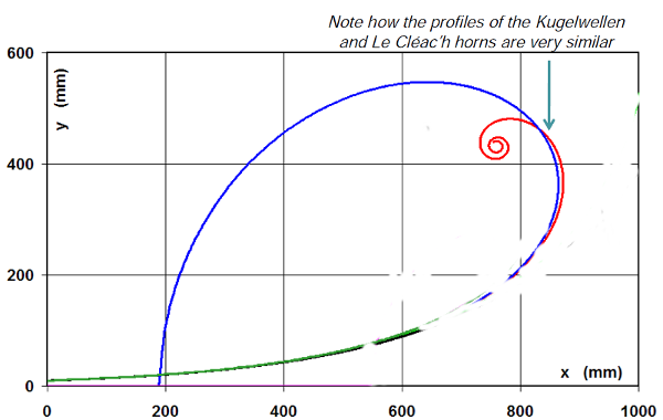

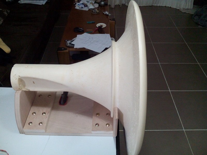

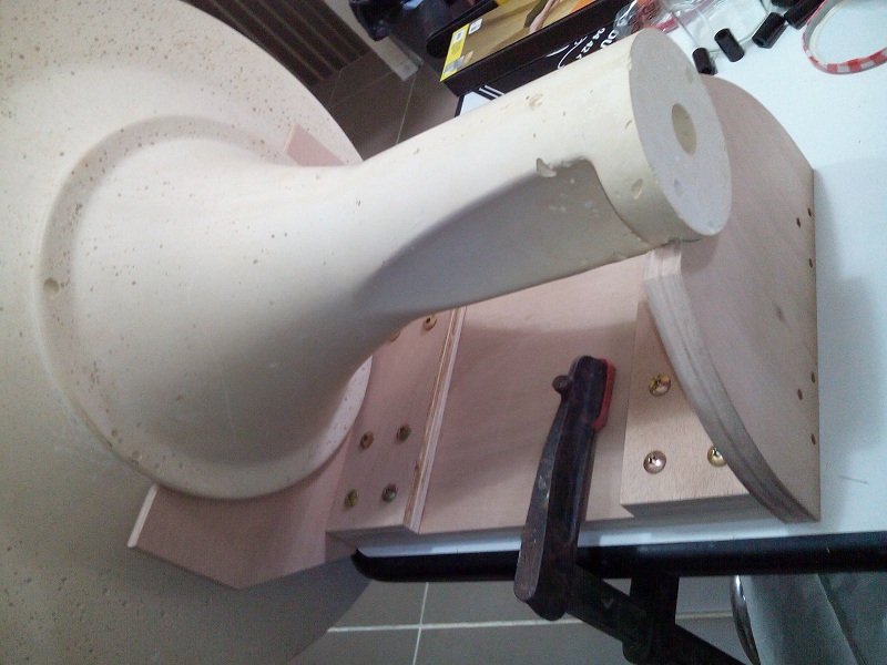

Your horn looks similar to the Marco Henry Musique Concrète J321 by Le Cléac'h, except for the throat size and the roll back at the mouth.
I believe it was this horn that Jean-Michel used (with a TAD TD2001).
...made of Gypsum plaster:

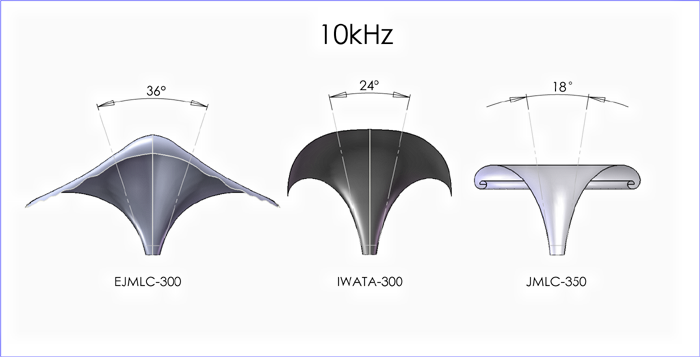

As with all things there are always trade-offs.....you gain constant directivity only to lose signal quality in the area of the frequency response accuracy. Yeah you can eq flat again but as I said earlier, additive eq is not a friend of signal quality and ultimately the less eq the better.....with constant directivity you gain more room interaction.....the room is a huge source of distortion....and the next best thing after a really nicely treated room is......no room....per say.
Comment by Jean Michel (horribly translated/edited):
"Autotech manufactures 3 ranges of horns designed by me:
1) Axisymmetric horns (ie "round" horns named JMLC with diff models) with cut-off frequencies (from 200Hz to 1400Hz depending on the diameter)
2) two Iwata inspired horns, fully curved surface that should be called Iwata-JMLC, with 300Hz and 600Hz cutoff frequencies.
3) different models of horns named E-JMLC, horizontal directional control which cutoff frequencies range from 300Hz to 2000Hz.
The expansion of the area of the wave fronts as a function of the distance to the throat is in all cases hypex with T varying from one model to the other of 0.5 to 0, 7. This means that all these horns provide a quasi-responsive acoustic load to the driver up to a frequency very close to its acoustic cut-off.
All these horns show very little diffraction at the mouth and very little reflection from the mouth to the throat. None shows the sound of bad horns ("honkness").
From the point of view of the angle of the listening zone, the JMLC horn is more directional than Iwata-JMLC and E-JMLC. Basically we can say that for the same frequency of acoustic cut-off, for example 300Hz, the opening angle of the listening area is 18° for the round JMLC horn, 24° for Iwata-Jmlc and 36° for E-JMLC. All these horns have an axial response that stretches high and, in general, do not need a tweeter. However a slight equalization is sometimes necessary with some compression drivers, especially with the Iwata-JMLC.
Sincerely, Jean-Michel Le Cleac'h"

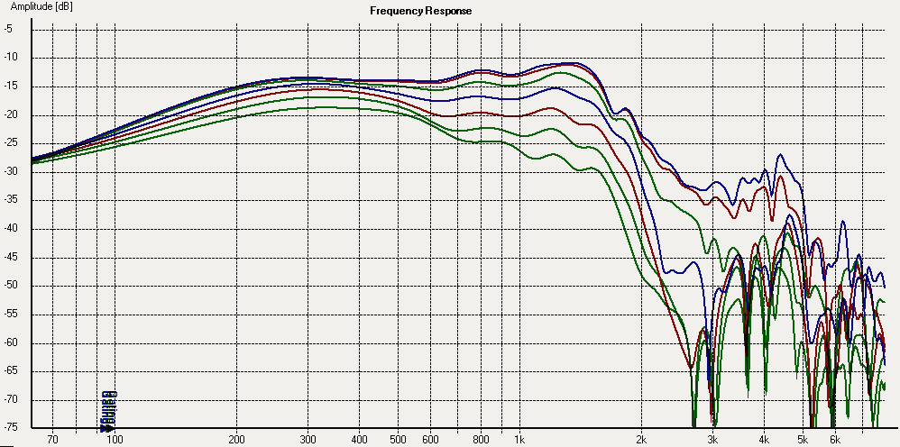

I can't find the 15TBX100 anymore but found my measurement of the raw 12TBX100. This is almost perfect, IMO. What more would anyone want? Of course the crossover won't be easy and no textbook filters will do it, but they never do, the less with these kinds of designs with horns. If someone claims that you need low moving mass for high quality midrange I would ask how do they know. For me it's just so obvious that it doesn't really matter that I can't imagine to be otherwise. Lighter membranes typically just store more energy (i.e. they resonate/ring) at the midrange. Why would anyone consider it better? 😕
