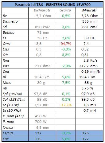

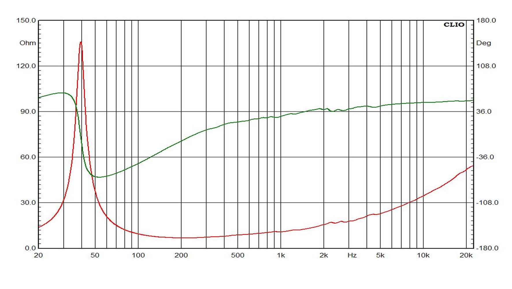

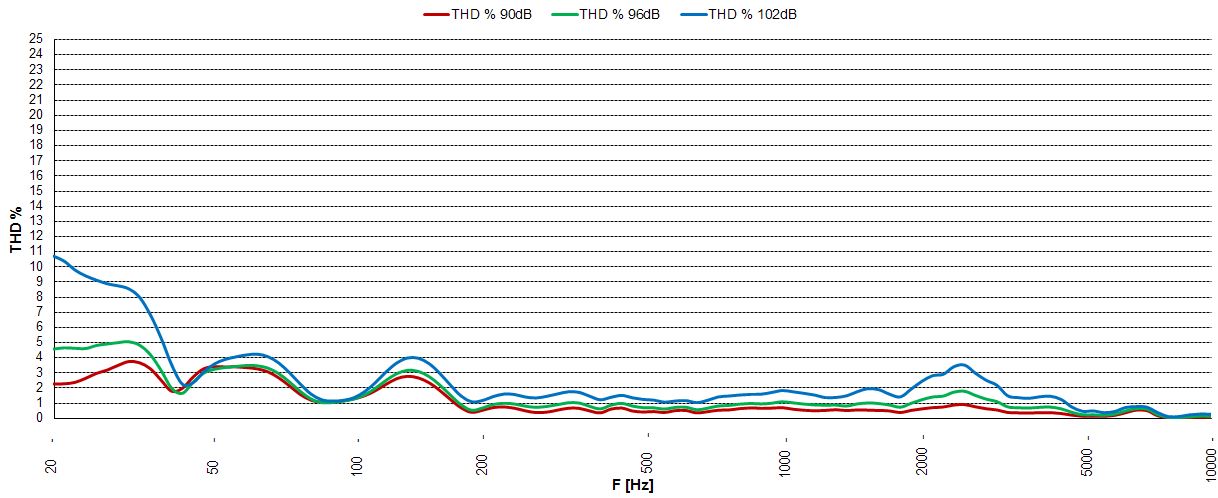

Another light cone, which actually shows the steep impedance peak in real life (that Tony Gee referred to):
