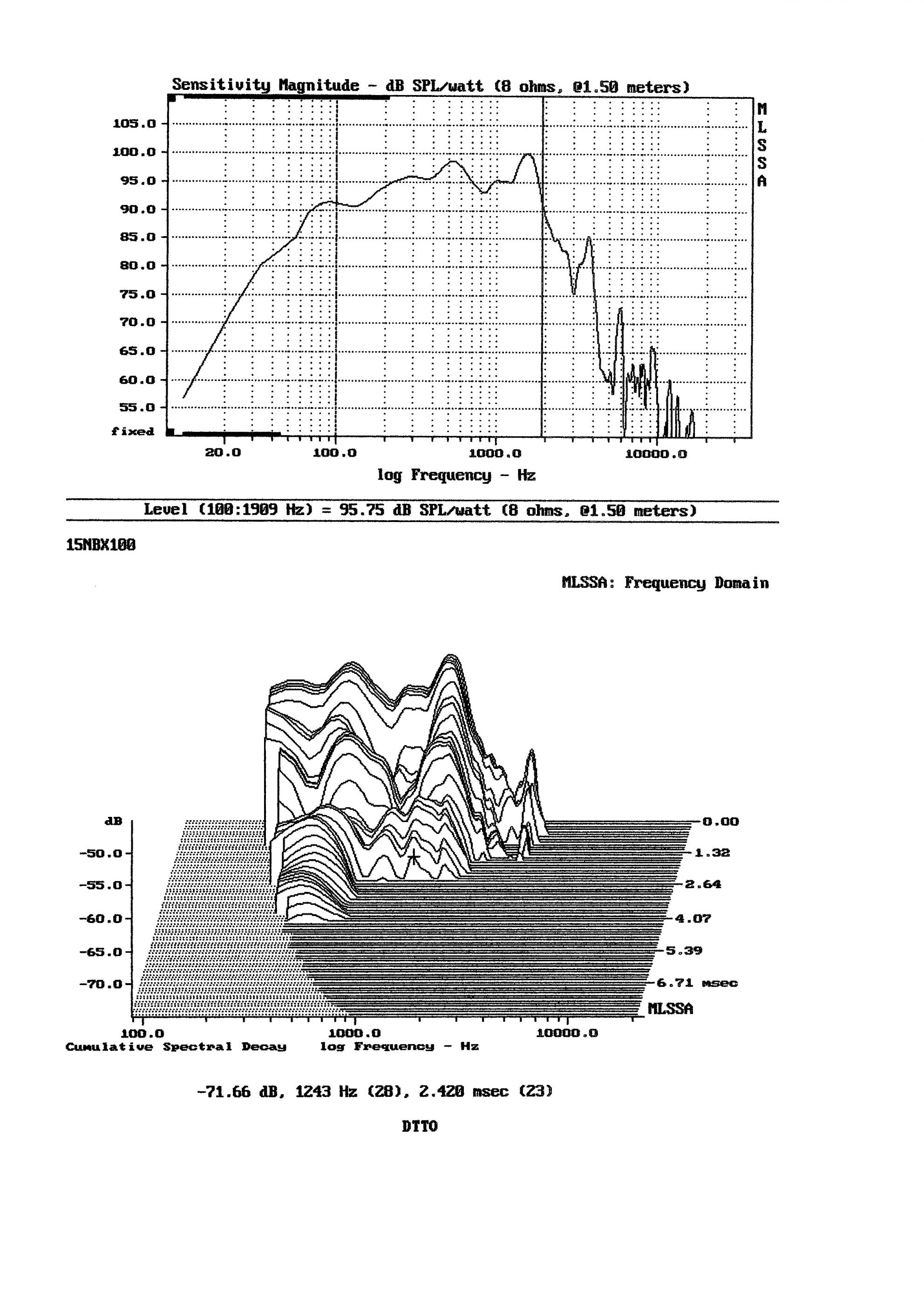

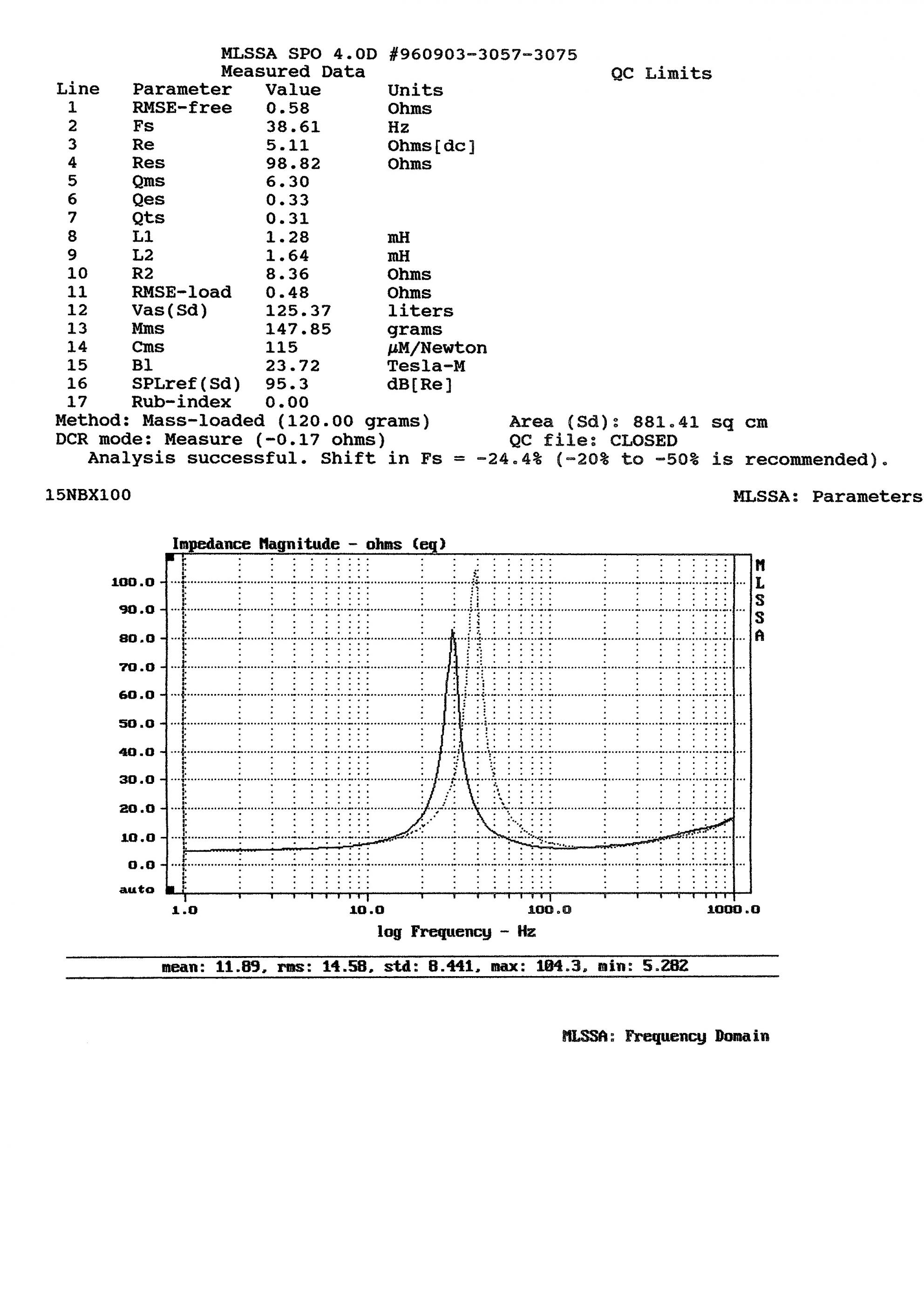

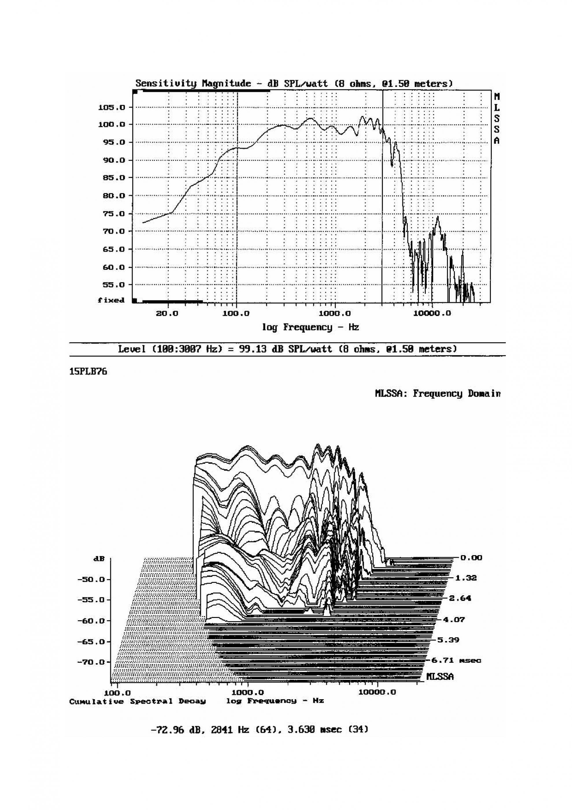

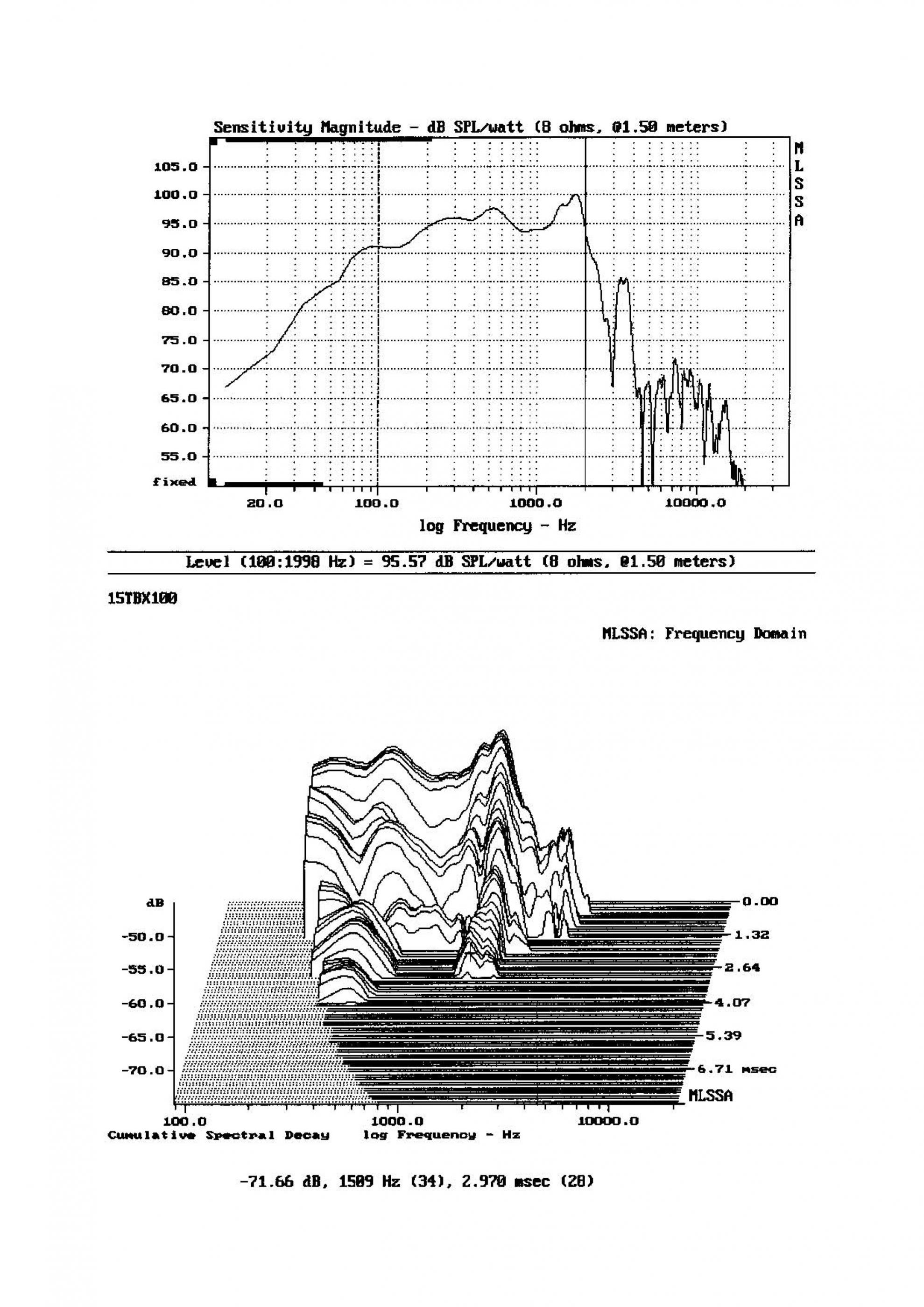

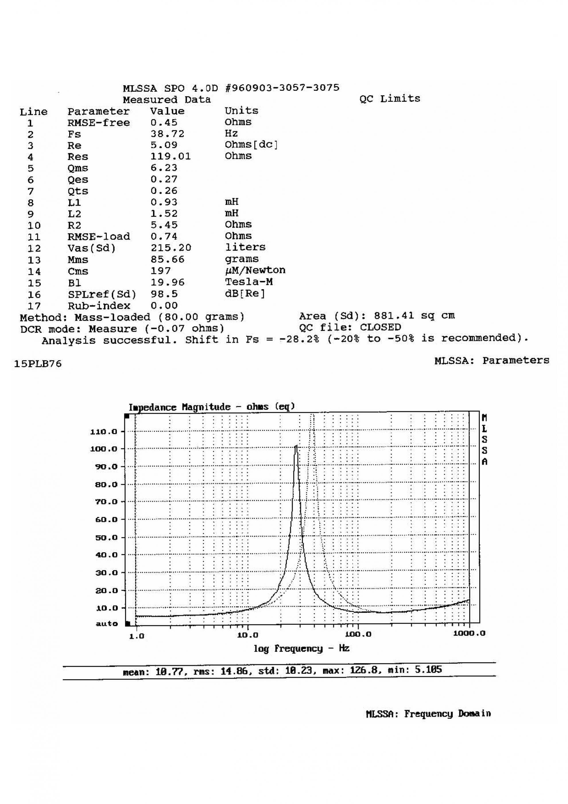

It's true, the TBX100 and NBX100 clearly beat the PLB76 wrt resonances.
1 & 2: 15TBX100
3 & 4: 15NBX100
5 & 6: 15PLB76
1 & 2: 15TBX100
3 & 4: 15NBX100
5 & 6: 15PLB76
It's not 'better', but we're in for a bit of surprise.
While poking around in measurement data, it - once again - becomes clear B&C factory specs are quite reliable.
No, it isn't 🙂

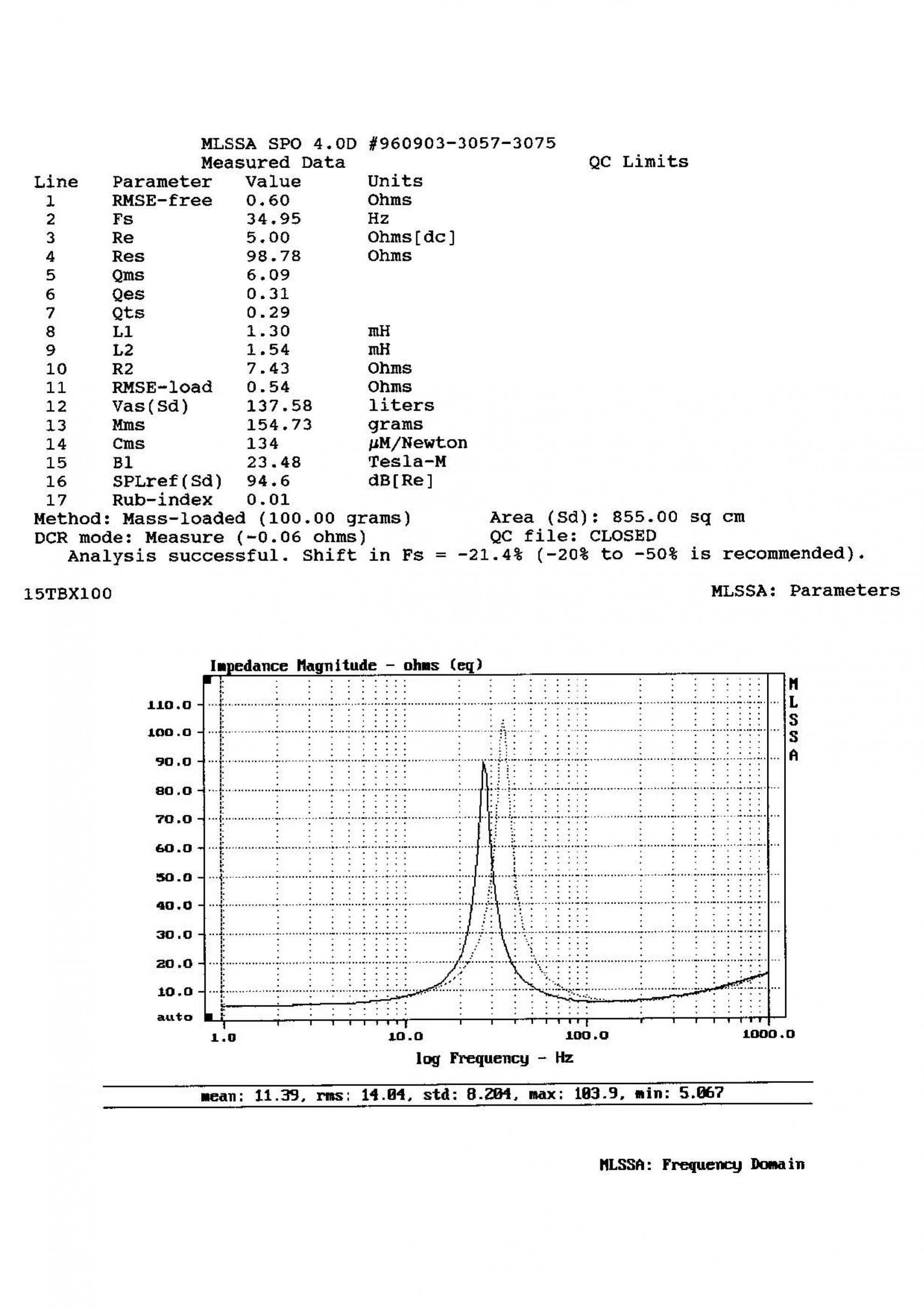

15TBX100:
voice coil:4"=100mm
MMS:>150gr

I'd like to see a comparison where the sound pressure level is matched, and there is a much higher resolution waterfall plot to see energy storage in the drivers. The fact is that the 15PLB76 is more than a full 3 dB louder than the other two drivers as indicated on the measurement sheets. At 800 hz, 1 period is 1.25 msec. 600 hz, 1 period is 1.67 msec. What about group delay added from the plurality of filters to deal with the ugly native response, or the added 'sound' radiated from the cabinet. These are other maladities that need remedies when considering a 'system' with any of the drivers in question. 3 dB more amplifier needed for the same sound pressure will raise currents in the coil, and these must be dealt with by a lower distortion motor system.

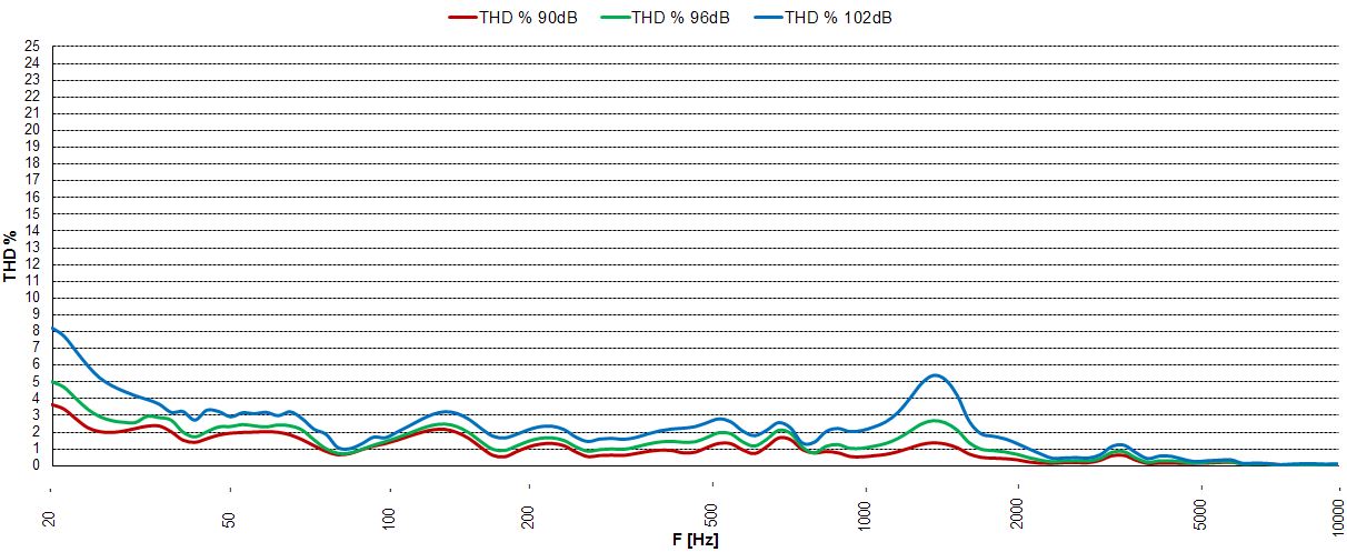

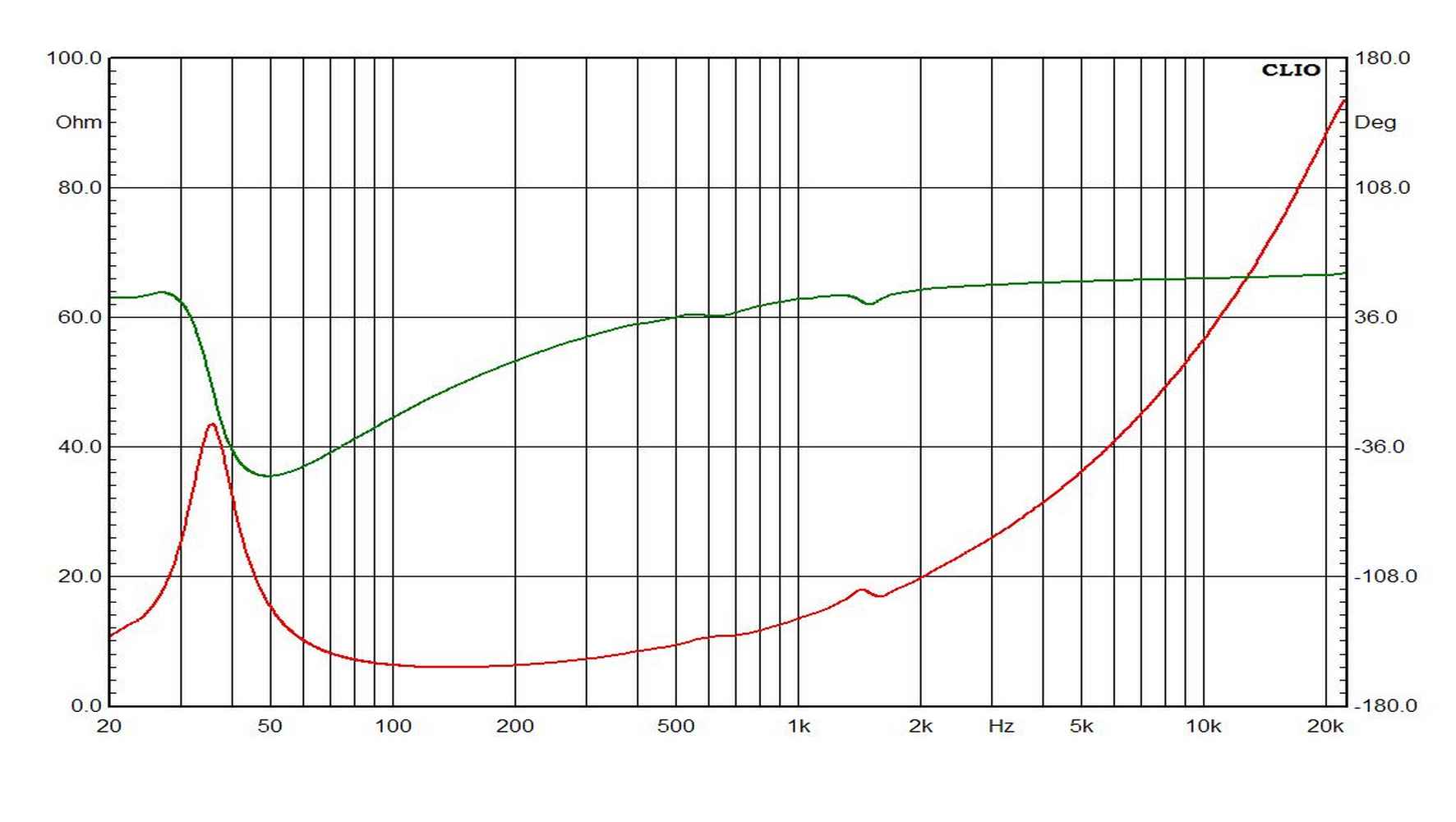

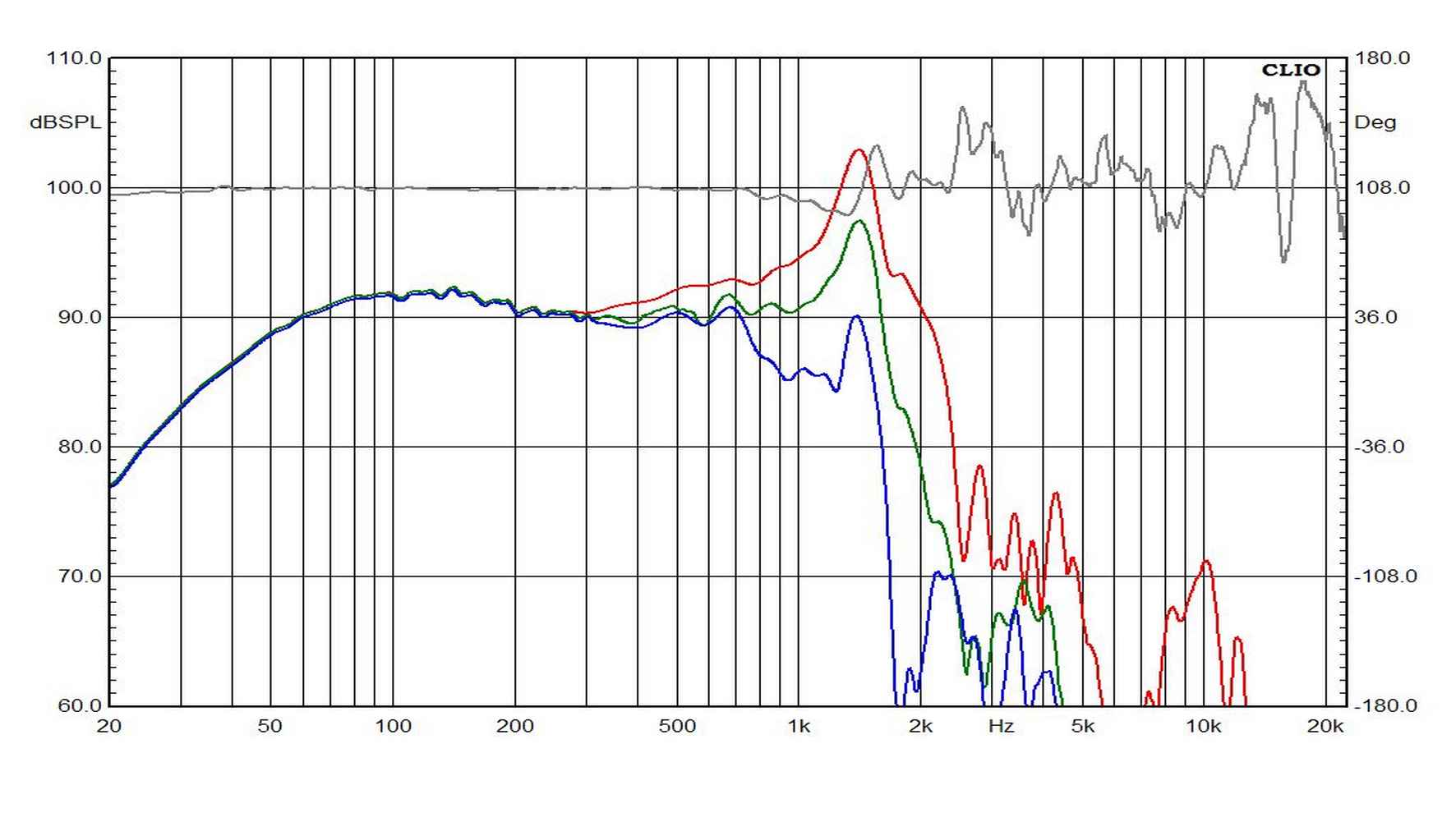

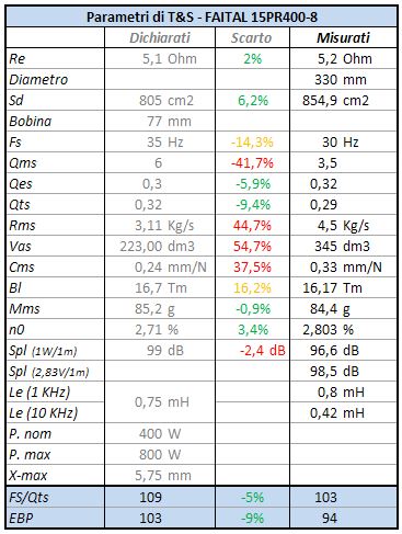

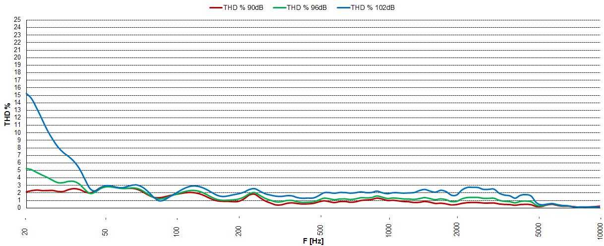

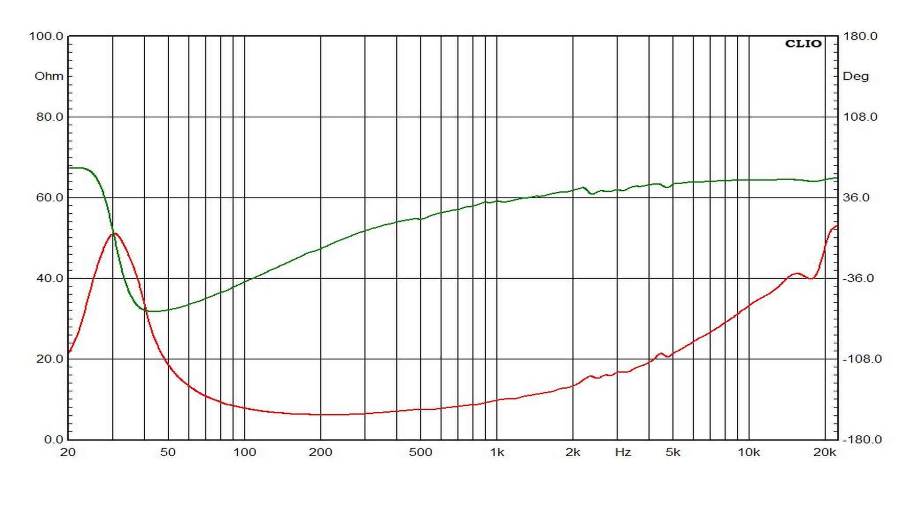

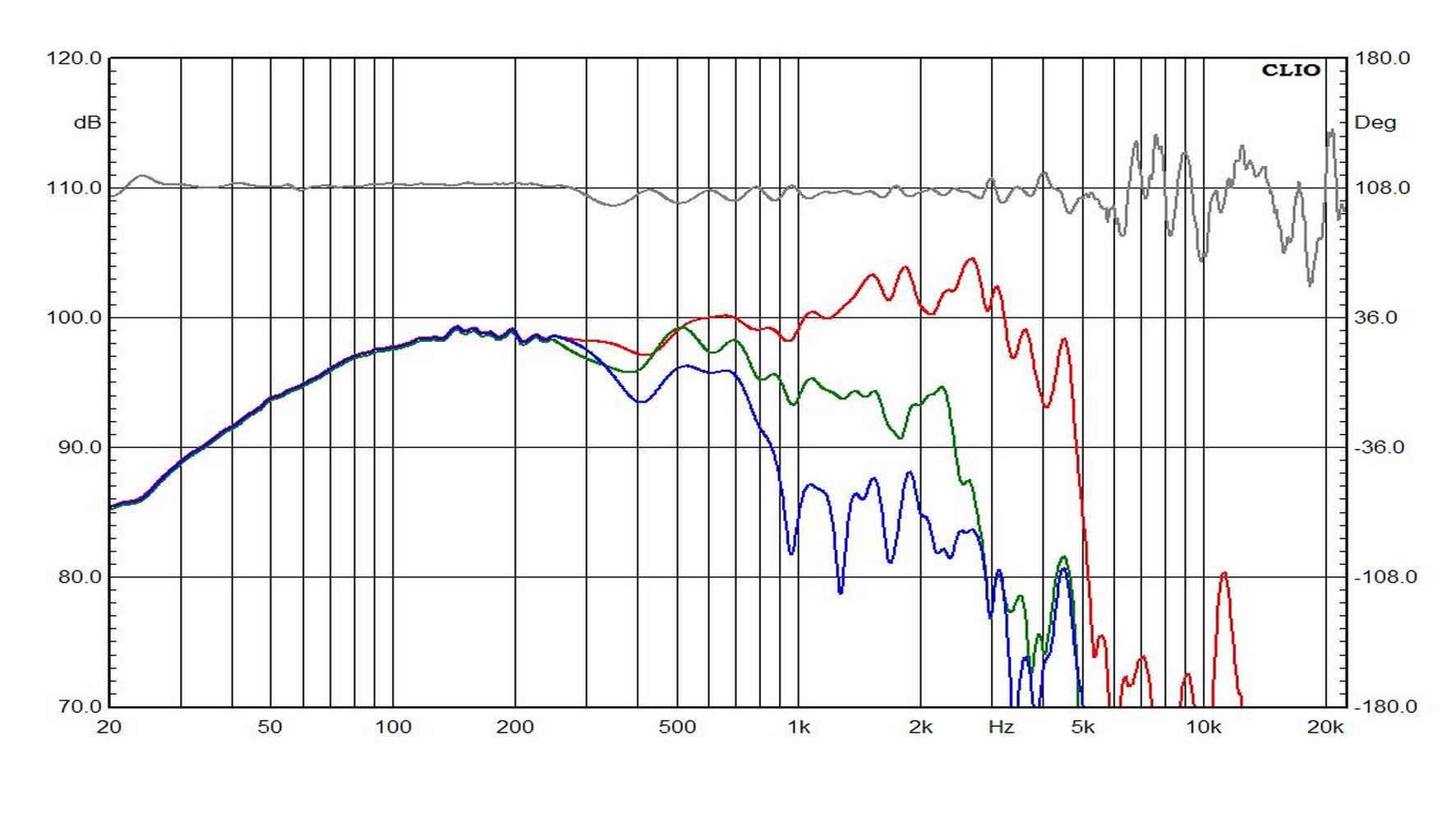

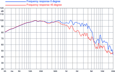

Here are some (independent) measurements of the FaitalPRO 15PR400.
Response, impedance, THD and interestingly: specified versus measured T&S parameters.

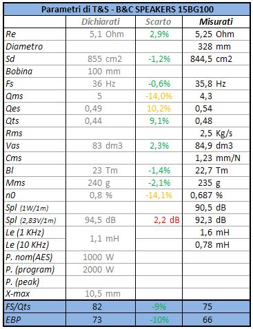

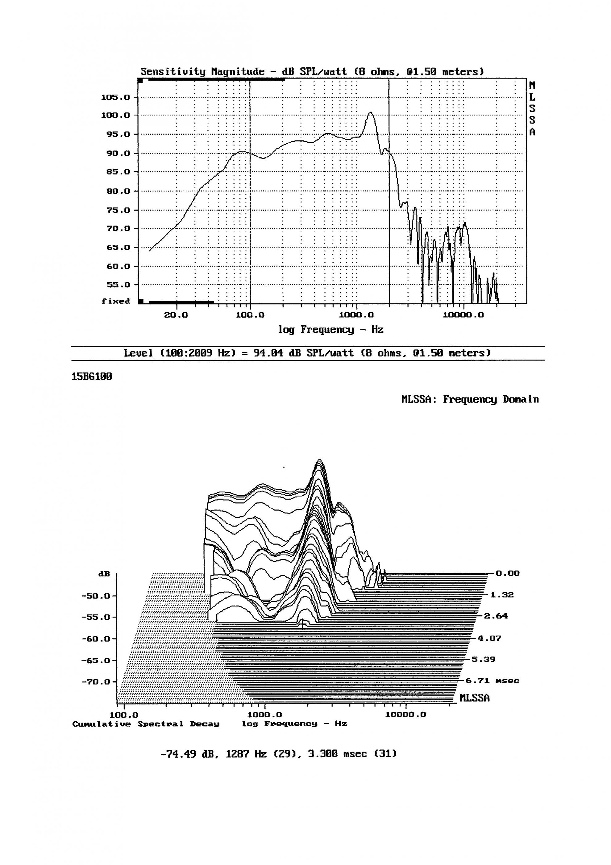

The same data of the B&C 15BG100 (as used by Vance Dickason):
I can't find the 15TBX100 anymore but found my measurement of the raw 12TBX100. This is almost perfect, IMO. What more would anyone want? Of course the crossover won't be easy and no textbook filters will do it, but they never do, the less with these kinds of designs with horns. If someone claims that you need low moving mass for high quality midrange I would ask how do they know. For me it's just so obvious that it doesn't really matter that I can't imagine to be otherwise. Lighter membranes typically just store more energy (i.e. they resonate/ring) at the midrange. Why would anyone consider it better? 😕
