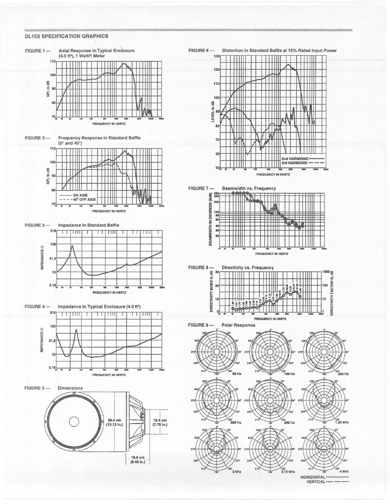

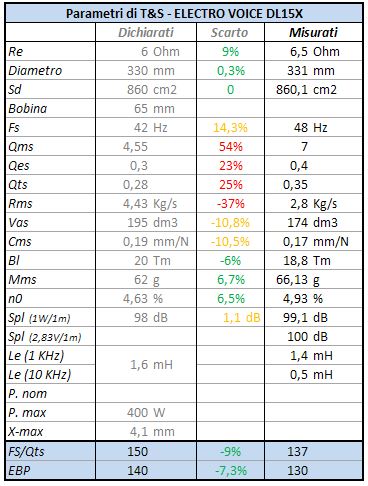

ELECTROVOICE DL15X: 4.682% (η₀)
Reference power calculated at ± 30% for an Xmax of ± 4.10 mm = 209 Watts. (146 to 299 Watts)

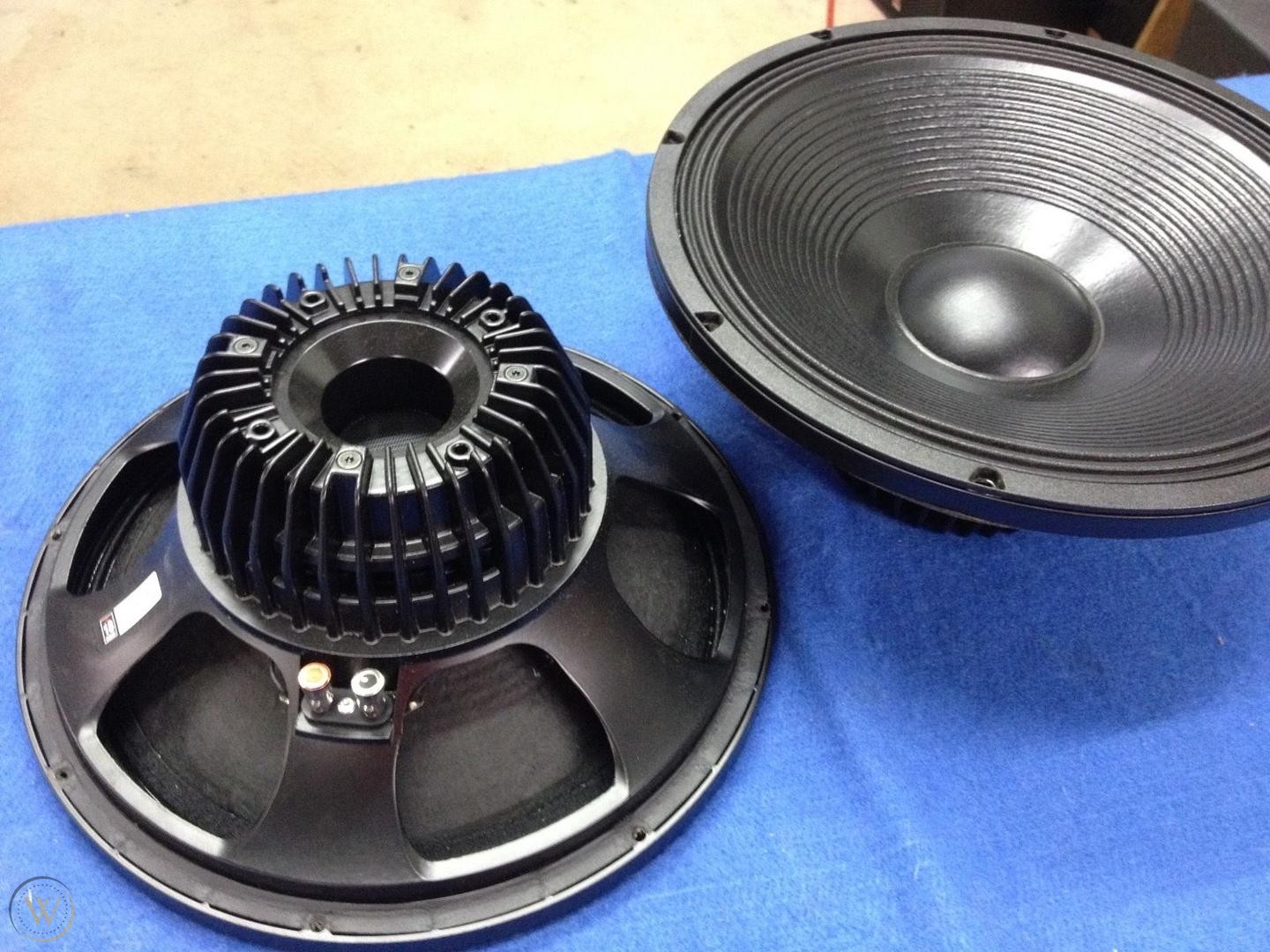

Having previous only used spherical shaped horns in the past for many years (Azurahorn JMLC, Goto unit horns, Auto-tech e-JMLC), been running the Faital Pro HF108R paired with PRV WG35-25-b 'waveguide' for past few days. Very good pairing (good balance of detail/refinement/extension) and no obvious downfalls I can hear so far from a non-spherical design. The HF108R does have a more 'delicate' sound compared to the HF107 units. Certainly a more suitable choice for domestic/near-field use.
Really impressed with Faital Pro products so far!
That's unquestionably one of the best 1" waveguides ever.

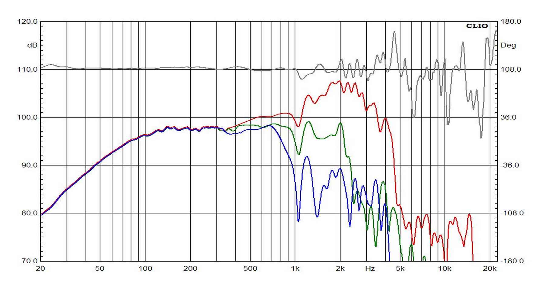

There are cone issues? starting at 300Hz which are not apparent in 15BG100...
I quote my own post as it probably got lost in the x fire�� And I mean FP 400 issues for clarification as it disappeared in the quote
I quote my own post as it probably got lost in the crossfire��
I do not know who did rhe measurement, but either faital nor troel gravesen found cone issues:
You refer to the ripple in the combined response, I guess ?
This is either cone/surround related, but it doesn't affect distortion figures, which are actually lower compared to the B&C 15BG100 in this region.
The ripple dissapears above 700/800Hz.
If you look at the plots of the 18Sound 15W700 posted on the same page, you'll notice it's exceptionally clean in this region, but the Faital beats it wrt distortion figures both in the lower as well in the upper part of the freq. range.
