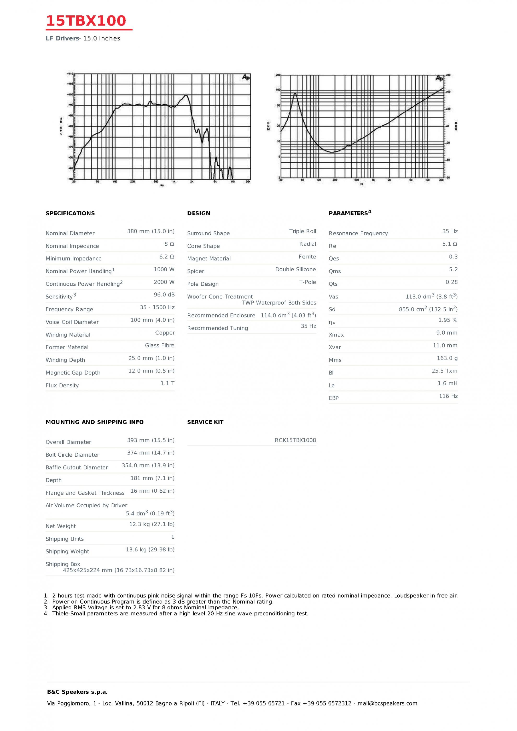

We know that lighter cones add efficiency, but they tend to "loose-it" faster and harder so they are hard to take up to 1 kHz. The heavier cone B&C are very well controlled in this region. And there is absolutely no way that one cannot use the frequency response at the high end of the woofer as part of the crossover. I don't like the low mass woofer cones.
Here we will have to agree to partly disagree, I guess.
The TBX100 is indeed well controlled up to 1000Hz, but the PLB76's extended bandwith provides additional leeway wrt the crossover.
While the TBX100 is better >500Hz than the BG100 (shown before), I would personally prefer the PLB76 to both.

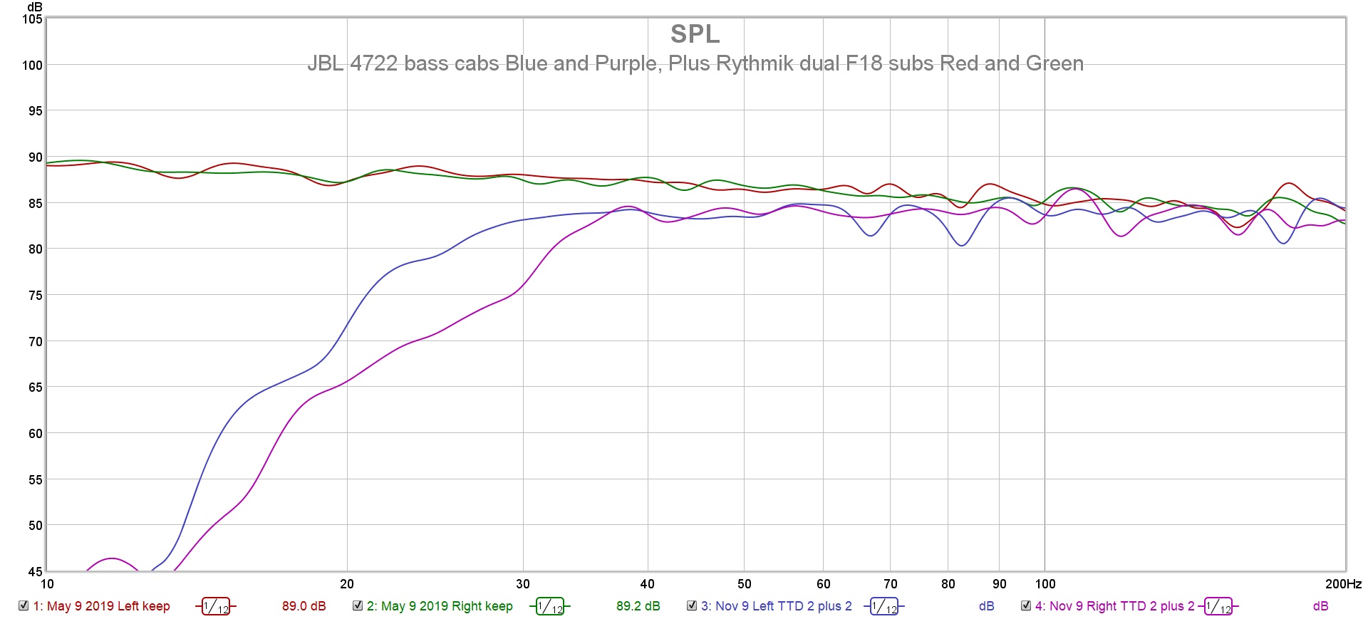

@camplo Some food for thought. The monster JBL cabs I have with the dual 15" are tuned to 40 Hz and with a little DSP can get a but lower, but not much being ported. Really stiff cones and some serious output - drums sound like drums when turned up - great transient output. I have an acoustic drum kit in the same room.
But the very bottom octave was missing and I thought to add a couple of subs. I went with dual Rythmik L12 entry level so if I did not like them, I could either sell them or pair them with my Kef LS50's in a 2nd system.
As it turns out, loved them. Added such weight to the sound that I decided to upgrade to a pair of F18's to keep up with the JBL ported bass cabs.

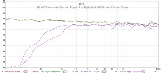

Here is the measured difference between the JBL bass cabs by themselves and then integrated with dual subs:
The only other 15" driver and cab combo I have seen in a 2 way that actually really makes it to 20 Hz is the JBL M2. Mind you there is quite a bit of eq on the production versions.
As mentioned in the link above, even Michael with the M2's opted for 4 subs. And since the release of the M2's JBL has added a companion sub for the M2's.
I know it is no longer a 2 way, but depending on the type of music you listen to and if you truly want 20 Hz to 20 kHz performance...

That's impressive Mitch!
The Red and Green extend to <10Hz???
In my country, the blue curve would suffice to shake the walls and terrorize the neighbours.

The TBX100 is obviously a well engineered woofer, with all the bells and whistles for HQ, high SPL PA use.
It does need some power to come to life though.
The PLB76's higher efficiency (and sensitivity) is a better match to low watt (high-end) amplifiers.

Yes, f3 is 6 Hz in my room. Can make the foundation shake. The measurement was taken at reference level ~83 dB SPL at the listening position some 3 meters away.
See CEA 2010 Max passing SPL: Rythmik Audio • 18" servo subwoofer F18
X 2 subs is more than enough for peak reference music level (not LFE) i.e. 105 dB SPL at 20 Hz, not including room gain. If I wanted more, I would have gone with the vented version, but in practice, this is more than enough for clean concert level at home.
