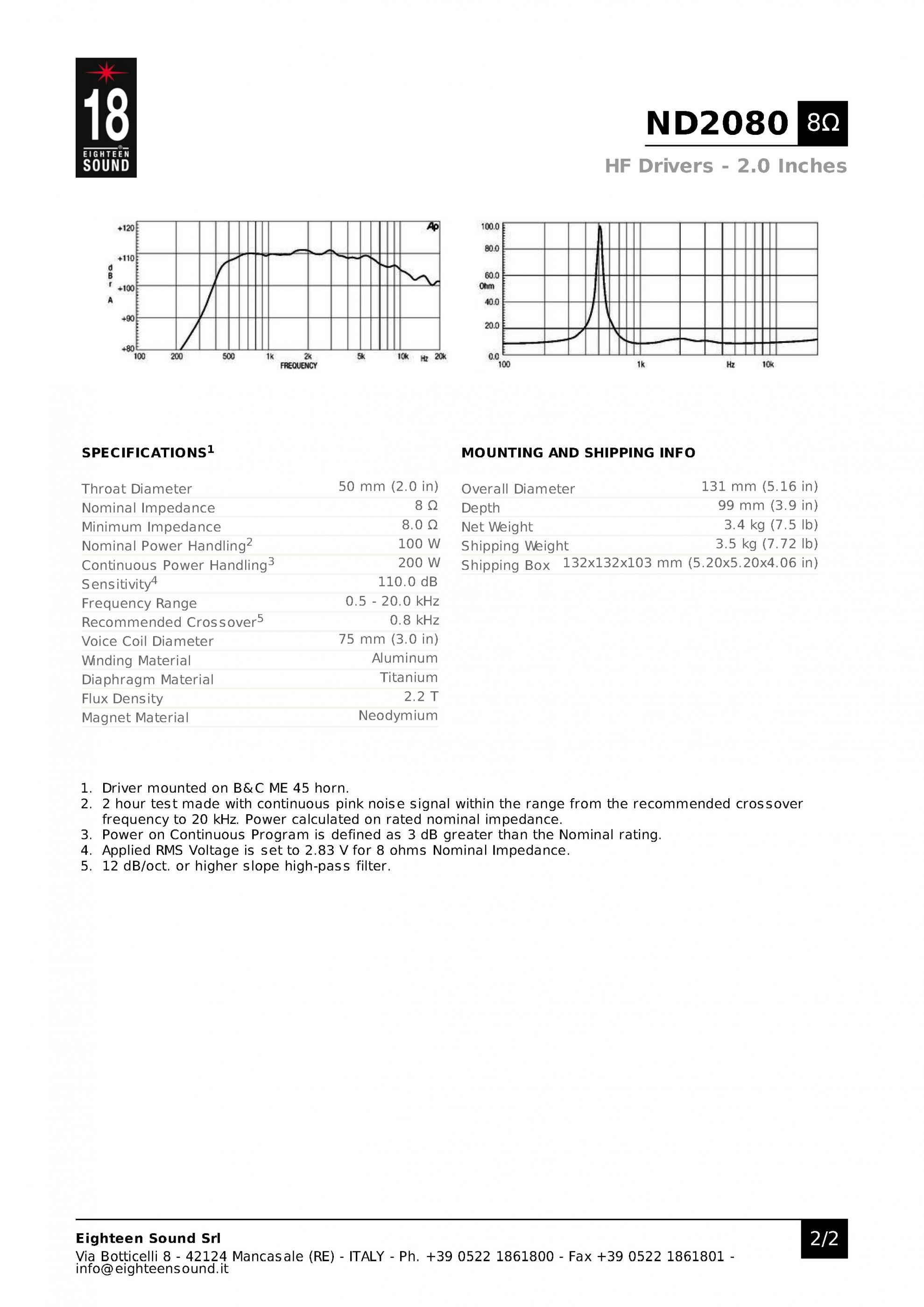

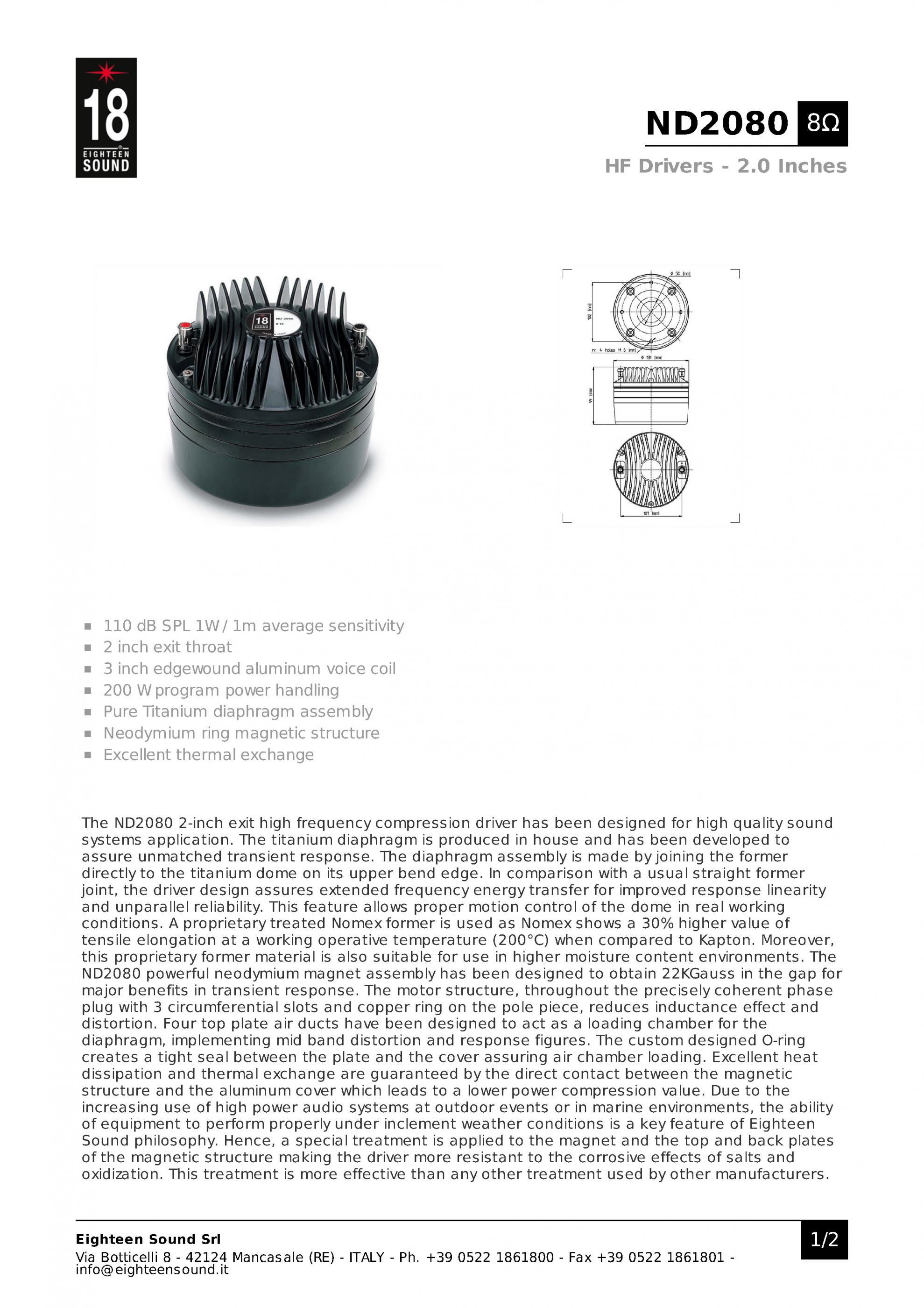

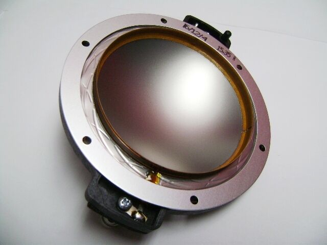

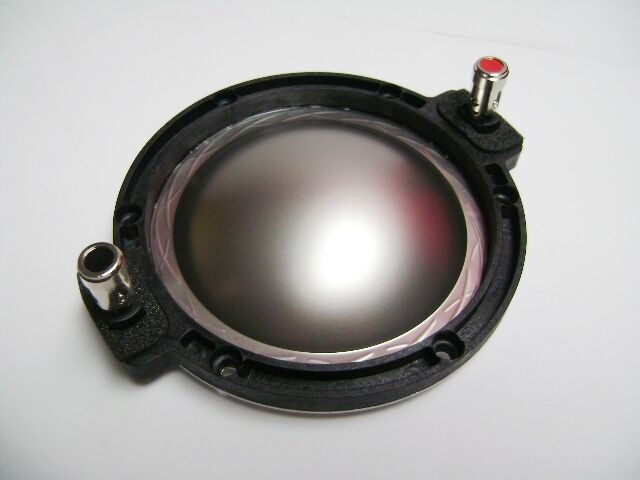

A few months ago, I was close to buying a pair of 18Sound ND2080s at 30% of the MSRP. This driver uses the same diaphragm as the ND2060A, ND1460 and ND1480.
It makes one wonder: why design a nice and expensive driver around a rather mediocre diaphragm?

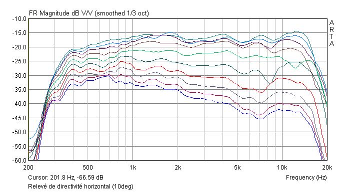

It's far from terrible though, judging from this measurement of a ND2080 behind a TAD TH4001.
Apparently 'battle proven', so why fix what ain't broke, especially in such a [now] competitive market?
