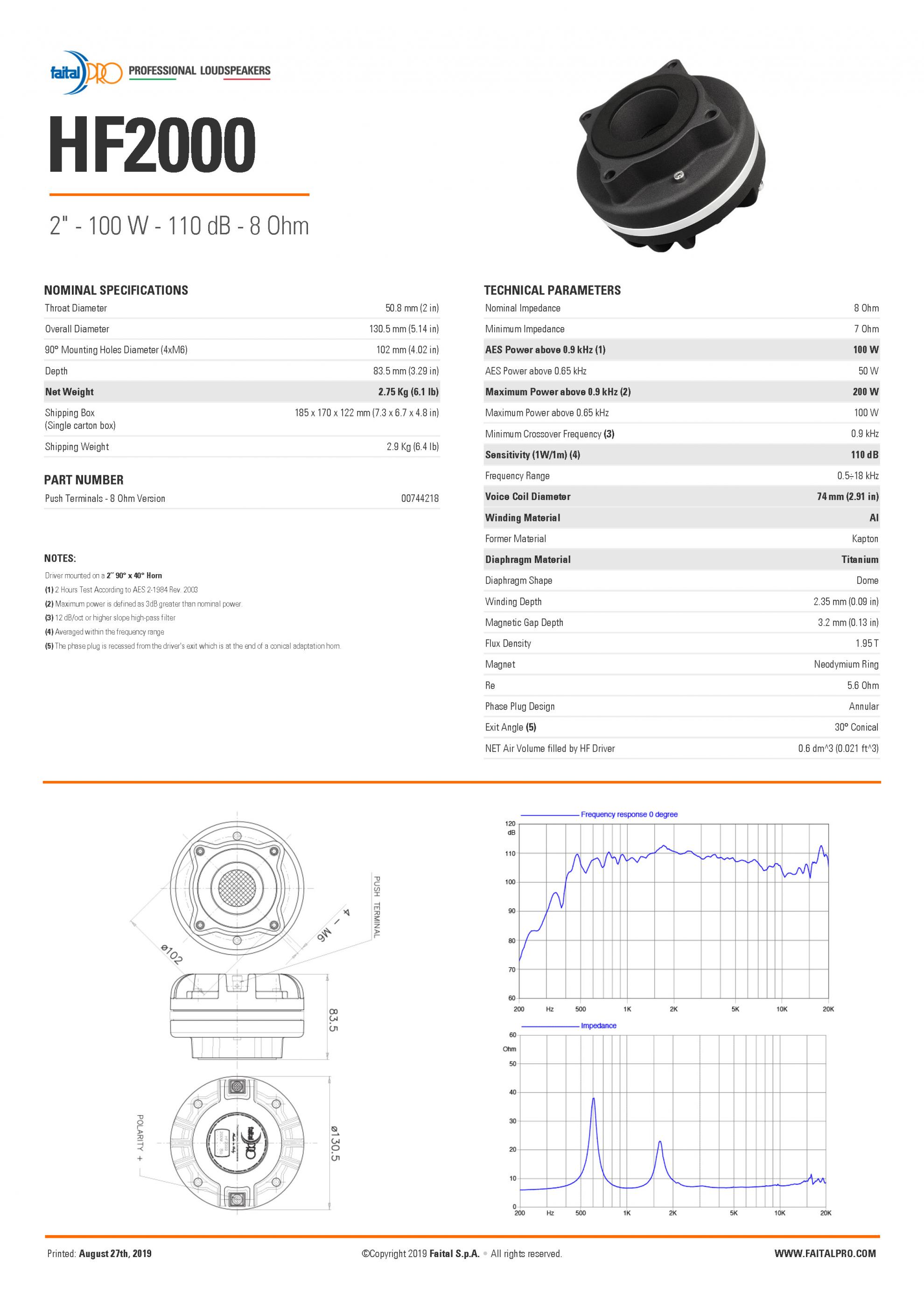

This one seems overlooked and why is it only one peak on the impedance measurement?

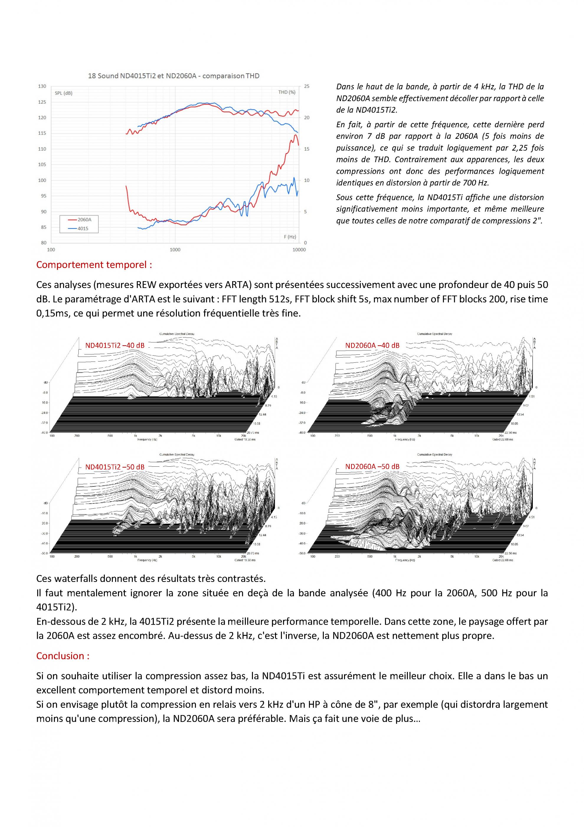

Waterfall/Distortion/impulse compared to ND4015Ti2 : Comparaison des compressions 18 Sound ND4015Ti2 et ND2060A.pdf
Conclusion: The ND4015Ti2 is much better suited to low XO points and would therefore also be preferred for a big 2-way.
In fact, it would be a waste of the drivers' qualities to use it in a 3-way.
Compared to the FaitalPROs it's quite expensive though.
WRT low frequency performance, the Faital 2" drivers beat the ND2060 by a margin.
The Faital 2" drivers beat the ND2060 by a margin.
'Which 2" Faital?

'Which 2" Faital?
Mostly the big ones (3" Titanium diaphragm), but the smaller 2.56" Ketone Polymer diaphragms are not far behind.
Duh, got a senile moment about the impedance, never seen it on a data sheet for cd's.
