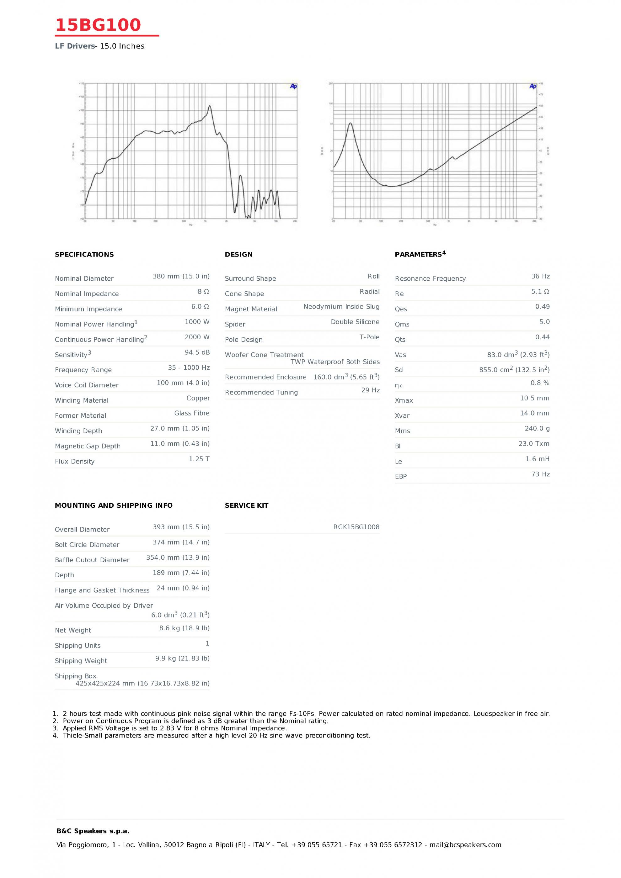

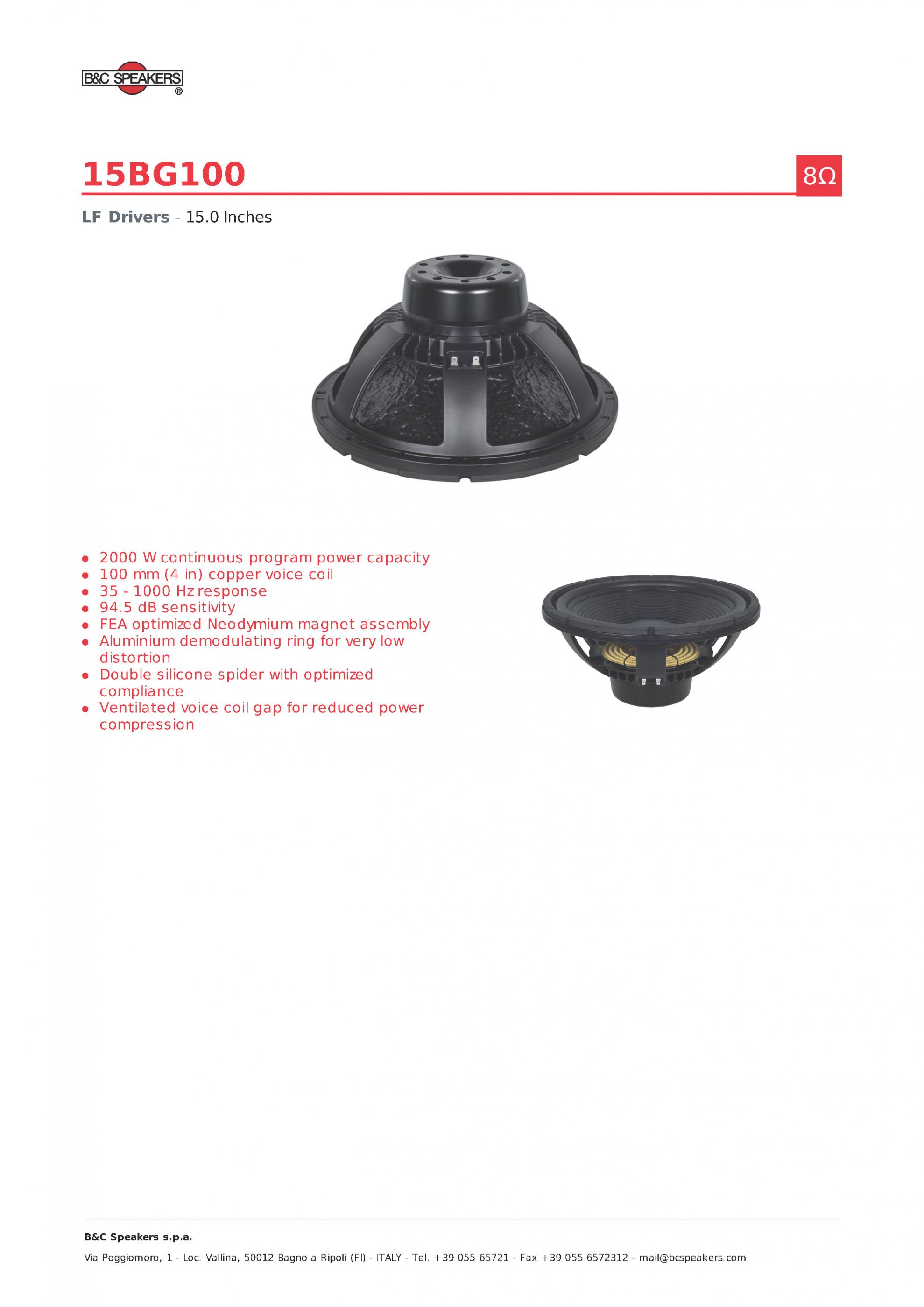

So let's take a closer look at Vance Dickason's far field monitor project.
Especially the woofer is a rather particular choice.
If you like energy storage, this is your driver!
Due to an ultra heavy cone (Mms: 240g !!!), sloppy NBR surround and subsequently a high compliance double spider, this driver needs a powerful motor structure.
It's a B&C, there are no doubts about the engineering of this "ScanSpeak HiFi woofer on steroids".
This driver is the opposite of what I consider sensible.
Because of this, it probably makes sense (again).
I couldn't find additional info on this far field project, so we'll have to guess.
One obvious clue is the designer, David Nelson of Triad loudspeakers.
If you check his website you'll find he's a proponent of sealed box designs.
In fact, I couldn't find any bas reflex design.
With this in mind and considering the B&C's 'physics', it's not surprising this driver is probably one of the best B&C 15" woofers for use in a SEALED cabinet.
IMO you'll have to be a closed box fetishist to use this driver and not really care about the midrange (where most of the music is).
Here's the paradox:

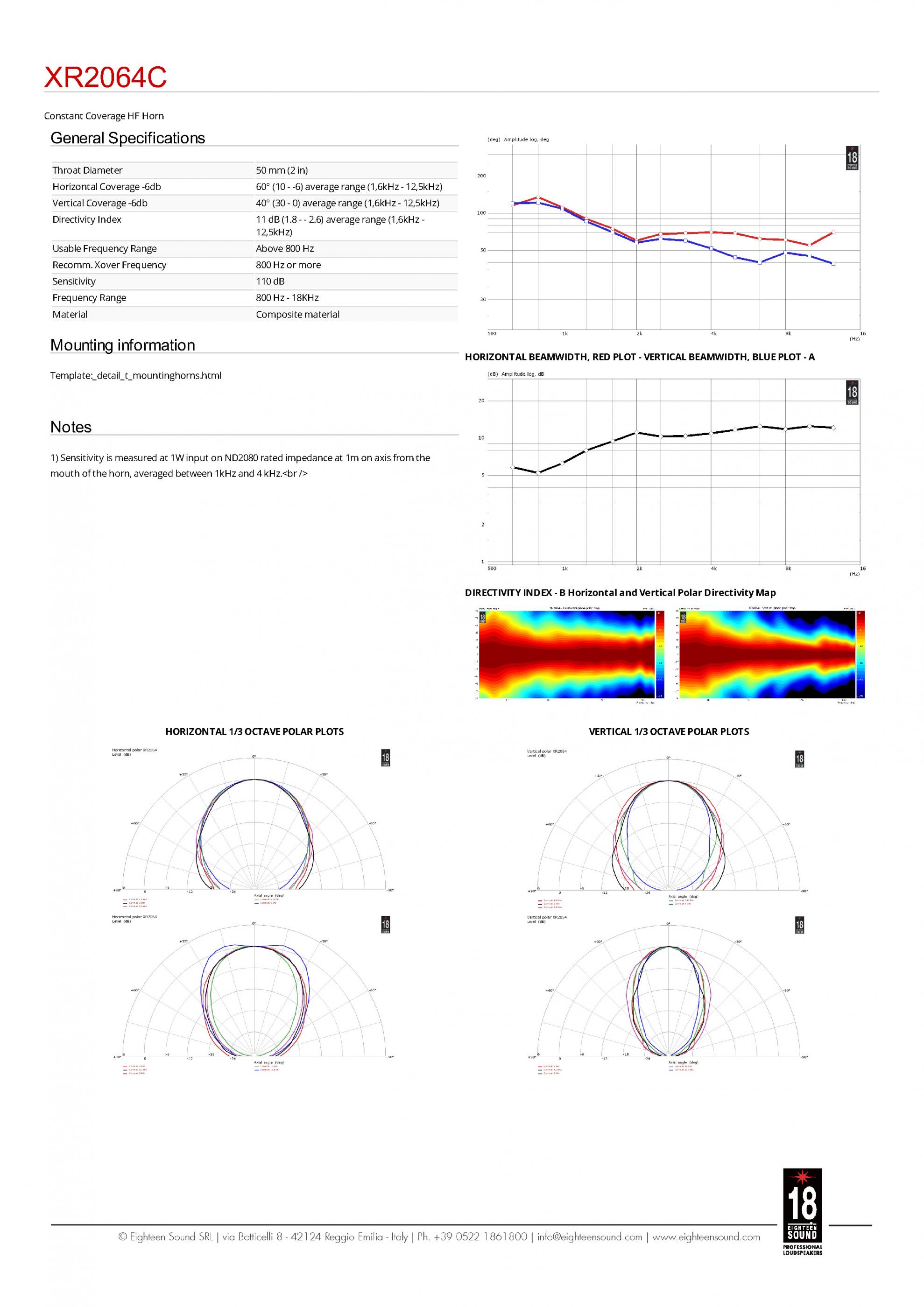

If you look at the response, the huge breakup spike at 1200Hz stands out.
Personally I wouldn't use this driver above 500Hz.

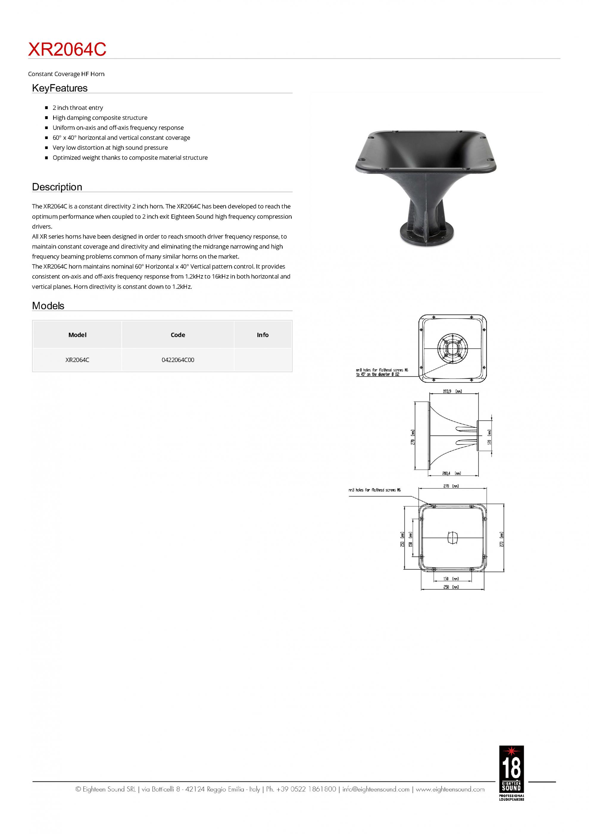

However, Mr. Dickason choose the XR2064C for horn duties. It's a nice horn, but not suitable for a crossover below 800Hz.
In order to make this combo work, you'll likely have to resort to 48dB slopes. I doubt the B&Cs midrange gets anywhere near the 15PR400's tranquility.
Finally, in box with some BSC applied, the B&C likely ends up with a sensitivity around 90dB.
Without doubt his monitor needs huge amounts of power in order to come to life.
Mr. Dickason is a knowledgable engineer, so his monitors will probably sound very nice in the end.
I wouldn't build a 2-way according to this design philosophy though. It's more akin to a scaled up typical HiFi 2-way.
In doing so, some of the merits of large highly efficient (low excursion) drivers are lost.

Here's the paradox:
Yeah, these huge peaks are out at the ~5th harmonic, so 36*2^5 = ~1152 Hz/12 dB = ~576 Hz/4th order plus parallel notch filter or 8th order to get close to the theoretical goal of > -25 dB, though considering its 'sprung like a buckboard' construction [tiny Vas] best suited for BLH apps, < ~288 Hz/4th order would be my choice and get a real mid bass [horn] driver.
GM

η0 is the reference, or power available efficiency of the driver in %:
(4 * Pi^2 / C^3 ) * (Fs^3 * VAS / Qes ) * 100
Which for the 15BG100 is: 0.768%
In comparison, the older 15PL40: 5.291%
It's apples and oranges though: a (sub)woofer versus an oldskool midwoofer.
