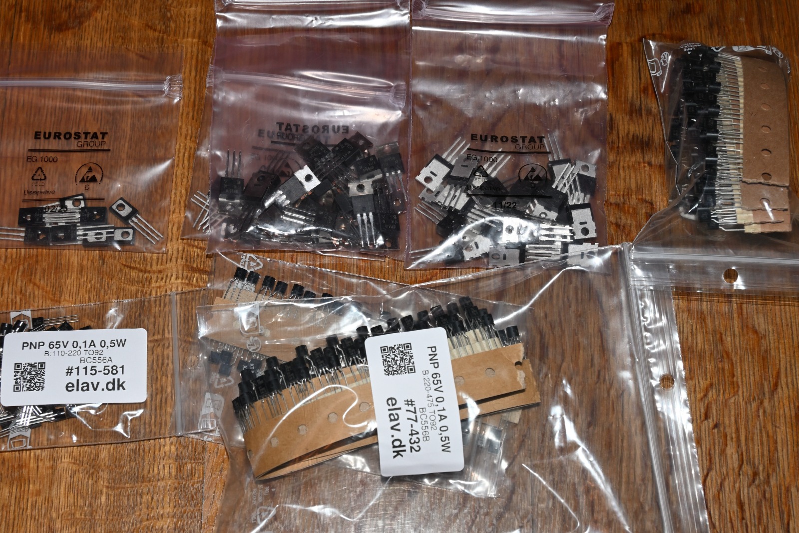

What I learned was that if the BC 5XX transistors sits on these paper rails the leg spacing is very wide.
I will get some of the "normal" next time I need components. Maybe for other projects in the future the "wide" leg spacing types can be used or for some "experiments" at the "kitchen table".

OK! .....it is probably good enough then.......I have not actual tried to fit it into the PCB layout.
I had a spare BC 546A with same small leg spacing as in the kit.......which I used for the repair.

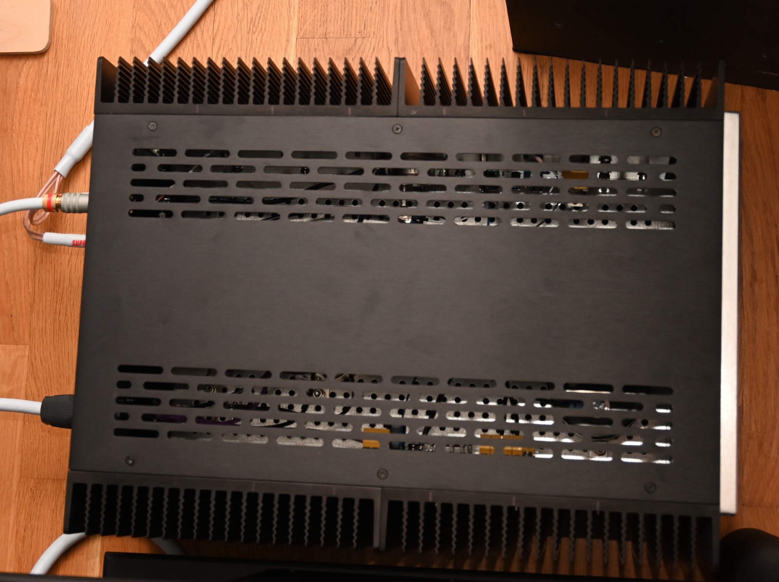

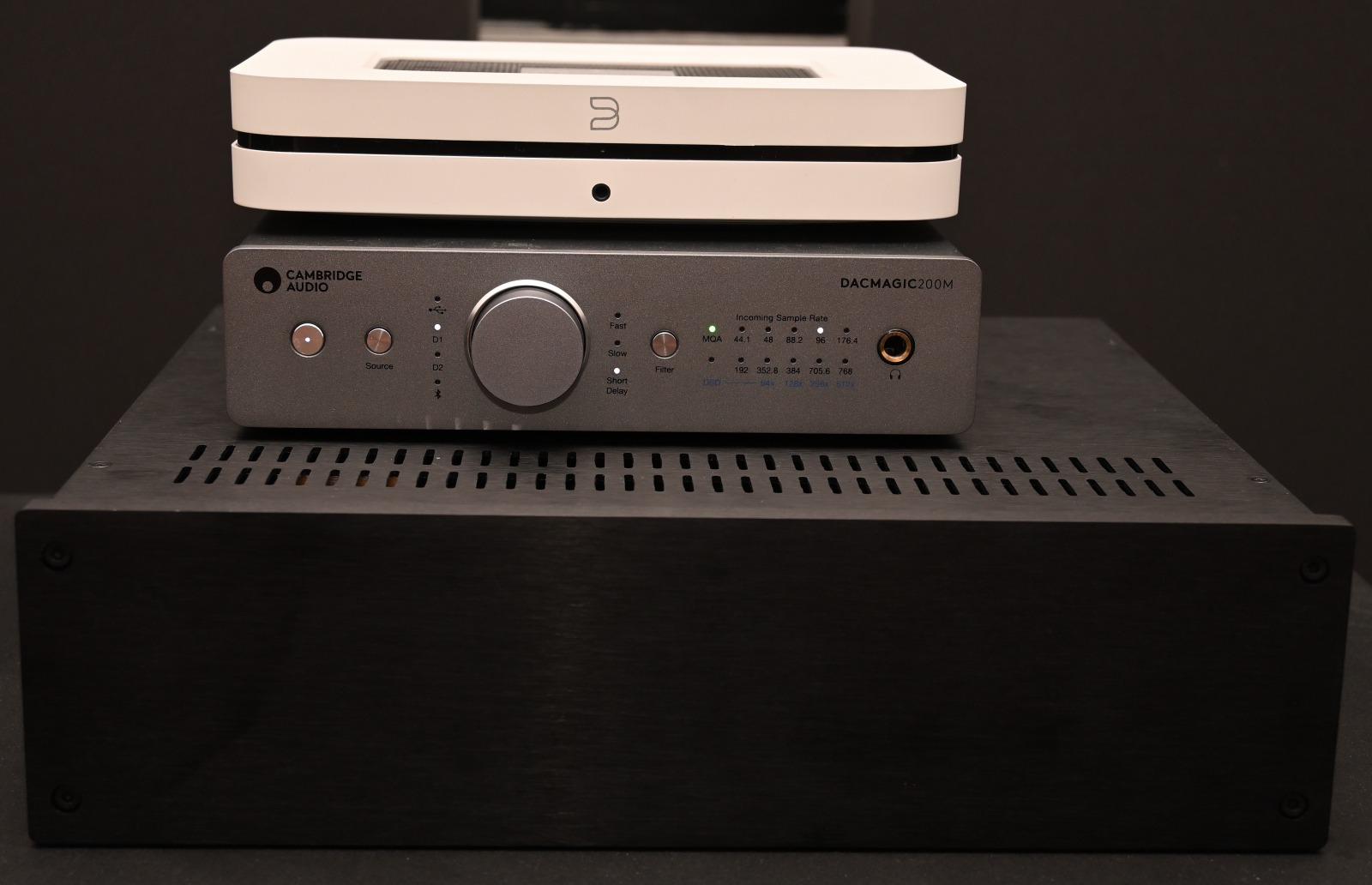

I am now convinced that 6dB gain is enough in my setup when output is taken from DAC XLR out.

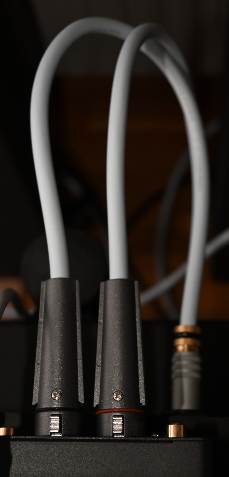

I have implemented the SE version (the black box in first picture). I use short XLR to RCA cables between DAC and Iron-Pre.
Then 1m RCA cables from Iron-Pre to Lazy-Bush mono-blocks at the floor (last image).
I am also convinced that sound it "good enough" to go for the BAL version (if it will arrive some day at the DiyStore).
My plan is to build BAL version as mono blocks and place them close to Lazy-Bush mono blocks and utilize the BAL input and have long (1m) XLR cables from DAC to Iron-Pre.
I could even place the Lazy-Bush mono blocks just behind the speakers and then shorten my very long 1.5m speaker cables to e.g. 0.5m or shorter!
For critical listening my DAC in pre-amp mode the Vol-control is set to about 70% to 95% depending on how loud the recording is. So gain is about perfect.
Setup is even more silent than with Korg as preamp.
