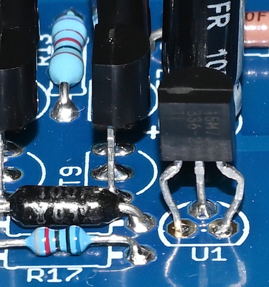

Have a look at U1 in picture (the voltage 2V5 reference). The legs had to be bended a bit to have it fit into the PCB. I assume I did correct?
I could make a very quick check of T1/T2 0.65V......if voltage is higher......then I know the problem and T1/T2 needs to be exchanged.

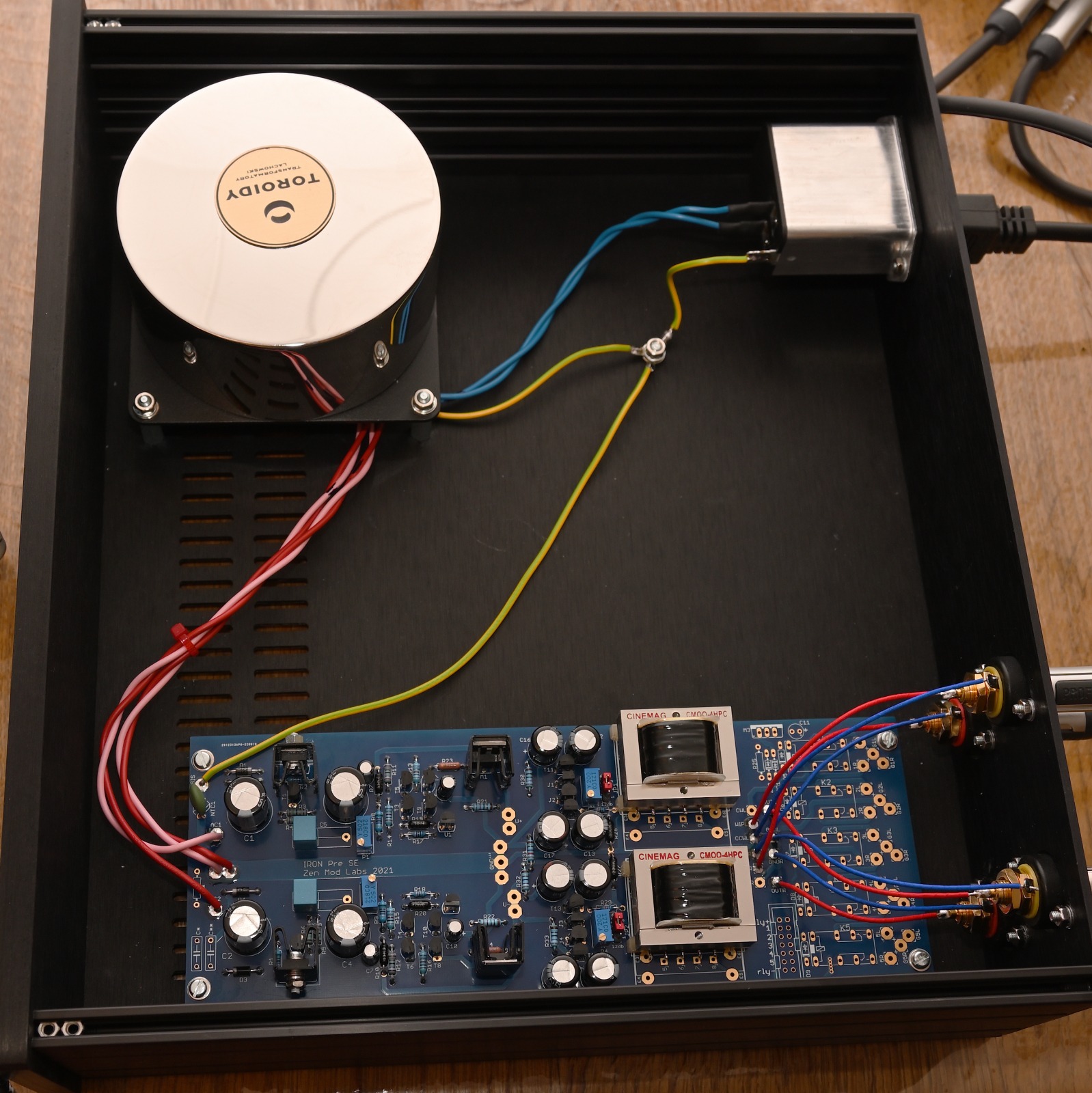

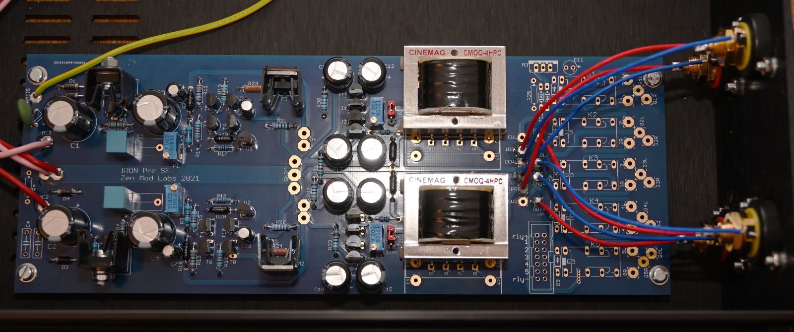

After replace of the BC546A for the positive rail-CCS the amp seems to "behave".
I put small clip-on heatsinks on the M1/M2. Without they raised to about 60C and with heatsinks I estimate temp to be approx. 50C.
They still gets a bit warmer than the BD's. I use 7R5 as CCS "resistor" so about 85 mA CCS current. It depends on Rds_on for M1/M2 how hot they gets?

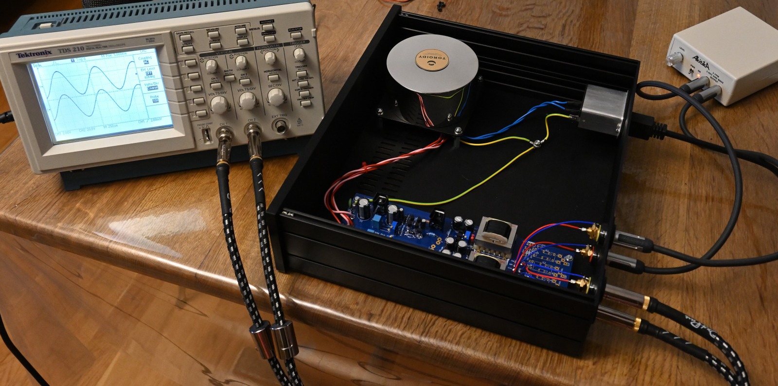

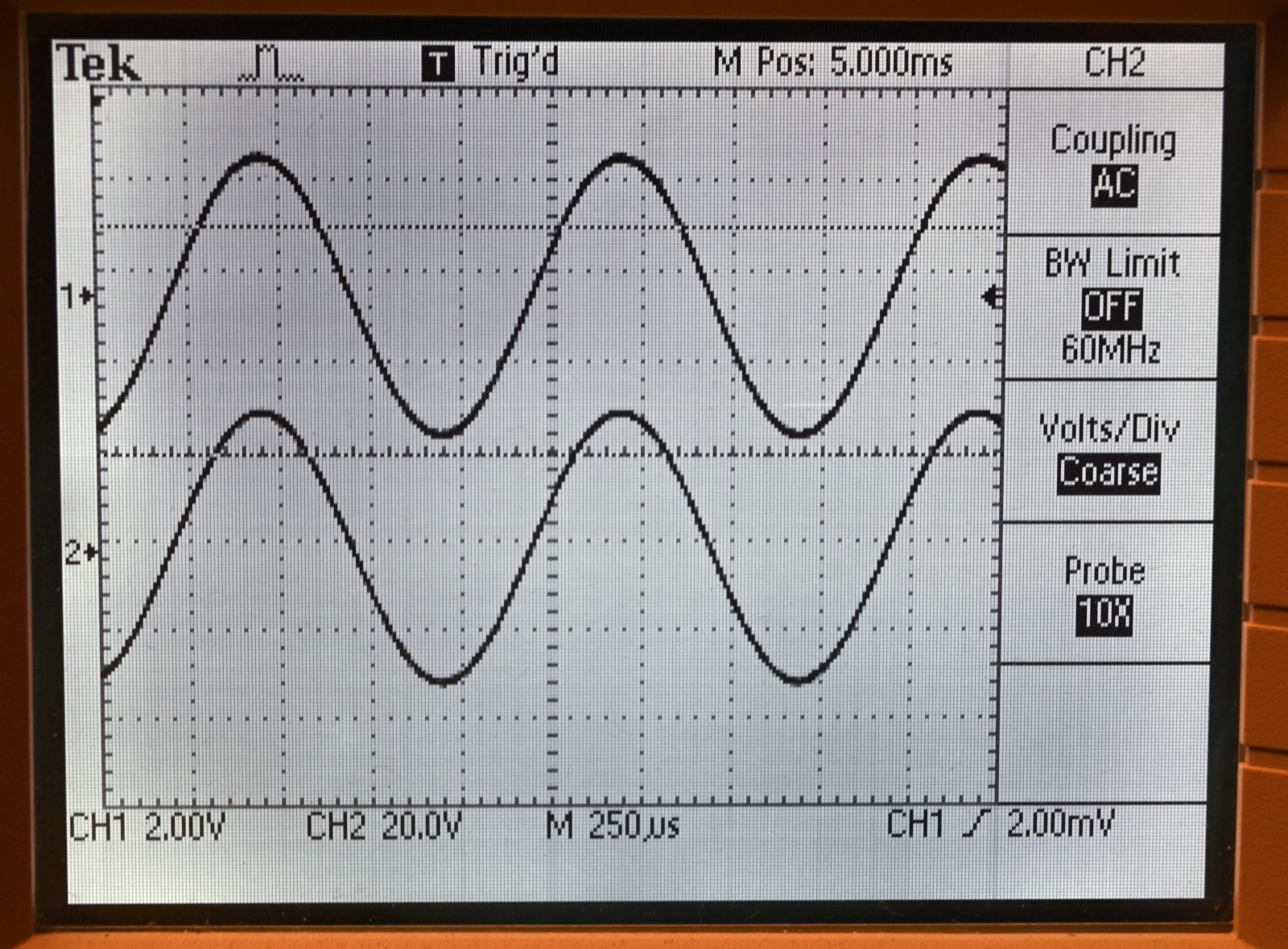

After adjusting rails and offsets I tried the amp using a small battery powered 1000 Hz generator. The scope shows both outputs. It is X1 but scope thinks it is X10 so Voltages shown should be divided by 10. Jumpers set to 6 dB.
Generator set at max. output I measure 5.2V RMS at output which I think is correct when set to 6 dB.
It looks like a sinus even that the old Tek has a rather coarse display?
I don't know if I should make some noise/distortion measurements or try to listen how it sounds.
I use DAC as preamp.......if some wonder why there is no pot.......
There are no mechanical hum from the transformer.......100% silent......which is nice.
