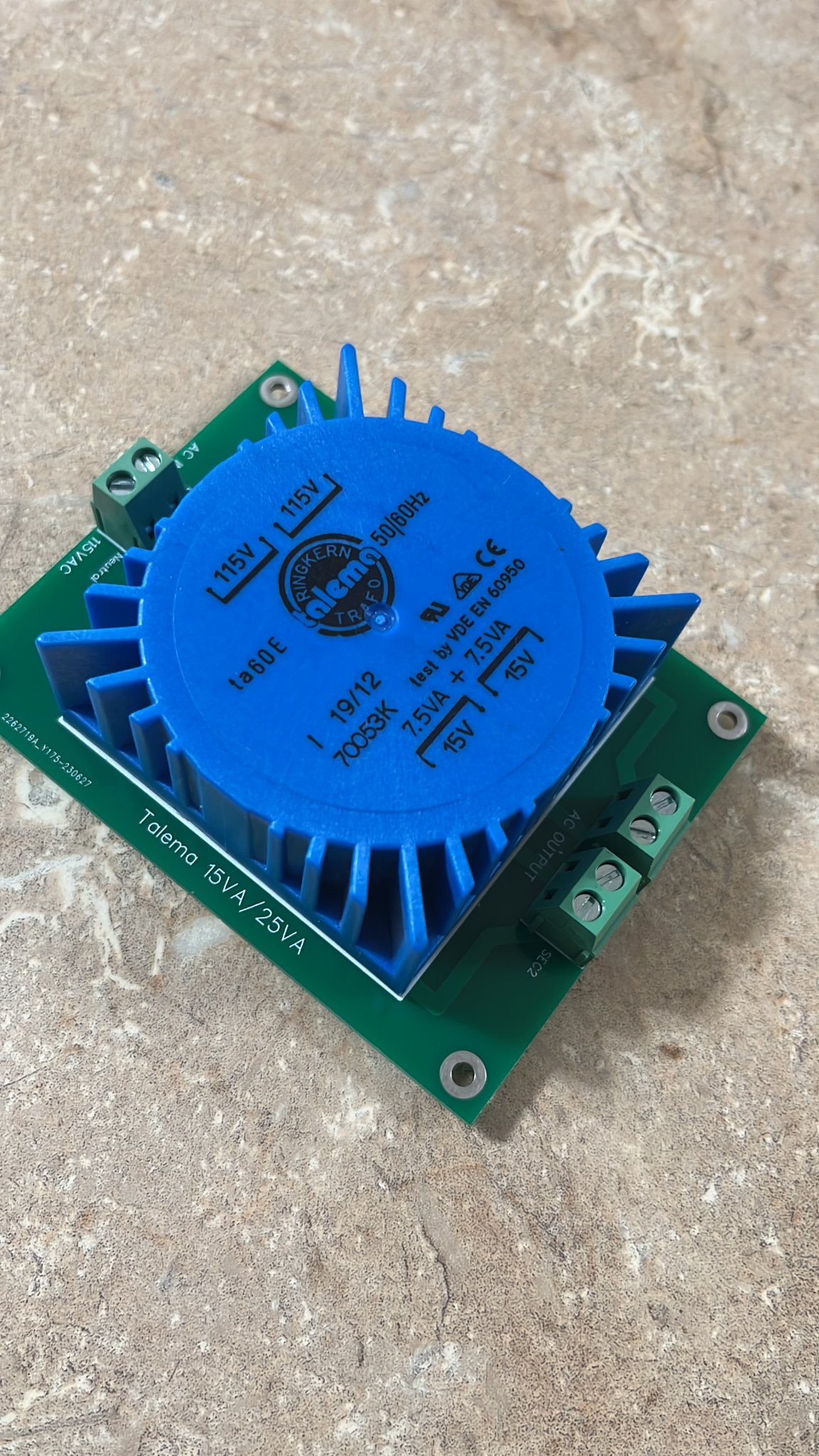

I see from the first post that the Iron Pre SE needs a 18v secondary but can I get away with a 15v dual secondary which I can convert to center tapped with 0.5A current rating for each secondary? I have these nice Talema got from a member here and I made these pcbs 🙂
most likely will do - say that I need at least 18Vdc after bridge to call it OK
meaning - 18Vdc in -10% mains state, so 19V8 when mains is nominal
now, if you have anything less, just set output voltage to lesser value
IPre will work nicely with 12Vdc rails
Iron Pumpkin is having 12Vdc rails, but without cap multipliers .........
anyhow - I'm expecting that shown Talema is going to have more than 15Vac per sec. loaded with 80mA; majority of xformers are spec-ed at full load
