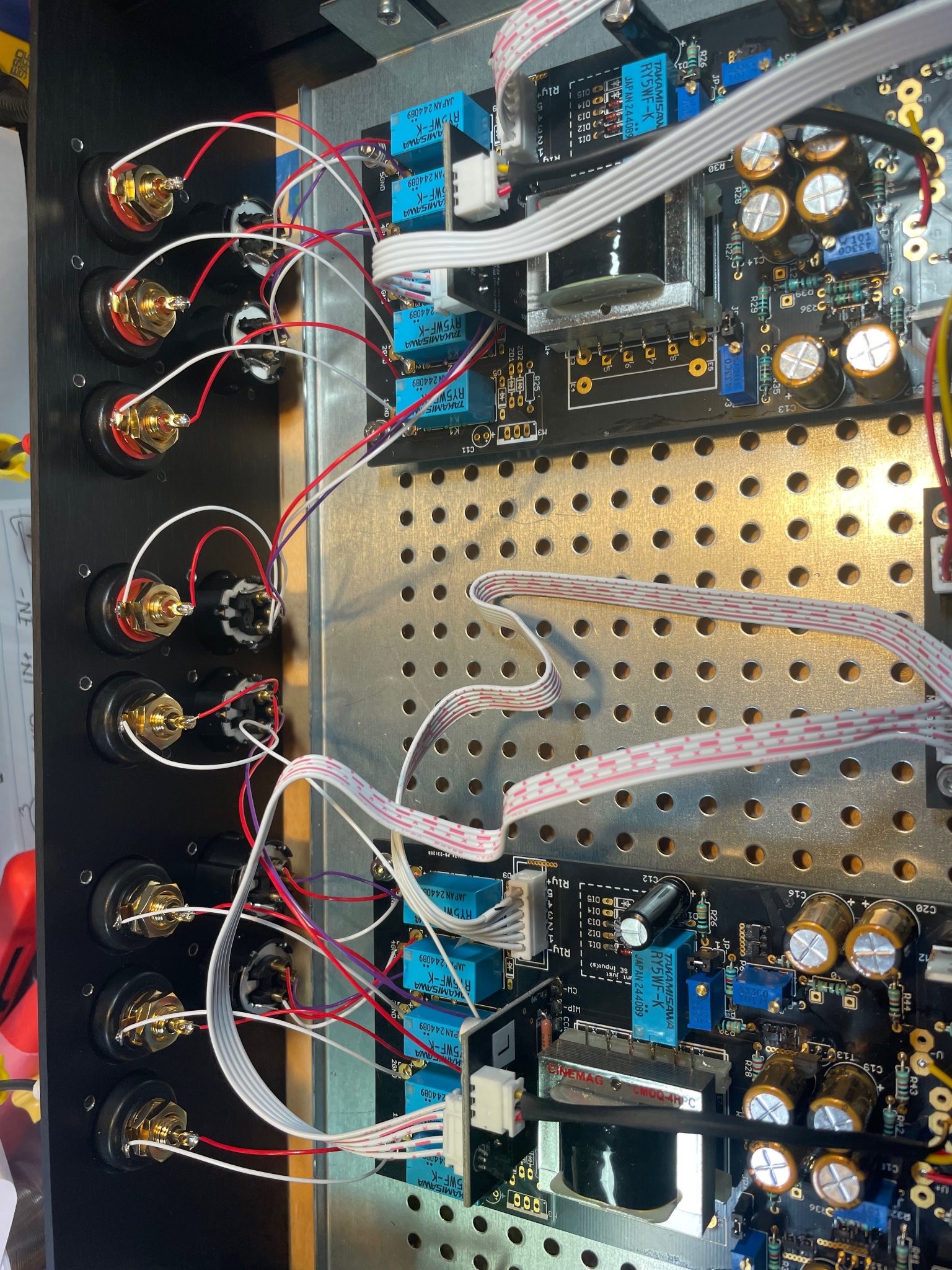

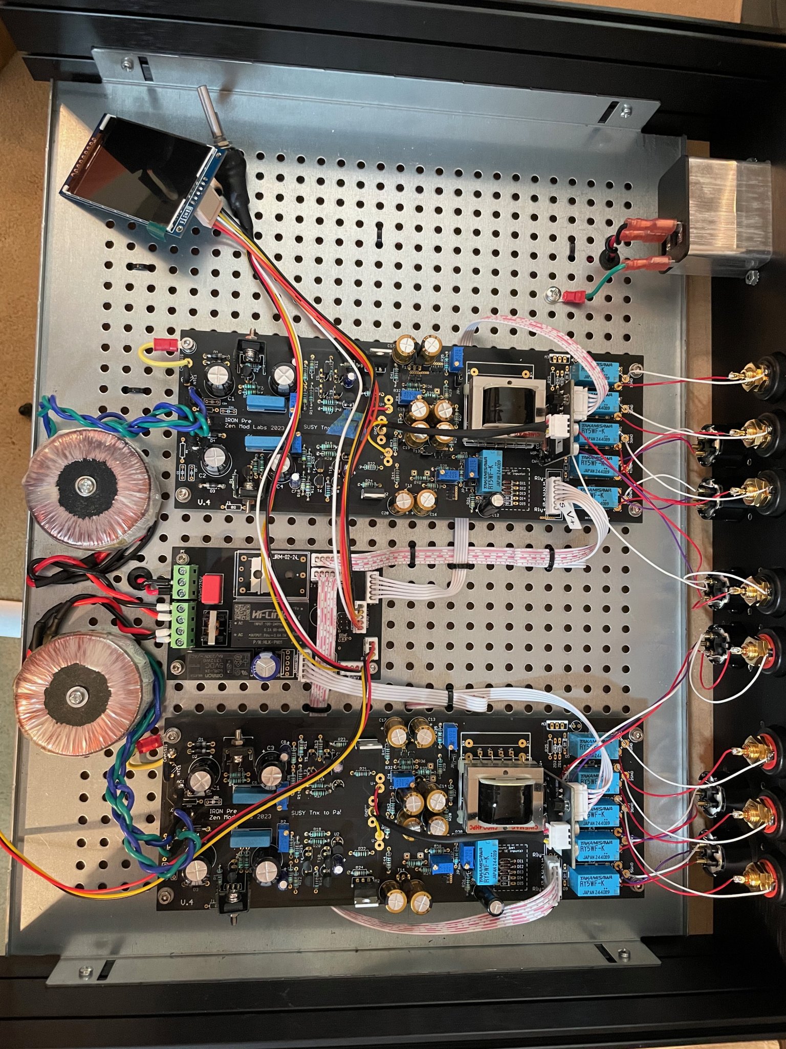

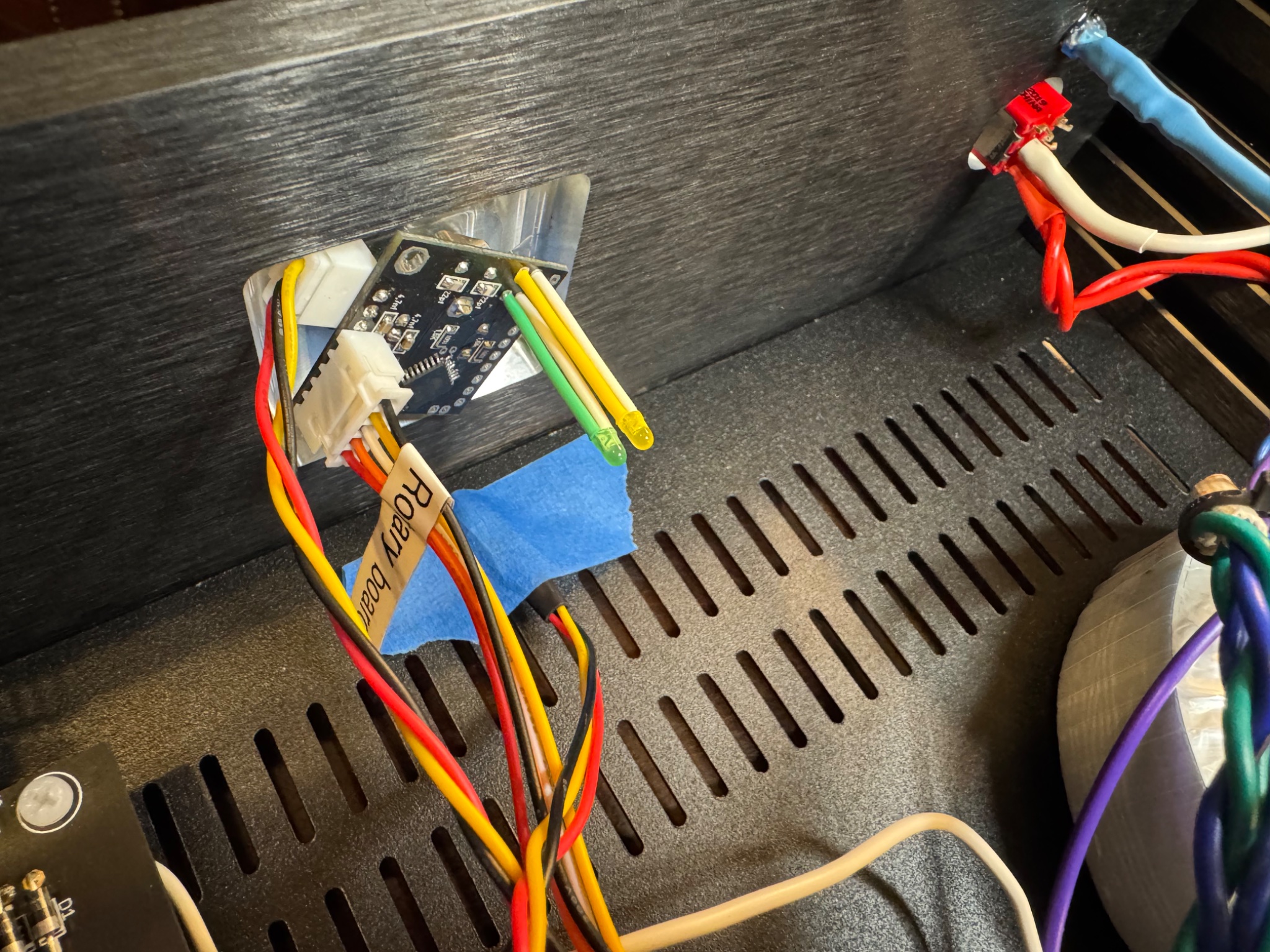

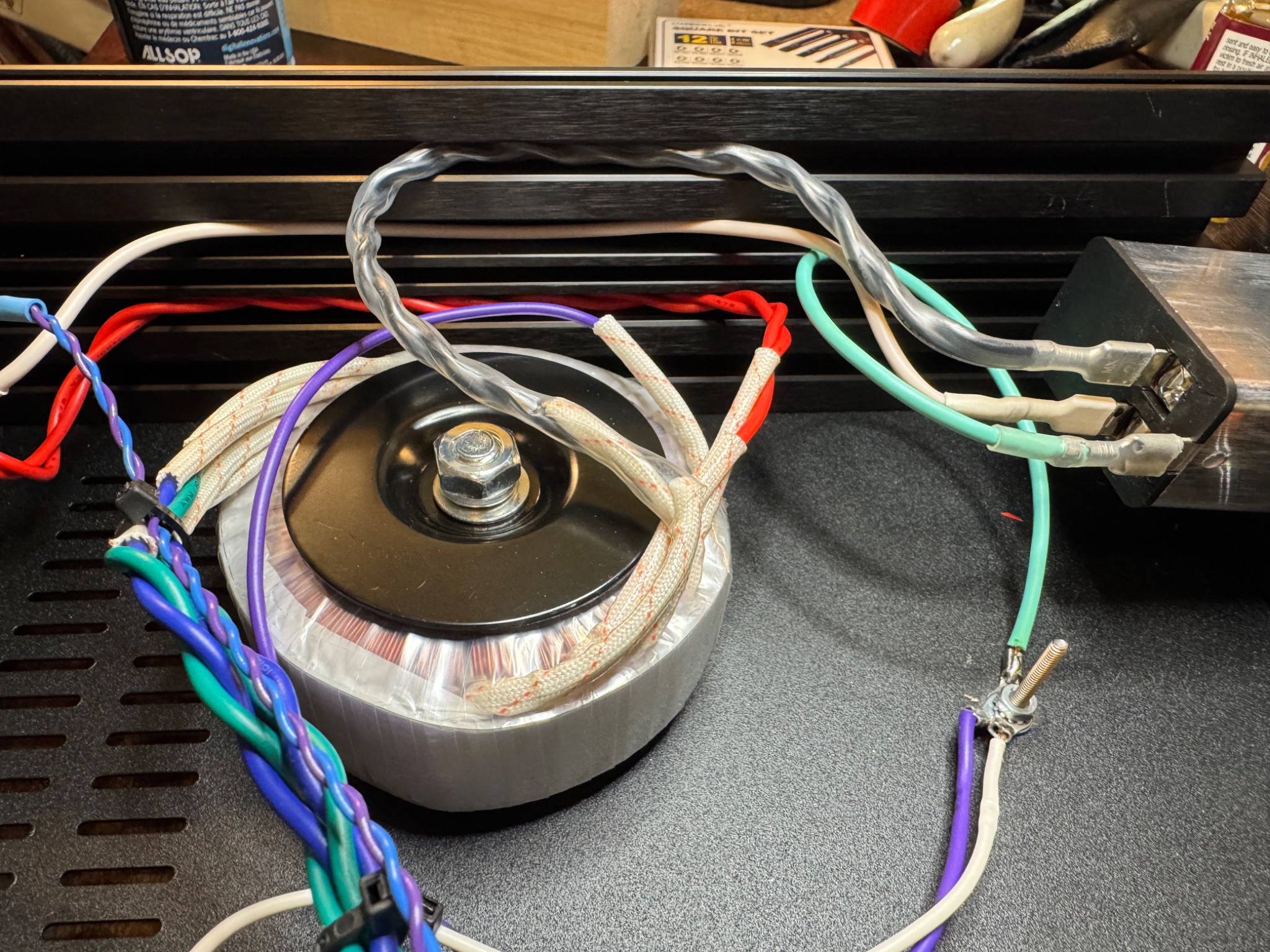

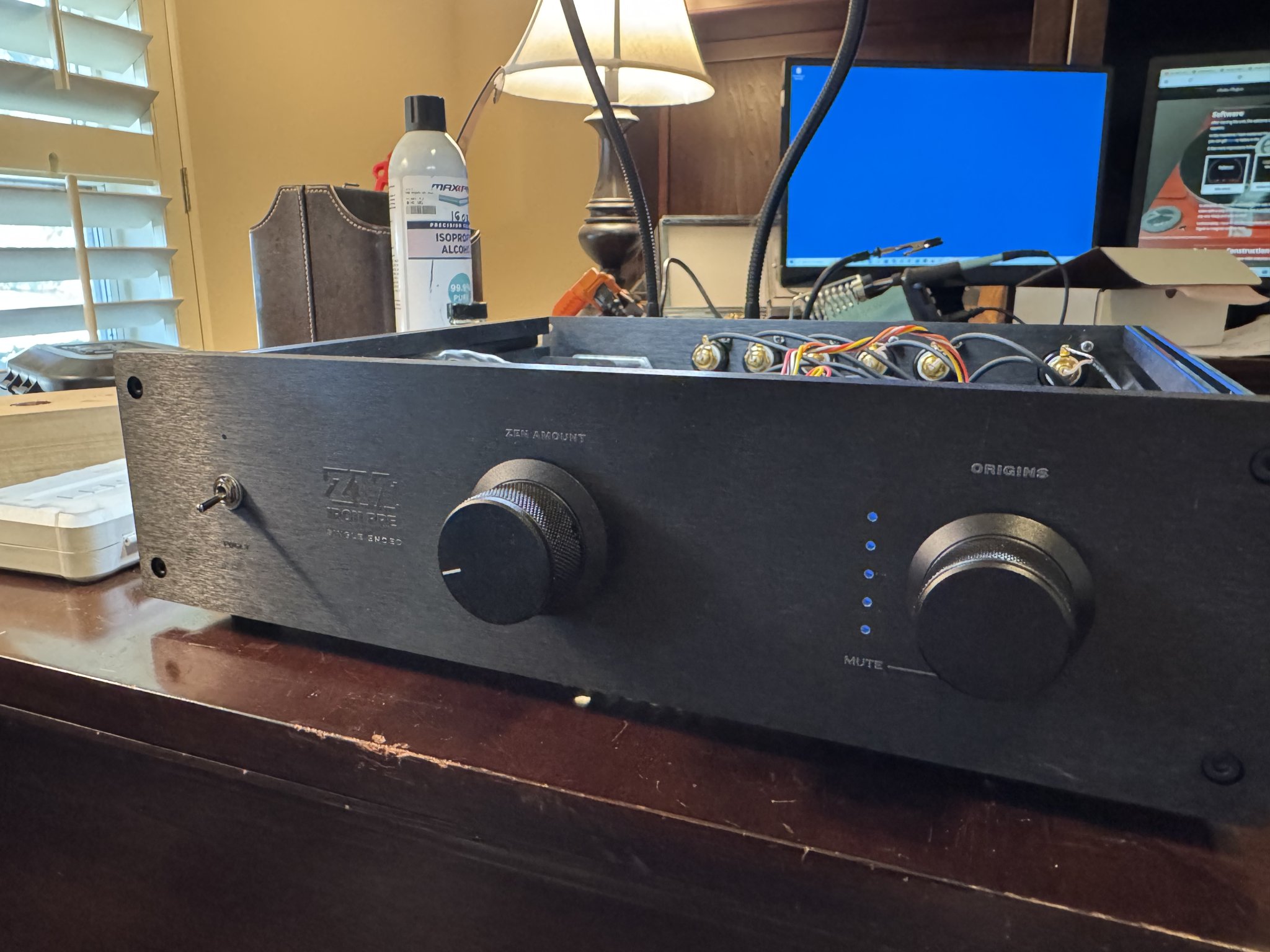

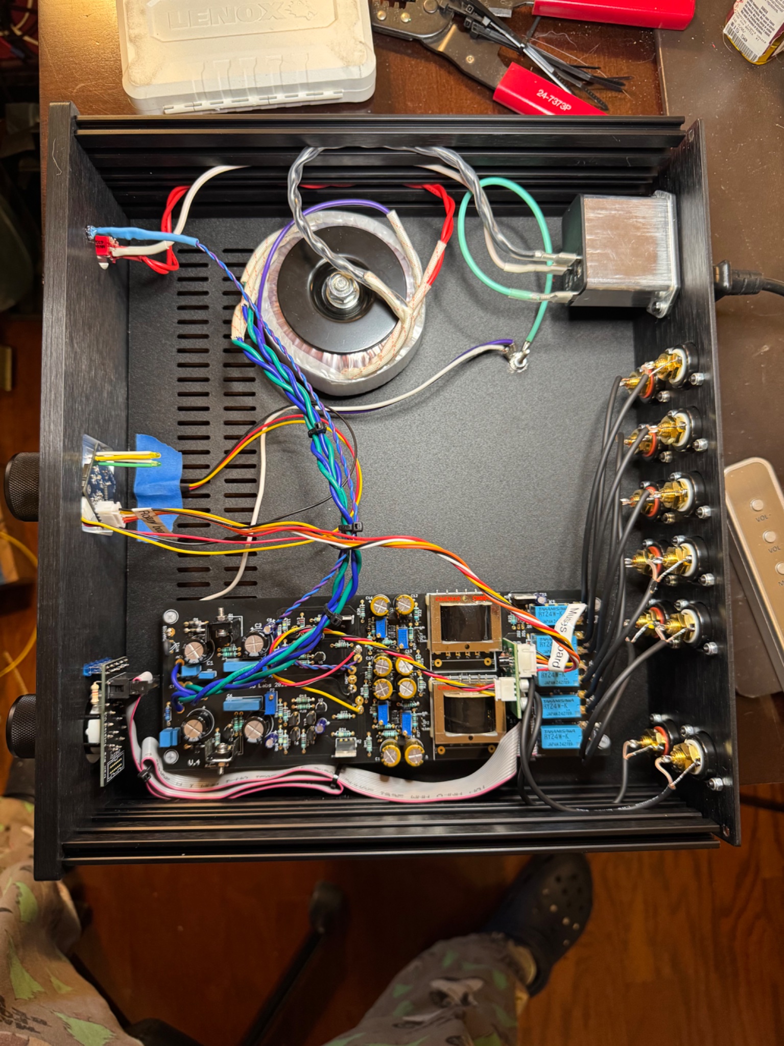

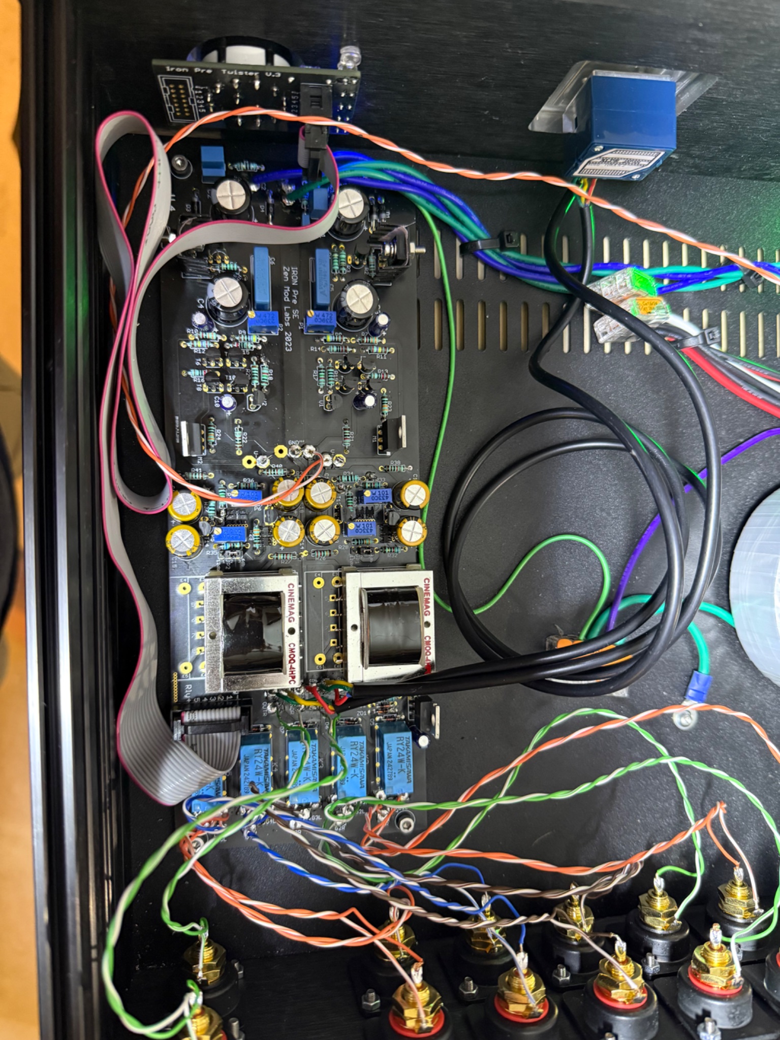

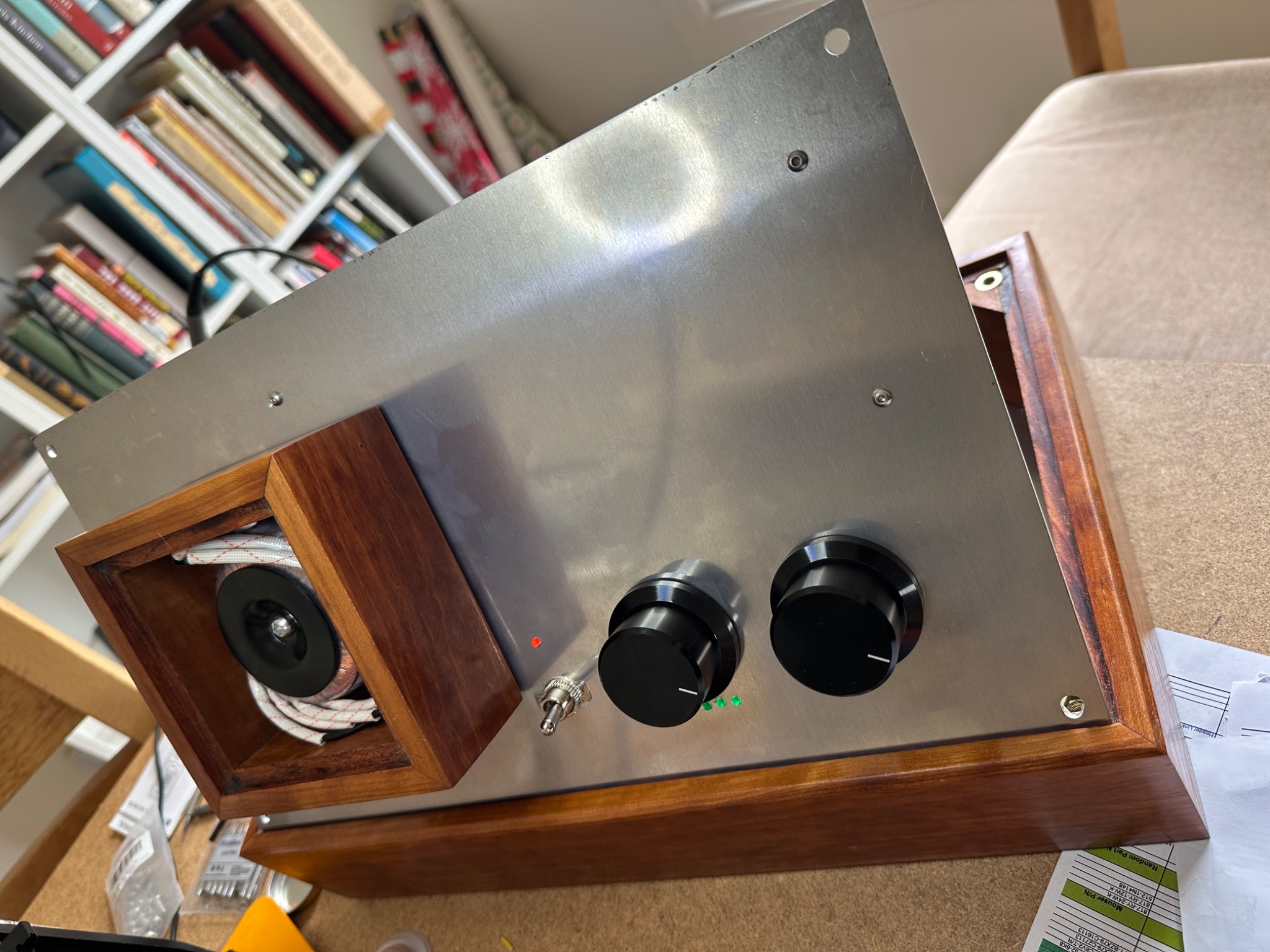

Dialed in all the test voltages easily, and fired up first time. Sounds excellent. I was not aware of Frank’s solution until I was about 90% done with the Iron Pre. It is definitely possible to solder in his 90deg pcb solution after installing transformers but I wouldn’t recommend it. You can see where I kissed a relay with a hot iron, but only cosmetic. For now, the IR receiver is peeking through a 6mm hole in bottom plate. I will see if it will reliably accept bounced signal from the shelf under it. I brought the programming leds out of back of rotary encoder so they may be observed through the vents of case when programming the remote control. This is in front of my Aleph JZM driving Belle Kipschs and I am very happy with the sound. Thank you to everyone here on DIYAudio for their knowledge and willingness to engage in civil discourse.

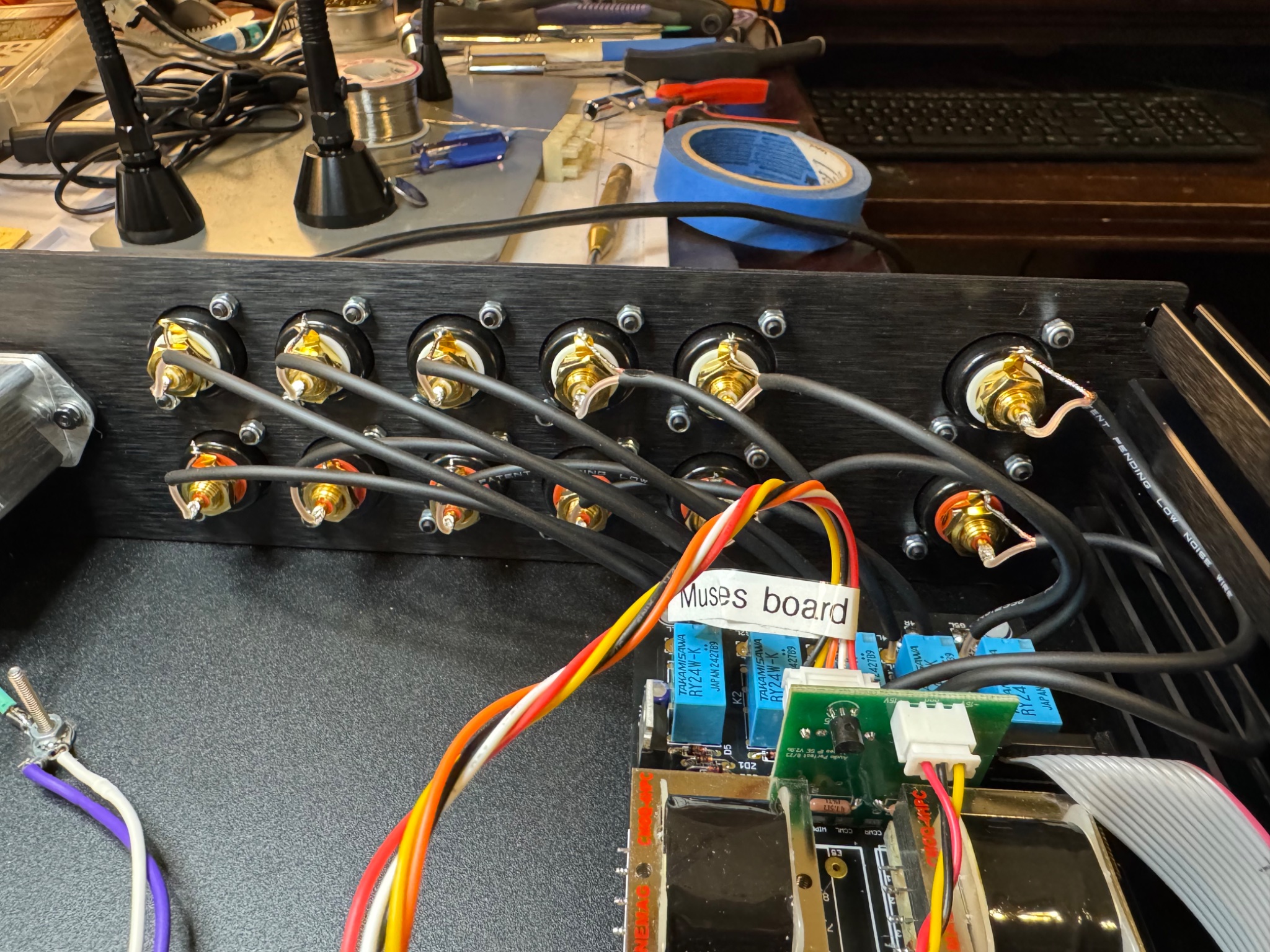

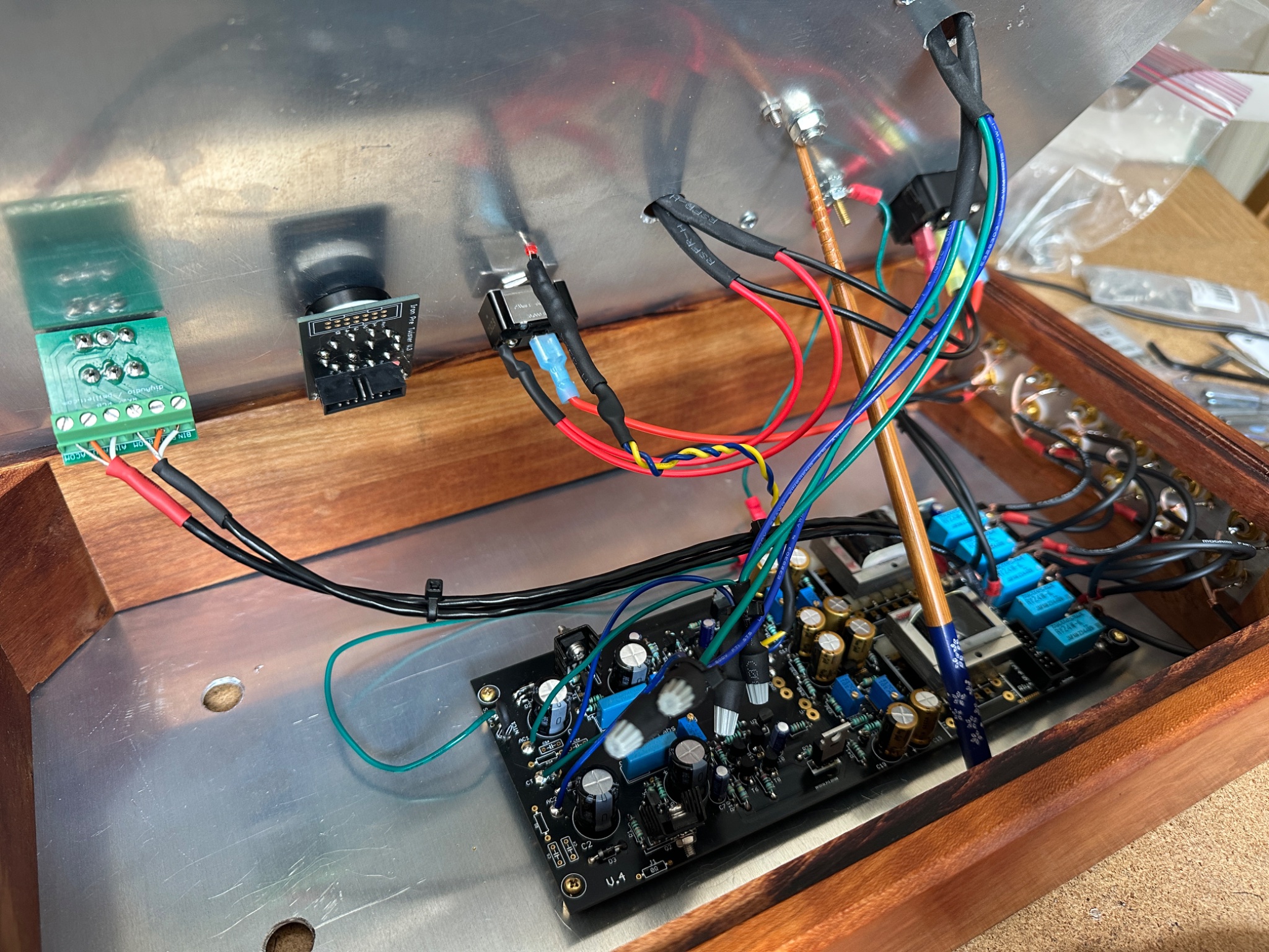

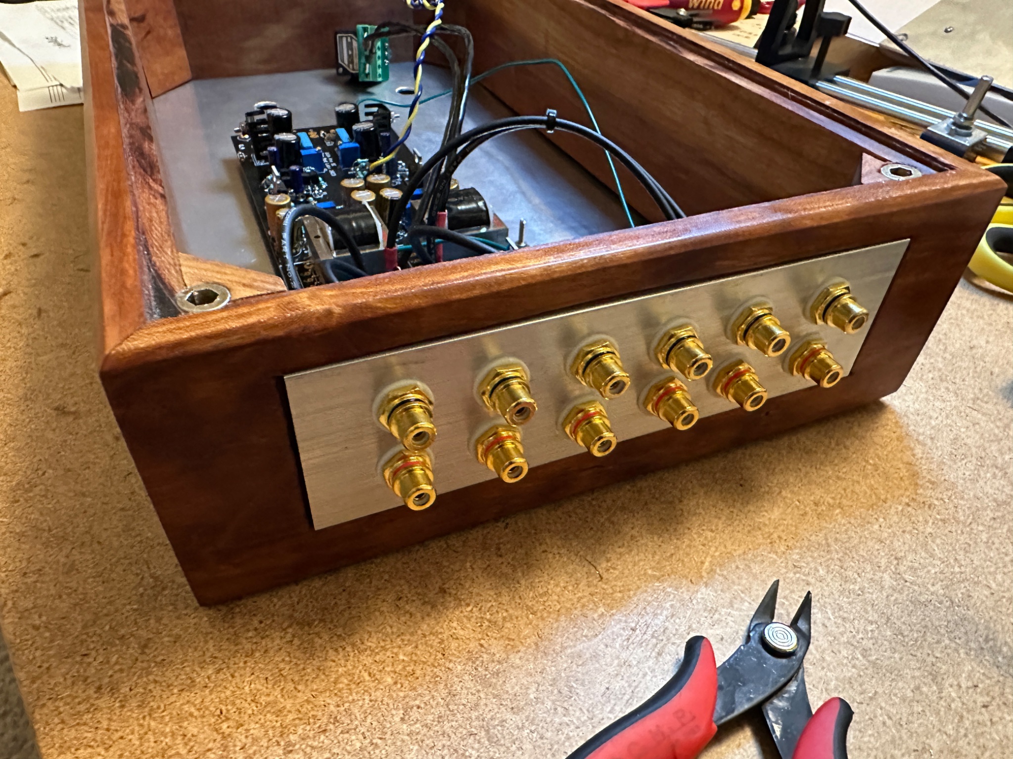

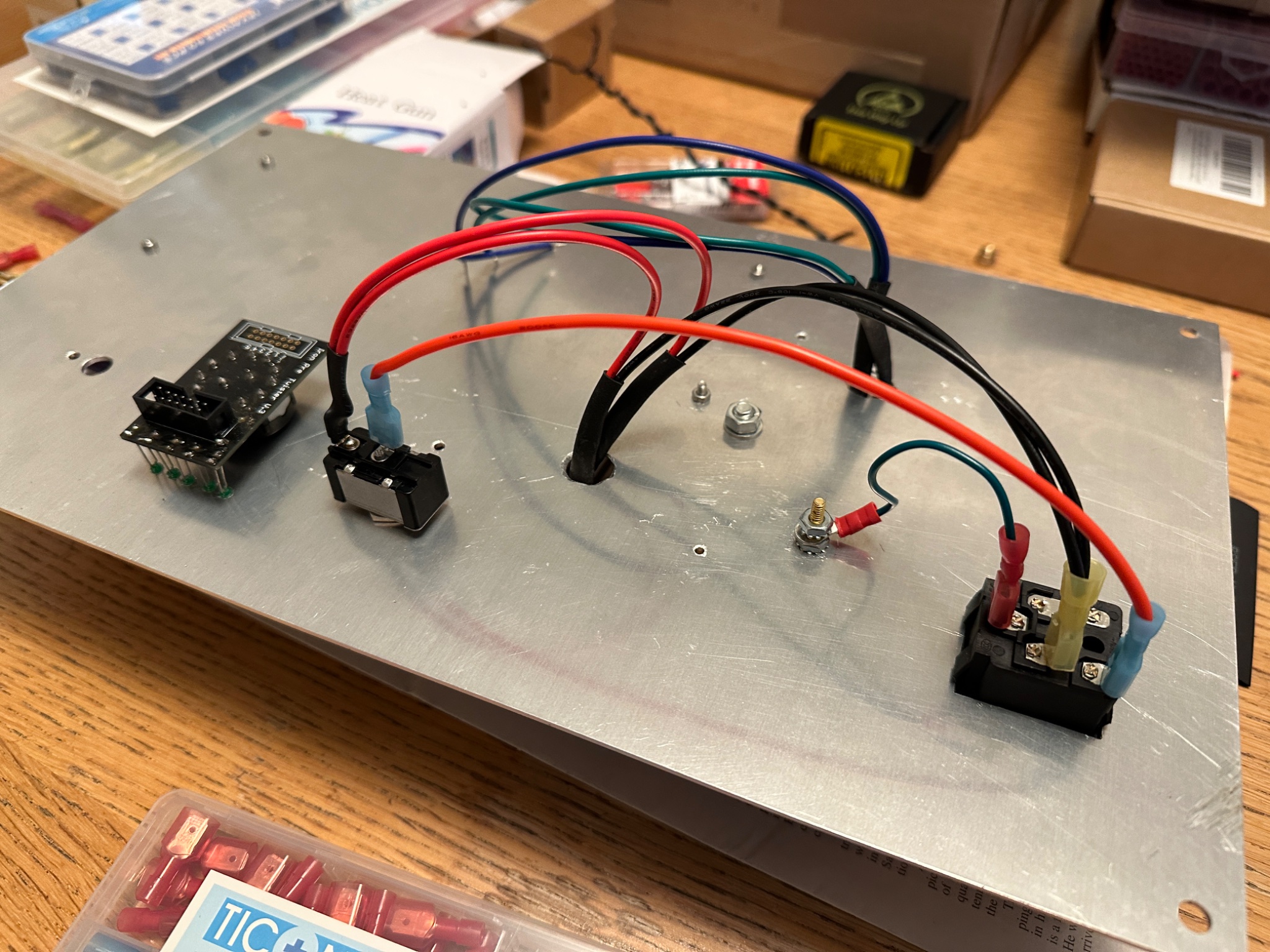

Hi there, making progress on this amp. Dim bulb startup was uneventful and DC settings made. No smoke. I did forget the jumper headers and when I went to put them on they fit loose. I can’t figure out what’s up with that so I ordered more. Here are some progress pics of my very diy effort.

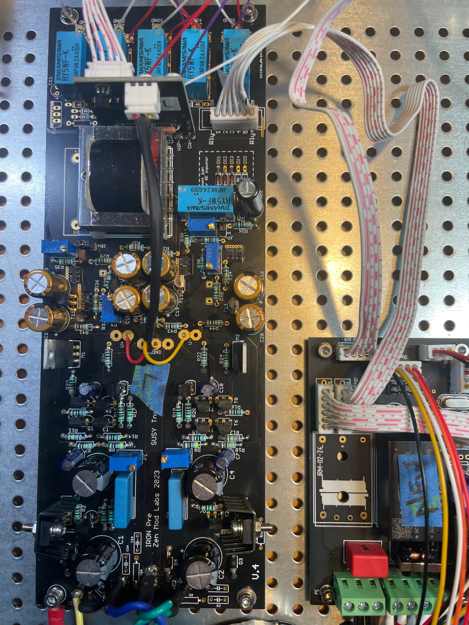

I gave the IP SMD I made a year ago to my kid, and have been slowly building another for myself. I finished it a little while ago, but it has low output syndrome -- it appears to have some kinda negative gain; it's too quiet and/or doesn't get loud.
Today I borrowed my kid's preamp for comparison. They both have Frank Wilker's MUSES volume solution, and sure enough, the new one was quieter (for lack of better terminology). I pulled the MUSES stuff out of the new preamp and put it in the old one and noticed no difference (that is, the older preamp still played significantly "louder" at a given volume regardless of the MUSES card installed). Hmmm. Voltages measure correctly on the new boards, and both channels exhibit the same issue.
And I'm a little stuck. Any advice happily accepted. I have a feeling I've done something dumb and just can't see it.
