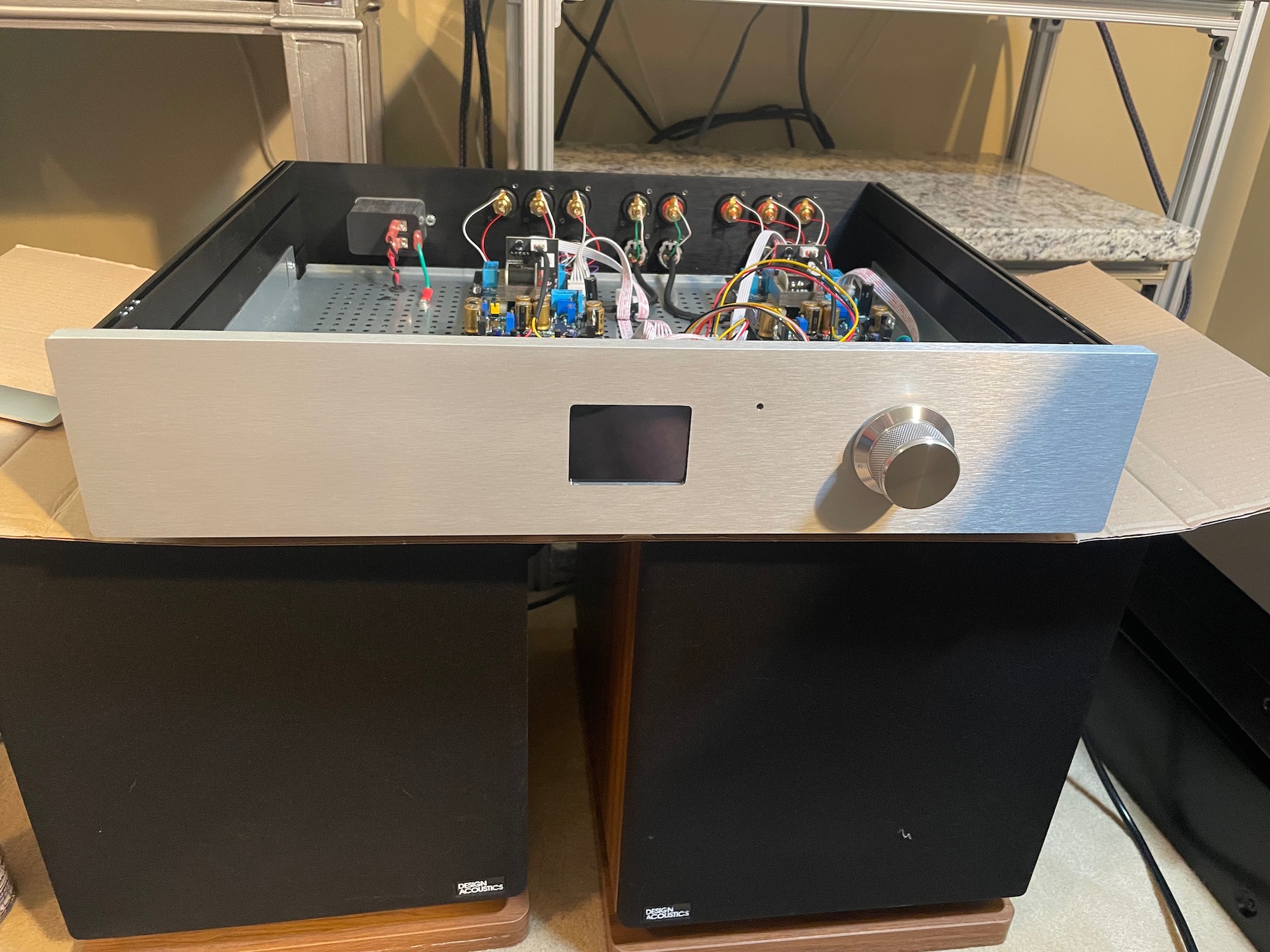

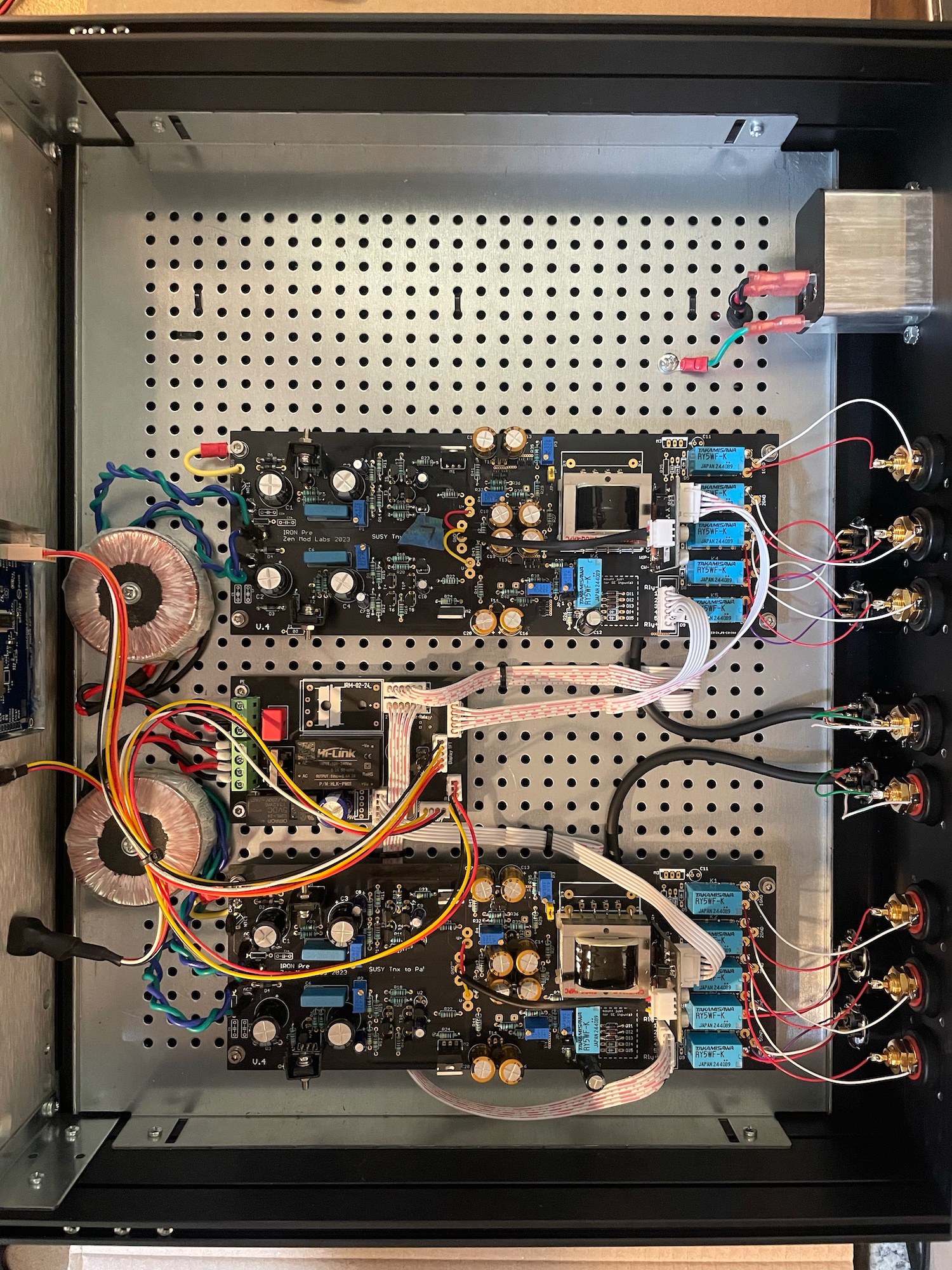

And it's done!
Thanks for all the help and inspiration.
It's been a year since I built my balanced version, and during that time only the single-ended were used. Yesterday I hooked the Iron Pre up to my balanced Mark Levinson and it sounded fantastic, and quiet, even though it was placed literally 4" behind the amp which has two enormous toroid transformers. I could detect no induced hum at all, even when I lifted the Iron Pre directly over the ML.
I built another for a friend last year, and he only wanted the single-ended jacks connected, but I think it's really a handy feature to connect at least one position for balanced use.

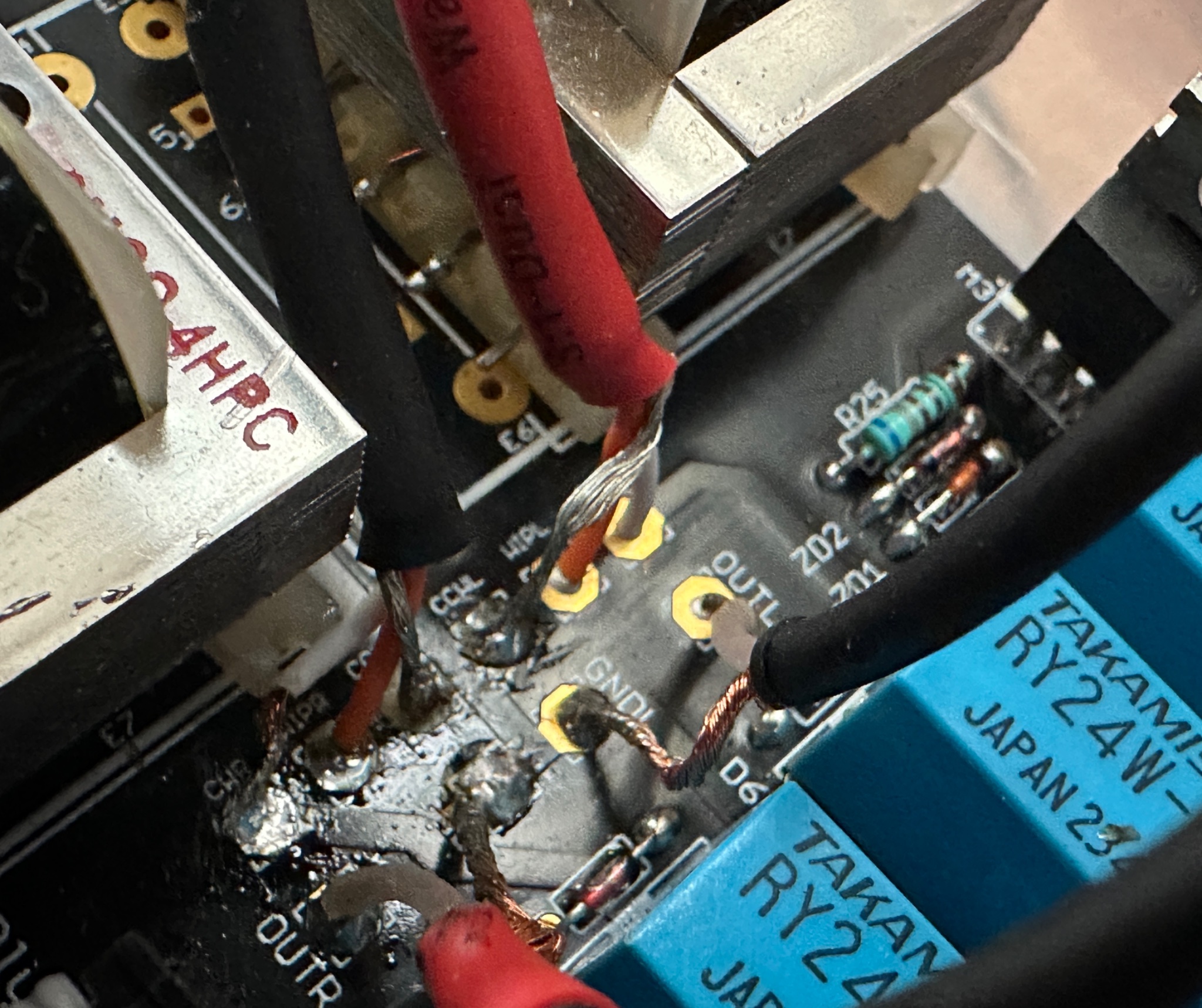

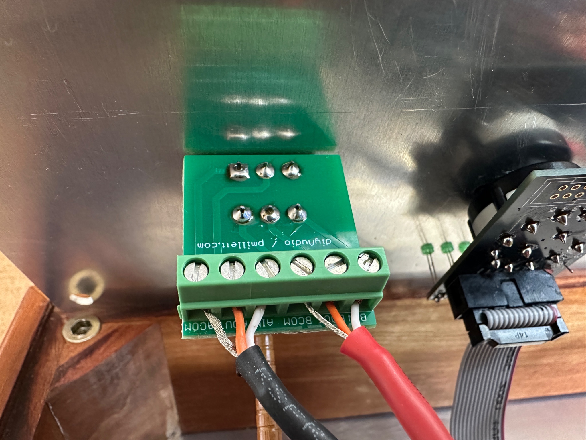

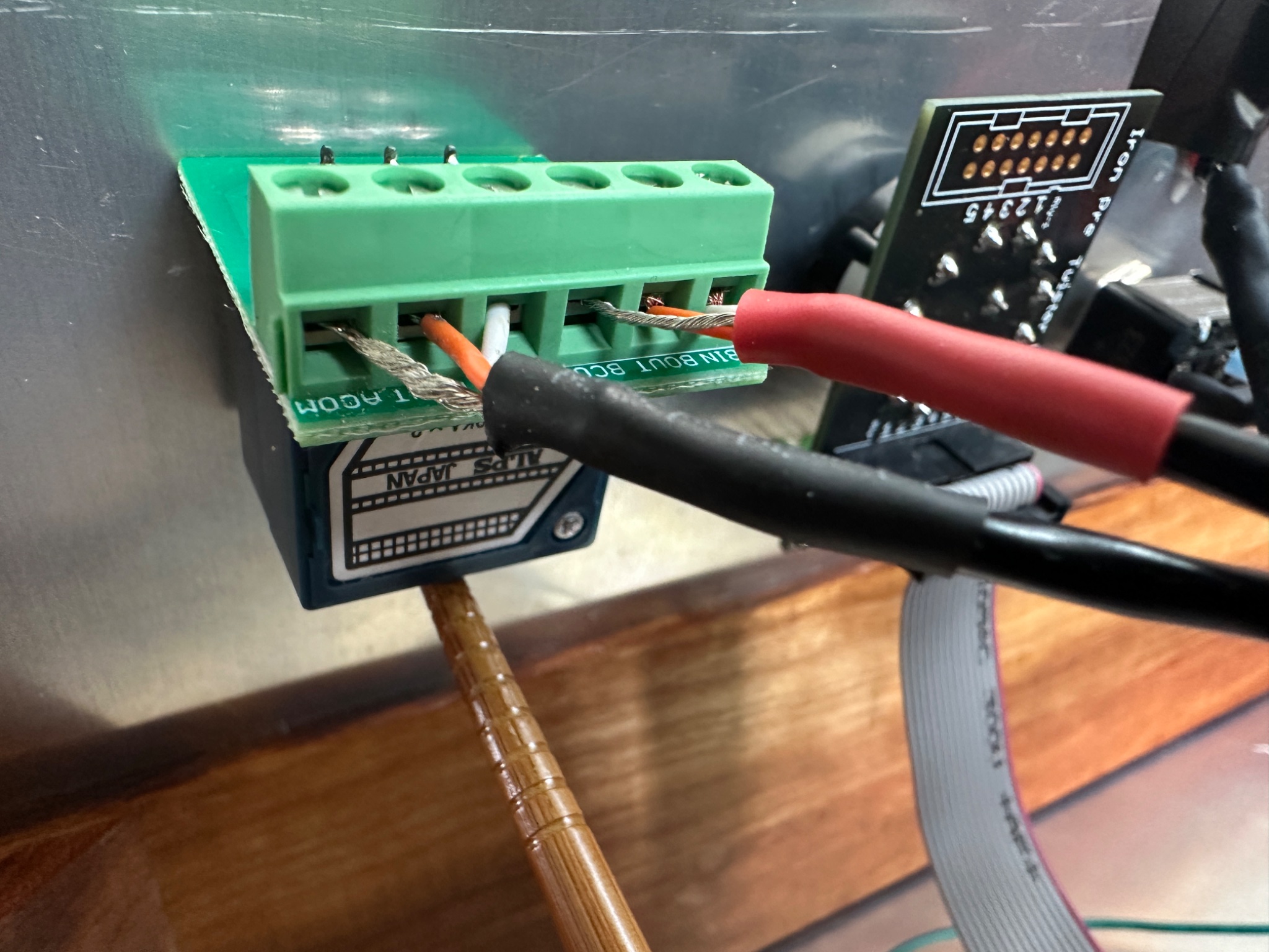

Hi all - I had to take a break from this project. 1) I screwed up the twister board and boneheadedly got the leds backwards. I think the selector actually works but resistor and leds are kaput. Can another be procured? 2) Board measured beautifully and jumper headers finally installed but 3) when twister moved to input 1 (only one I’ve tested) preamp plays full volume on left channel when volume pot full CCW then full volume right when full CW then both channels full volume when 12 o’clock. I know I have red heat shrink on the left cable, bad form. I’ve been reading the threads but cannot find the other instances of this happening. Any help appreciated.
