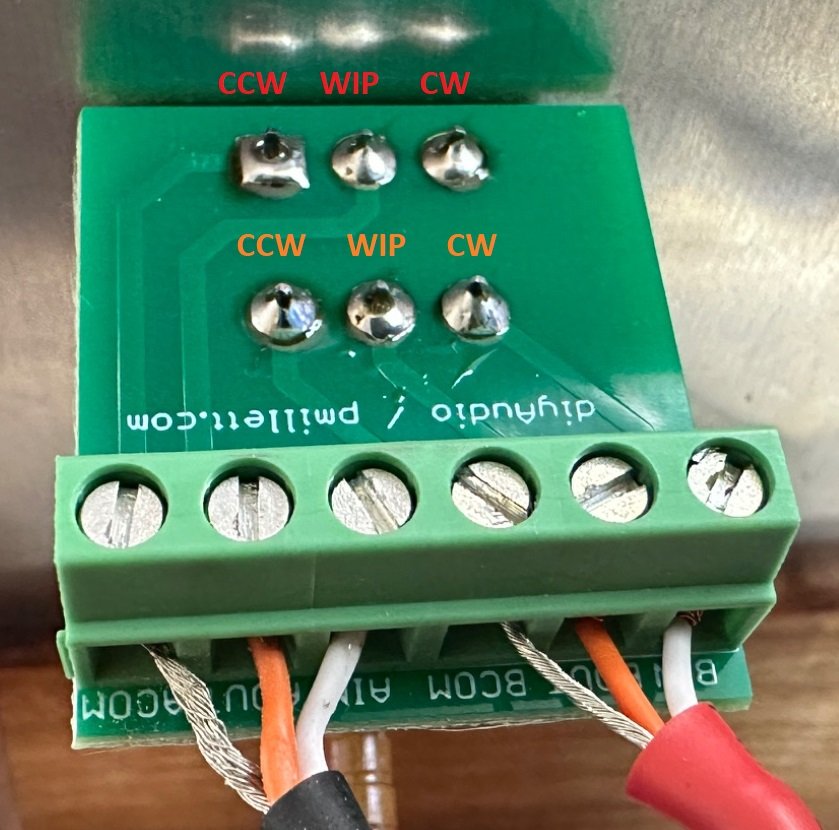

It's highly likely that you have your pot wired incorrectly. See post #1 for a diagram. That should fix the volume issue.

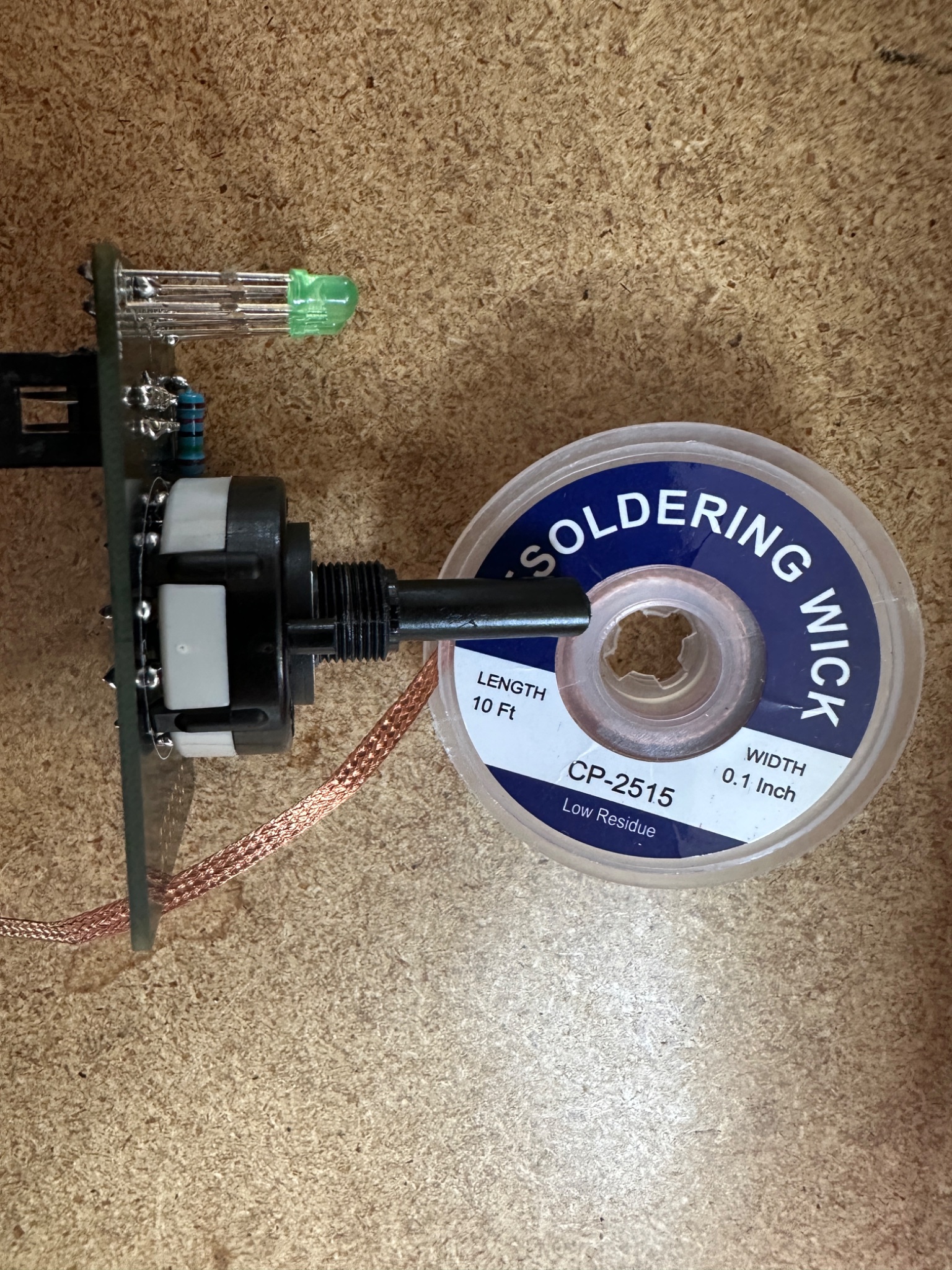

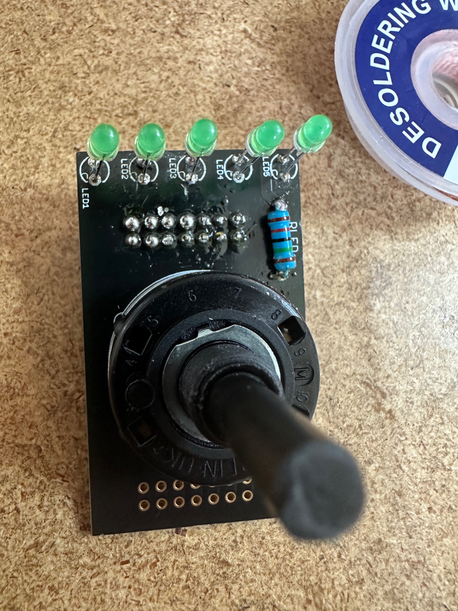

Make sure the twister board is getting power from the main board at the LED resistor. If it is, then the LEDs will light when inserted properly and the input is switched (unless you've cut some traces and/or used an improper switch).

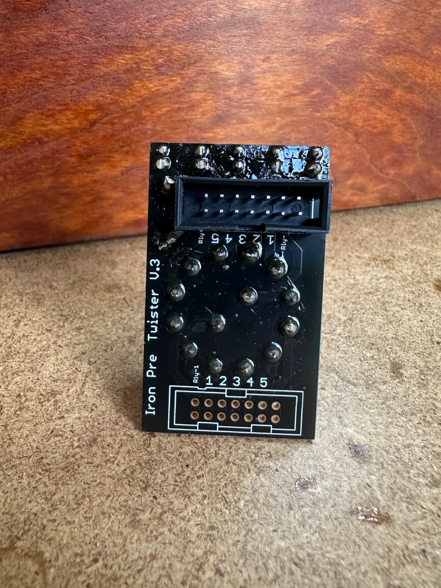

Let's see a couple good photos of that damned Twister. I had a challenge with mine too because I assume way too much and go ahead anyway.
The volume problem seems to be a wiring problem not at the volume control, but the other end for one channel. Take a closer look at the board wiring. One of the channels wirings doesn't look like the other. That is why you have reverse volume for one channel. Did I read that correctly?
Twister board
What I notice in the jpg 7879 photo is the possibility that the connection that is close to 'V3' in that photo has come loose. This may be why you are not getting those LED's to light.
Back to the circuit board problem wiring. Do you see what I am referring to about the CW/WPR/Comm connections? I did the same thing and so that is why I looked for it.
Look at jpg7878. The cable with the red heat shrink on it is incorrect. Center red conductor is correct, but the other two are swapped.
I think the build guide photos are like mine although build guide photos don’t seem to agree on R and L in the page 1 duagram. I thought CCWL and CCWR are the grounds at the pot BCOM and ACOM? I thought the white conductor was the IN, red the Wiper/out and shield is GND.
If I am wrong, I am not surprised, but, I am only talking about the red heat shrink wire, not both. As stated in the above post, using a meter will make sure that the wires have ended up where they should end up. It is just that I remember that some things were in 'mirror image to each other' and that gets me every time.

Thank you. Buzzer test worked w continuity as expected. I also tested to the board. It buzzed w knob in all positions, not just mid position. It also buzzed when one lead was on wiper and other on IN on each channel.
I wrote pot in mid position, exactly to avoid shorts between wiper and other two pot pins, which is going to happen if pot is in one or other end position
so pot in mid, and buzz will confirm wanted traces
if then you have buzz between pot pins, something is wrong
I forgot to write that you also need to check exactly that, buzz test between pot pins
