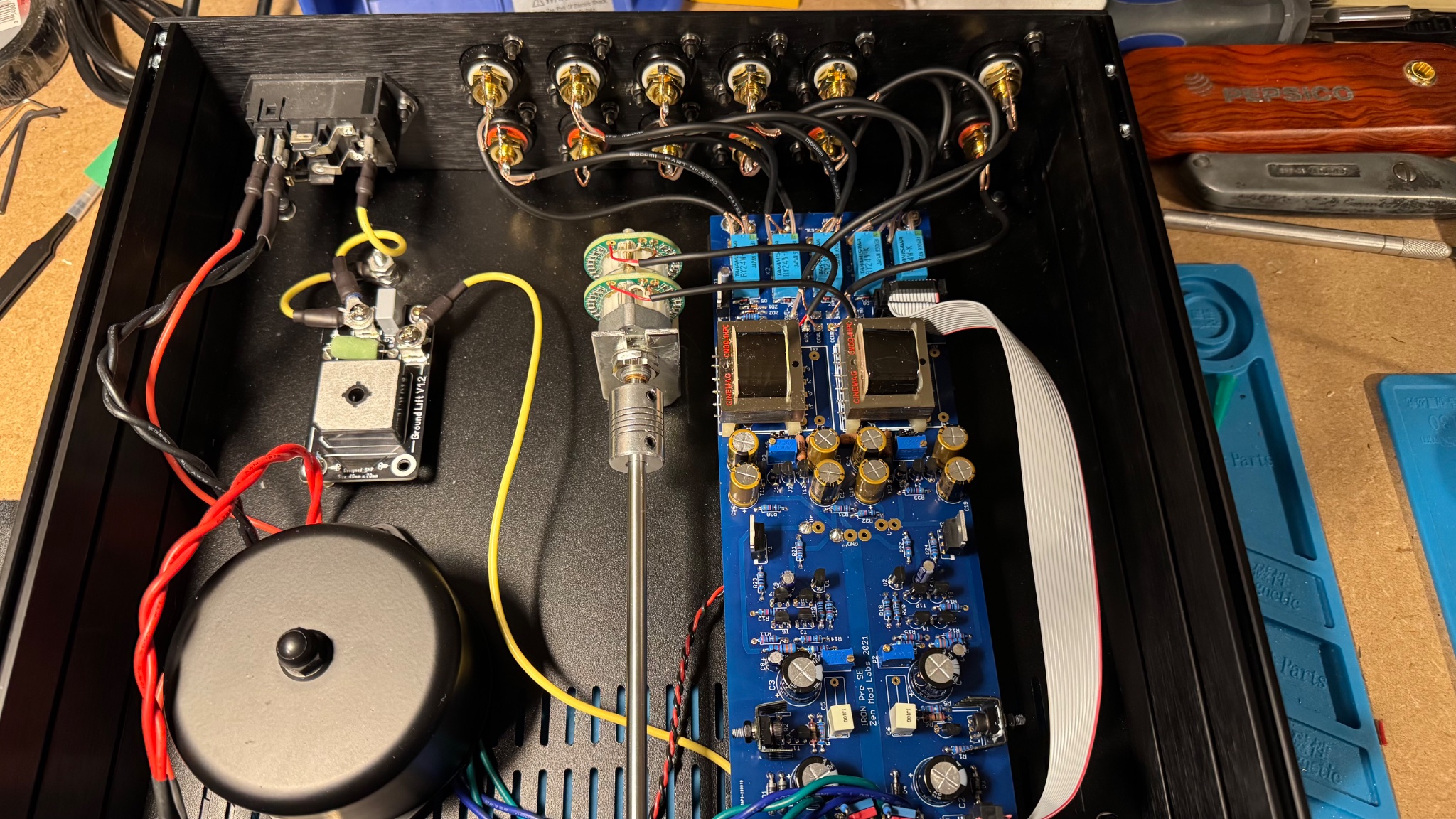

Hi @bilschSo I'm mostly ready to start assembly of my SE kit. The case is here but I'm missing a bunch of the connectors ( ok all of them )
I found the volume pot in the thread somewhere
I need to measure the power entry module port - any suggestions on the part?
I need to look up the power switch - any suggestions?
Are this and this right for the rca jacks?
I'm debating what to use for hooking up the rca jacks. I have a bunch of cat 6 or cat 7 ethernet wire which is nicely twisted. Given the lower voltage of the inputs / output any reason not to use that? Is it worth getting the mogami?
I bought the Modushop chassis pre configured for the Iron Pre. Here are the parts I used:
Volume pot: Goldpoint V24-10k. The 10k has worked well with my Denefrips DAC, Salas UltraFSP, and some other stuff.
For power entry, I used the Schurter 693-DD11.0121.1110. Note that you need to order the fuse holder separately.
Power switch for the front panel is a DaierTek Mini Toggle SPST rated for 250v and 6 amps.
Those RCA jacks are the ones I used.
Good luck with your build!
-Glen

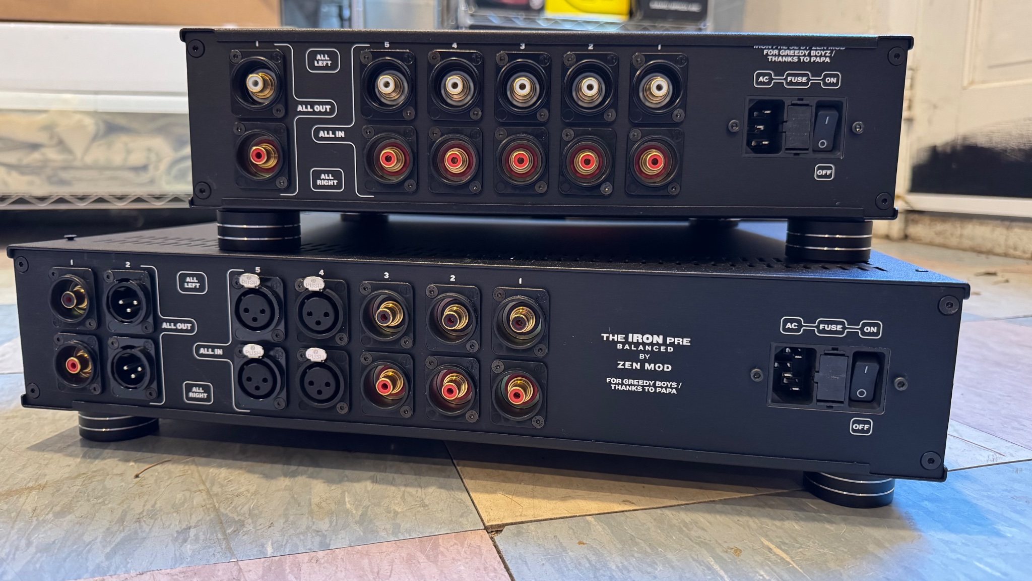

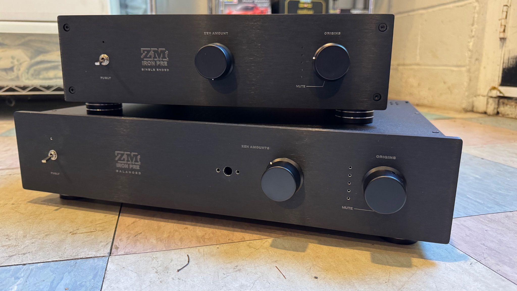

My Iron Pre SE build is complete. I bought the SE during the first group buy round, just missing out on the balanced version. I wasn’t very enthusiastic about building the SE version and waited a long time for the balanced version in the store. After recently completing the balanced version, my interest in the SE version peaked, and here I am with both versions to play with. I am exceedingly pleased with both versions. The SE sounds exactly like the balanced version. I posted my impressions previously back on post #4248.
Thanks again to Aleksandar, Patrick, and everyone else who made this great sounding project possible.
