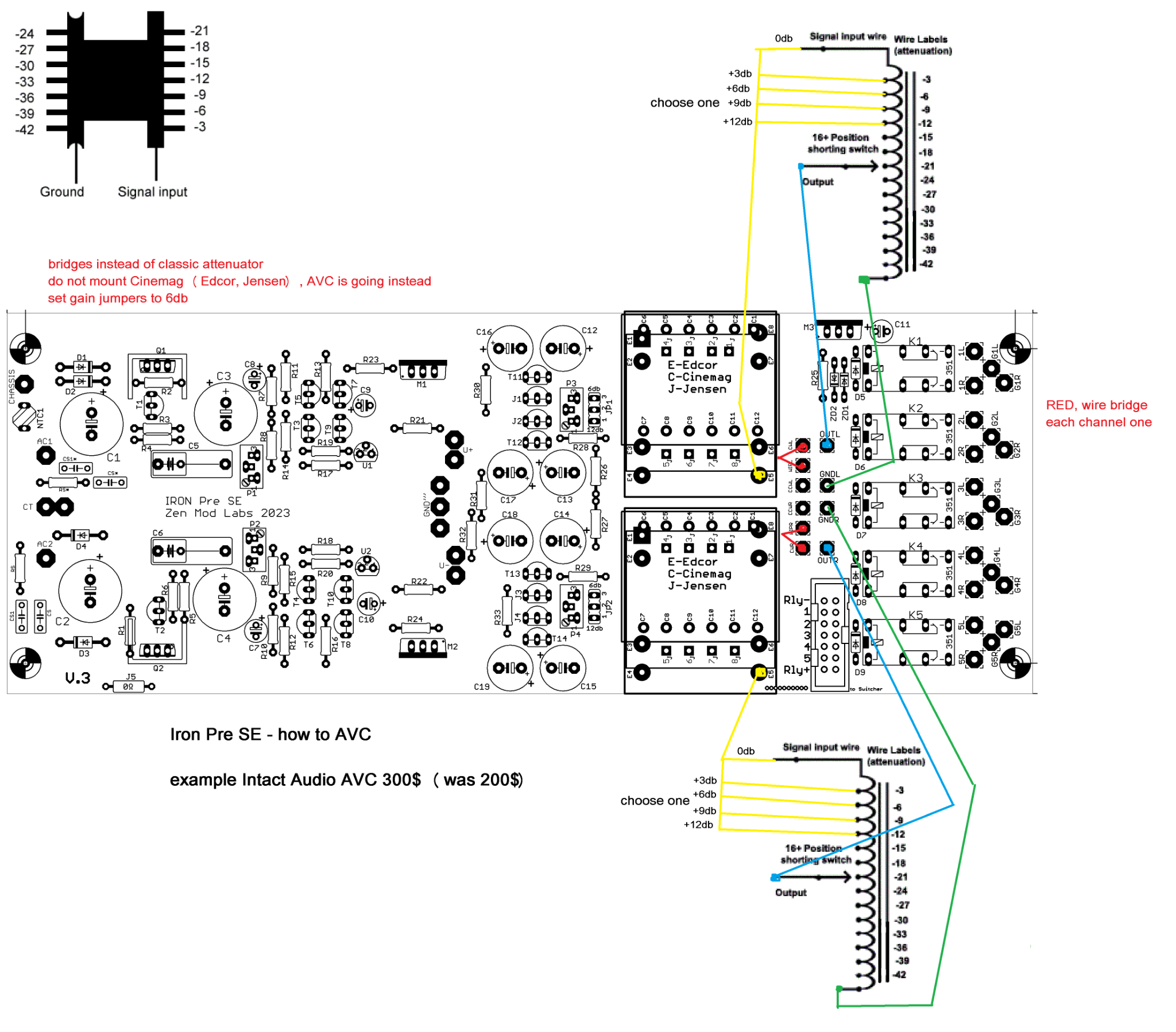

same logic for implementation
I didn't use TVC - they're not needed for my purposes
AVC is easier to get in same quality (sound wise) and it can reach better SQ than TVC
TVC is logical choice only if you need galvanic isolation between input and output circuits, and if galvanic isolation isn't needed, AVC is logical and better choice

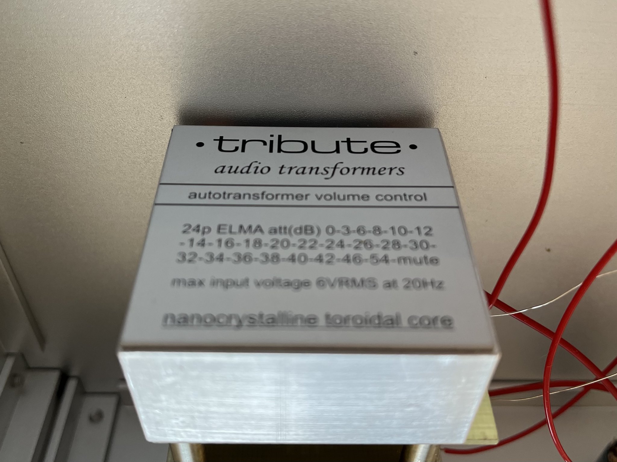

what's preventing you of trying it?
I've just checked on Sowter site, they claim it's easy enough load for preceding stage
I wouldn't be surprised at all, in fact - I'm sure it's better sounding option than any resistive attenuator
anyhow, if/when you decide, just buzz and I'll draw little sketch how to

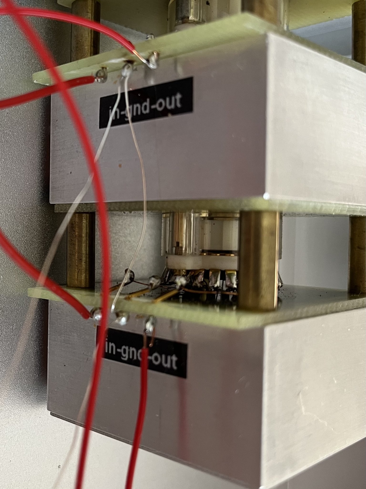

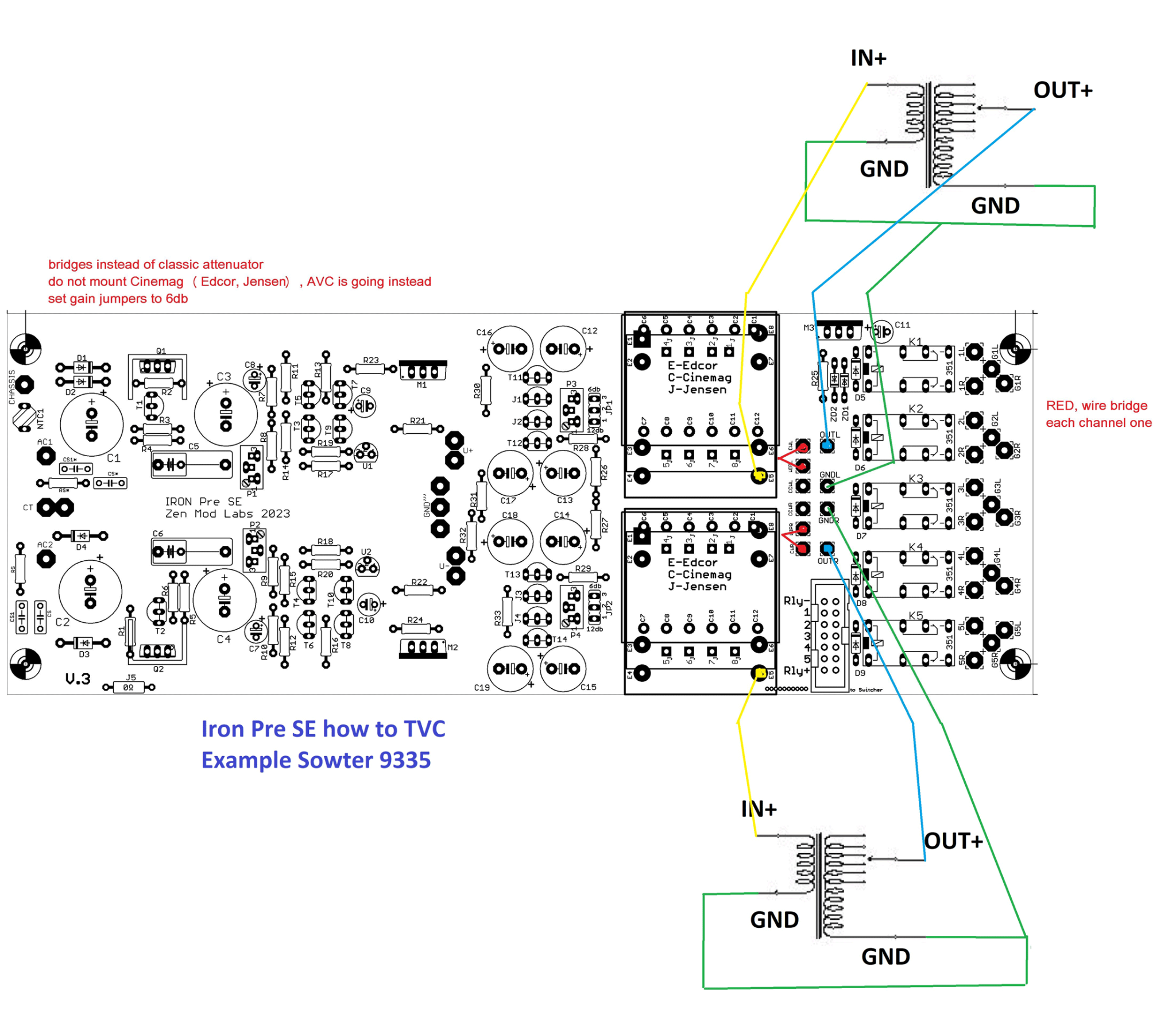

Iron Pre how to wire TVC
whichever gen of pcbs you have ( through hole JFets or smd ones) principle is the same
applies both for @Studley and @geoturbo
though, Tribute is AVC, but having defined IN-GND-OUT points, wiring is the same as shown here for Sowter TVC
reposted - Iron Pre how to wire Slagle AVC, just in case

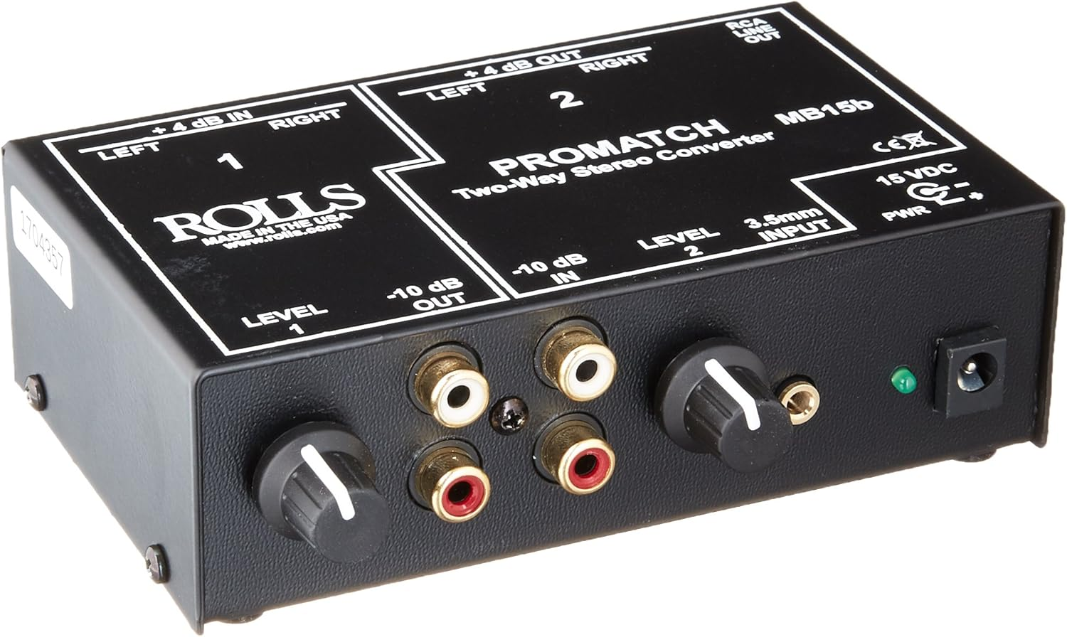

Ready to put the lid on and try it in my system. BTW, the Rolls MB15b Promatch 2-Way Stereo Converter is a great box to test the balanced I/O's without having to have balanced stuff on my test bench.

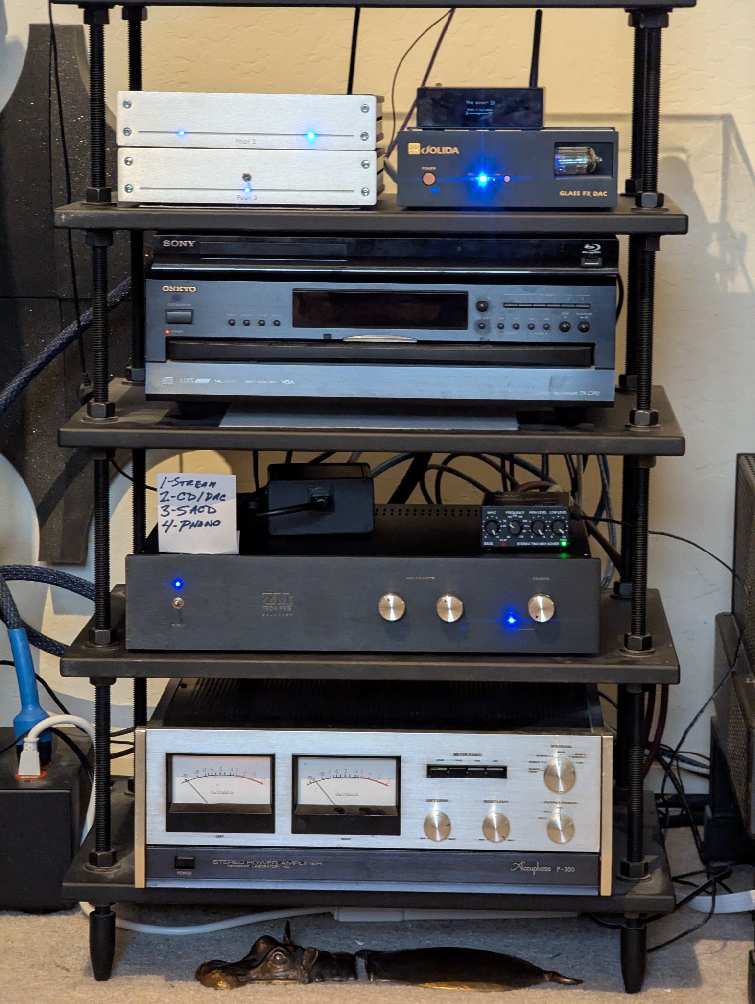

It's integrated into my system and singing. Replaced a Korg Nutube preamp with separate switch box.
Initial impressions are that it is more detailed and in control of the sound, especially the bass (Rhythmic subs with 1.5QR). Very pleased. Thanks ZM.
