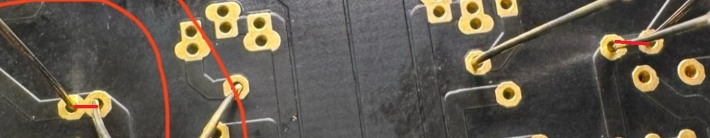

Was just checking the R7/R8 pad question since the pads for R9/R10 on my board were not joined.
physically they're not joined (kissing pads), electrically they are

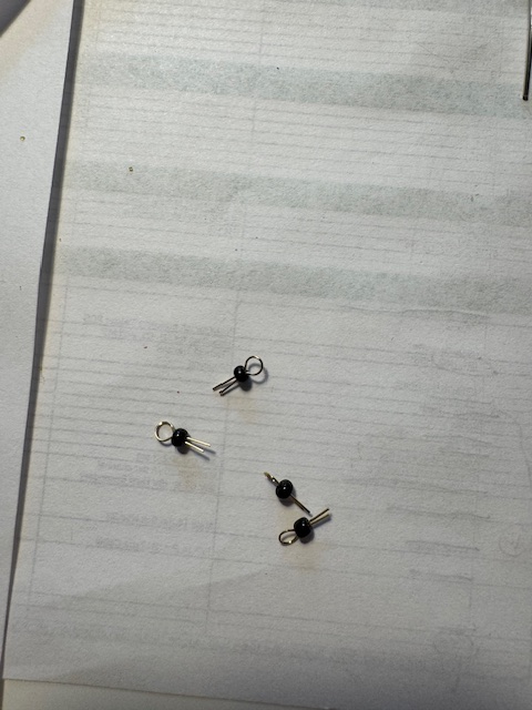

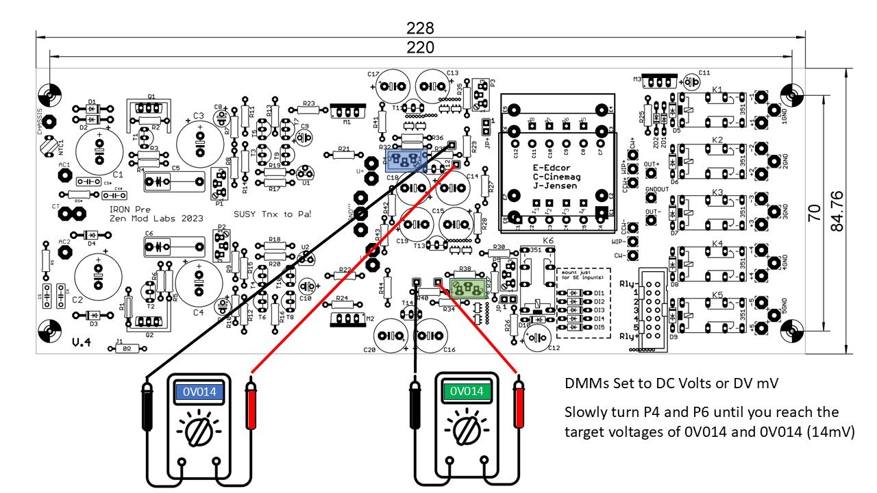

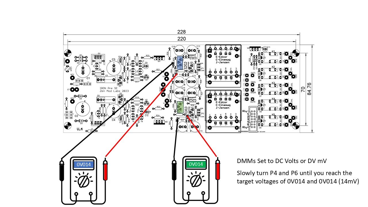

Hi All -
Someone asked a great question, and I am guessing some others may have a similar question.
In a nutshell, the question was: What are these?
They are listed as optional on the packing list. I added them later in the process. So, no... not everyone got them in their kits.
The technical term is - test point helper-outers.
I am a big ol' fraidy cat, and shorting something on a board while I'm trying to hold two probes, turn a tiny pot, and watch a DMM approach a precise voltage isn't something I want to experience (again).
So, if you got those in your kit, and if you use j-hook or mini-grabber probes, you can place those onto the square pads. Attach your DMMs, and rest a little easier that things won't go snap-crackle-pop. Take sip of coffee, twist the pot with your now free hand, watch the DMM delightfully edge toward 14mV and smile.
If you didn't get them in your kit, they are <$0.01 per piece from popular web retailers and/or you can make your own wire loop from an old component lead. Waste-not-want-not.
Attached (now in Post 1 too) are some hopefully helpful diagrams.

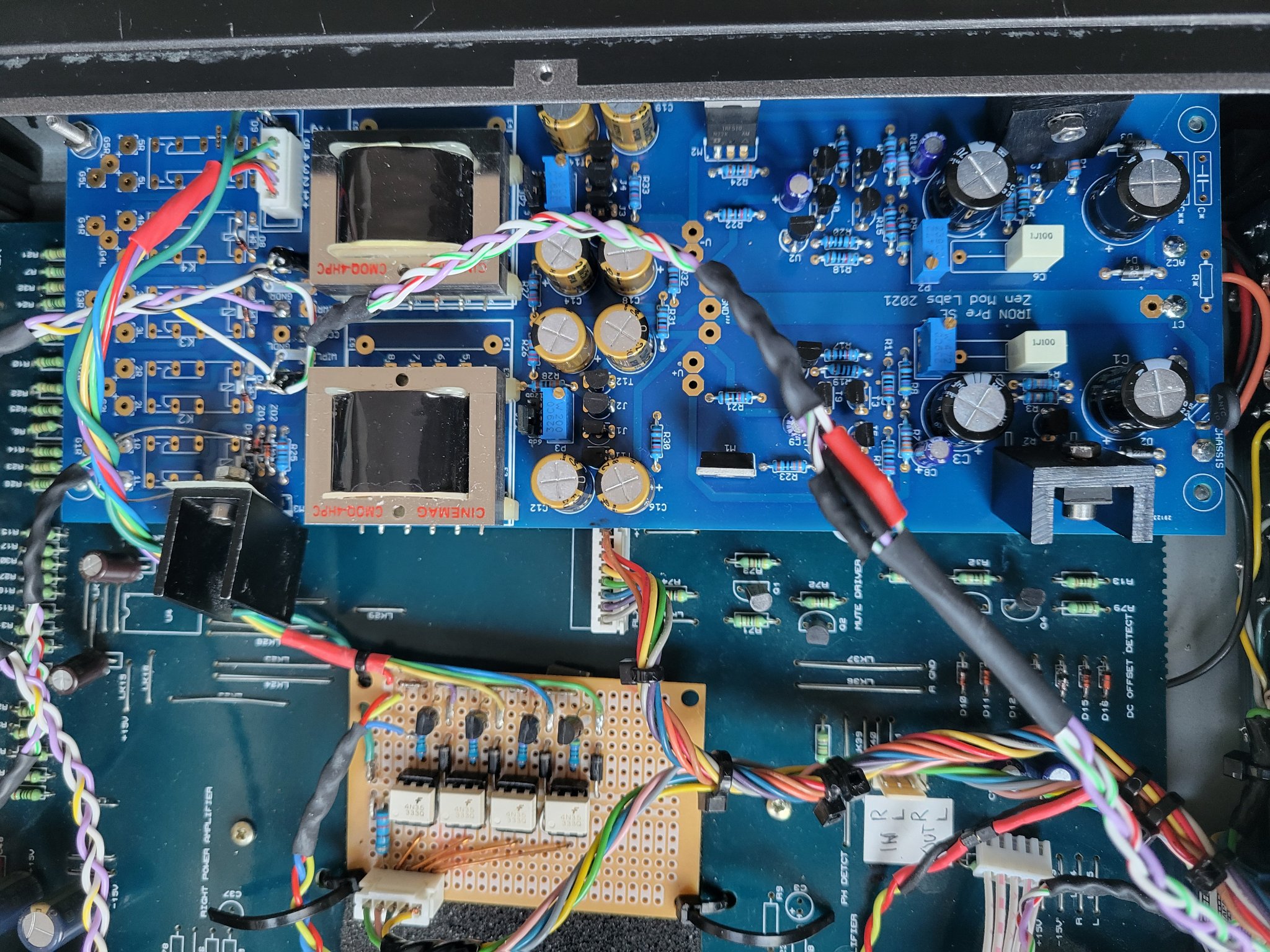

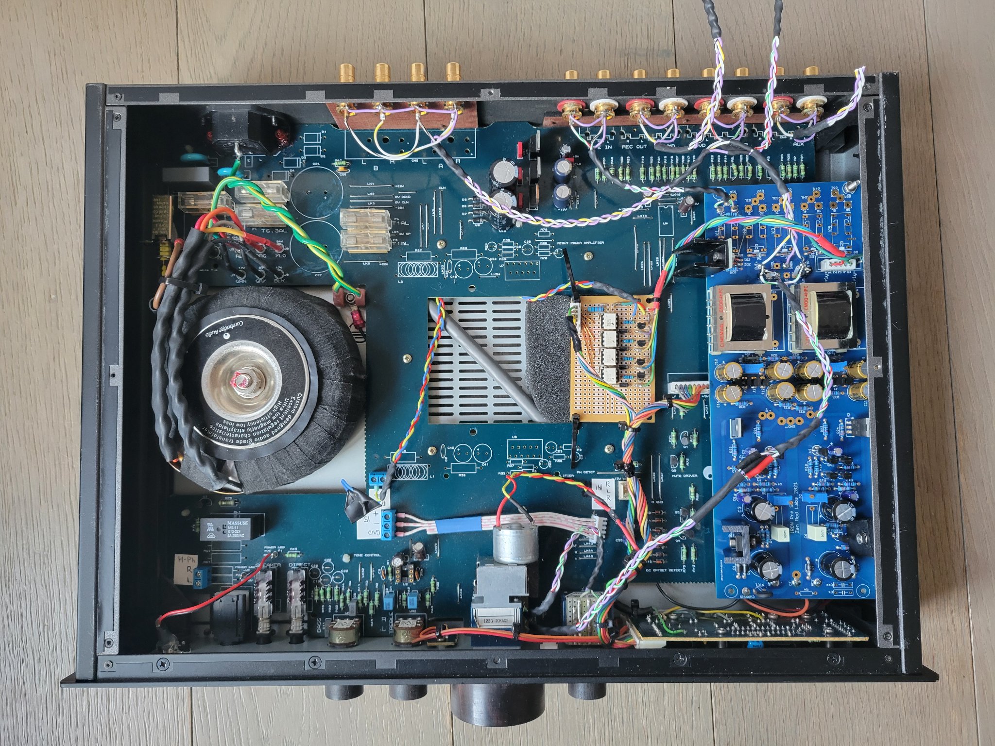

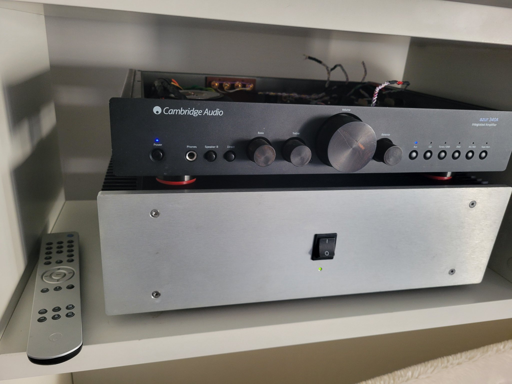

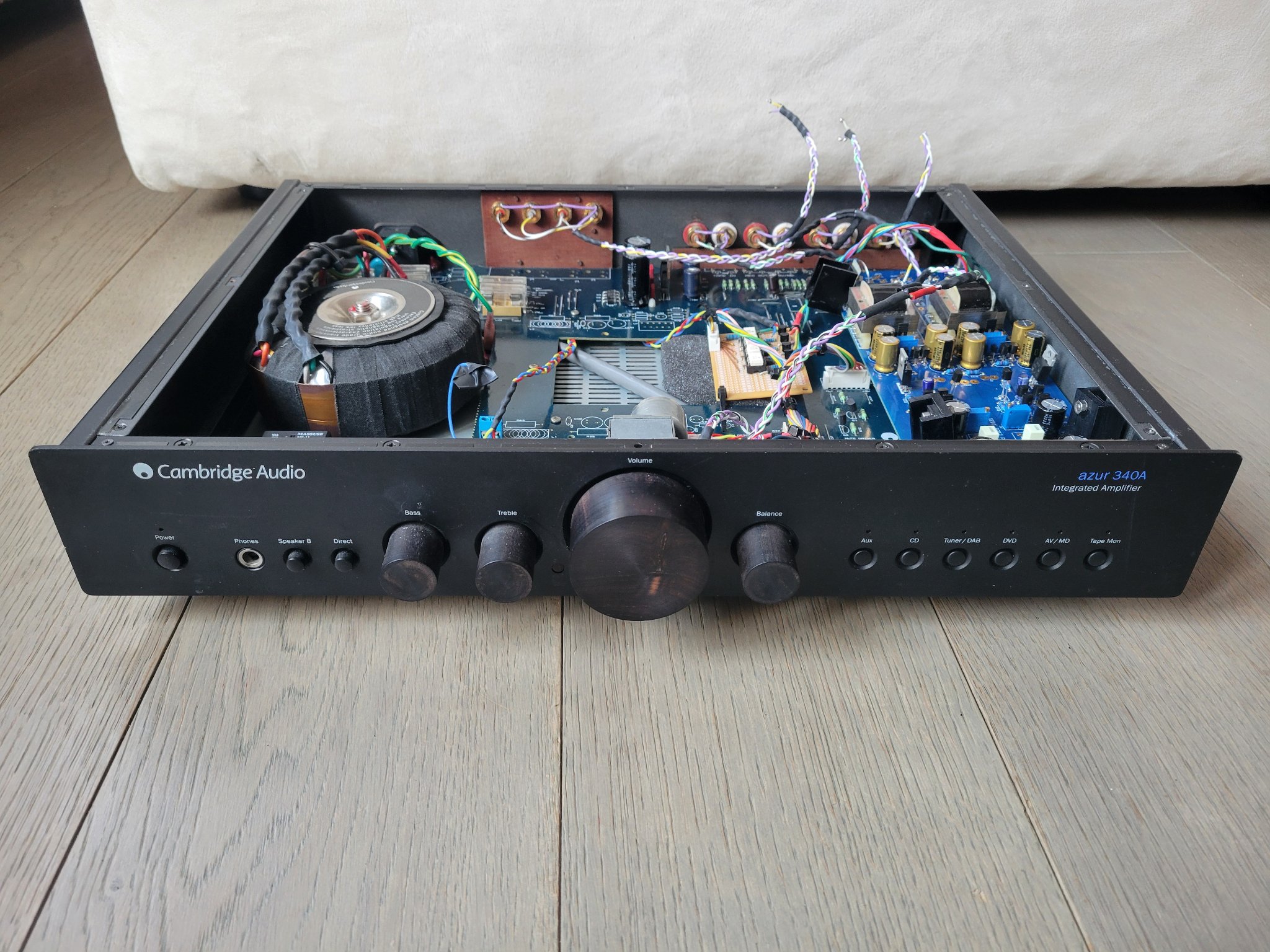

Another Iron Pre SE sings beautifully!
Gladly I think I got the relais thing right with no magic smoke released (fingers still crossed), directly wired one single input now for the lack of relais which are added to next cart..
Really silent as a mouse despite the volume pot is on the front.
A big thank you to @Zen Mod @Nelson Pass @6L6 and @ItsAllInMyHead for this great opportunity.
The amp is housed in a former Cambridge Audio Azur integrated amp case, I have no credit for this, the former tinkerer @sasha70 made the most, I just adapted the Iron Pre to it and benefitting from remote volume control 😉
See some pics, have fun with yours!
Ps. XA252 amp by @schultzsch beneath is also great!
