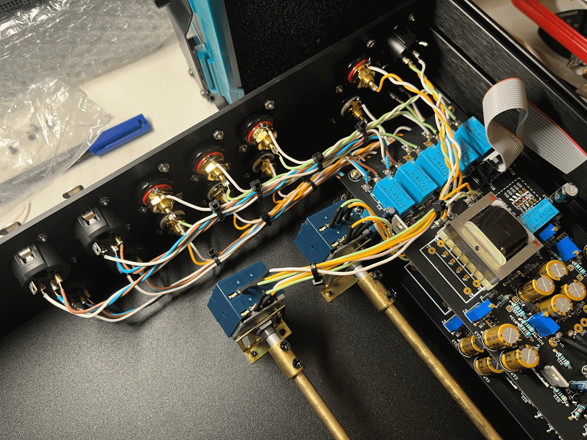

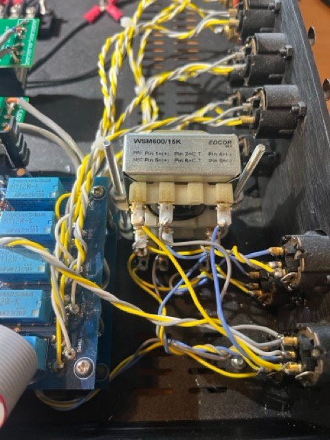

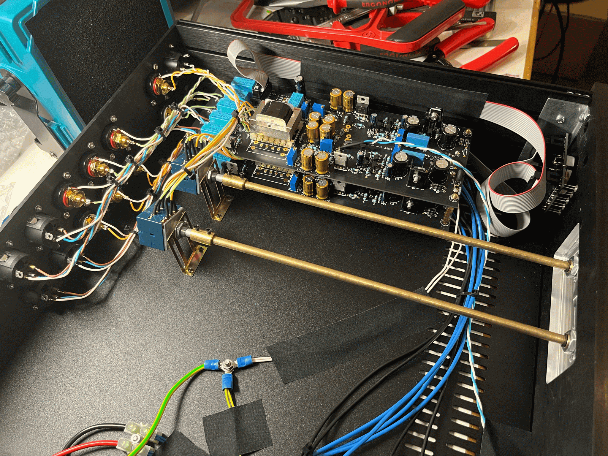

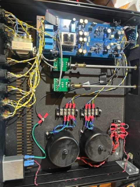

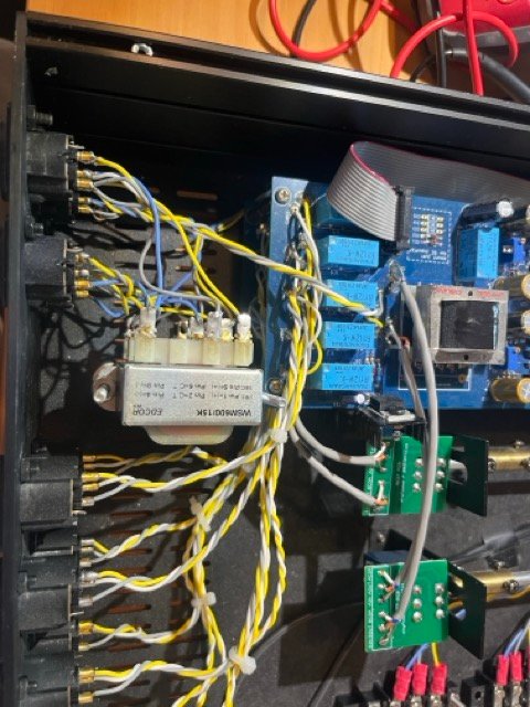

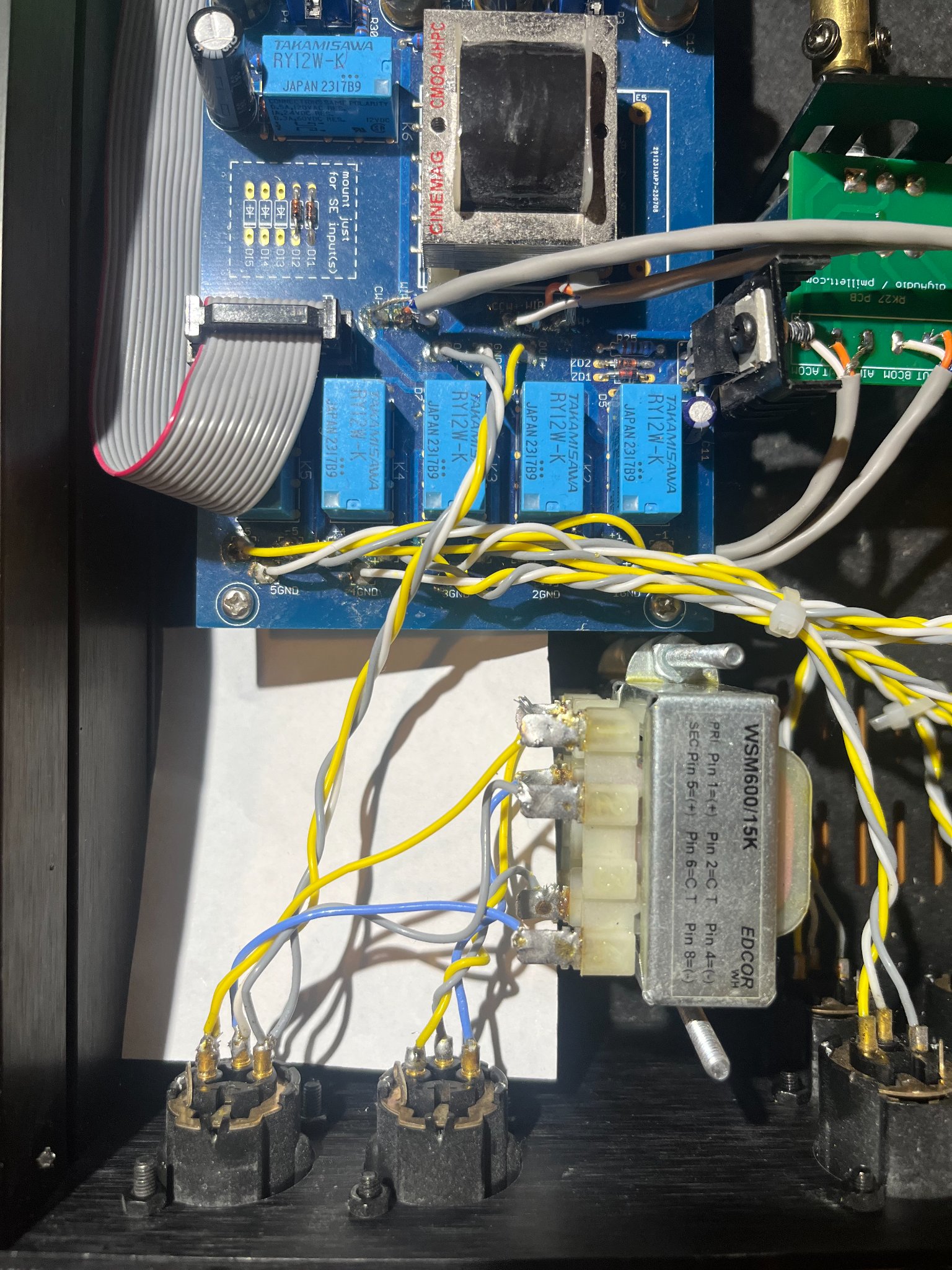

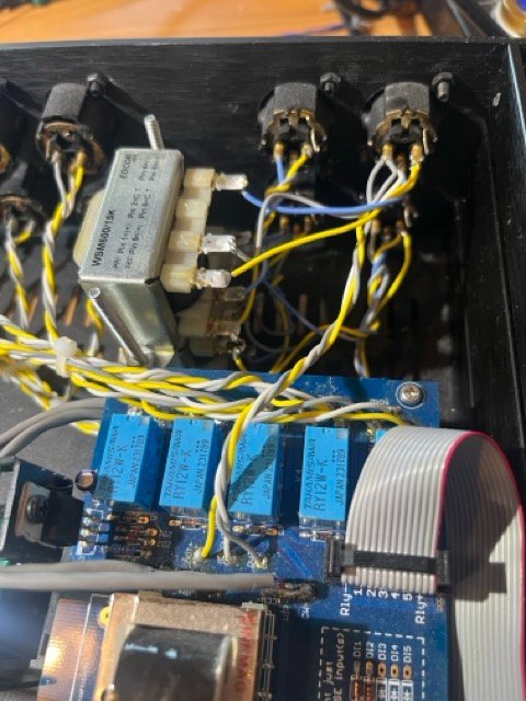

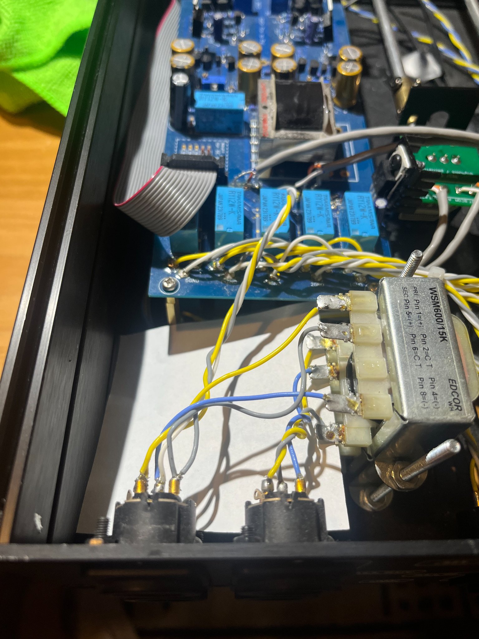

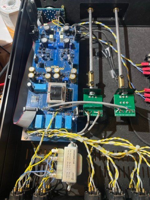

:scratch: How, exactly, is this wired…?
Photos and schematic please. 🙂
It's a headscratcher for sure. I'm sure I messed up the wiring somewhere along the way. Here are some pics. I attempted to wire it as described by ZM in #2,626.

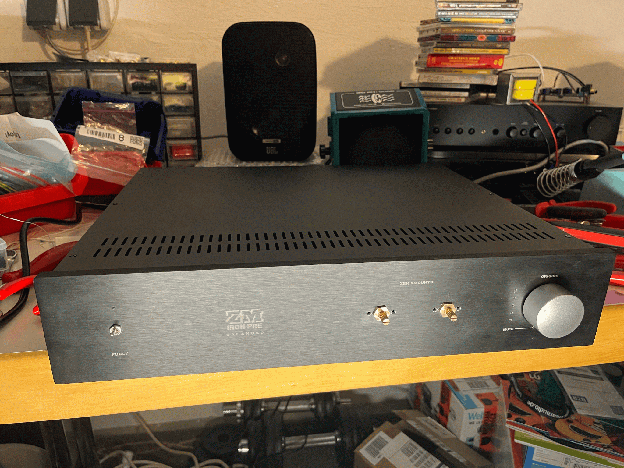

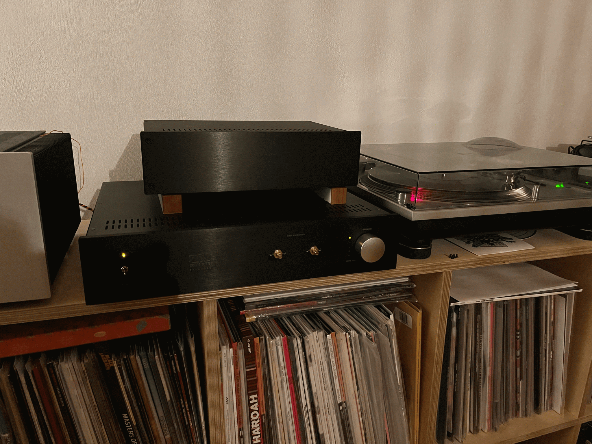

Hello Everyone,
another IronPre is singing. Thanks a lot to Zen Mod, Nelson Pass, Patrick(DiyAudioStore), 6L6, and everyone else on this wonderful Forum! It’s become definitely one of my favorite places on the internet 🙂

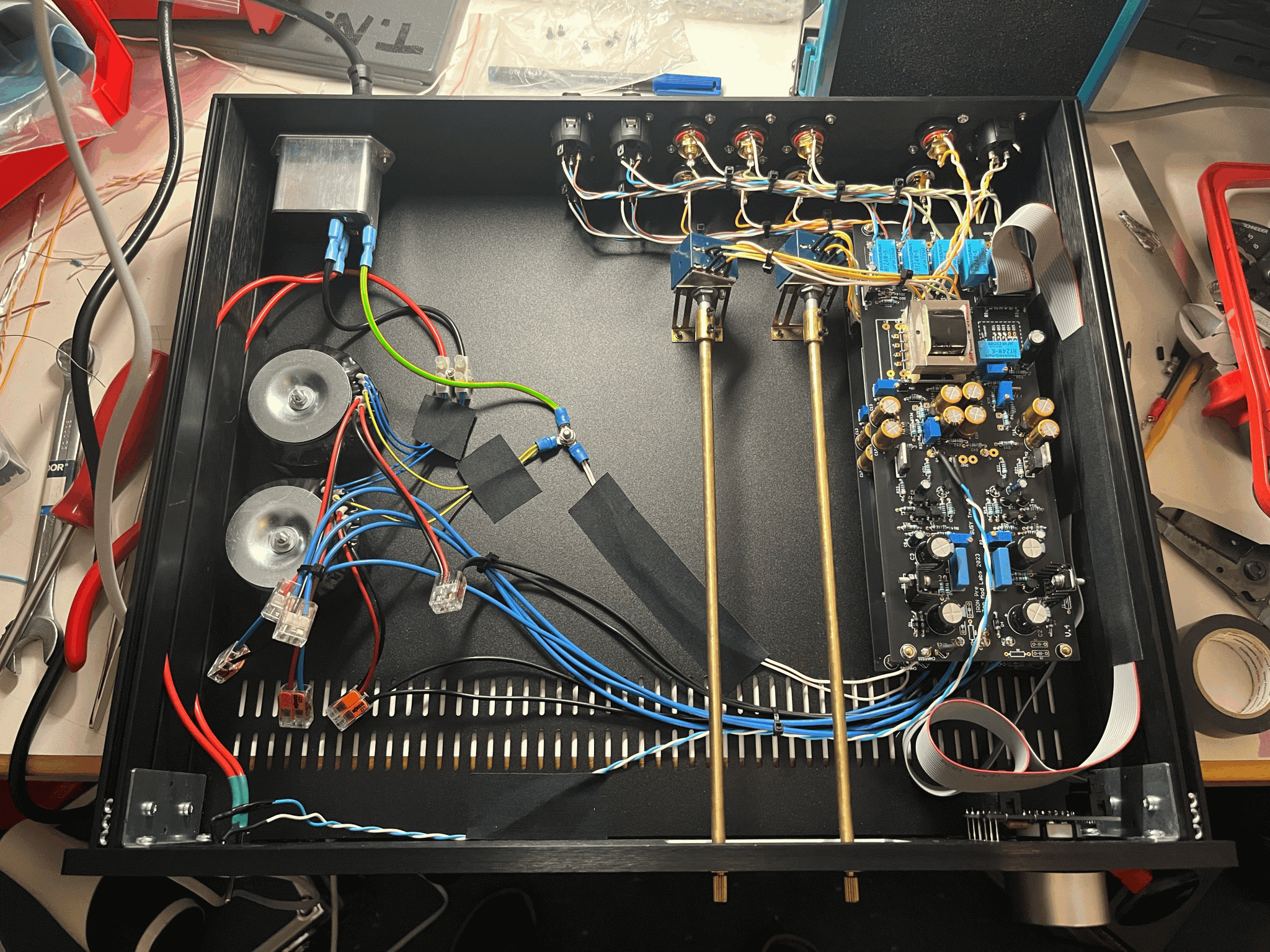

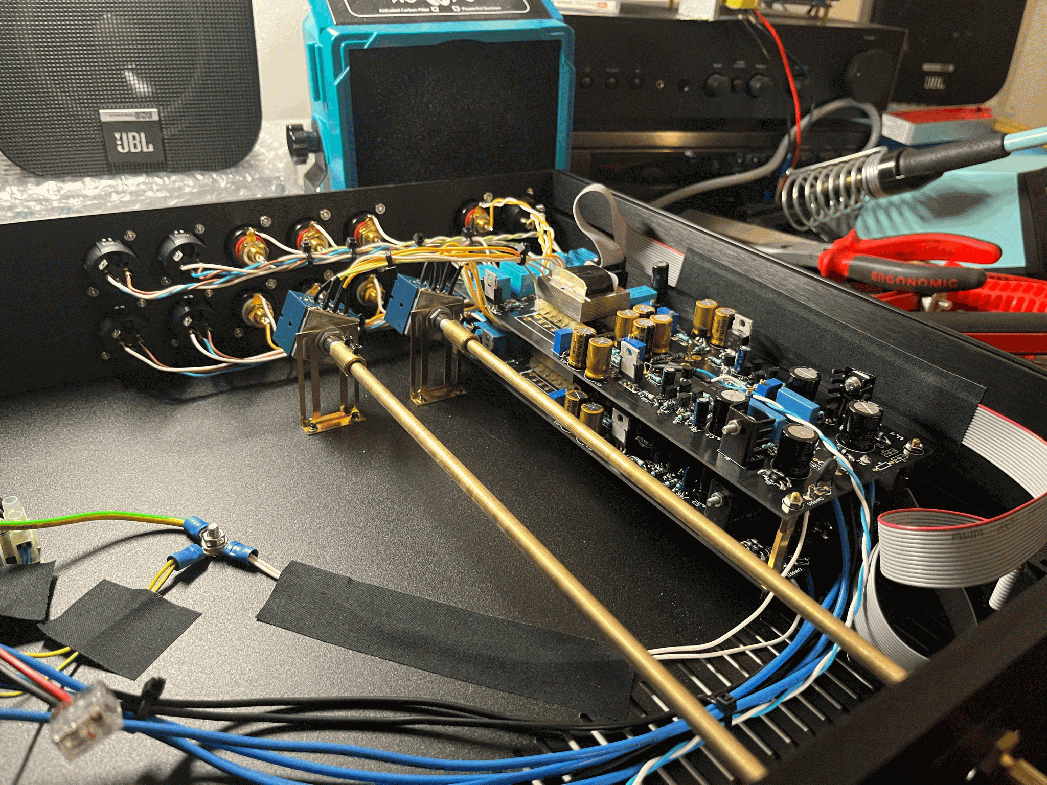

My IronPre still needs some knobs, and maybe I have to tidy up that left side a bit more. But I’m already really happy with the sound of it! It is singing alongside my Aleph J and Pearl 2 builds on some vintage Cheviot HPD’s (last photo). Very fun Preamp and Project!
The build was like already mentioned by 6L6 in his guide very straight forward. Although M1 and M2 do get hot, which worried me a bit during the first power up and setting of the voltages.
The SissySit is next 🙂
All the best from Blackforest Germany
Tobias

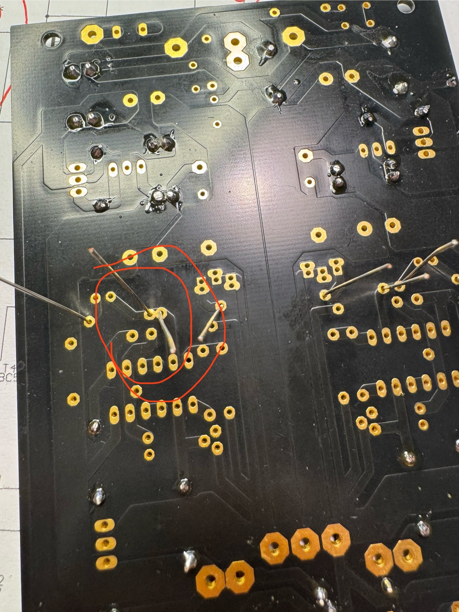

Hello,
Just starting a SE build using 2023 v.4 board, essentials and supplemental part (arrived this week).
Two questions.
Do the length of the zener diodes (shorter or longer) reflect the part name (zd1 or zd2) or voltage? Not able to reliably test them (limited equip / knowledge)
Next on the back of the board, for R7 and R8, the pads seem to be joined. Is this correct, and if so i assume its fine to have a solder bridge at that point (not sure how to avoid it). See pic
Please advise, thanks!
Hello Chedma,
try to see what is written on the diodes and identify them that way. You might need a magnifier and a light, since it is really small.
For your second question, you can always have a look at the schematics if you are unsure. But in this case you can also see that both pads are on the same conductor.
