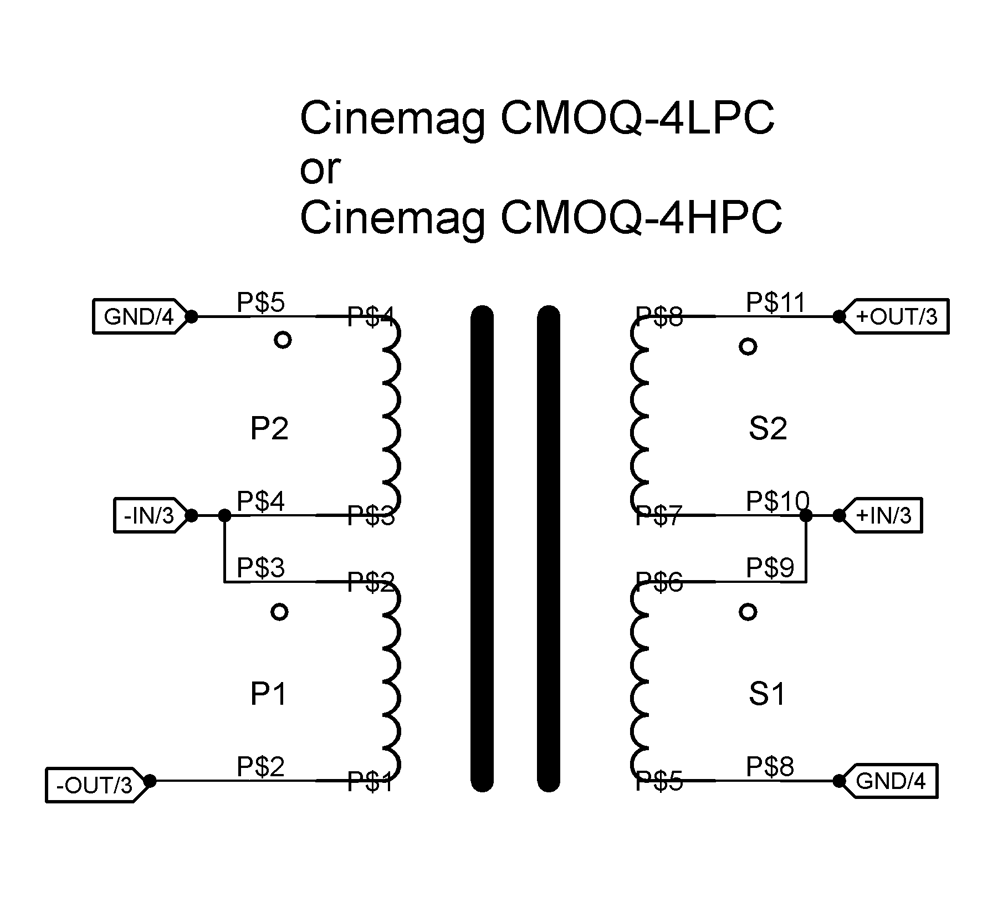

That is unusual. I don't see anything on the boards. Can you check the actual resistance, please from just the GNDOUT to the Out+ and Out-. Also, just quickly check OUT+ to OUT-.

Ugh, I was hoping you weren’t going to say that. Here’s what I measure:
GNDOUT to OUT+ is 54 ohms
GNDOUT to OUT- is 53.5 ohms
OUT+ to OUT- is 107.2 ohms
The other board had similar results.

Thanks Patrick! I did consult those diagrams before I posted, but I just wasn’t 100% certain of what my measurements were showing. Another bit of knowledge gained here in DIYAudio U!

Glen clearly has it under control, but for those that may wonder...
The diagram showing the Cinemag transformer is a bit more clear, IMO. It is showing that:
With a fresh Cinemag CMOQ-4HPC...
Pin 2 to Pin 4 - 27RX
Pin 3 to Pin 5 - 27RX
Pin 8 to Pin 10 - 27RX
Pin 9 to Pin 11 - 27RX
Pins (2 and 4); (3 and 5); (8 and 10); (9 and 11) are the 8 ends of the 4 windings.
So, if we short pins 3 and 4 and measure from 2 to 5 => ~55R
Similarly, if we short pins 9 and 10 and measure from 8 to 11 => ~55R
Pin 5/8 to Pin 2
Pin 11 to Pin 2
- Out+ In+ and GND are all in series with each other.
- Out- In- and GND are all in series with each other.
- Since GND is common... they're all in series with each other.
Pin 5/8 to Pin 11GNDOUT to OUT+ is 54 ohms
Pin 5/8 to Pin 2
Pin 11 to Pin 2
