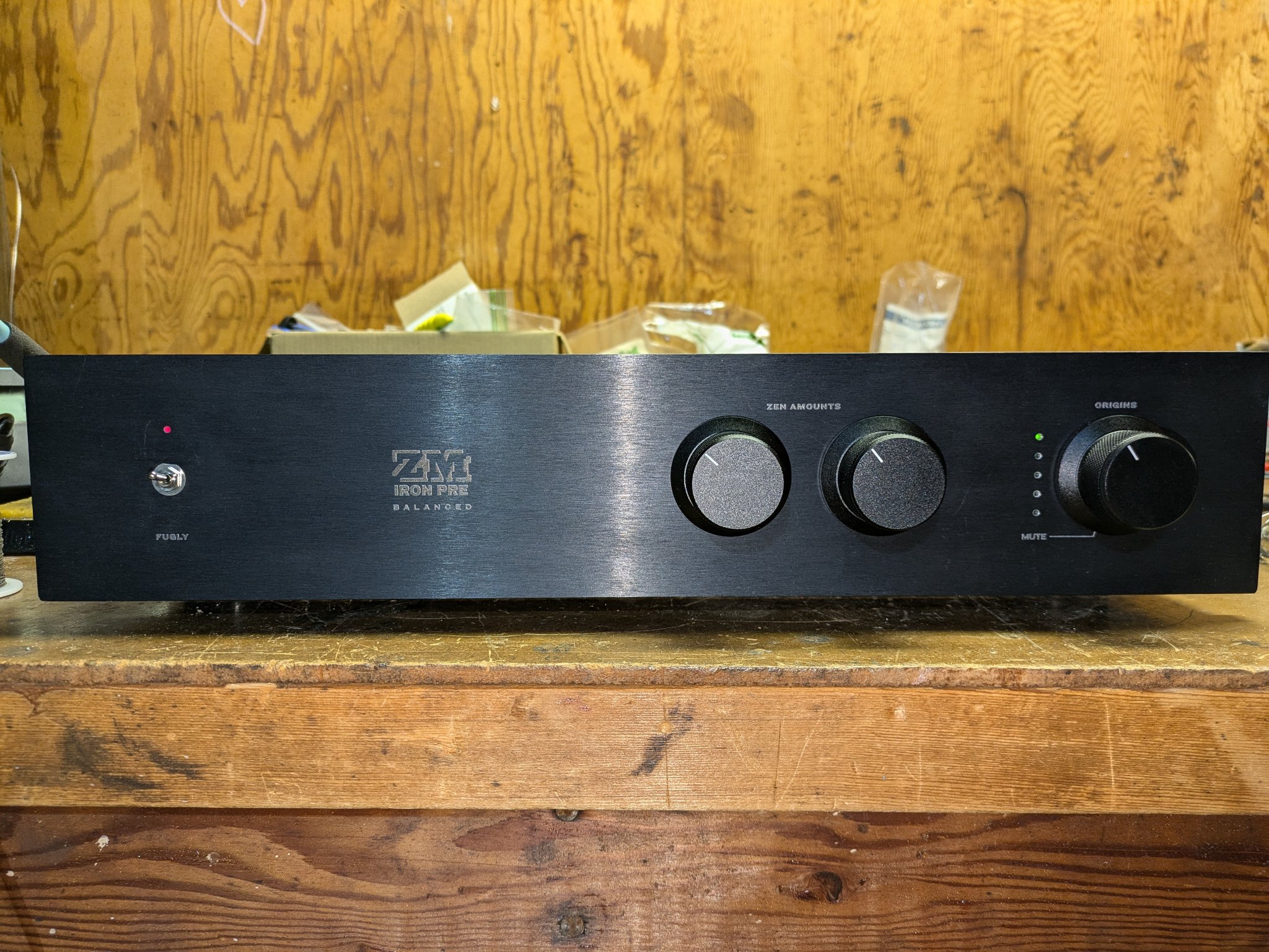

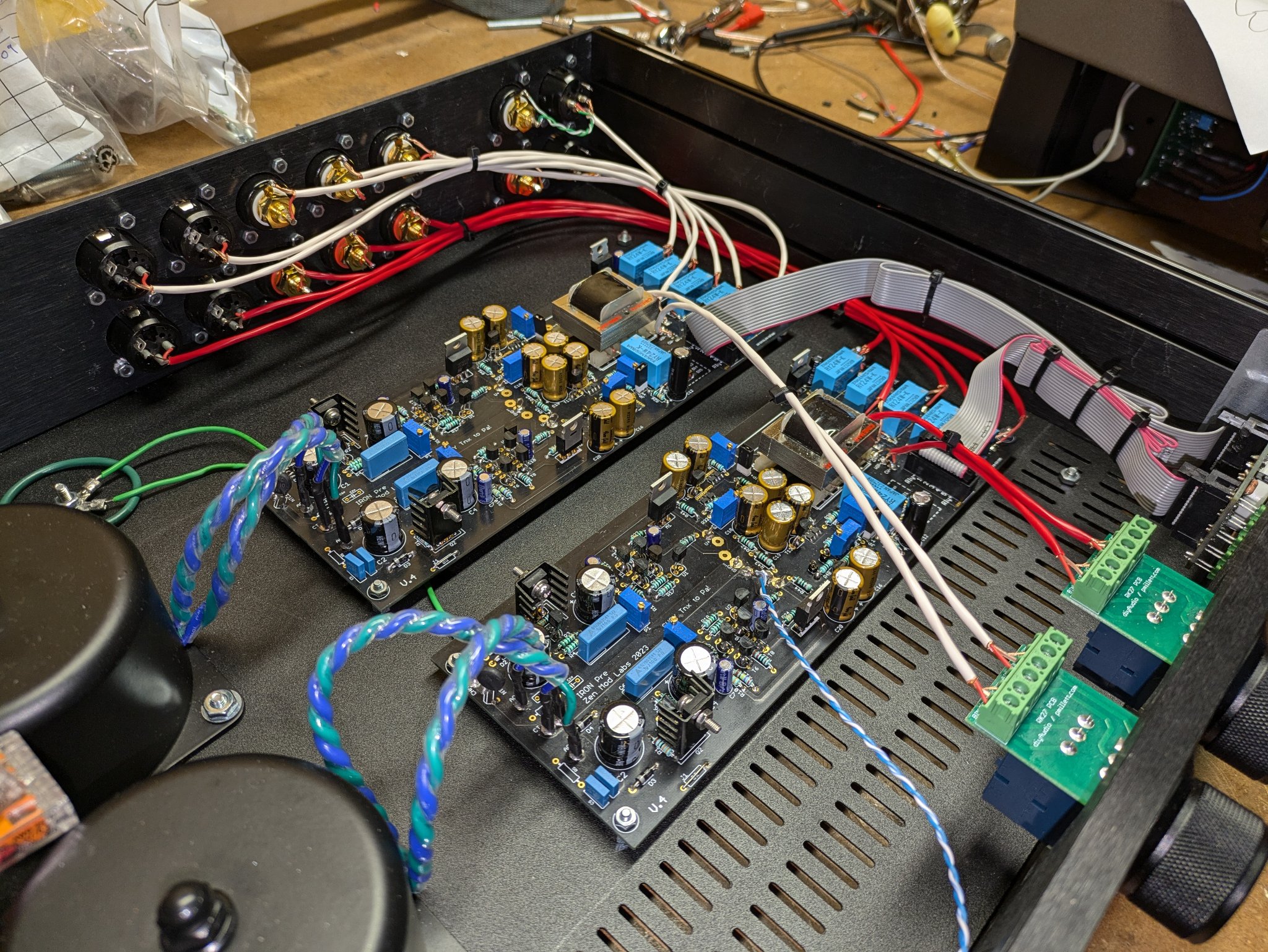

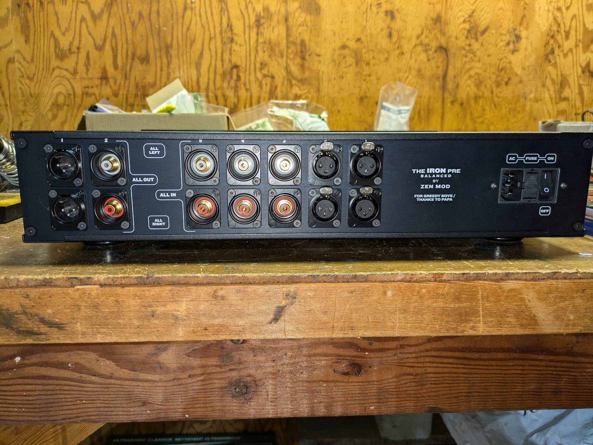

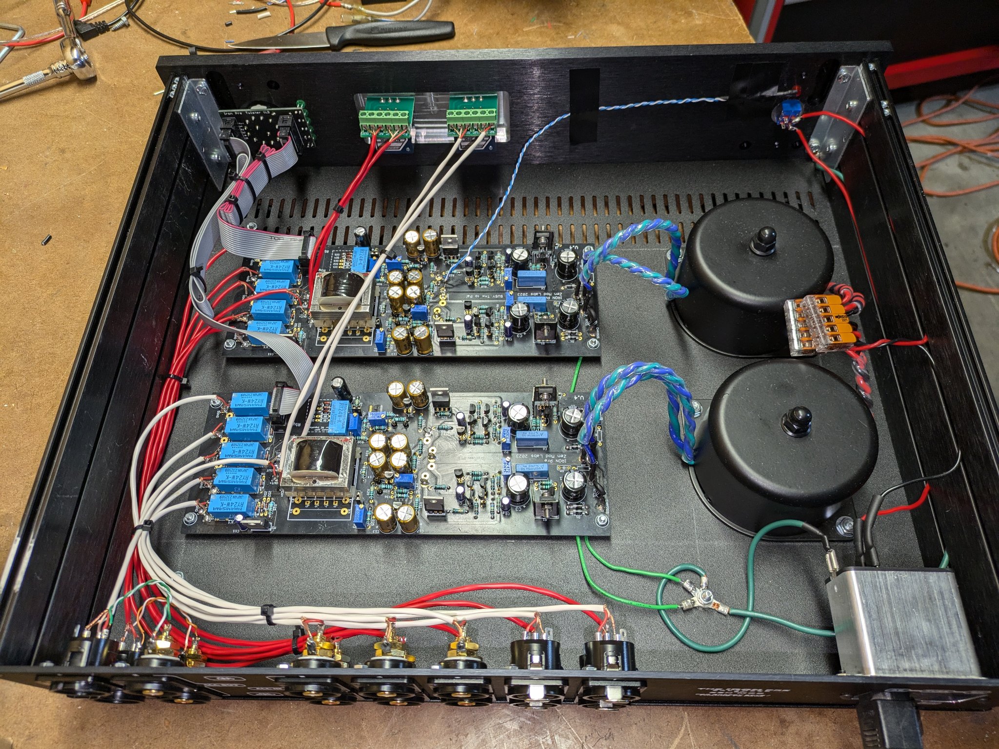

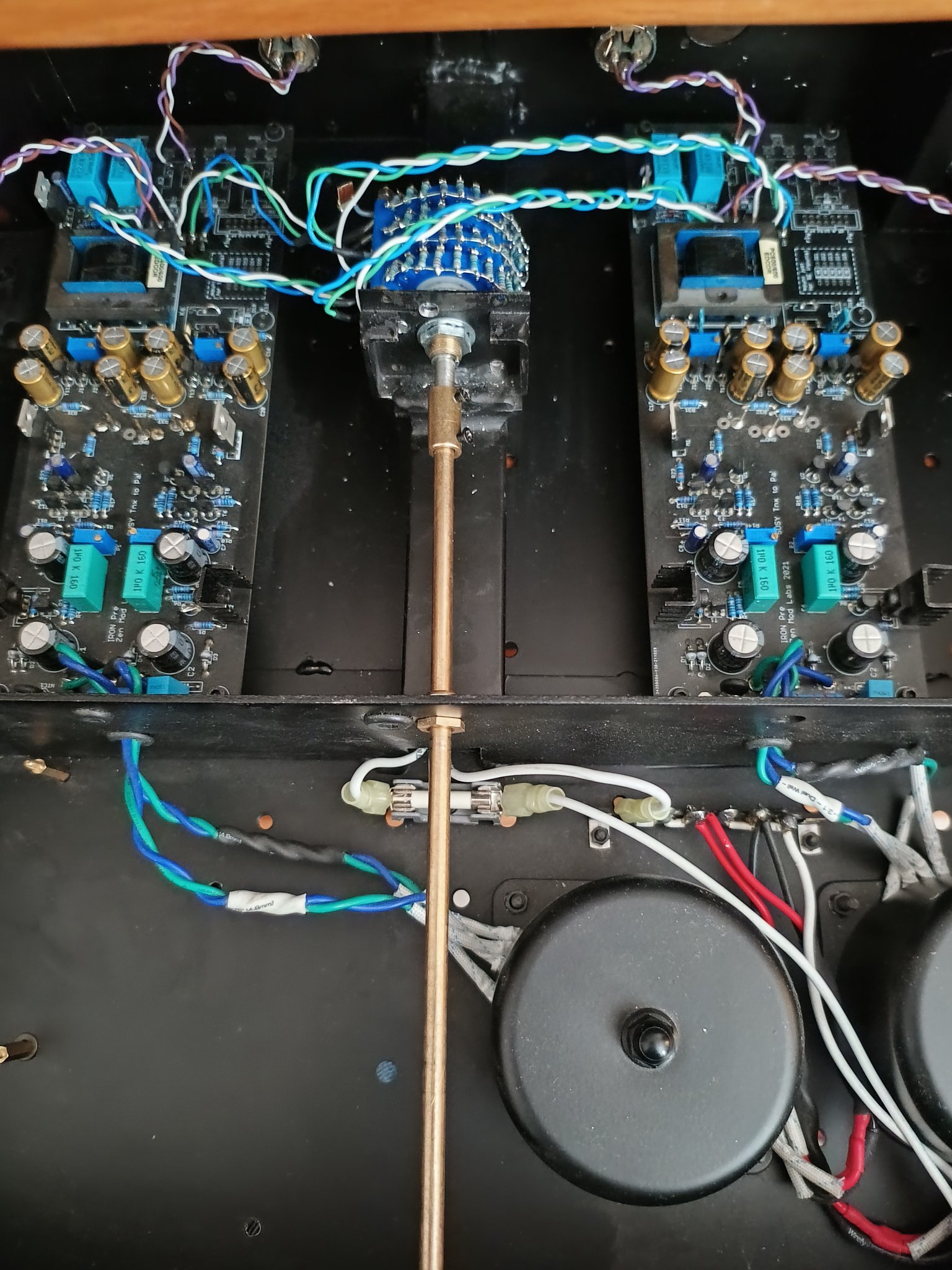

Another Iron Pre is singing! Wow this is truly an awesome gift, huge shoutout and thank you to Zen Mod, ItsAllInMy Head, Mr Pass and all the helpful people on this forum! It is dead quiet, but the sound it produces is clean, detailed, and very engaging. I am somewhat new to diy audio, the build guide and the threads were extremely helpful. I learned a lot on this build, a lot of firsts for me.
Thank again for this wonderful gift!

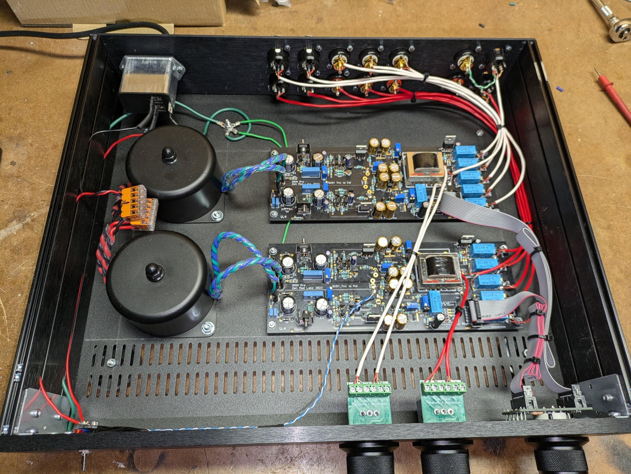

Not a kit, but I can't help but share me enthusiasm for this wonderful preamp.
Built from earlier boards from Jim. Cutting and welding involved of a clapped out crest power amp chassis. AC routed through 12 gage square tube. That's what I had.... Ultra isolated power supply with lots of steel. Hifi collective shunt attenuator really was an incredible shift in SQ. Uncanny. Aside from iron, is there a better circuit to attenuate? 2 resistors. Well 4 total bal. Zfoils in the right places. Perfect.

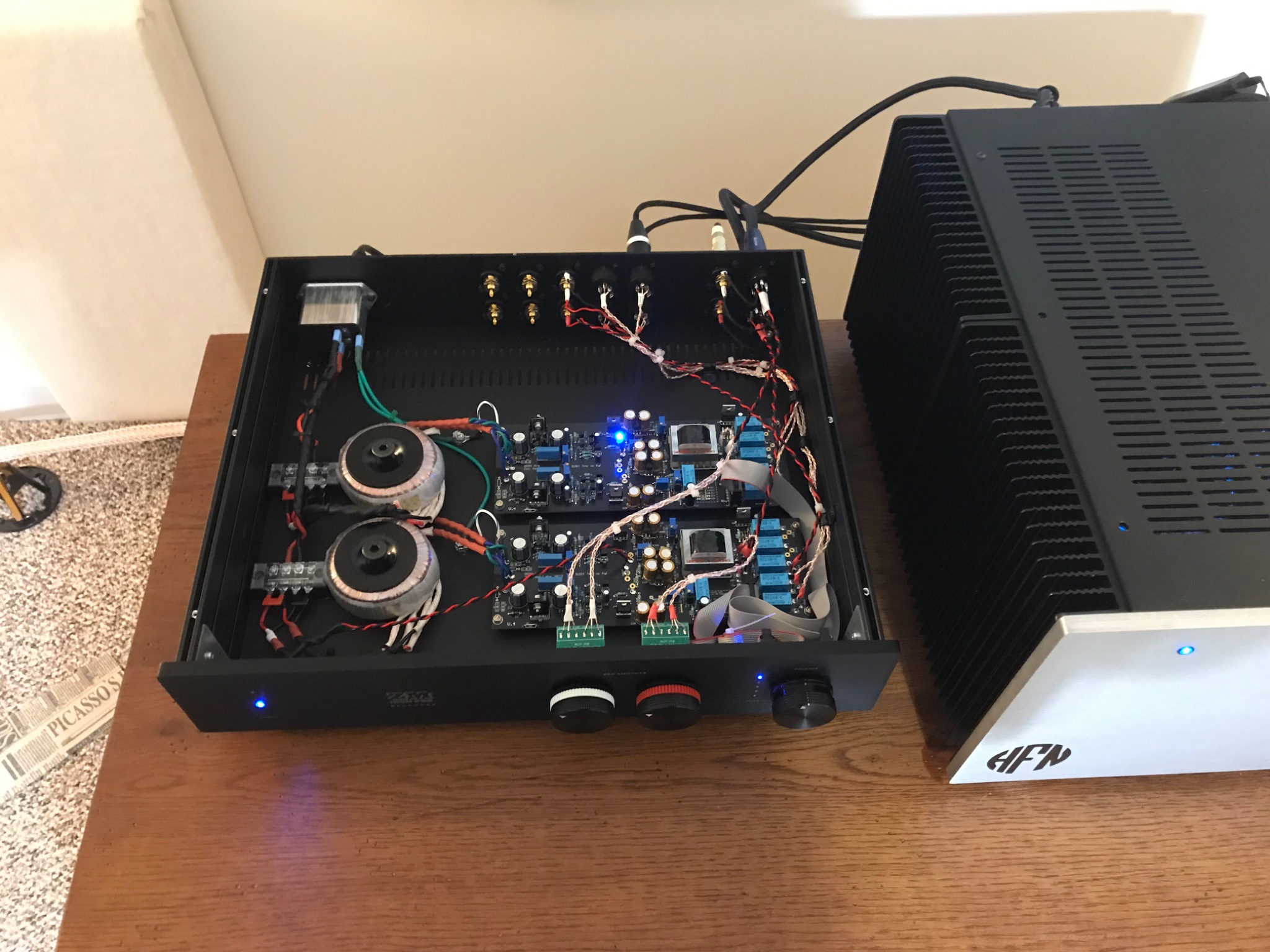

Here's mine. This was really fun to build. Sounds great.... dead quiet. Thanks to everyone on this thread for the tips and entertainment.

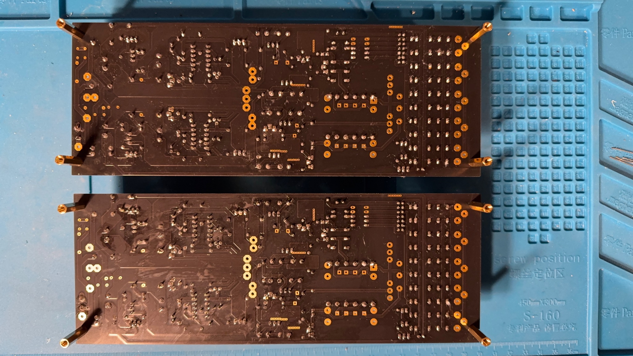

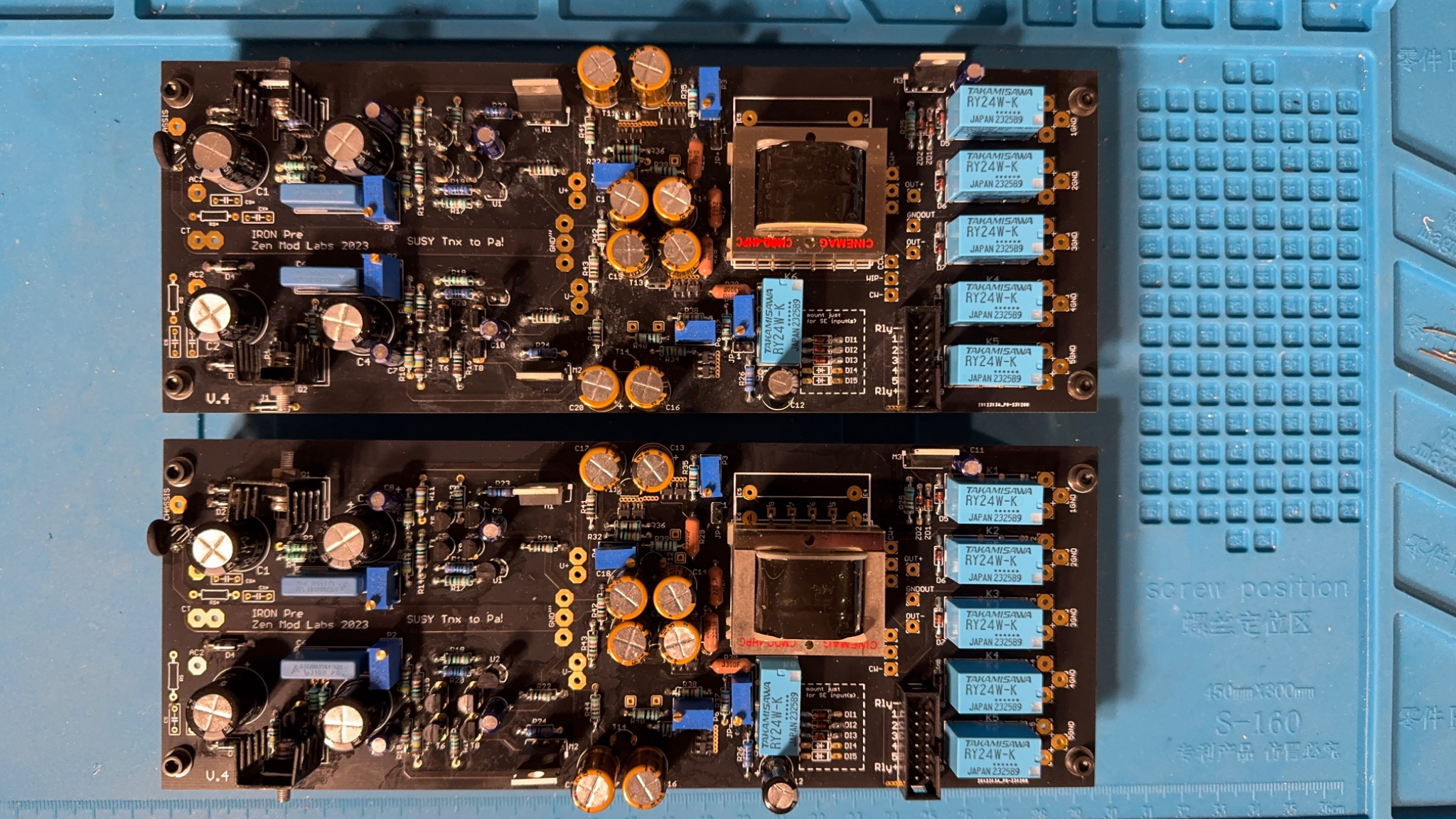

I completed my boards and was toning things out before firing up the Iron Pre for the first time when I noticed both of the Out pads, plus and minus, are going to ground. This is the situation on both of my boards, jumpers on and jumpers off. I am not finding any solder bridges or misplaced parts on my boards. I can’t tell from the schematic or from the “eagle” board traces pict if this is the normal situation when the boards are powered off.
BTW, I noticed a lot of builders leaving the snubbers out on these later boards. I Quasimodo’d my Antek AN0218 with the standard C values and found R to be 34.5 ohms.
Thanks in advance for any guidance provided.
-Glen
-Glen
