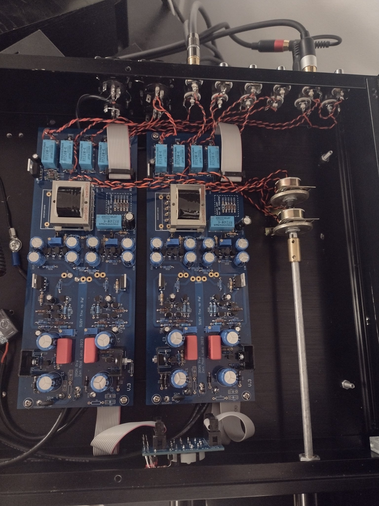

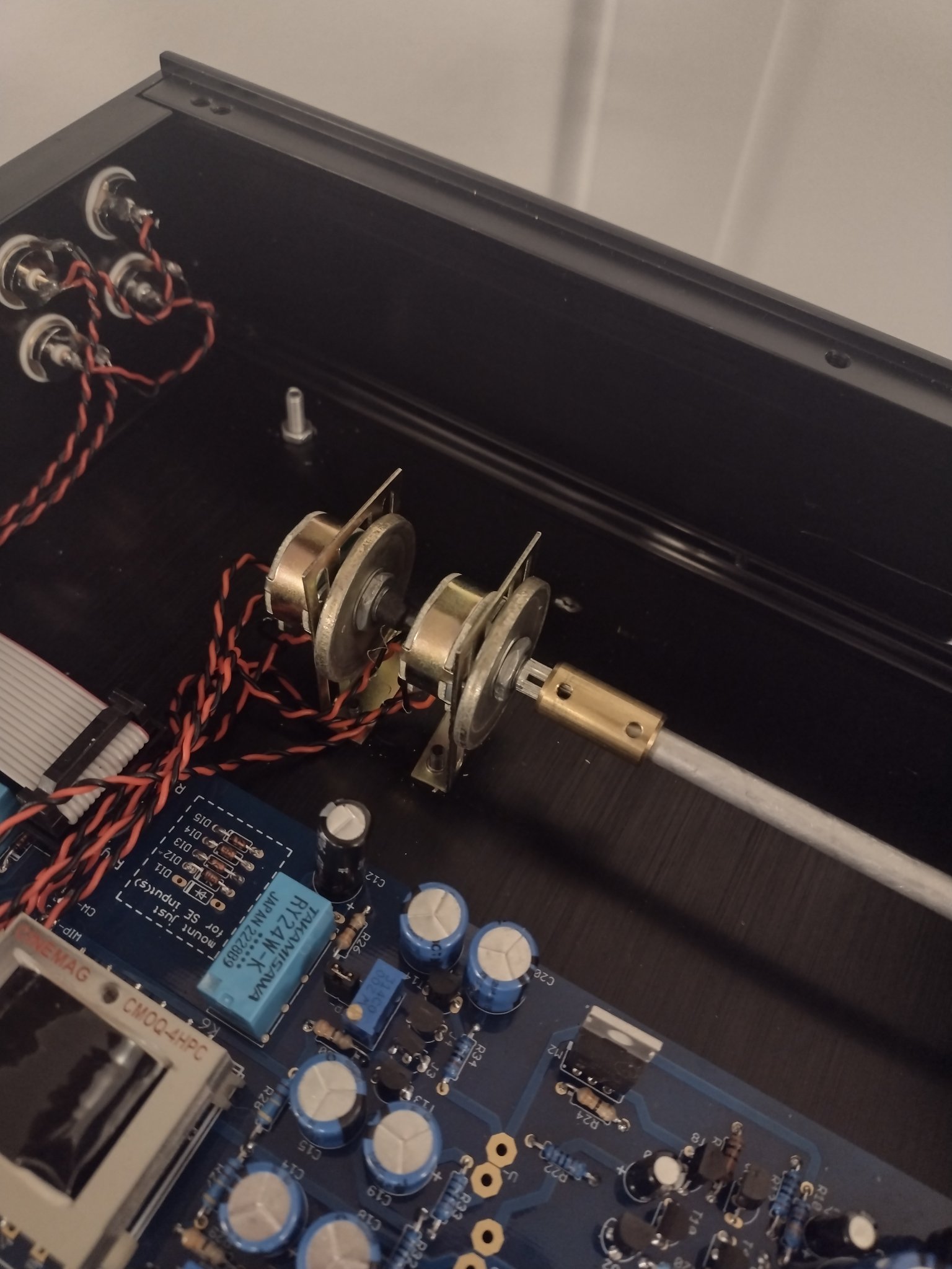

I originally was using a ALPS rk27 4 gang for my Iron Pre. On many of my other preamps I have used the very high value(cheap Dact style smd stepped attenuaters(15cdn) and thought they sounded excellent. For fun I thought I would try to combine two of these ebay Dact Attenuators and turn them into a 4 gang version. I filed and cut a hex screw driver bit down and removed the sticker backing of the one unit to combine the two. Sounds really good so far.
Just in case anyone is on a budget like me and cant afford TDK or Goldpoint, lol.
