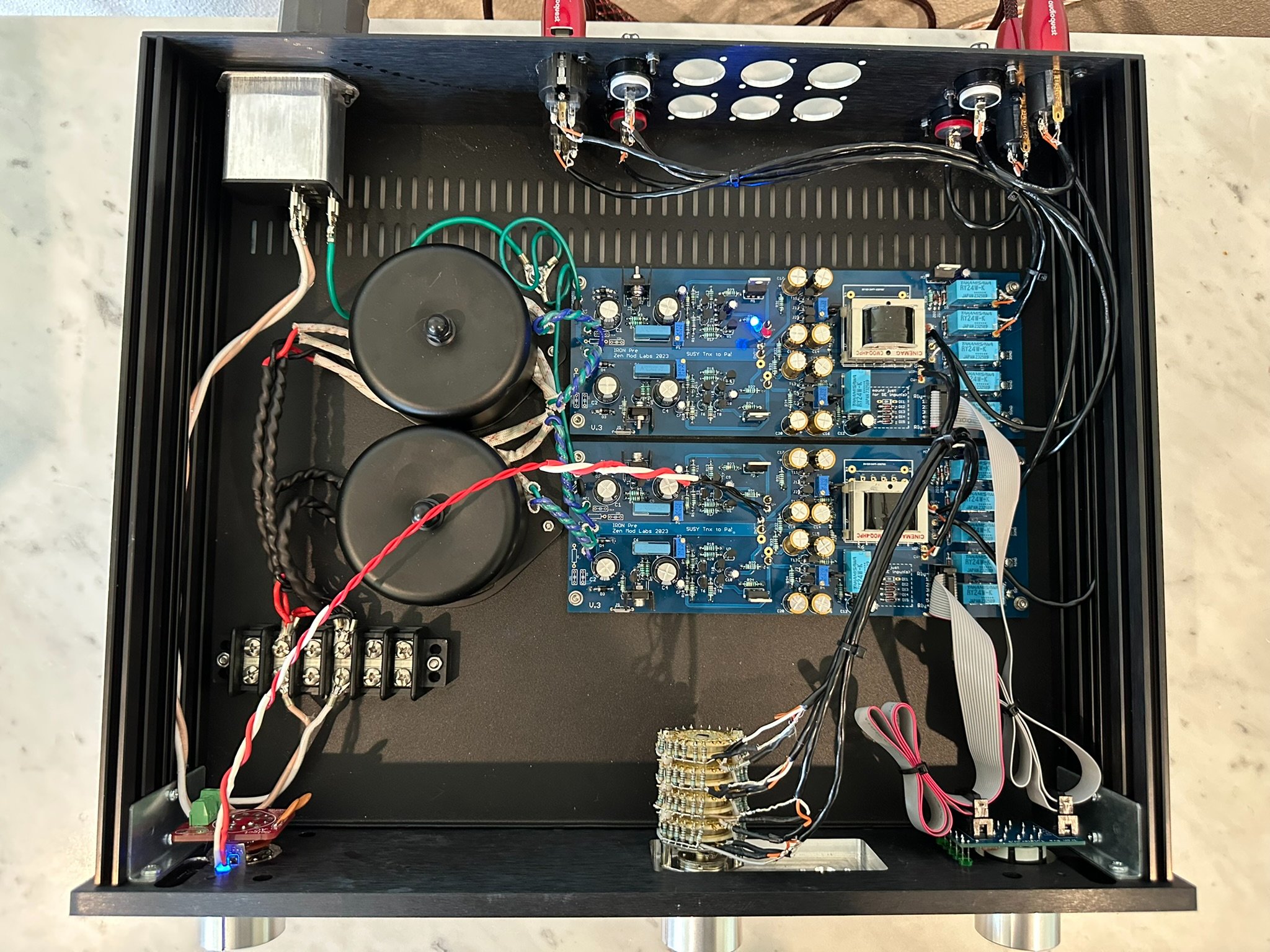

I just got my Iron pre balanced up and running. This preamp is mighty!
