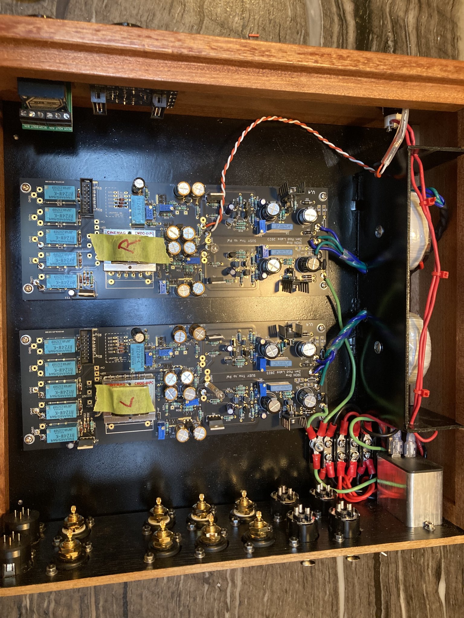

I've finished the Iron Pre boards, made the cabinet and wired the AC side of things while I wait for a fuse drawer for the IEC (didn't come with one). Input/output wiring and testing soon. I've included a photo of progress so far. My question is do you see anything at this stage that looks wrong, questionable or just bad practice. I continuity checked the AC side; everything appears to be connected to everything. On the terminal block I get beeps between the positive and neutral (red and black) but not the ground. Is that because the transformers are in the circuit? Trying to minimize future smoke!

I wanna see more images of the hardwood chassis!I've finished the Iron Pre boards, made the cabinet and wired the AC side of things while I wait for a fuse drawer for the IEC (didn't come with one).

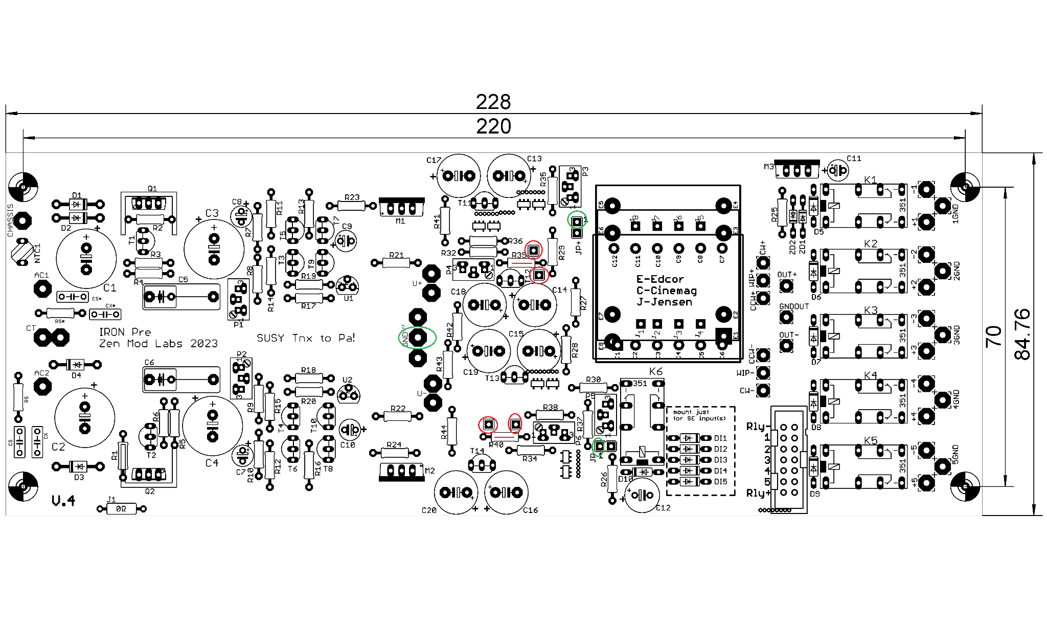

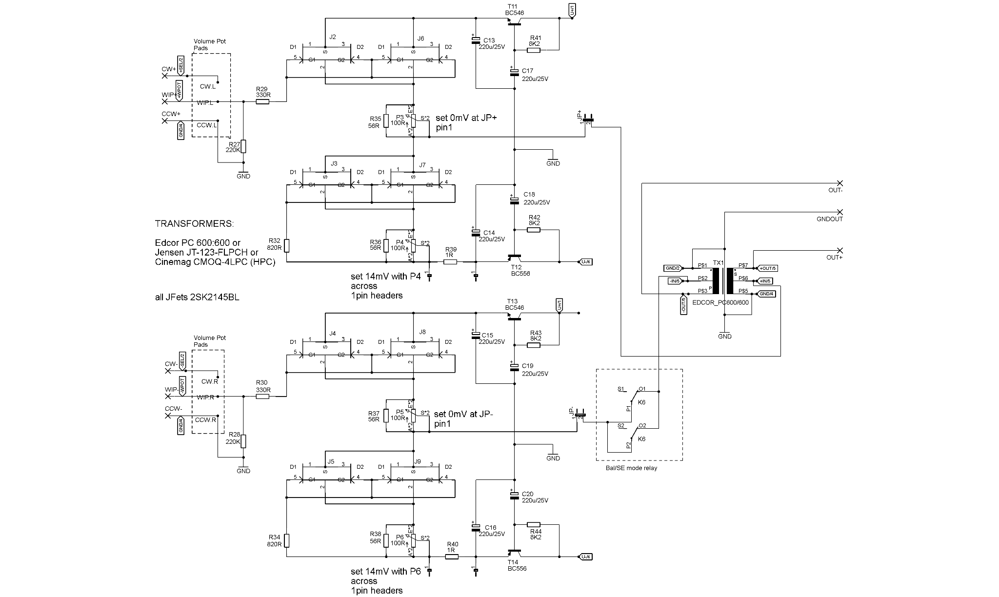

everything needed for setting is already written on schematic
red probe on one test point, black probe on second test point
test points are practically one on each end of 1R resistor
voltage sag across 1R resistor is actually showing current through same, effectively through buffer itself
R39 for positive phase buffer (fiddle with P4)
R40 for negative phase buffer (fiddle with P6)
when that done, set buffer output DC offset to zero - red probe at appropriate jumper pin (marked "1" on pcb), black probe to GND (any convenient place on pcb)
P3 for positive side DC Offset
P5 for negative side DC Offset
edit - enclosed parts placement pic; Iq setting points marked with red; DC Offset points marked with green
