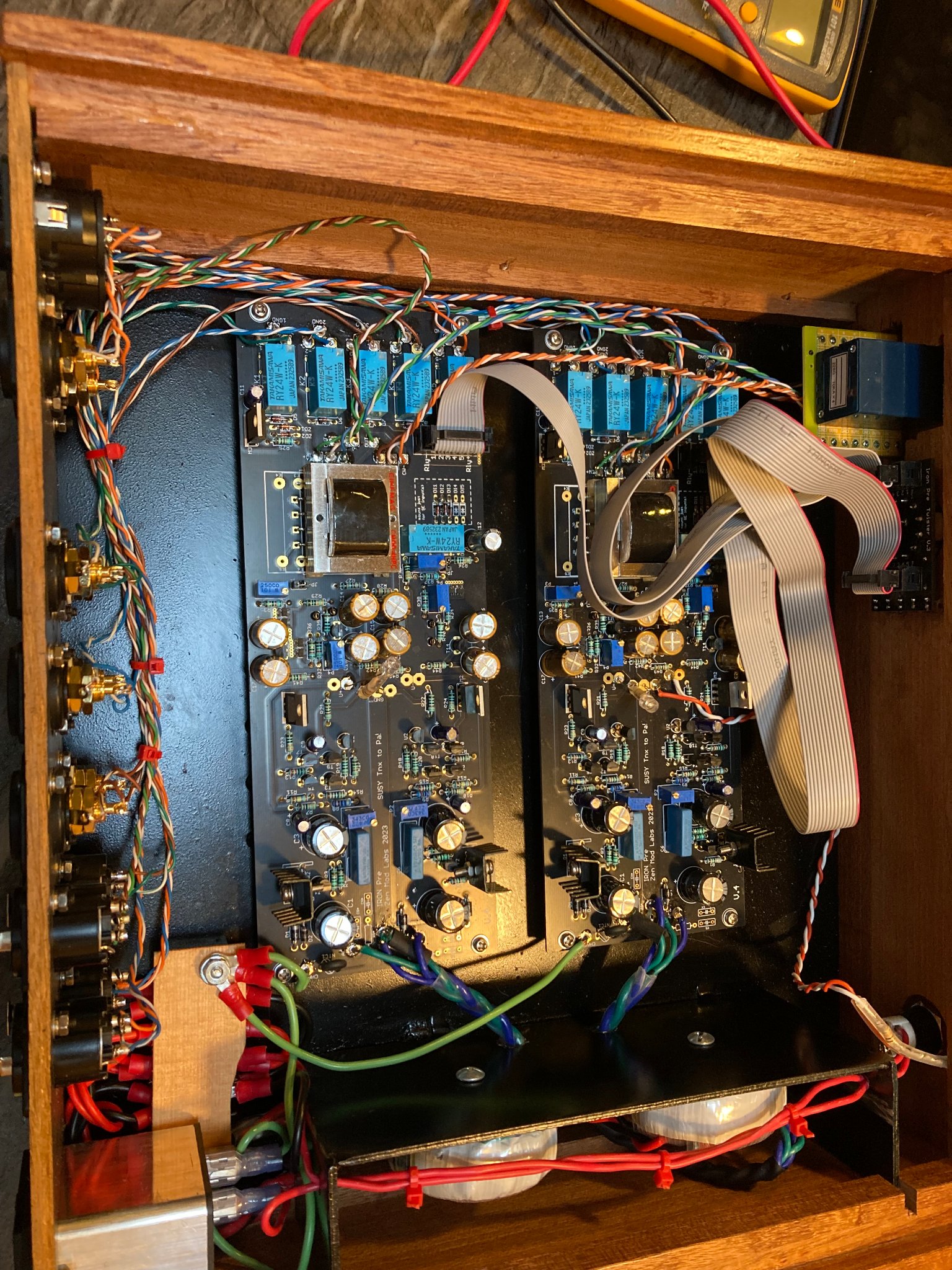

I'm building an Iron Pre SMD, 2023 pcbs, version 4. I got my quad 10k pot a few days ago and finished the wiring and have a problem. I got through all of the adjustments just fine. The input switch leds light up appropriately when switching between inputs. I hooked it up to my system I got dead quiet instead of music. I remembered that I hadn't put the 4 jumpers on JP+ and JP-. When I did I got full ear splitting volume and the turning the pot didn't change that. Subsequently I reviewed my pot wiring and checked that the resistance between common and input; almost zero when the pot was in the full ccw position. All checked out. This is paired with an Aleph J. What should my next step be?
Most likely scenario is miswiring or a wonky pot PCB, but I think ZM took a look at the PCB. Could... but unlikely... be a totally wonky pot.

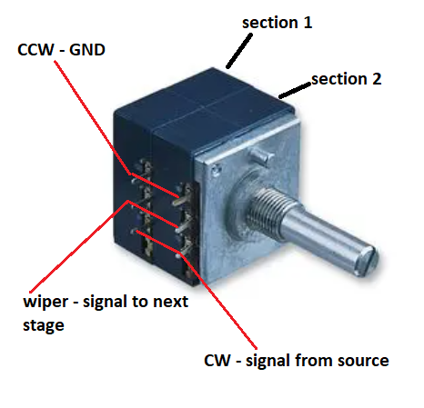

maybe this helps
this one is 2 section - usually used for stereo SE
yours - 4-deck is double that - having 4 sections, two channels, with 2 phases per channel
same principle

in case of Iron Pre - GND is GND, signal from source is signal from selector, signal to next stage is signal to buffer input
