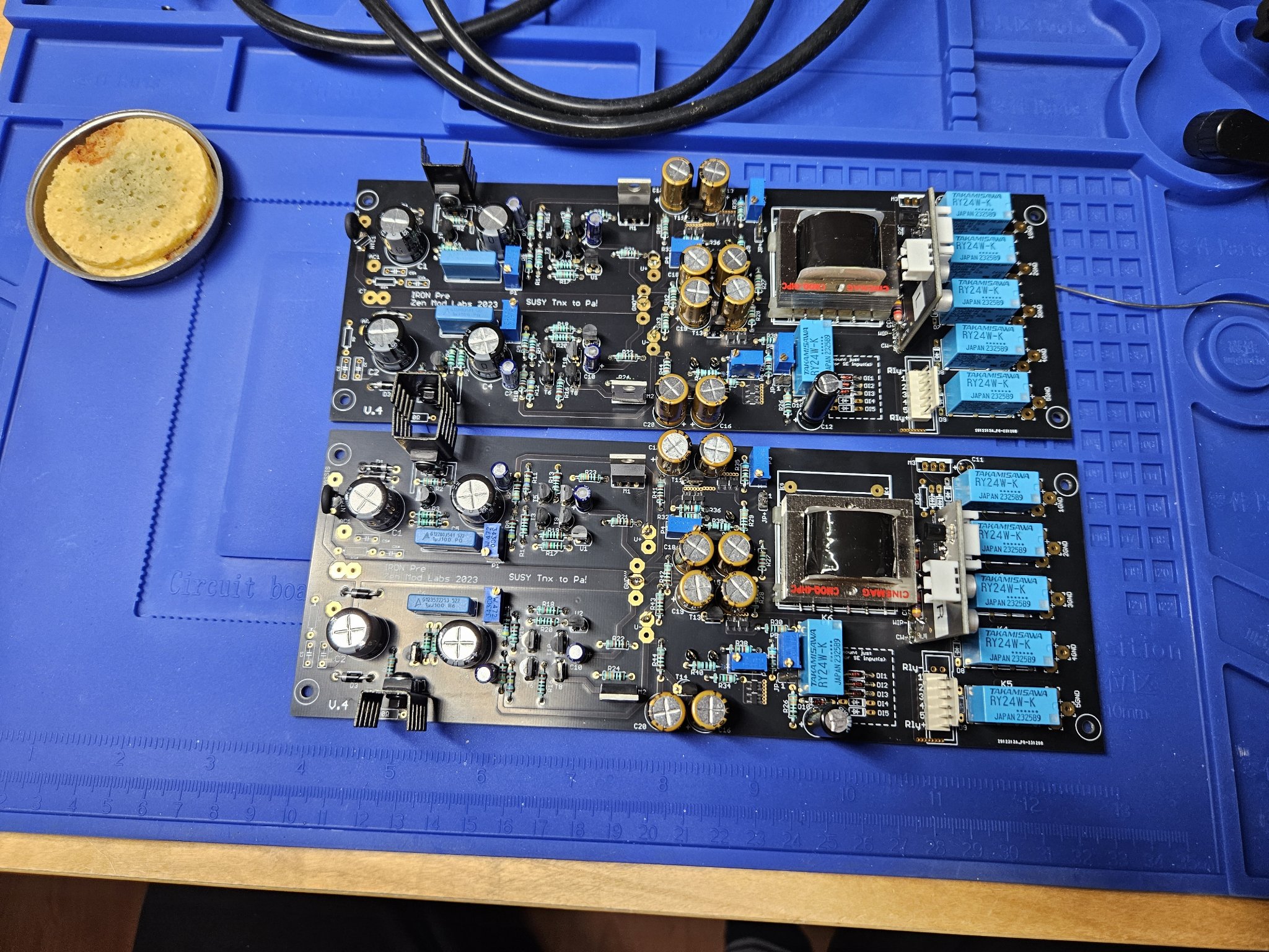

Boards ready. Today is a big day. I should receive both a custom chassis from Modushop as well as Toroidy donuts. 🙂
I was certain some of my IEC inlets would fit the cutout in the back panel, but no. None of the ones in my stash fit.
The specified Shurter DD12.111.111 can be easily found on Mouser or Digikey, but I don't have anything else I need right now, and shipping costs for orders under 50EUR is 20Eur. Ouch.
If anyone has a bunch of these laying around ad would be willing to spare me one, please send me a dm... 🙂

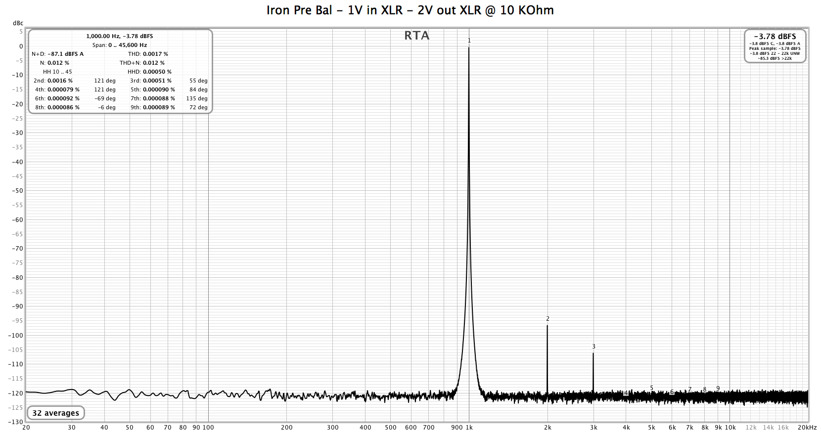

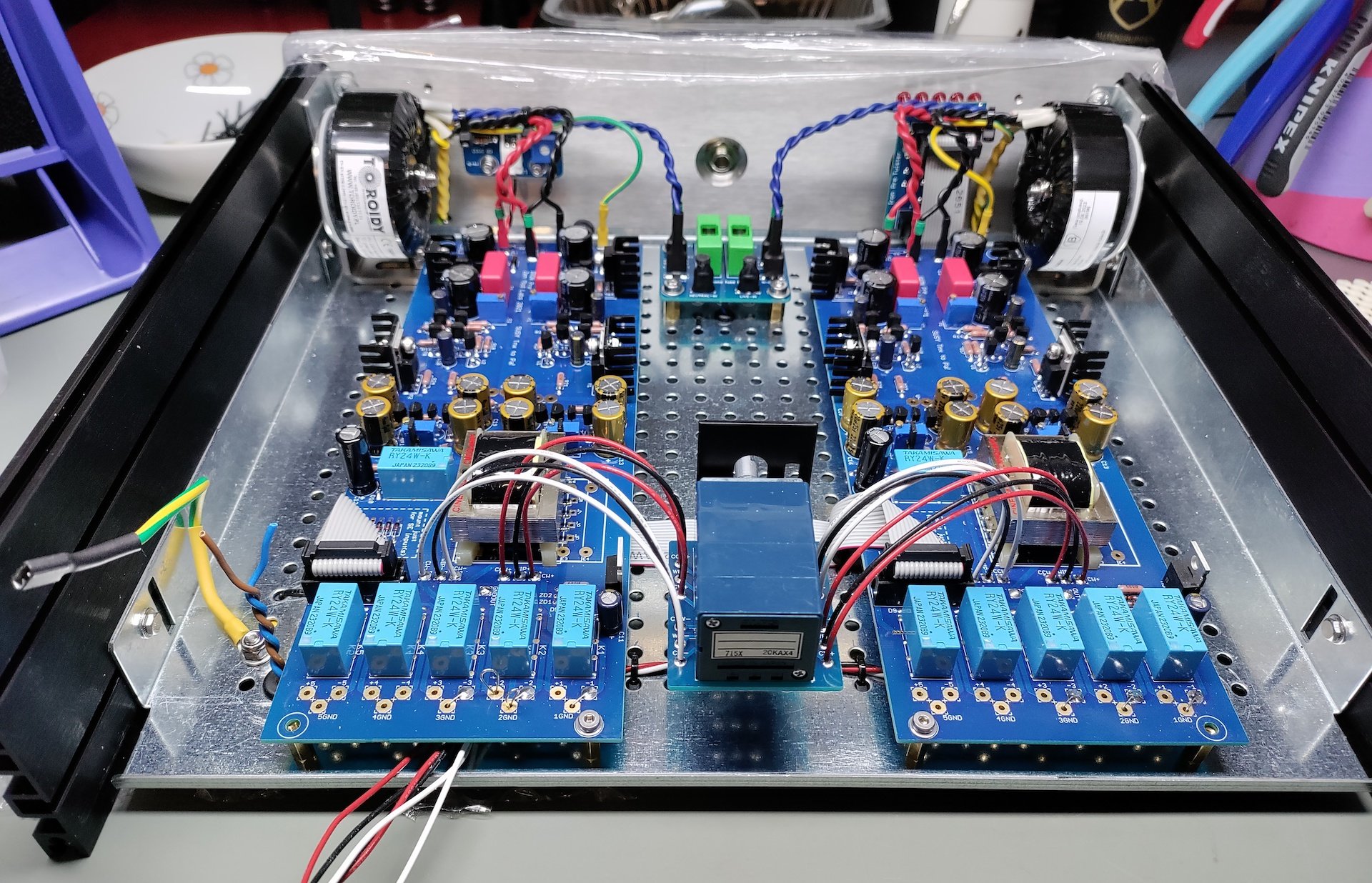

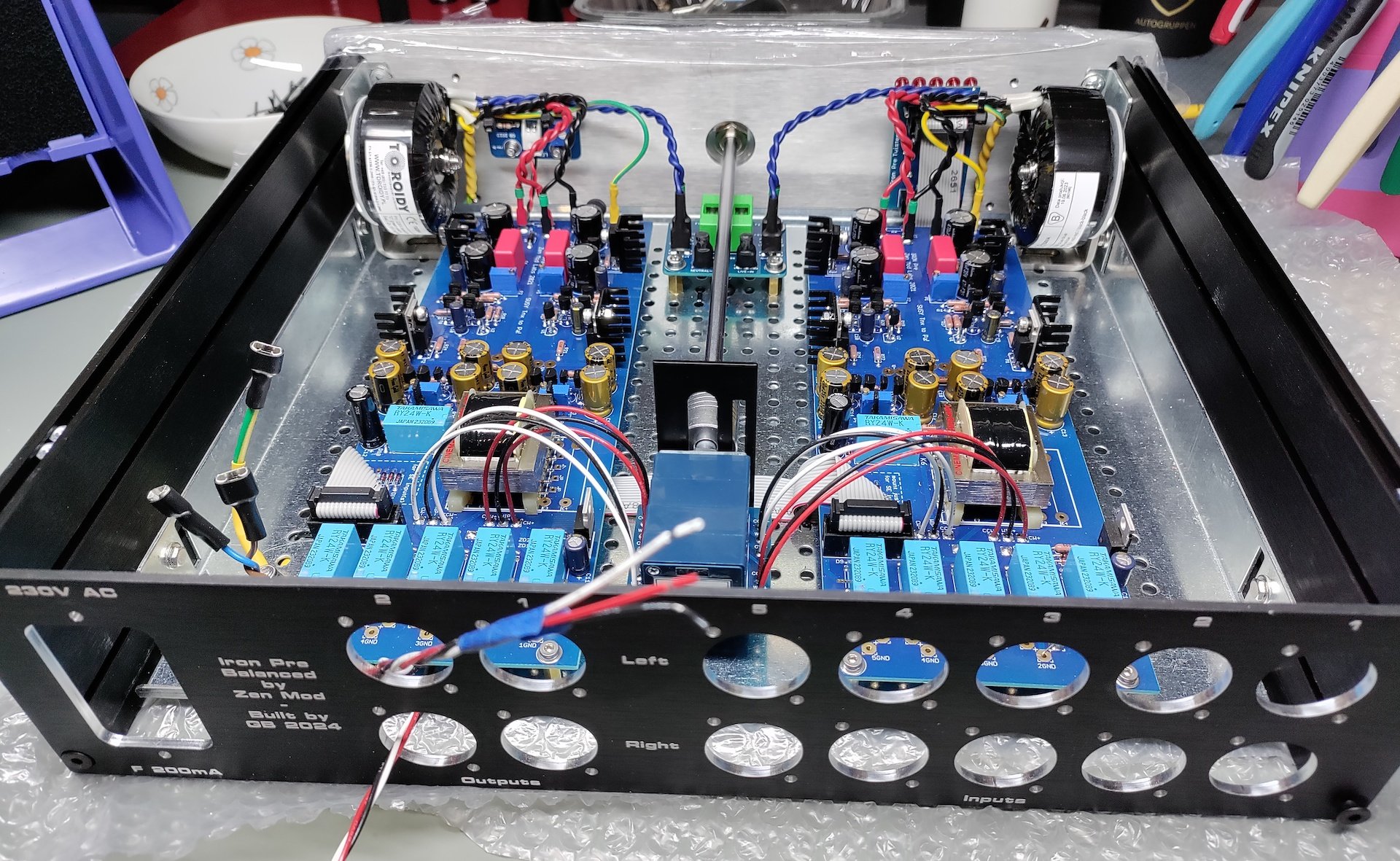

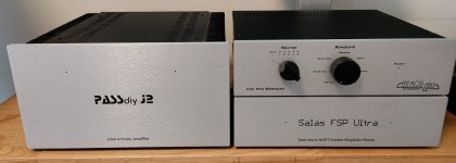

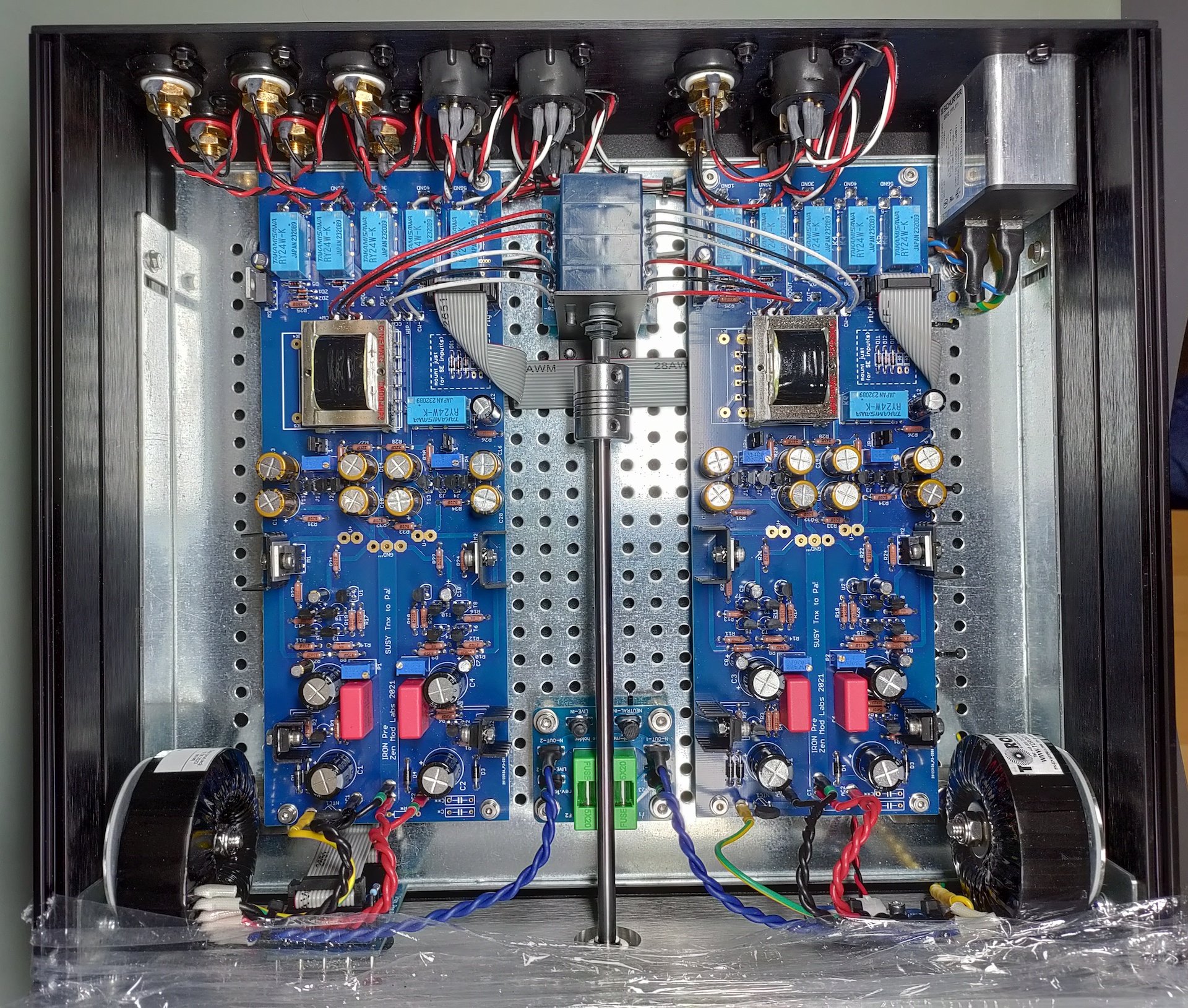

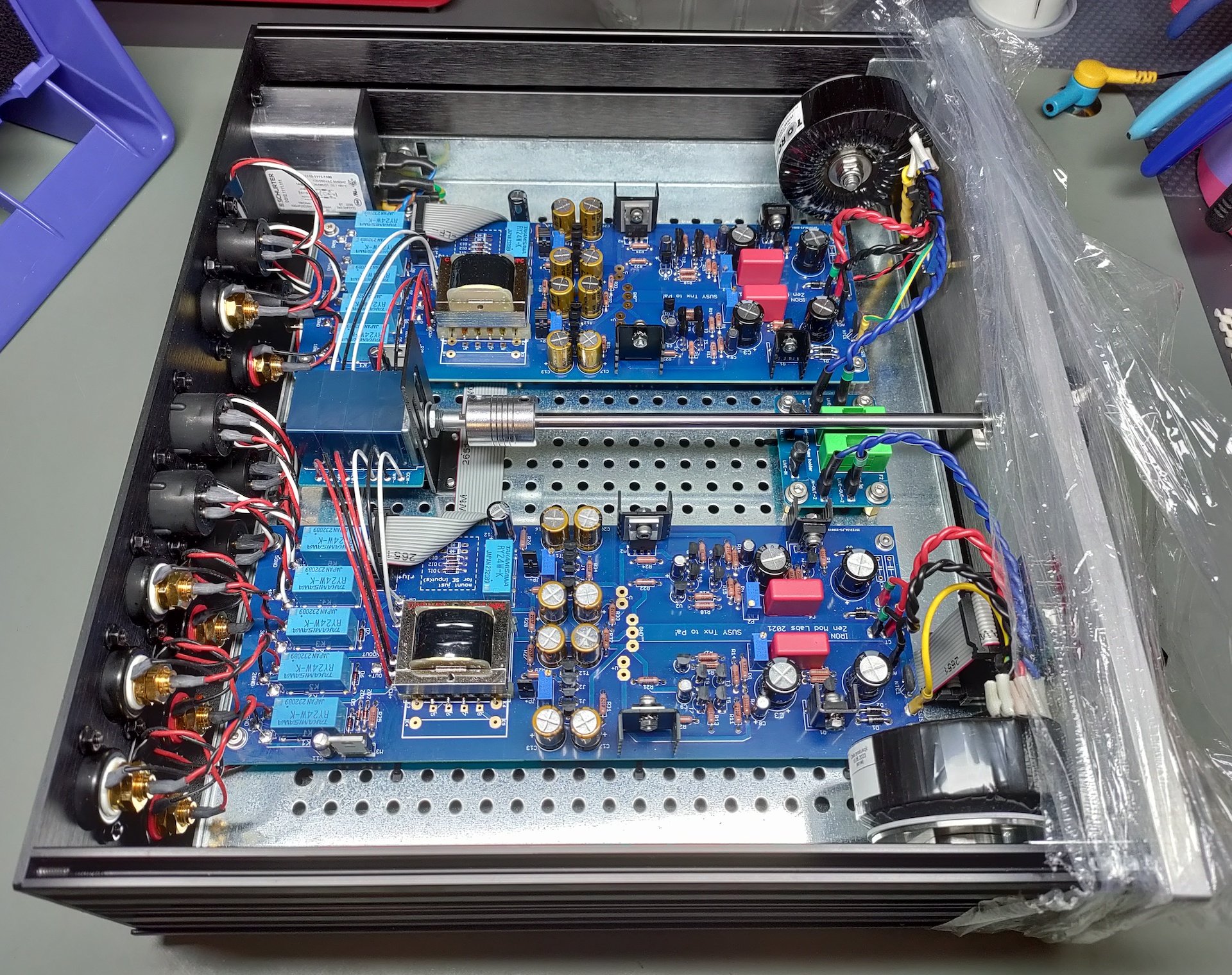

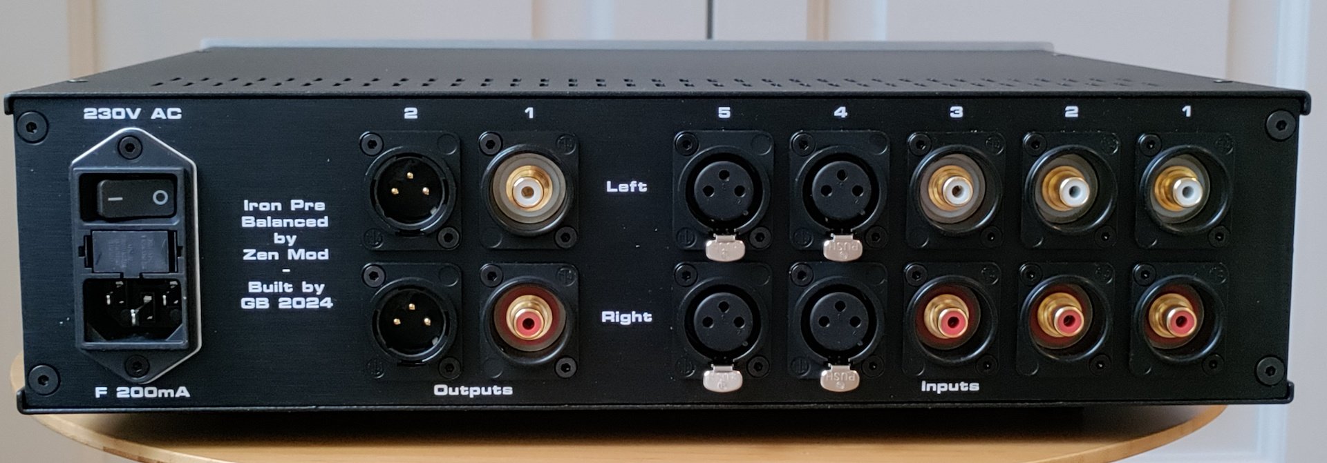

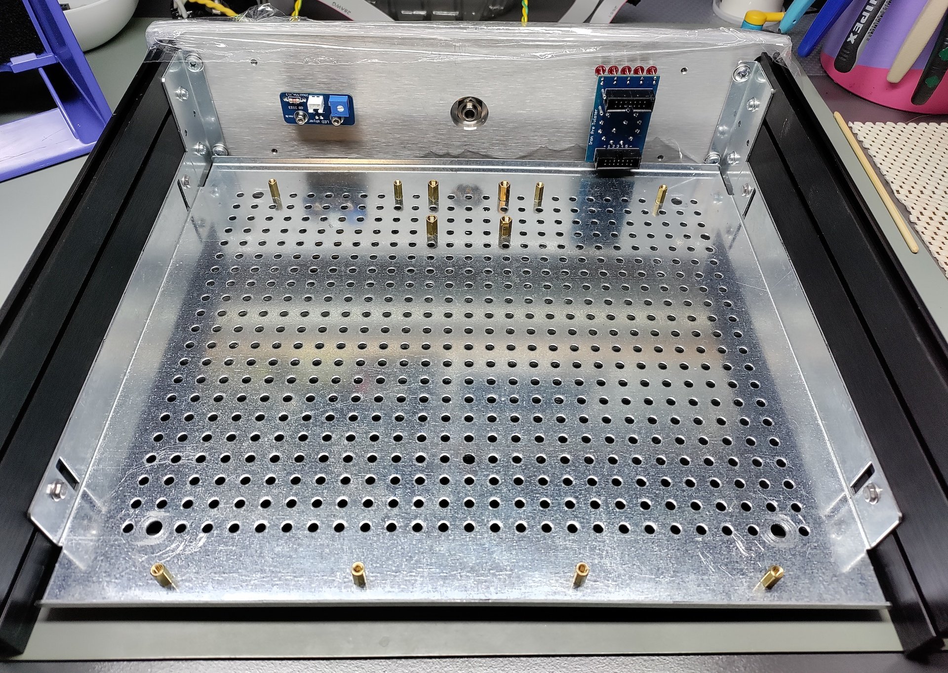

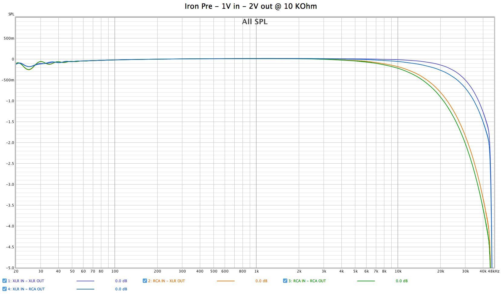

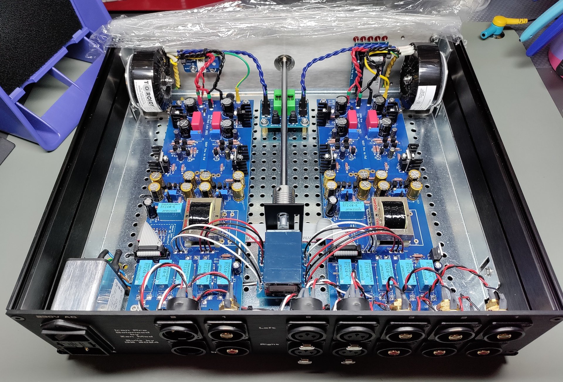

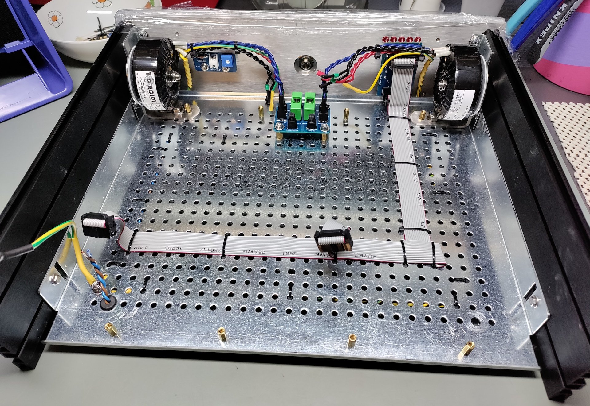

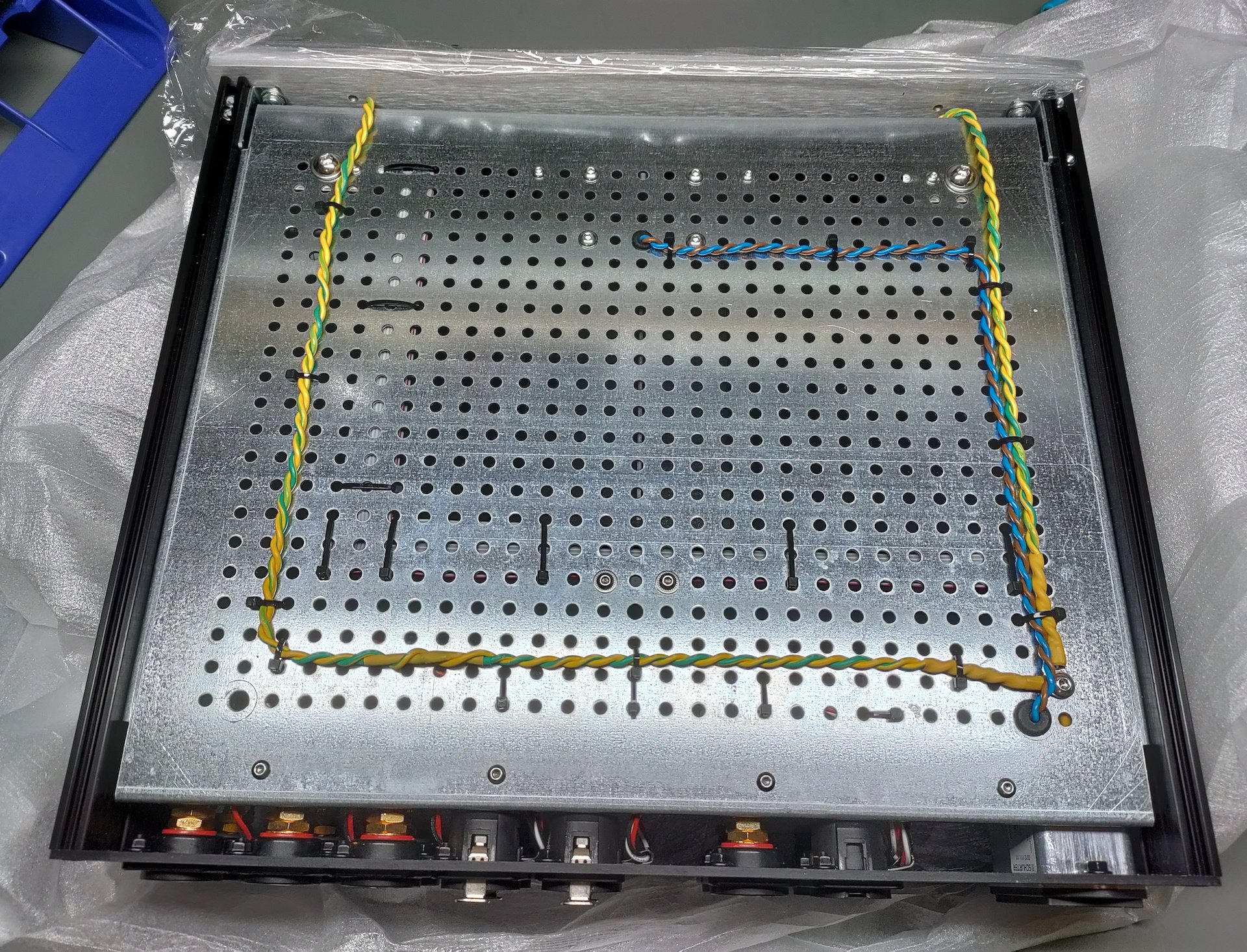

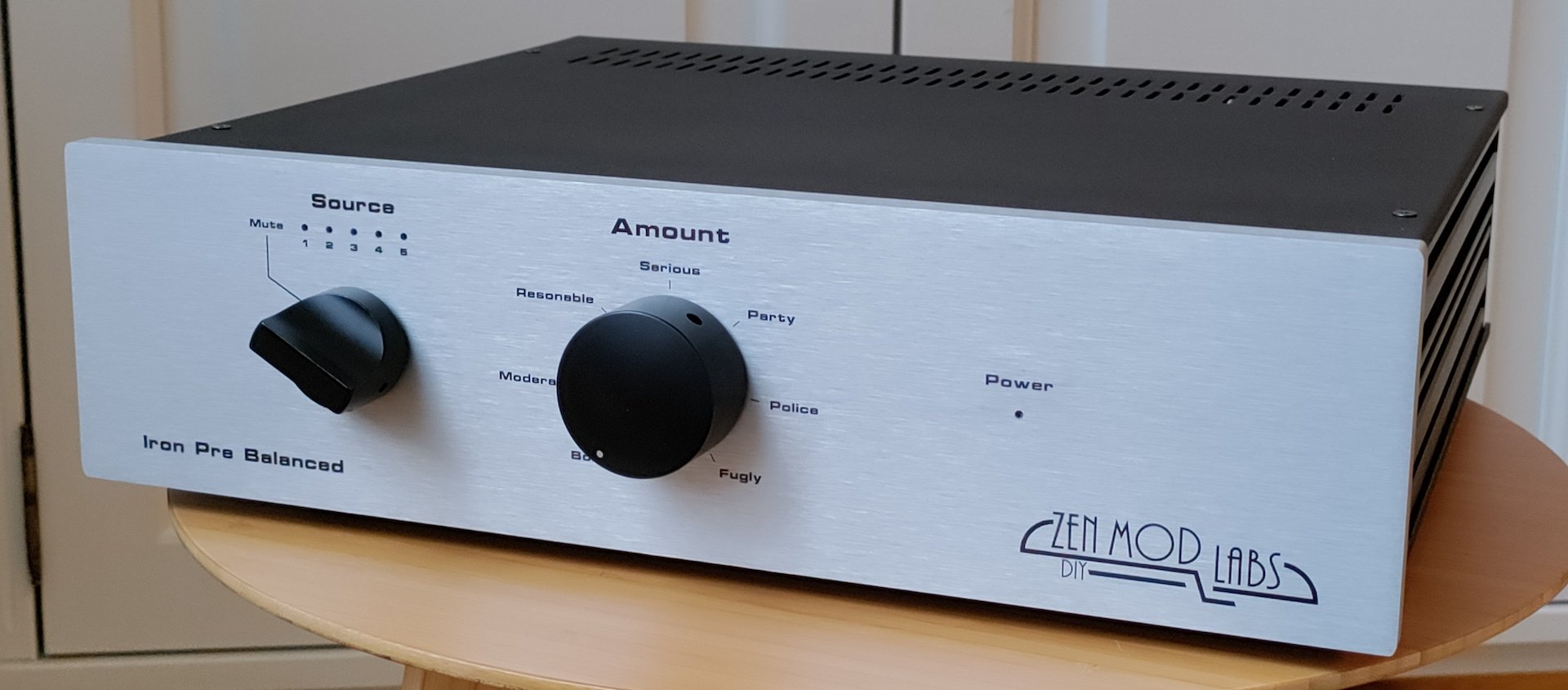

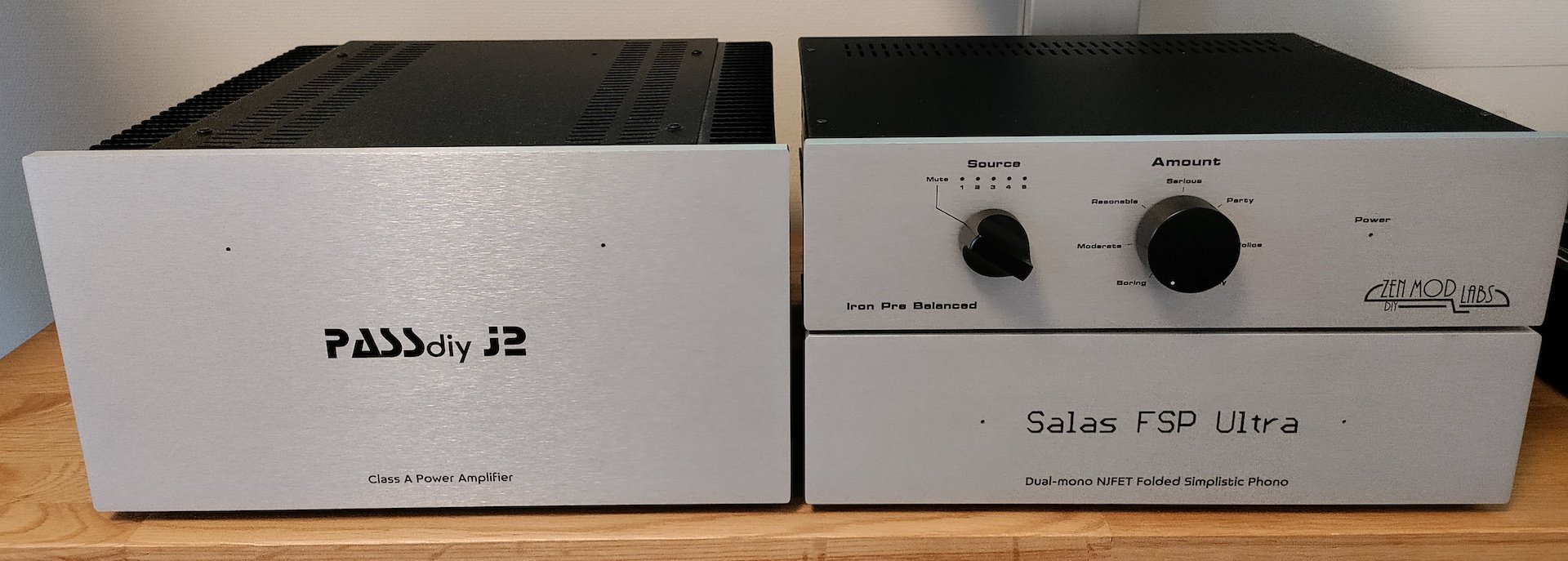

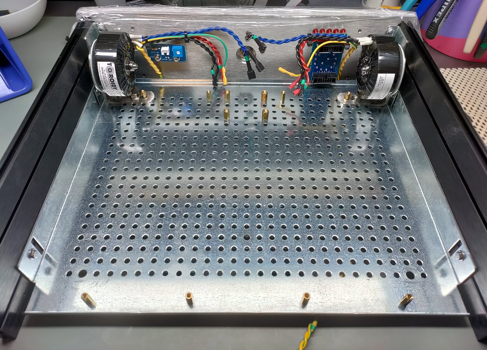

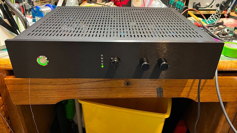

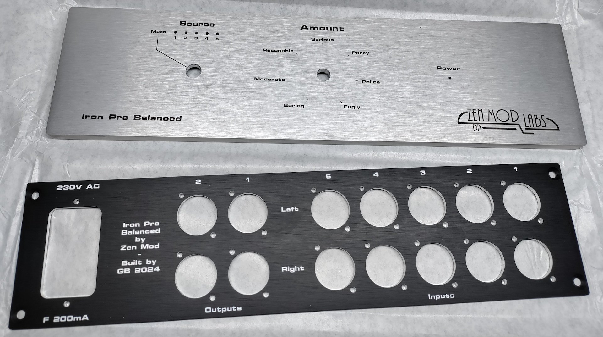

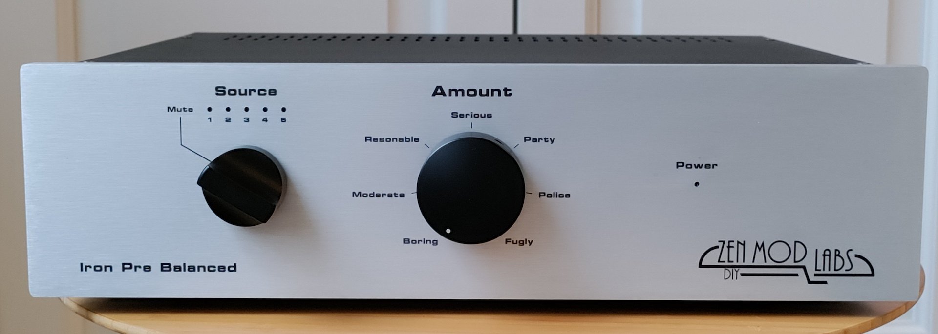

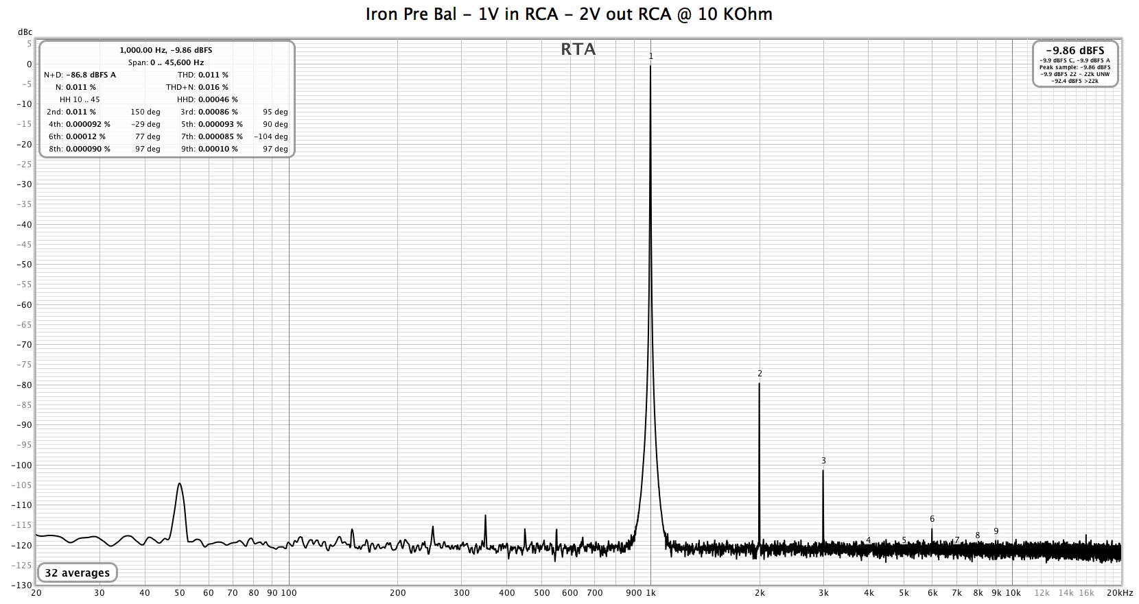

Here comes my blue car boards Iron Pre. Balanced but in SE-sized chassis.
I couldn't use the store SE chassis. I needed an additional output and had to rotate the power inlet 90 degrees. Hence, a completely new custom chassis.
Make the layout symmetric, just because. Flip the toroids to make them fit. Rotate the input selector due to lack of space behind the front panel. Add a silver faceplate to distinguish it from the official store chassis. Add ZM logo and some irony around the knob. Use LED and dual-fuse PCBs simply because are in stock. Place the pot where ZM likes it. Leave space to update the pot down the road. Deal with the limited space for signal wiring. Measure it. Forget about measurements. Take your time. Enjoy the whole process.
This will be my central control unit until I have the time, space, and money for the full Pumpkin.
