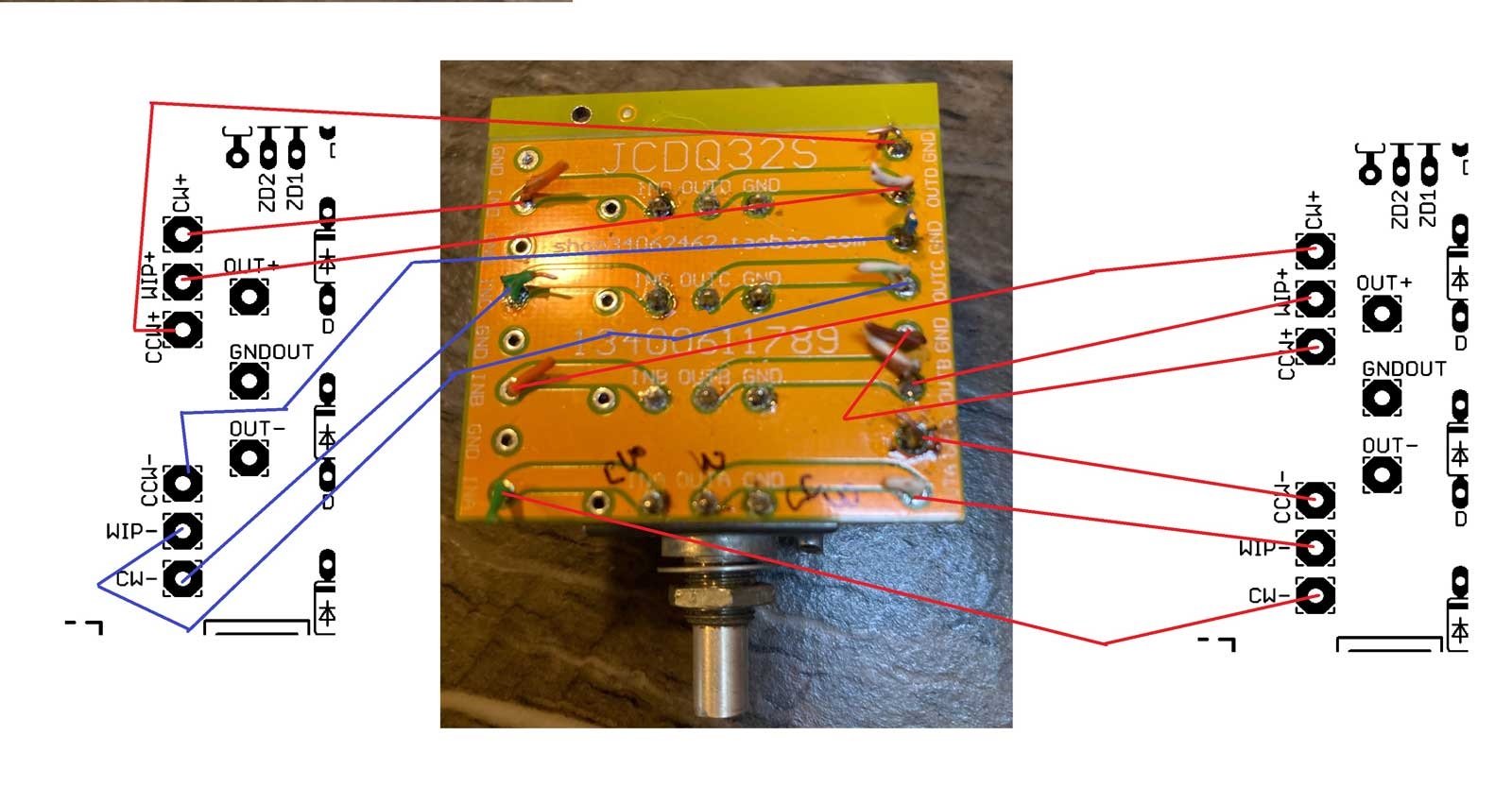

now I see a problem with pcb itself - it's having all GNDs together, thus negating proper dual mono arrangement of BAL pcbs (channel GNDs isolated)
as I can't see traces on top side, I can't deduce is it enough just to make a cut from bottom side to isolate
it is, as is , absolutelly necessary to desolder pot ( carefully please) from pcb and to solder wires directly to pot pins
if needed, I'll make another sketch how to

The last redo did it.
pics, so I can see what you did
again, isolating channel GNDs is of substantial importance, when already made as dual mono
