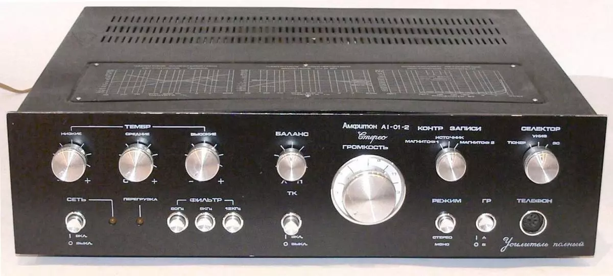

The only upgrade would be more balanced inputs and output and perhaps a tape monitor and a tape dubbing and a bass and treble control and a loudness and, and... and.... how do you say "Origins" and "Zen Amount" in Serbian?
Perhaps a cabinet designed after the old Soviet audio stuff with stuff like "порекла" on it.

btw. whatever "Amfiton" I ever heard sounded as drek, and was made as overcomplicated drek
pretty much sole thing worthy, made in old era, was tube amp "Priboi"
divine iron, but rest of it showing too many corners cut
majority of those were reworked, resulting in much better sound quality and functionality
