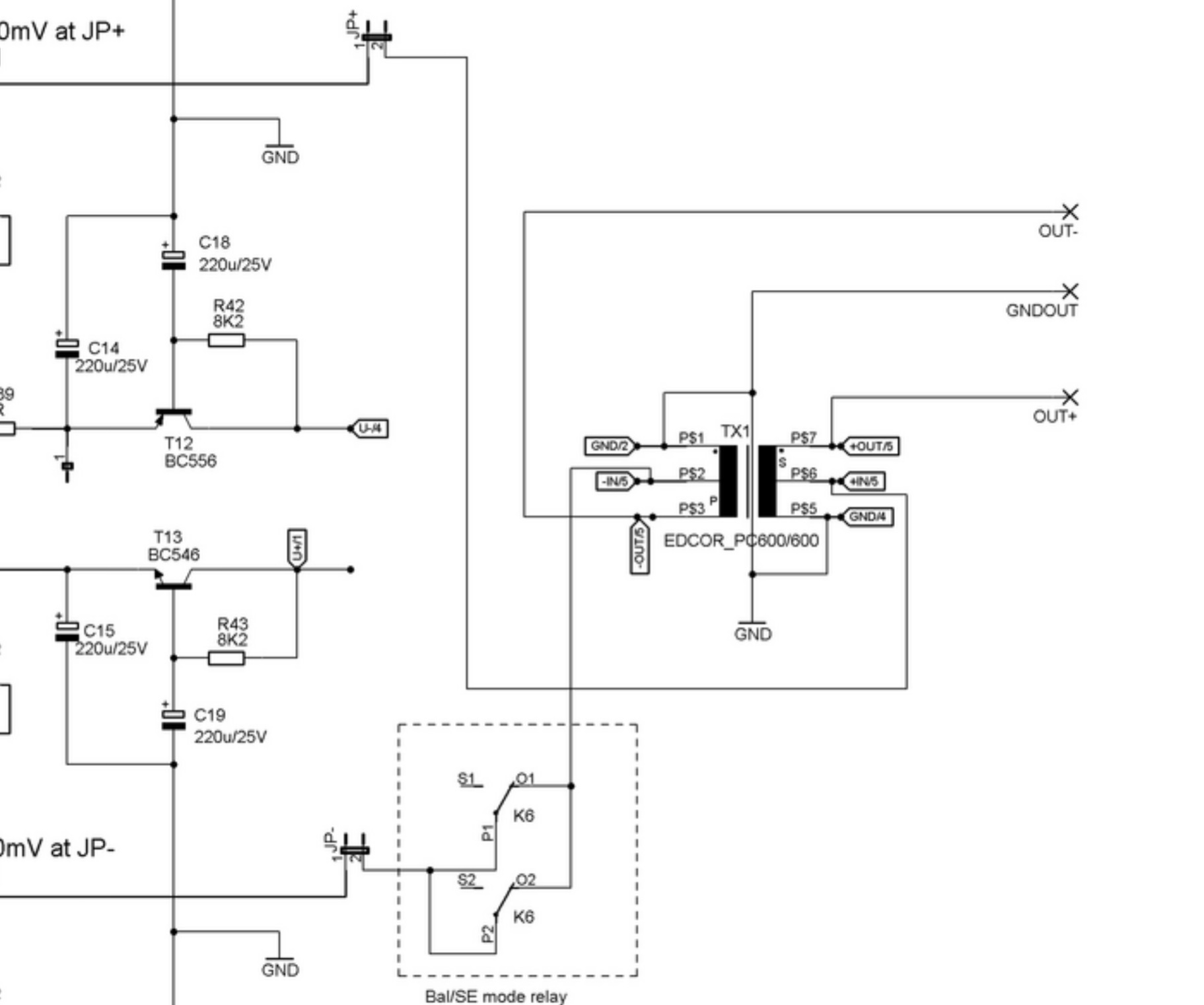

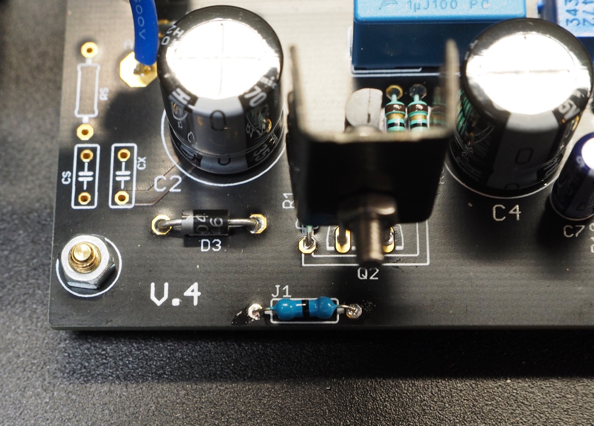

Got my Iron Pre Balanced SMD package last week and have got the PCBs stuffed except for Jumper 1 near Q2.
When do/don't you use it? I've searched around and can't find anything on it. I'm sure it's in plain sight, I just can't see it.
Look at the signal schematic.
https://d3t0tbmlie281e.cloudfront.net/igi/diyaudio/GYyQSGRLBbCr24yu.huge
EDIT... wait, hang on, you're talking about this...
Long story short, if you are using the on-board relays for switching, (which will be 98% of the builds) yes, stuff the jumper.
Well, logic through this and ask again…
Look at the signal schematic, specifically the transformer, and your wiring. (Which is correct, BTW…)
Balanced out+, out- and ground have continuity (DMM beep) on my build
if you desolder autoformer from pcb, there will not be Beep!! anymore, but there will not be sound, too
correction:
Long story short, if you are using enclosed rotary switch for switching inputs, (which will be 98% of the builds) yes, stuff the jumper. If you're using Logic solution of any sort, for inputs switching and Volume, do not stuff the jumper

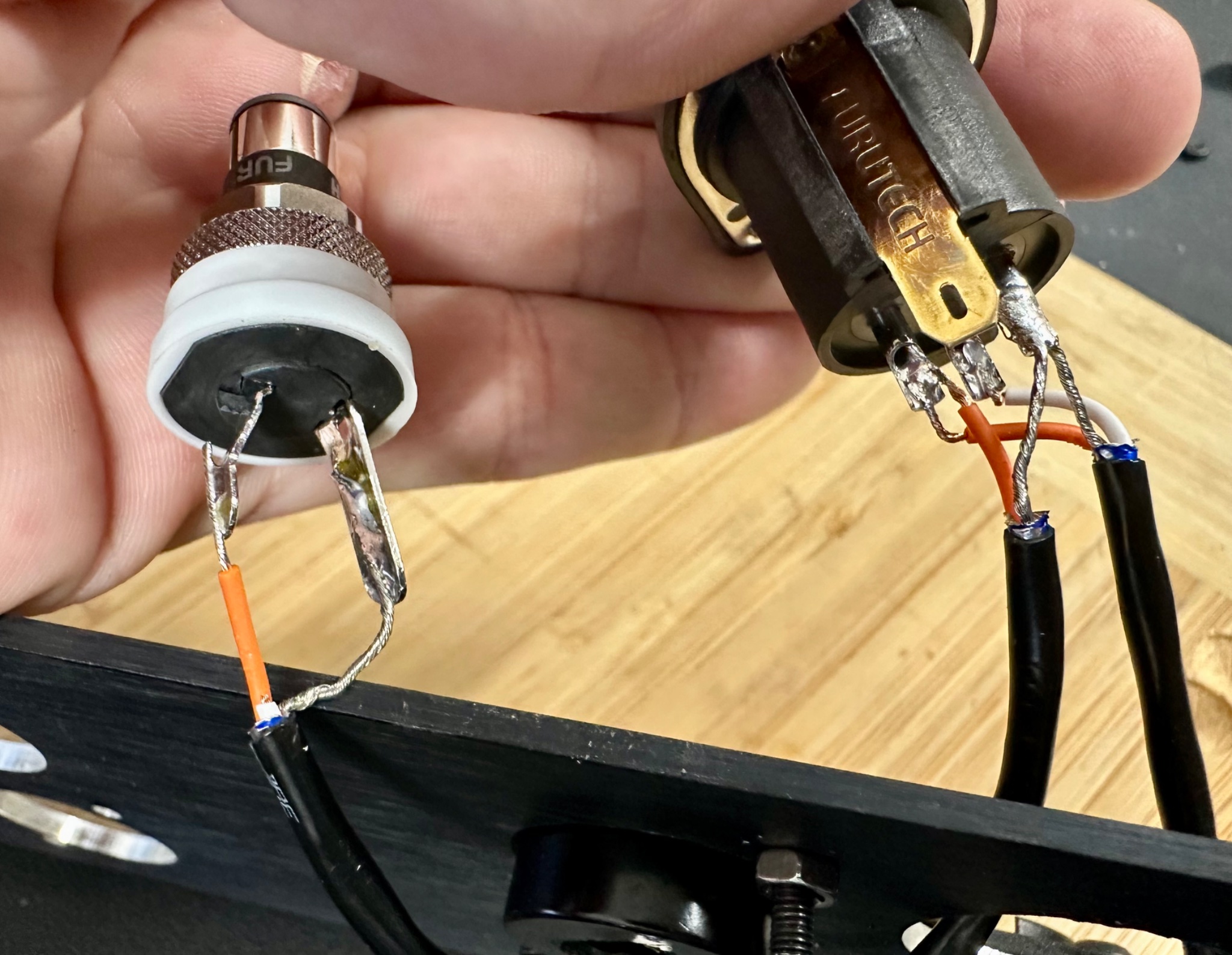

It solders great, at least for meThe Mogami cable arrived today. I really lucked out with stripping it, as my present wire strippers worked flawlessly on both the shield and tiny 28 ga. Center wire! You all know how rare this is. Now, let's see how it solders
