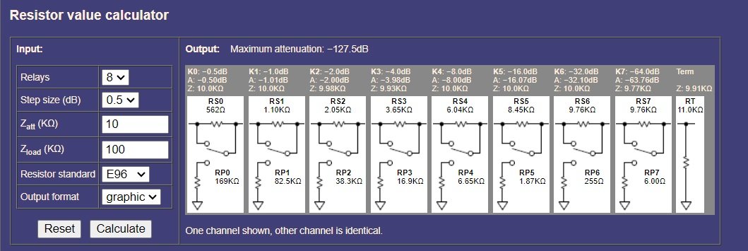

I just ordered a balanced essentials kit and I'll be using an AMB Delta 1 relay-based R-2R stereo attenuator. It has a calculator so you can choose your resistor values based several factors. I read that the recommended attenuator value is 10K but I don't know what the load impedance in KΩ of the iron pre smd is, as seen by the attenuator. I though I read 100K ohm but I'm not sure if that's correct. Can anyone advise?
Thanks! Just wanted to make sure I was in the ball park. R26 and R27 show 220K, just wondering how one would get the R in from that value? Is 220K halved?
if chosen attenuator is having specific resistor as "closing" value, nothing easier than replacing input resistor at buffer gate with that specific value
example - if I'm making resistor matrix attenuator of 24K impedance/resistance, it calls for final resistor of 24K
so, I'm just using 24K as JFet gate-to-GND position resistor
got it... So I'm using an attenuator value of 10K Ohm. I can then just use a 10K Ohm resistor for R26 and R27?
Thanks, here a link to it in pdf form https://www.amb.org/audio/delta1/delta1_100_sch.pdf
These are the resistor values it generated for me with the value of Rin at 100K
so, yes, change R26 and R27 to 10K
if they're present at attenuator pcb(s), omit them there
