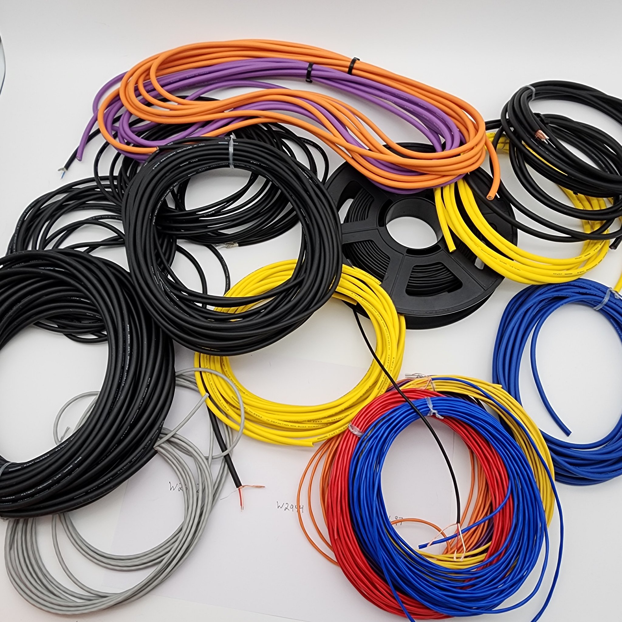

I have bought the balanced SMD kit, just got it home. I have another cable question. For the SE outputs, I'm drawn to the Mogami W2381 for it's reported flexibility and I like that it's thin. But what should I use for the balanced connections? I'd prefer something similar, but I obviously need two conductors plus shield. Can someone point me to some good quality cable fitting the thin and flexible requirements?

I think that although not as flexible as using two separate W2381 wires, the W2697 in the picture is pretty good and flexible. It has two center conductors and the shield for ground. If you want two conductors, ground, and shield, then W2944 is a decent option (console cable). The W2552 is too thick in my opinion for a short run in a chassis like Iron Pre and is intended to be dragged around a stage.
Very helpful, Thanks!
So for the ones with both ground and shield, do you connect both shield and ground together? I do not want to derail this thread into cables, but I am uncertain if the shield should be connected or not when both ground and shield are available?

I'll try to answer my own question. I did some reading about this. If I understand it correctly, the wire you call ground is a drain wire. It's purpose is to ease the termination, and it is in contact with the shield along the length of the cable.Very helpful, Thanks!

If you want to go with balanced cable, based on the wide variety of balanced cable I've "tried" (I haven't soldered with all of those in picture), I'd recommend the balanced microphone lapel cable, W2697. It is soft and suppel, 2.5mm OD, has three conductors (one is a wrapped shield), and costs $0.31/ft. In my opinion it checks all the boxes.
My second choice would be W2944, which is also 2.5mm OD, but has an extra ground conductor, which is not insulated and, as noted above, is in contact with the shield. Because of the added wire, it's less flexible than the W2697.
Cable in photo in no particular order...
Mogami W2696 / W2552 / W2944 / W2983 / W2971 / W2799 / W2549
Canare L-4E6S / L-2E5
