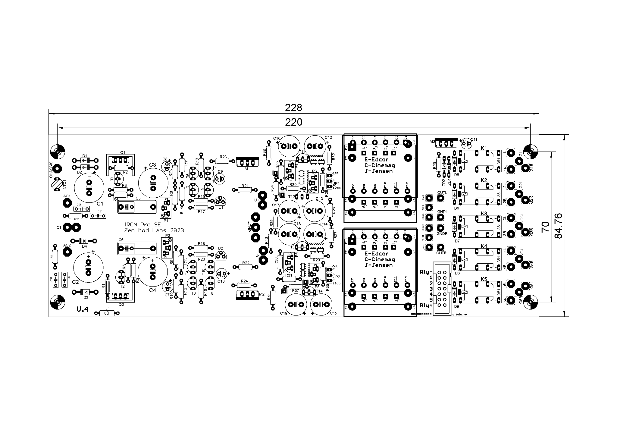

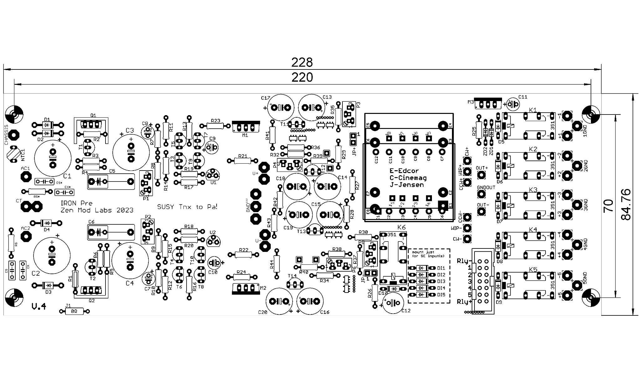

Inxay, yours is clearly working so I’m not questioning that. I need some help with what I think I see. When I look at the build and pcb images I only see c14 and c18 with their positives facing outward. Looking at yours I think I see c18 negative facing out and c14 positive facing out?
The Iron Pre SE SMD Essentials kit (without additional packaging) weighs in at (around) a svelte 490 grams. The fulfillment center likely adds additional packing for final shipment, but another 260 grams (give or take) seems a tad much for another outer box or bubble mailer.Would anyone be able to weigh the parcel containing one IronPre SE kit, please. My courier is charging my for 1.64 lb which I think is unrealistic. The PCB set, actives and two autoformers can't possible weigh that much, or could it?
I am still building mine so I am also wondering about this. Looking at the silkscreen board at this moment, I see that C13 and C17 with their negative stripe facing outwards. Then I look at C18 negative is also facing out and C14 negative facing IN. It is the only one out sequence you might say. I am really wondering if this isn't a mistake like with the last board version that had C11 facing the wrong way.
I will look closer at the schematic to reassure me.
Thanks again for the observation. I will not power this up until there is a definite answer.
Looking at step 32 of the build guide, there is a schematic that shows the correct electrical connections, but based only on that, I am not confident that it translates to the actual physical orientation of the capacitors. It does seem from looking at the traces that both sets of capacitors are in the correct electrical connection despite their appearance physically. I sure do hope that someone verifies this!
@Ixnay - I see no issues with the orientation of C18 in you photo in #3916. The silkscreen on the boards is correct.
When in doubt, validate against the schematic. The positive side of C18 has a direct connection to R40, which then heads off to the positive rail. I am not sure what may have caused confusion, but if anything can be documented more thoroughly to help others that may be confused, just let me know.

Edited to add - the build guide does not show the new SMD boards. Remember, the boards and schematic have changed for using the all "same sex" SMD JFETs. Always use the latest schematics / files - helpfully always found in post #1 of this thread. Parts placement added again here for reference. 🙂
