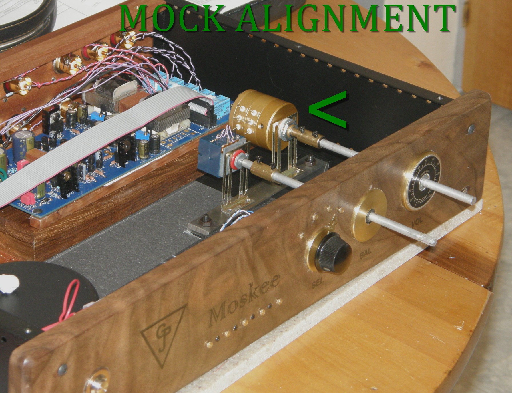

Found post #3690 on page 185 about halfway down. Just great looking work. I am starting to wire my present project am still glad now that it isn't balanced. That is a lot of wiring, but fortunately the Iron Pre negates the need for as much wiring with the relays.

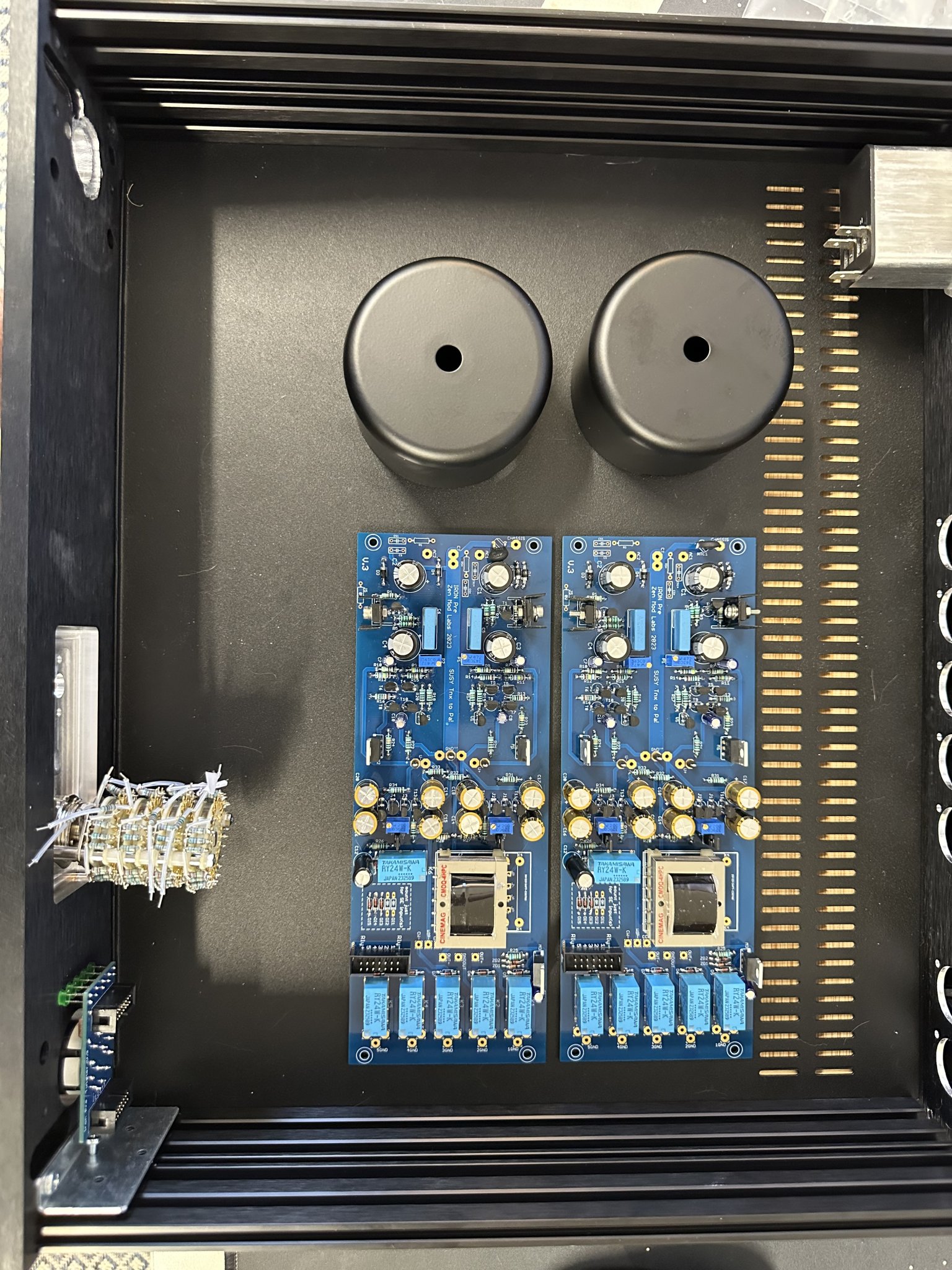

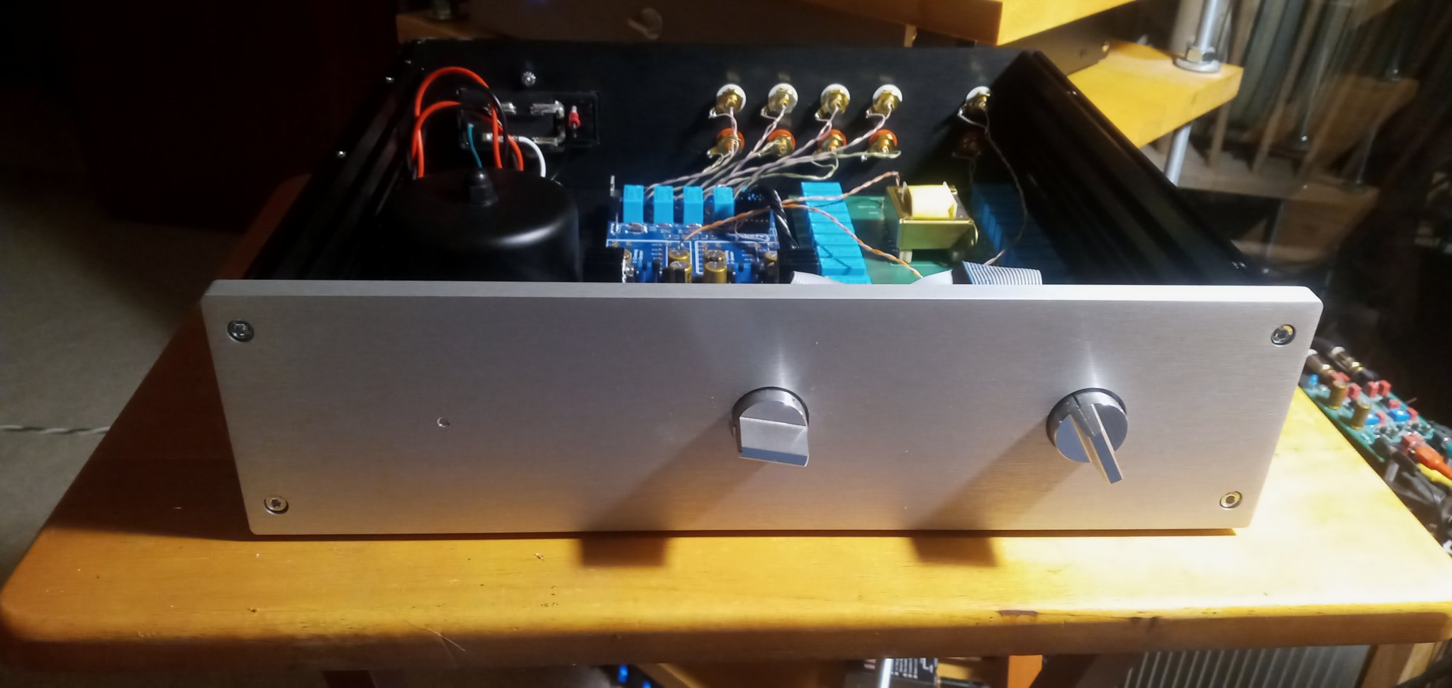

@edwinjones4 with the balanced boards orientated as you show, the best place for the pot IS the front.
There is a reasonable argument that extensions are better for the SE board, particularly when mounted longitudinally, but I put the potentiometer on the front of SE and it's quiet and sounds great.
I've linked an Alps RK27 Remote Mount 3D print design that can be used with the Iron Pre SE. Currently in draft as of today, and I'll update the thread with the latest revisions once it's been tested out in the wild. As 6L6 noted, probably not needed for Iron Pre Balanced if mounting boards as he did, but for the SE version, it can be used reduce wire length if the board is oriented front to back in the chassis.

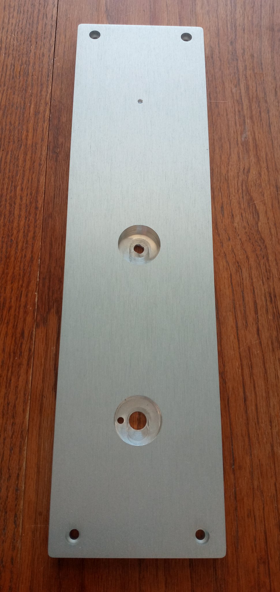

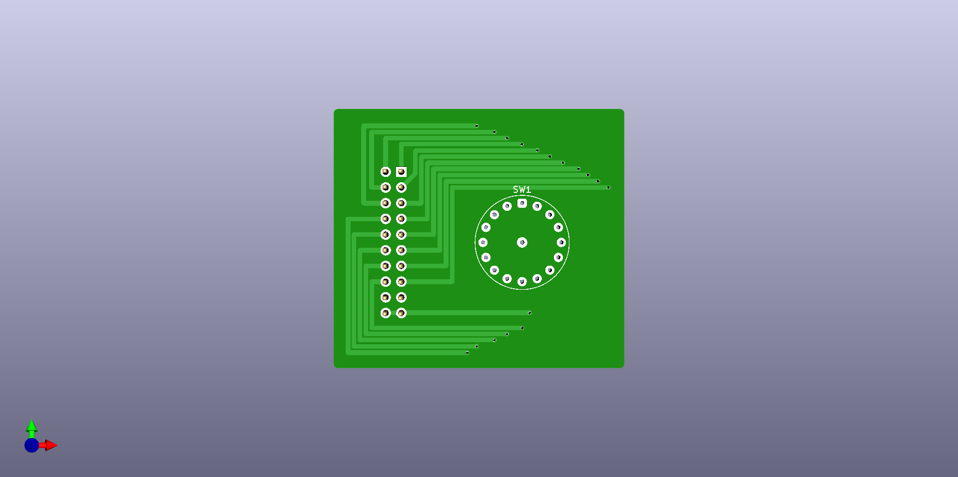

Can we get a Balanced Chassis face plate with a Single volume control hole (rather than two as show below). And further, can the single volume control
hole be center aligned to the label text above it - so that it basically has the same visual appearance as the SE Chassis? I think this would be a tiny CAD file change. Are others interesting? I intend to use a single rotary encoder that will feed either MUSES or ladder attenuator.

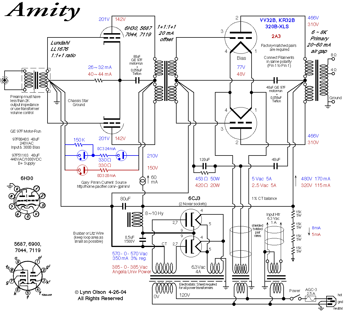

What sort of output drive capability does this Iron Pre have? I have all balanced, transformer input tube amps. My Lynn Olson Amity Clone's are tough to drive because the reflected miller capacitance of the driver tubes grids appear at the input transformer. I think it's equiv to 600pF. LOL!
say that smd iteratioon of balanced Iron Pre is having Rout under 300R
do your math ..........
though, 600pF is most likely wrong number

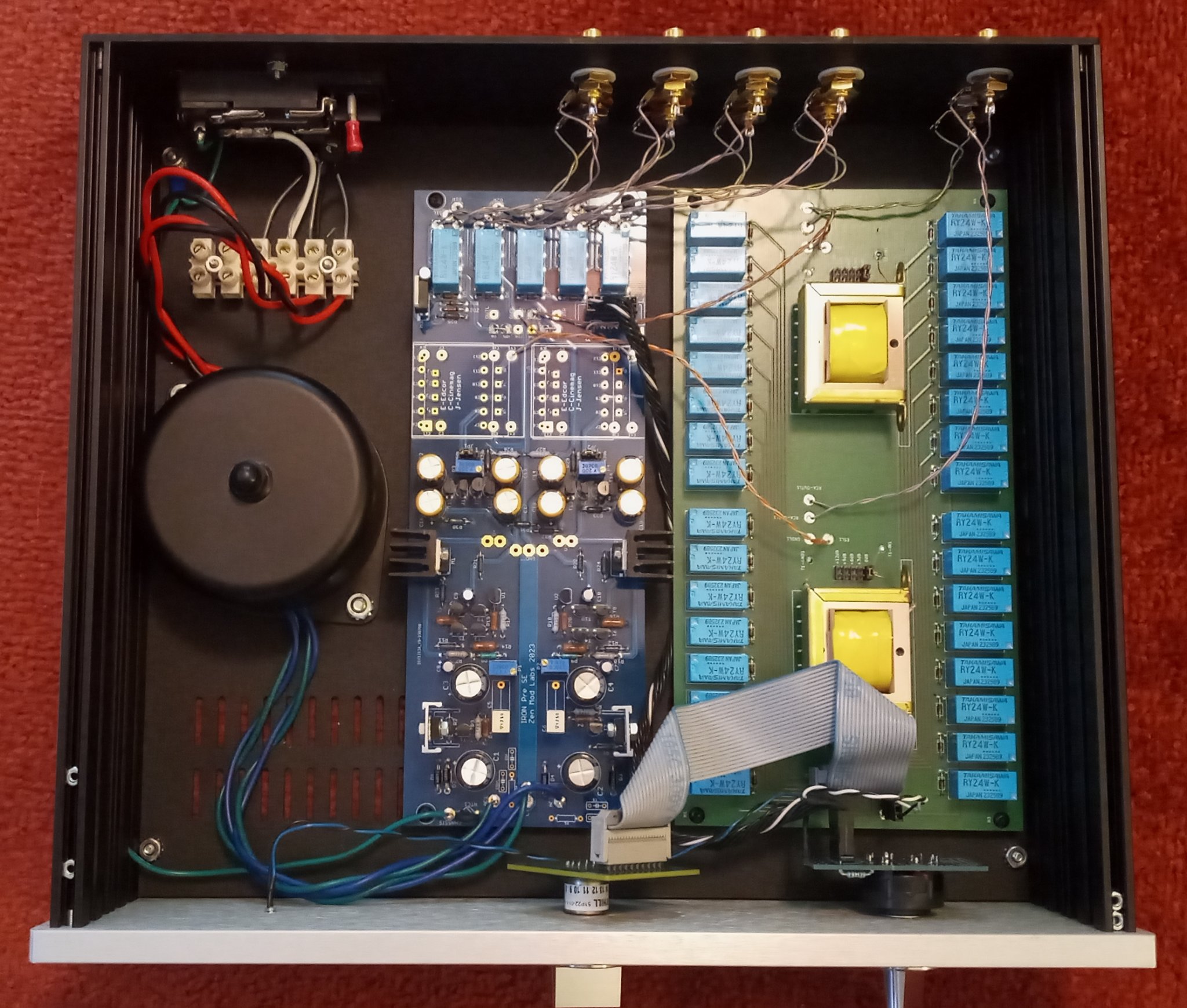

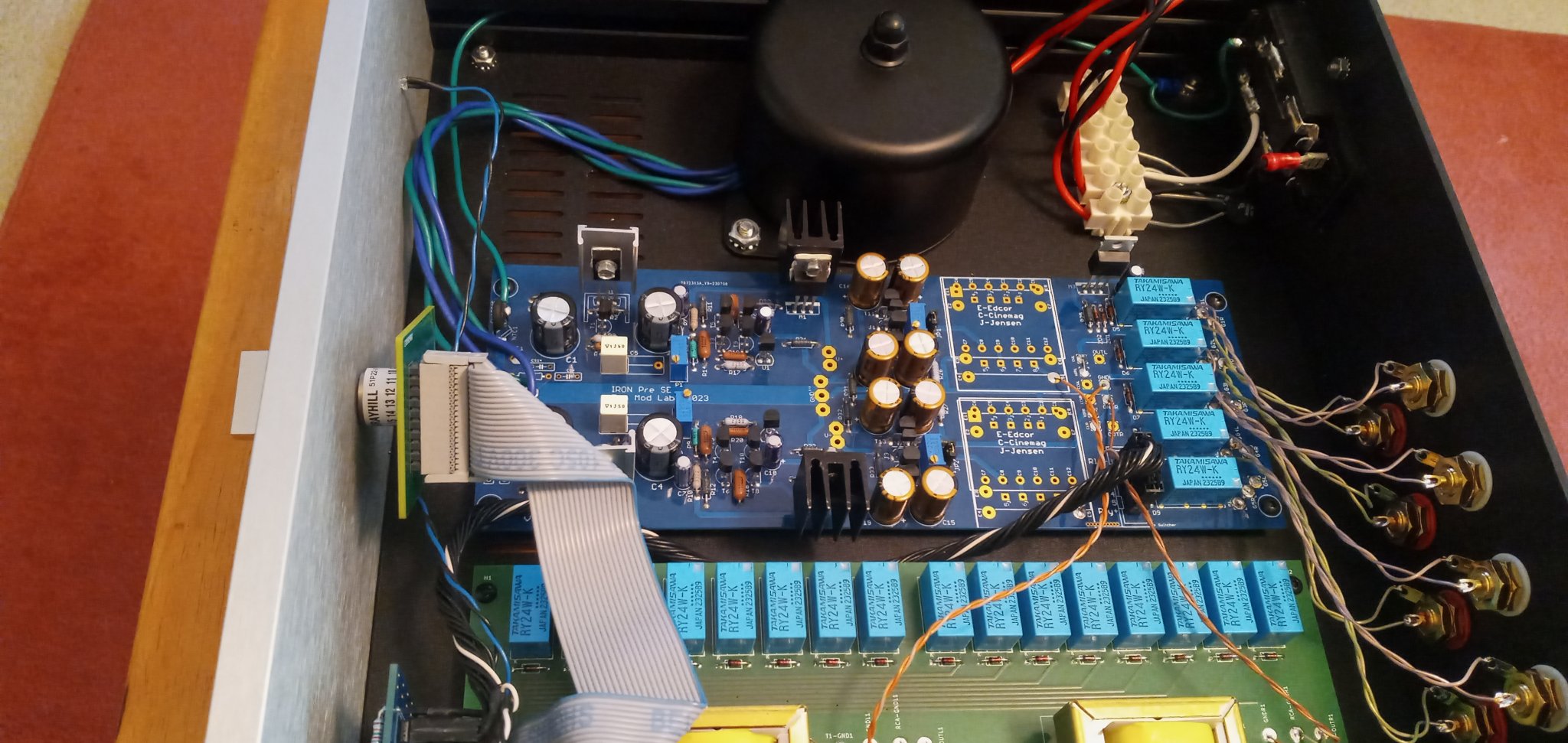

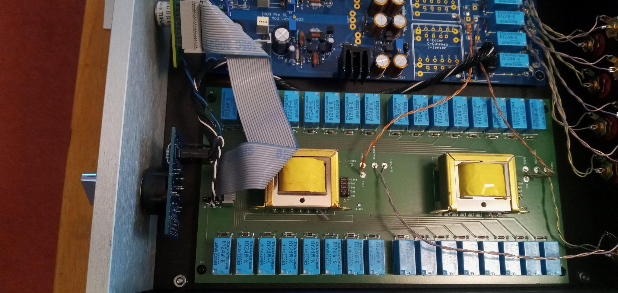

I've been working on this project for a while... I finally finished it.
Here's my take on the Iron Pre Amp with AVC (Iron Pumpkin Jr.?). I love the way this pre-amp sounds. Actually it's the way it doesn't sound, it's so transparent. Thanks again to ZM and ItsAllInMyHead et al for getting these to the store.
Cinco
Cinco

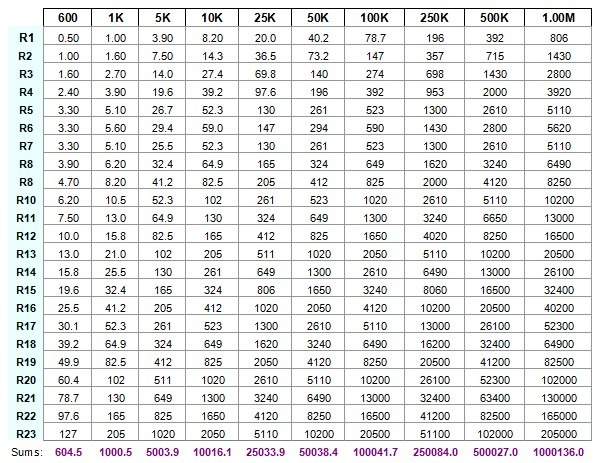

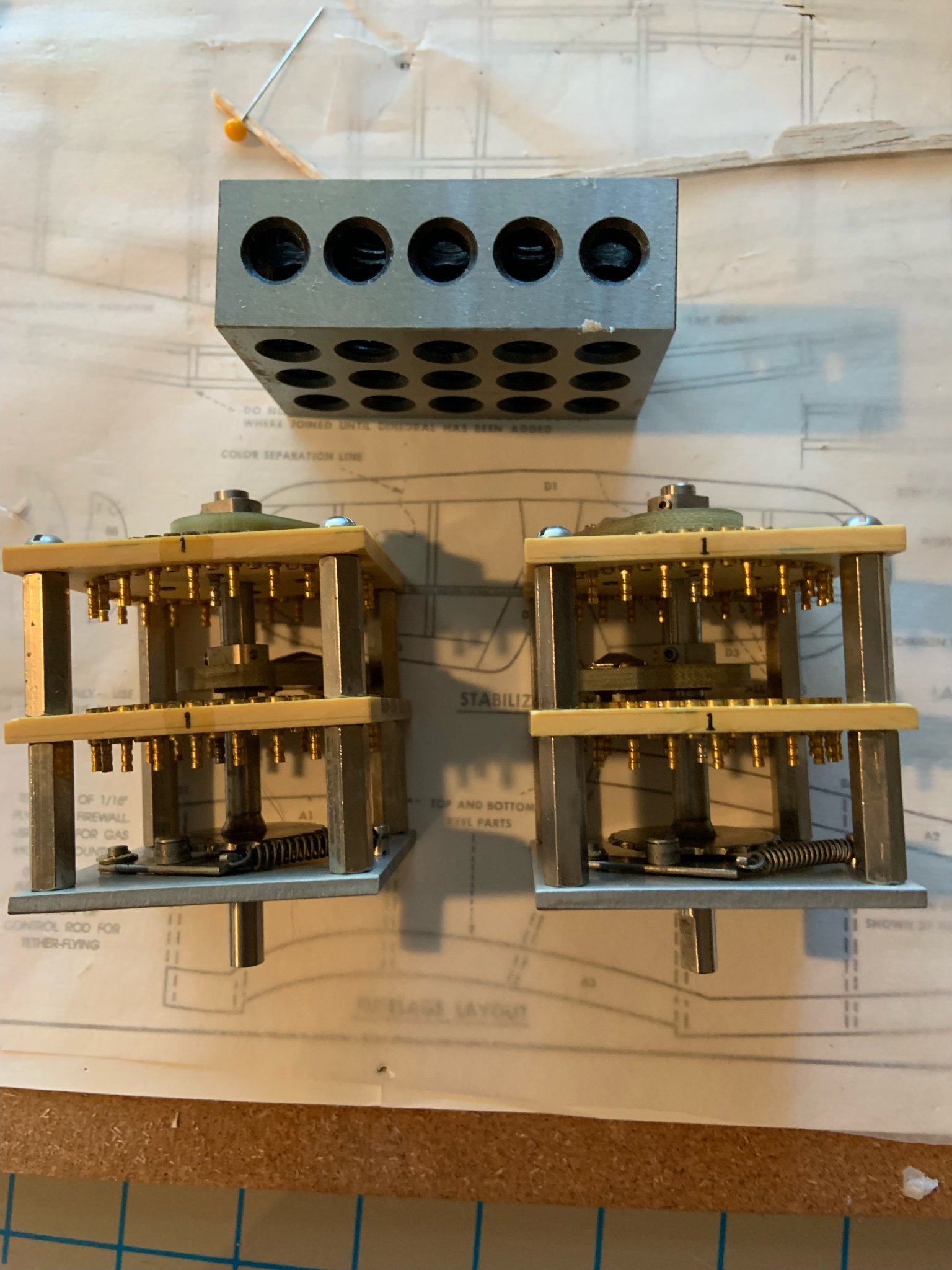

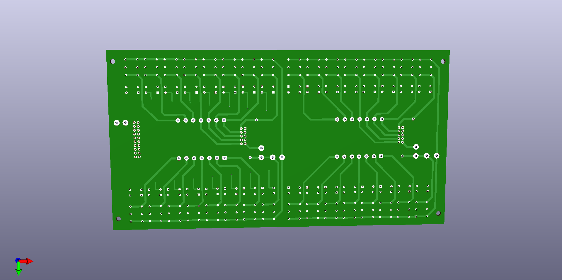

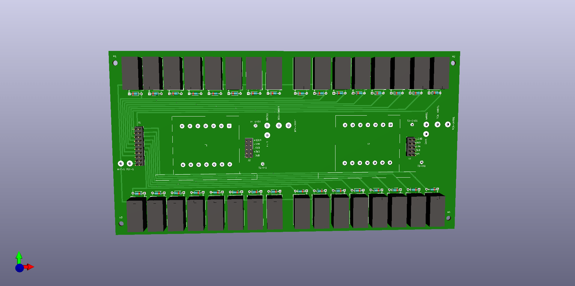

I ordered myself a balanced kit. I have this pair of really nice vintage Daven/Shallcross 24 position make before break switches. Torn between choosing to build the pots or buy just buy a COTS and get going instead of building. What are folks preferences?
In case I go the build route, any one hve resistor values for 10k (i am assuming that is optimal) pot?
Regards, Vinay
Regards, Vinay
I am still trying to wrap my head around this beautiful piece of work. So... this is what a TVC would turn out to look like. I just didn't have that much of a picture in my mind's eye. I really like the chassis as well. Good and heavy duty.
