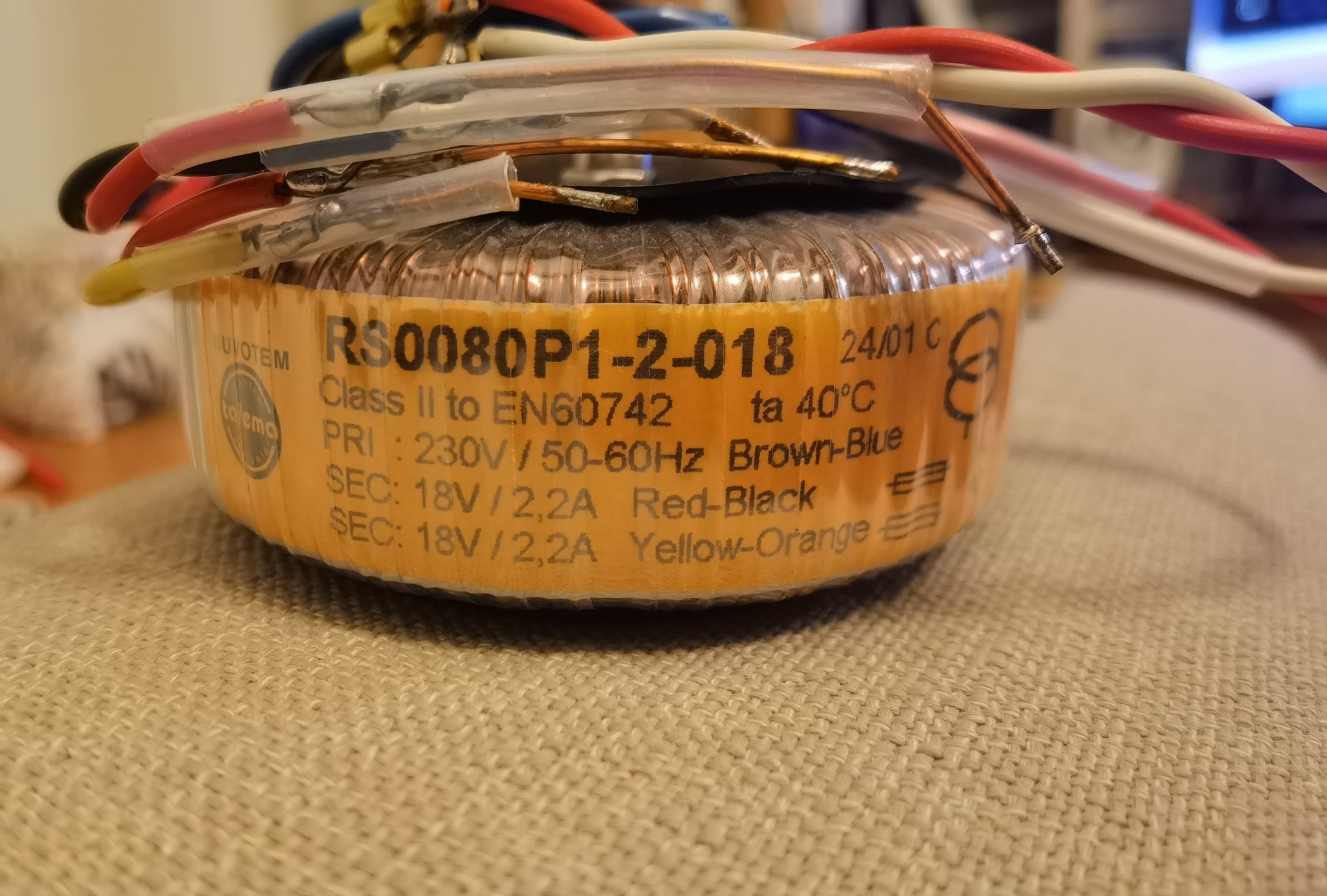

Transformer question for general knowledge that I'm sure has been asked before...
A "minimum" of 20VA 2x18V secondaries (or a 36V CT) is listed on the purchase page.
AnTek sells a 25VA, AN-0218, which certainly meets the requirement for the Single Ended version of the Iron Pre.
For the Balanced version, assuming purchase from AnTek, would two 25VA transformers be the preferred option, or two 10VA transformers be just as appropriate, or preferred (AN-0118)?
I'm also making an assumption that buying the "can" to put the transformer inside is the preferred path if it's not too much trouble.

^ Excellent question.
ZM's marvelous schematics and documents are the source of divine truth. My mere interpretations are ... trivial.
With that... it's recommended to have 20VA "per board".
For SE builds I've used an AN-0218 with great success, and I've also used the absurdly large (but the smallest shielded version offered) AS-0518.
For a balanced build, two 0218s in dual mono would be marvelous. I would not try an 0118 per channel. The Antek's regulation may suffer. Besides, the 0218s are already adorably small... and easily accomodated into most chassis in the preferred dual mono configuration.

Will this work for the balanced version, or do I need to use the two that I have?
Am I asking for hum by going too large?
there is enough finesse in overall construction, so overkill in that area simply not needed and actually asking for trouble
acquire proper Donuts, this Drek deserves it

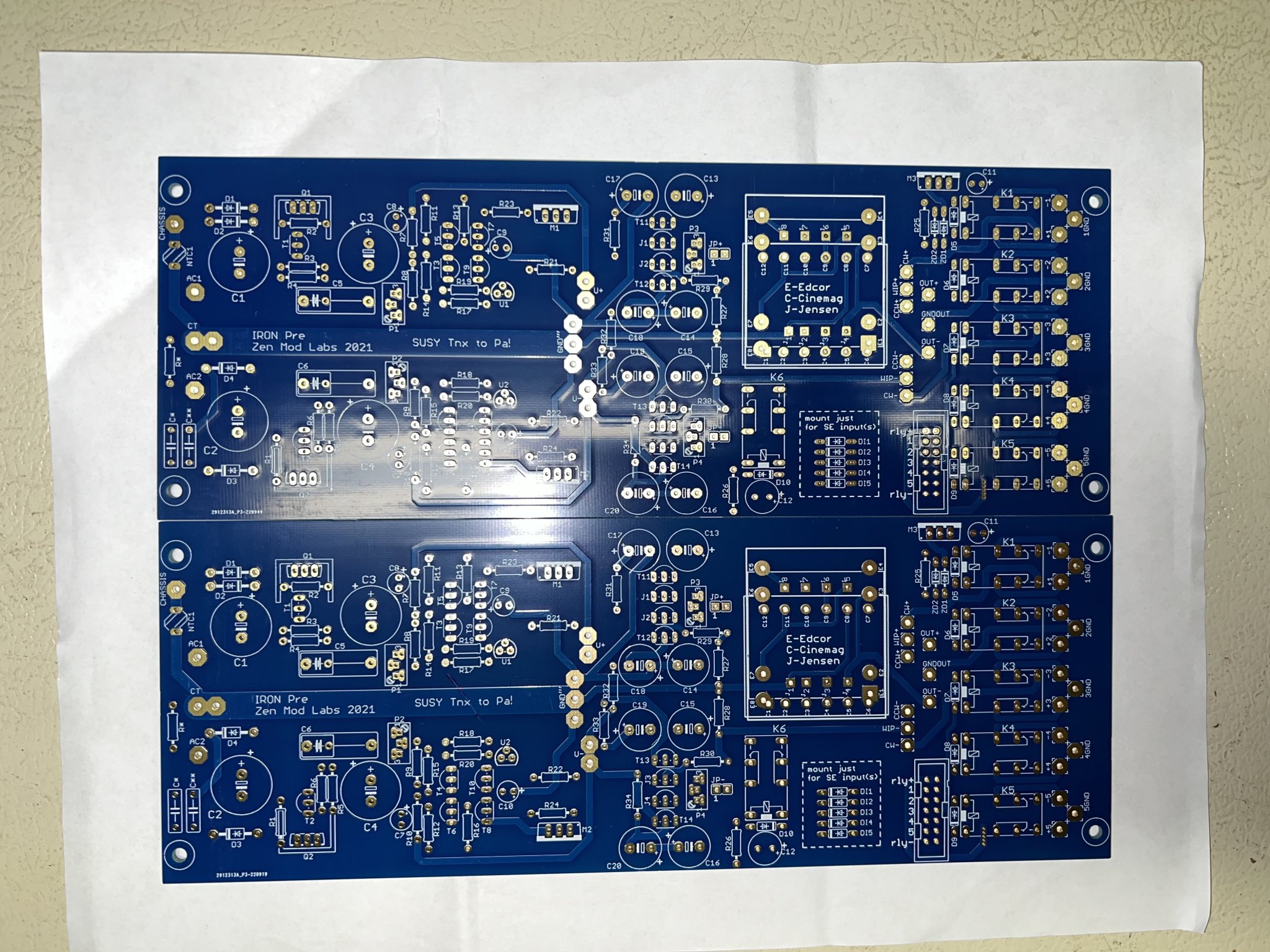

Just for clarification. These new SMD version boards have the modifications made earlier by ZM so they are ready for use with Logic solutions? Such as Muses etc?
As opposed to the 2021 version which would require modifications for use with Logic? (Pic)
^ Hiya -
Yes; the SMD boards are the same as the V3 boards with regards to logic compatibility. 🙂
Great question!
Edited to add - The "2021" boards may not need to be modified. It largely depends on the logic solution chosen, and what that logic is doing. 😉
Great question!

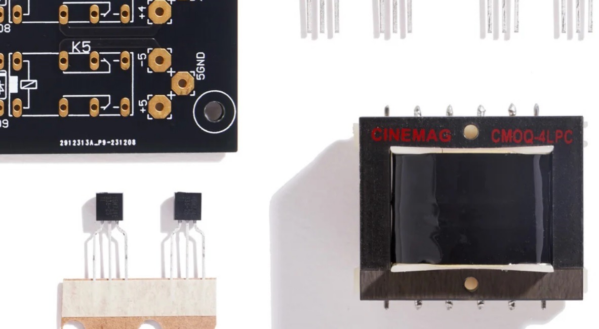

IAIMH,
On the diyAudioStore page for the Iron Pre SMD, you can read that the “CineMag CMOQ-4HPC Signal Transformers” are included in the kits, but strangely the image included on that page shows the CineMag CMOQ-4LPC (attached image).
Can you clarify which of the Cinemag transformers are included in the kits?
Thanks.
Thanks.
^ Excellent catch. Our incredible photo friend had the LPCs for the photos. The HPCs are in the kits. 🙂
