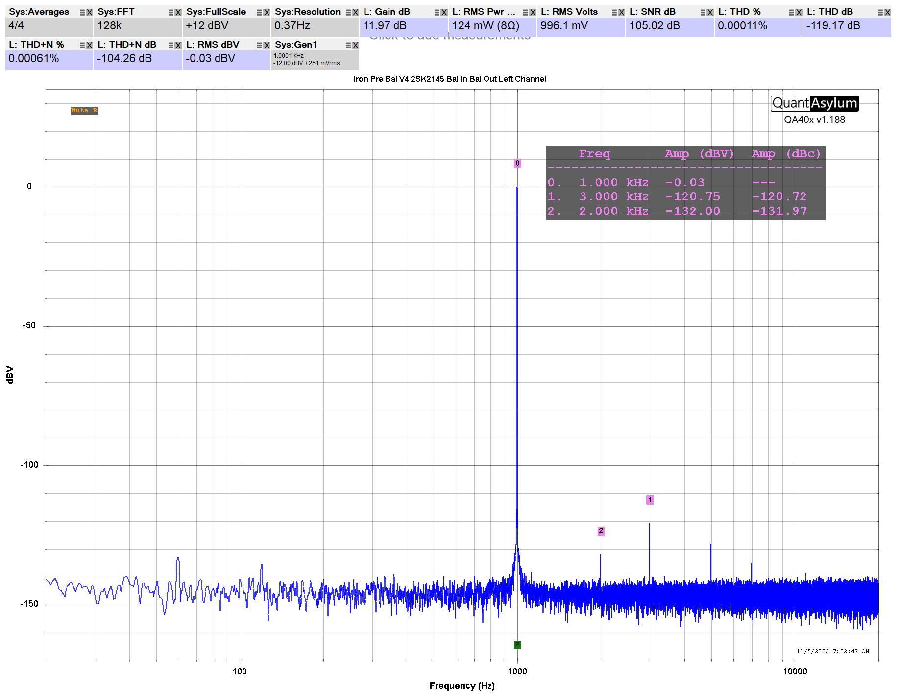

If it's the latter, it is shielded, and it has a thermal fuse. Both are niceties. I built mine (several) with various models with and without shields; and with and without two types of metal cans over the toroids. Granted, my builds were in fairly spacious chassis, but they were all silent with a 'very low' noise floor and mains harmonics that were all but undetectable with a QA403. Example below used 'regular old' Antek AN-0218. Note that the 2nd harmonic is 132dB below the fundamental, and the mains noise is... well... maybe juuuuuuust lower than that.
tl;dr - I'm all about overkill, and that medical grade Triad looks nice...but the Anteks work wonderfully too. If you go that route with the Triad, let us know how it works out. 🙂
I'll be dammed. It is medical grade. Model VPM36-690. Not seeing a reason for that having to be used. I will stick with the Antek. That is what I used last time and am still overwhelmed by what it does. Besides the medical grade might give me hives.
