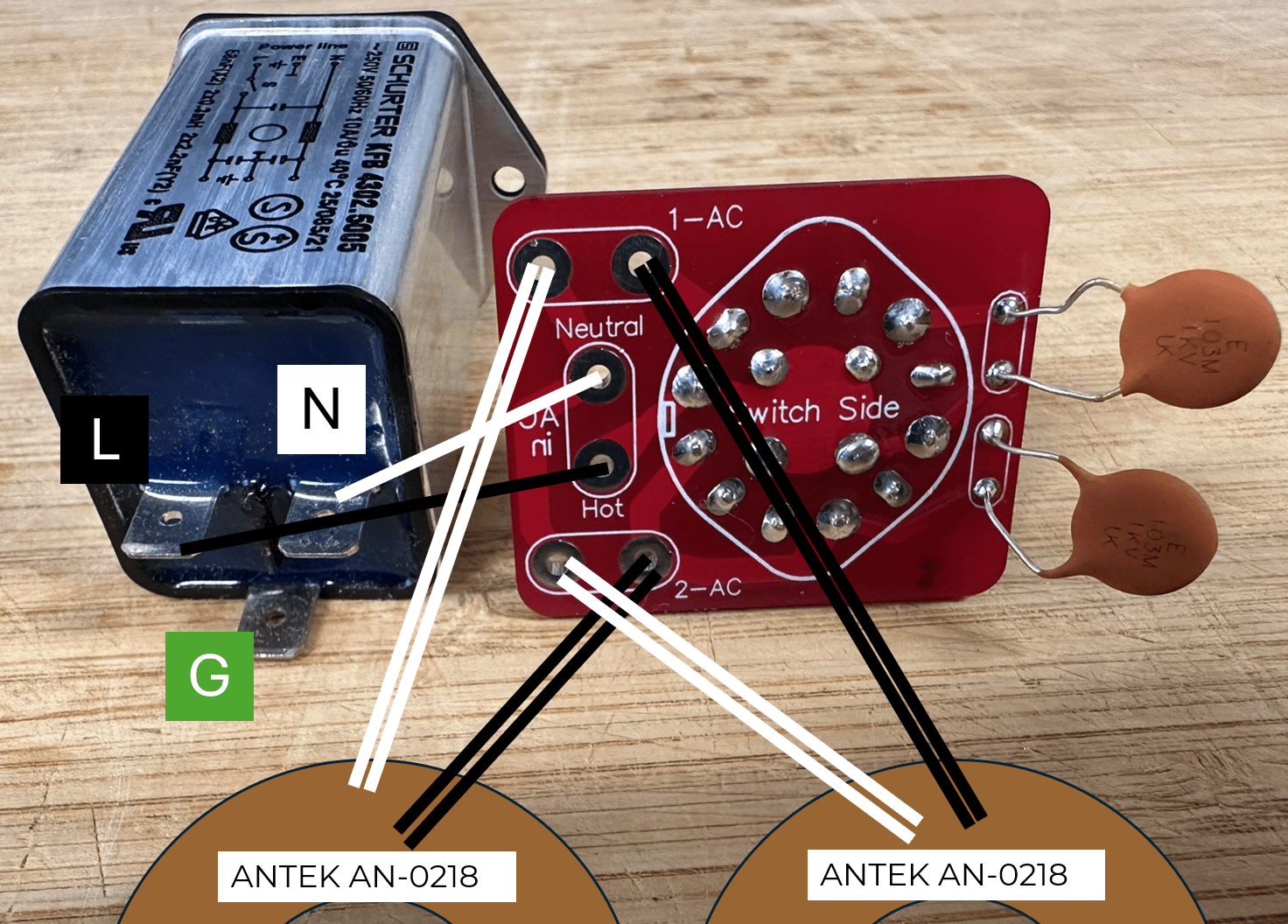

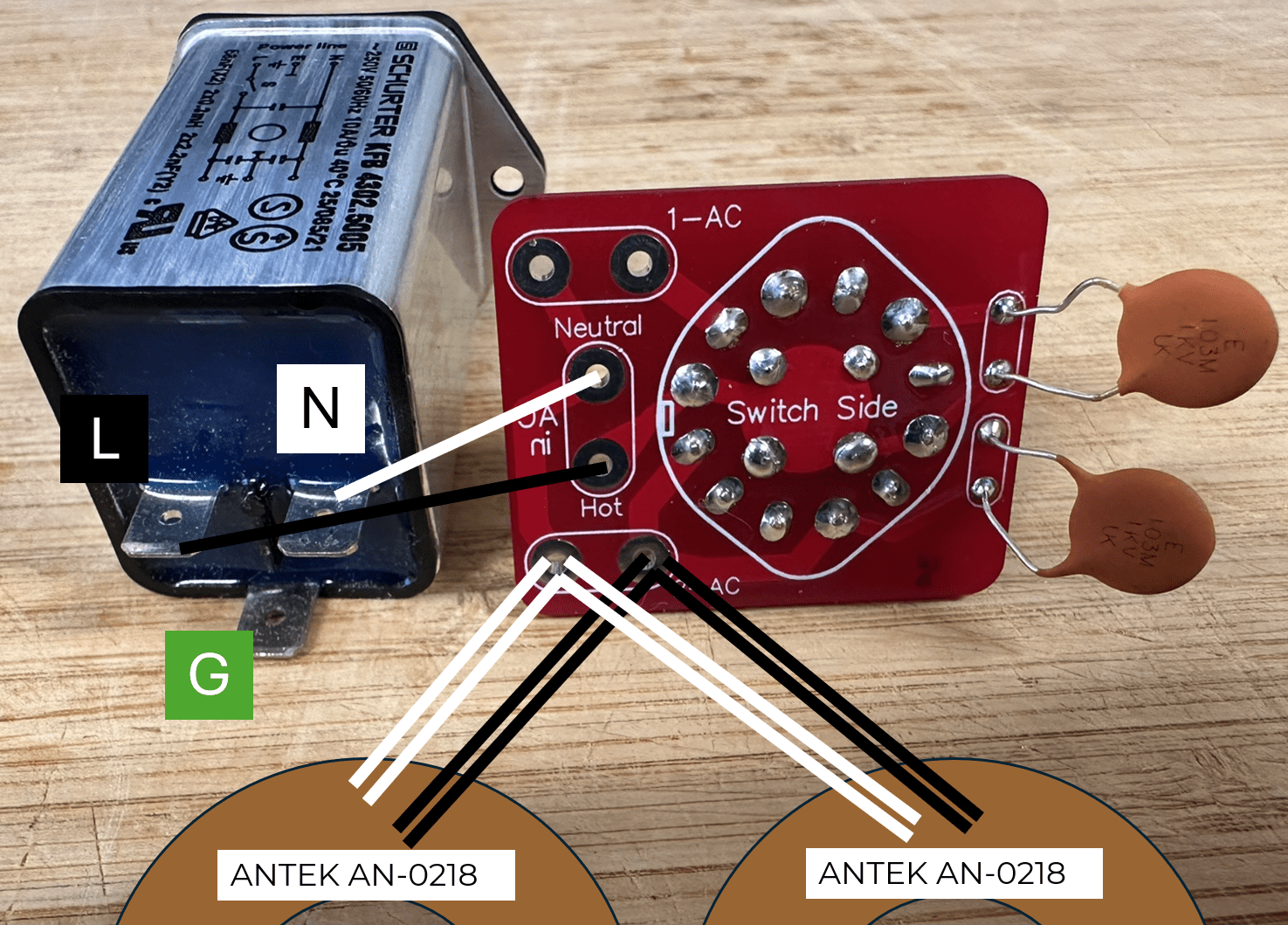

Assuming I wanted to lean into the nuances of using this switch instead of buying a single power switch, would the wiring look something like the two images below?
Second image skips AC-1 and powers on both with final click of the wheel.

I haven't beeped it out... and you haven't shared how it all beeped out... but #1 scares me.
#2 looks fine to send mains to both transformers when the switch is most likely fully CW.
