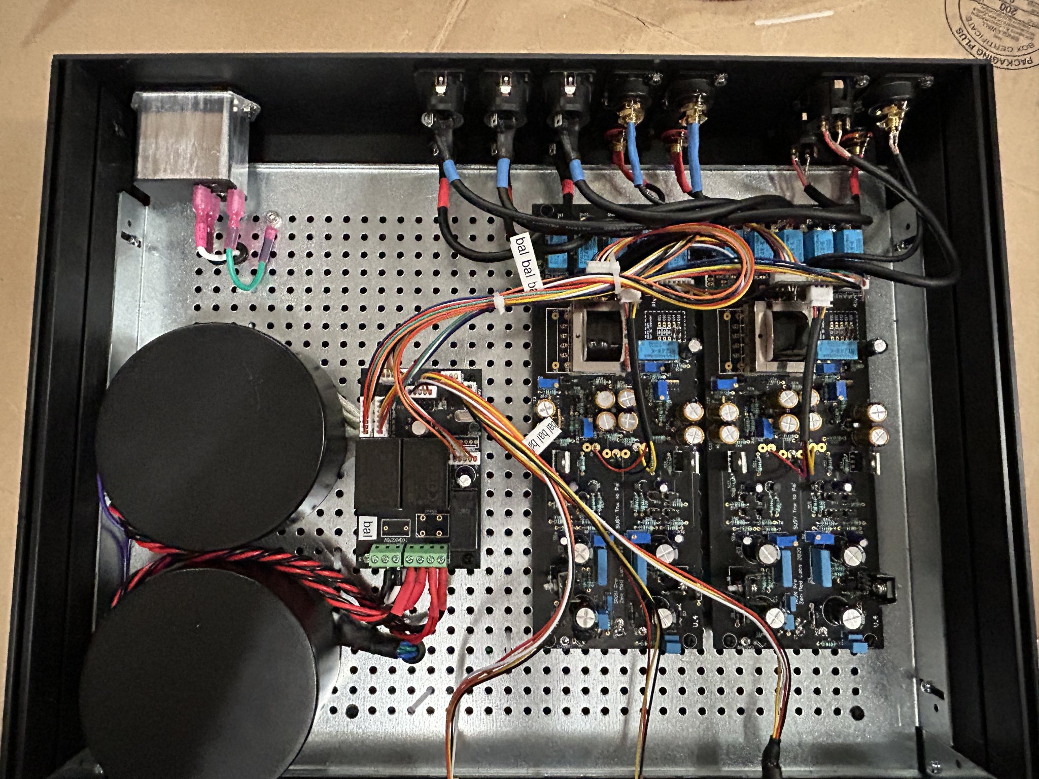

Sure, sure, they look lovely, and you spend a lot of time looking at the mechanicals, close up.
Pfftt..
^ Wire management is not my strongest attribute.
In all seriousness, after I figured out a layout that sorta made sense, it wasn't too big a deal.
If I had it all to do over again... and I won't... there are a few things I might change -
- I used Mogami 2552 for the balanced I/O. With these chassis dimensions and the layout (right and left are "stacked" on the back panel vs. to the left and right of the chassis), I'd opt for something a little thinner to allow tighter bends // shorter cable runs / neater wiring. It could also be my lack of skills and my trepidation to bend it too much or put too much stress on the wires at the boards and jacks.
- I may use a taller chassis to allow stacking the boards and greater separation between the toroids / auxiliary stuff and the boards.
- I might make up some of my own connectors for the Muses boards to allow longer / shorter runs as needed. This still nags at me.

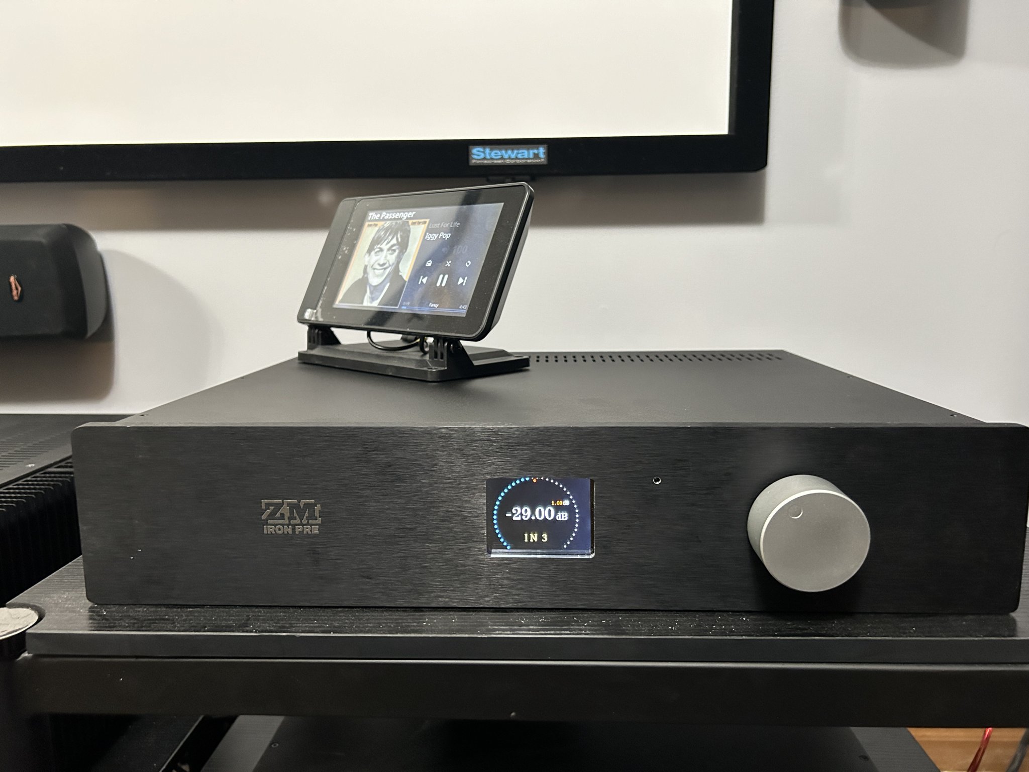

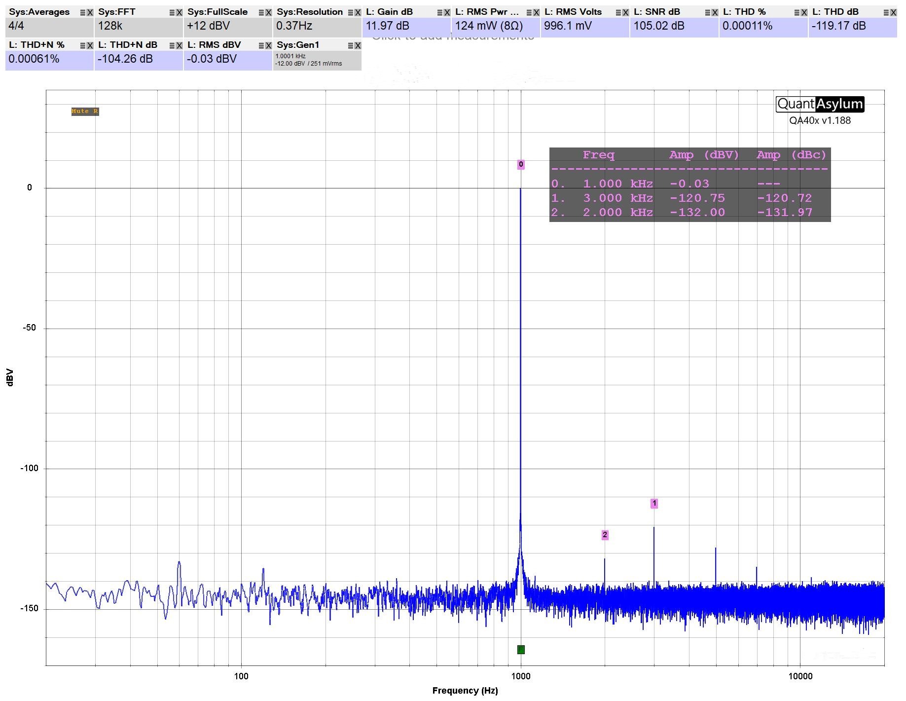

It's got the lid on... and I can't see it... and it's <140dB noise floor (if I did it right). It's fine.
Again... it's no secret that I really like this pre-amp. It's playing now with Lynn's HG follower... nifty stuff.
